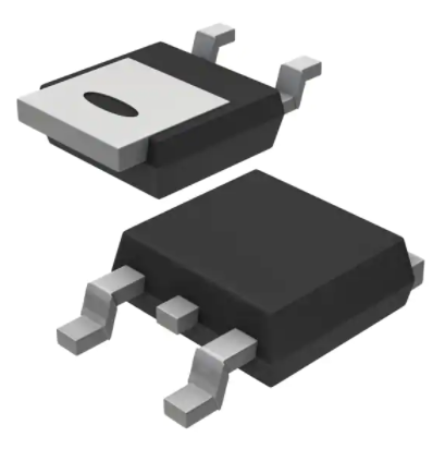

    MOS管 N-Channel VDS=30V VGS=±20V ID=75A RDS(ON)=5.5mΩ@10V TO252
PHD101NQ03LT,118 数据手册
PHD101NQ03LT N-channel TrenchMOS logic level FET Rev. 5 — 31 October 2011 Product data sheet 1. Product profile 1.1 General description Logic level N-channel enhancement mode Field-Effect Transistor (FET) in a plastic package using TrenchMOS technology. This product is designed and qualified for use in computing, communications, consumer and industrial applications only. 1.2 Features and benefits  Low conduction losses due to low on-state resistance  Suitable for logic level gate drive sources  Simple gate drive required due to low gate charge 1.3 Applications  DC-to-DC converters 1.4 Quick reference data Table 1. Quick reference data Symbol Parameter Conditions Min Typ Max Unit VDS drain-source voltage Tj ≥ 25 °C; Tj ≤ 175 °C - - 30 V ID drain current Tmb = 25 °C; VGS = 10 V; see Figure 1; see Figure 3 - - 75 A Ptot total power dissipation Tmb = 25 °C; see Figure 2 - - 166 W VGS = 10 V; ID = 25 A; Tj = 25 °C; see Figure 9; see Figure 10 - 4.5 5.5 mΩ VGS = 5 V; ID = 50 A; VDS = 15 V; Tj = 25 °C; see Figure 11 - 8 - nC Static characteristics RDSon drain-source on-state resistance Dynamic characteristics QGD gate-drain charge PHD101NQ03LT Nexperia N-channel TrenchMOS logic level FET 2. Pinning information Table 2. Pinning information Pin Symbol Description 1 G gate 2 D drain[1] Simplified outline Graphic symbol mb 3 S source mb D mounting base; connected to drain D G mbb076 S 2 1 3 SOT428 (DPAK) [1] It is not possible to make a connection to pin 2. 3. Ordering information Table 3. Ordering information Type number Package PHD101NQ03LT Name Description Version DPAK plastic single-ended surface-mounted package (DPAK); 3 leads (one lead cropped) SOT428 4. Limiting values Table 4. Limiting values In accordance with the Absolute Maximum Rating System (IEC 60134). Symbol Parameter Conditions Min Max Unit VDS drain-source voltage Tj ≥ 25 °C; Tj ≤ 175 °C - 30 V VDGR drain-gate voltage Tj ≥ 25 °C; Tj ≤ 175 °C; RGS = 20 kΩ - 30 V VGS gate-source voltage -20 20 V ID drain current VGS = 10 V; Tmb = 100 °C; see Figure 1 - 75 A VGS = 10 V; Tmb = 25 °C; see Figure 1; see Figure 3 - 75 A IDM peak drain current pulsed; tp ≤ 10 µs; Tmb = 25 °C; see Figure 3 - 240 A Ptot total power dissipation Tmb = 25 °C; see Figure 2 - 166 W Tstg storage temperature -55 175 °C Tj junction temperature -55 175 °C VGSM peak gate-source voltage pulsed; δ = 25 %; tp ≤ 50 µs -25 25 V Source-drain diode IS source current Tmb = 25 °C - 75 A ISM peak source current pulsed; tp ≤ 10 µs; Tmb = 25 °C - 240 A VGS = 10 V; Tj(init) = 25 °C; ID = 43 A; Vsup ≤ 15 V; unclamped; tp = 0.19 ms; RGS = 50 Ω - 185 mJ Avalanche ruggedness EDS(AL)S non-repetitive drain-source avalanche energy PHD101NQ03LT Product data sheet All information provided in this document is subject to legal disclaimers. Rev. 5 — 31 October 2011 © Nexperia B.V. 2017. All rights reserved 2 of 13 PHD101NQ03LT Nexperia N-channel TrenchMOS logic level FET 03ai19 120 03aa16 120 Ider (%) Pder (%) 80 80 40 40 0 0 0 Fig 1. 50 100 150 200 Tmb (°C) 0 50 100 150 200 Tmb (°C) Normalized continuous drain current as a function of mounting base temperature Fig 2. Normalized total power dissipation as a function of mounting base temperature 03ai21 103 ID (A) Limit RDSon = VDS / ID tp = 10 μ s 100 μ s 102 DC 1 ms 10 10 ms 1 1 Fig 3. 10 102 VDS (V) Safe operating area; continuous and peak drain currents as a function of drain-source voltage PHD101NQ03LT Product data sheet All information provided in this document is subject to legal disclaimers. Rev. 5 — 31 October 2011 © Nexperia B.V. 2017. All rights reserved 3 of 13 PHD101NQ03LT Nexperia N-channel TrenchMOS logic level FET 5. Thermal characteristics Table 5. Thermal characteristics Symbol Parameter Conditions Min Typ Max Unit Rth(j-mb) thermal resistance from junction to mounting base see Figure 4 - - 0.9 K/W Rth(j-a) thermal resistance from junction to ambient minimum footprint [1] - 75 - K/W SOT404 minimum footprint [1] - 50 - K/W [1] Mounted on a printed-circuit board; vertical in still air. 03ai20 10 Zth(j-mb) (K/W) 1 δ = 0.5 0.2 10-1 0.1 0.05 10-2 δ= P 0.02 tp T single pulse t tp T 10-3 10-5 Fig 4. 10-4 10-3 10-2 10-1 tp (s) 1 Transient thermal impedance from junction to mounting base as a function of pulse duration PHD101NQ03LT Product data sheet All information provided in this document is subject to legal disclaimers. Rev. 5 — 31 October 2011 © Nexperia B.V. 2017. All rights reserved 4 of 13 PHD101NQ03LT Nexperia N-channel TrenchMOS logic level FET 6. Characteristics Table 6. Symbol Characteristics Parameter Conditions Min Typ Max Unit Static characteristics V(BR)DSS drain-source breakdown voltage ID = 250 µA; VGS = 0 V; Tj = -55 °C 27 - - V ID = 250 µA; VGS = 0 V; Tj = 25 °C 30 - - V VGS(th) gate-source threshold voltage ID = 1 mA; VDS = VGS; Tj = 175 °C; see Figure 7; see Figure 8 0.6 - - V ID = 1 mA; VDS = VGS; Tj = -55 °C; see Figure 7; see Figure 8 - - 2.9 V ID = 1 mA; VDS = VGS; Tj = 25 °C; see Figure 7; see Figure 8 1 1.9 2.5 V IDSS drain leakage current VDS = 30 V; VGS = 0 V; Tj = 25 °C - 0.05 1 µA VDS = 30 V; VGS = 0 V; Tj = 175 °C - - 500 µA IGSS gate leakage current VGS = 20 V; VDS = 0 V; Tj = 25 °C - 10 100 nA VGS = -20 V; VDS = 0 V; Tj = 25 °C - 10 100 nA VGS = 10 V; ID = 25 A; Tj = 25 °C; see Figure 9; see Figure 10 - 4.5 5.5 mΩ VGS = 5 V; ID = 25 A; Tj = 175 °C; see Figure 9; see Figure 10 - 10.5 13.5 mΩ VGS = 5 V; ID = 25 A; Tj = 25 °C; see Figure 9; see Figure 10 - 5.8 7.5 mΩ ID = 50 A; VDS = 15 V; VGS = 5 V; Tj = 25 °C; see Figure 11 - 23 - nC - 10.5 - nC - 8 - nC - 2180 - pF - 600 - pF - 225 - pF RDSon drain-source on-state resistance Dynamic characteristics QG(tot) total gate charge QGS gate-source charge QGD gate-drain charge Ciss input capacitance Coss output capacitance Crss reverse transfer capacitance td(on) turn-on delay time tr rise time td(off) tf VDS = 25 V; VGS = 0 V; f = 1 MHz; Tj = 25 °C; see Figure 12 VDS = 15 V; RL = 0.6 Ω; VGS = 4.5 V; RG(ext) = 5.6 Ω; Tj = 25 °C; ID = 25 A - 23 - ns - 90 - ns turn-off delay time - 37 - ns fall time - 33 - ns Source-drain diode VSD source-drain voltage IS = 25 A; VGS = 0 V; Tj = 25 °C; see Figure 13 - 0.85 1.2 V trr reverse recovery time - 37 - ns Qr recovered charge IS = 10 A; dIS/dt = -100 A/µs; VGS = 0 V; VDS = 25 V; Tj = 25 °C - 33 - nC PHD101NQ03LT Product data sheet All information provided in this document is subject to legal disclaimers. Rev. 5 — 31 October 2011 © Nexperia B.V. 2017. All rights reserved 5 of 13 PHD101NQ03LT Nexperia N-channel TrenchMOS logic level FET 03ai22 80 VGS (V) = 10 ID (A) 5 4.5 ID (A) 3.8 Tj = 25 °C 03ai24 80 4 60 60 3.6 40 40 3.4 3.2 20 20 175 °C 3 Tj = 25 °C 2.8 0 0 0 Fig 5. 0.2 0.4 0.6 0.8 VDS (V) 1 Output characteristics: drain current as a function of drain-source voltage; typical values 03ai29 3.2 0 Fig 6. 1 2 3 V (V) 4 GS Transfer characteristics: drain current as a function of gate-source voltage; typical values 03ai28 10-1 ID (A) VGS(th) (V) max 10-2 typ 10-3 2.4 min typ max 1.6 10-4 min 0.8 10-5 0 -60 Fig 7. 10-6 0 60 120 Tj (°C) Gate-source threshold voltage as a function of junction temperature PHD101NQ03LT Product data sheet 0 180 Fig 8. 0.8 1.6 2.4 VGS(V) 3.2 Sub-threshold drain current as a function of gate-source voltage All information provided in this document is subject to legal disclaimers. Rev. 5 — 31 October 2011 © Nexperia B.V. 2017. All rights reserved 6 of 13 PHD101NQ03LT Nexperia N-channel TrenchMOS logic level FET 03ai23 16 Tj = 25 °C RDSon (mΩ) 03af18 2 VGS (V) = 3.8 a 1.5 12 4 8 1 4.5 5 10 0.5 4 0 -60 0 0 Fig 9. 20 40 60 80 ID (A) Drain-source on-state resistance as a function of drain current; typical values 03ai27 10 ID = 50 A Tj = 25 °C VDS = 15 V VGS (V) 8 0 60 120 Tj (°C) 180 Fig 10. Normalized drain-source on-state resistance factor as a function of junction temperature 03ai26 104 C (pF) Ciss 6 103 4 Coss 2 Crss 0 0 10 20 30 40 50 QG (nC) Fig 11. Gate-source voltage as a function of gate charge; typical values PHD101NQ03LT Product data sheet 102 10-1 1 10 VDS (V) 102 Fig 12. Input, output and reverse transfer capacitances as a function of drain-source voltage; typical values All information provided in this document is subject to legal disclaimers. Rev. 5 — 31 October 2011 © Nexperia B.V. 2017. All rights reserved 7 of 13 PHD101NQ03LT Nexperia N-channel TrenchMOS logic level FET 03ai25 80 VGS = 0 V IS (A) 60 40 20 175 °C Tj = 25 °C 0 0 0.3 0.6 0.9 VSD (V) 1.2 Fig 13. Source current as a function of source-drain voltage; typical values PHD101NQ03LT Product data sheet All information provided in this document is subject to legal disclaimers. Rev. 5 — 31 October 2011 © Nexperia B.V. 2017. All rights reserved 8 of 13 PHD101NQ03LT Nexperia N-channel TrenchMOS logic level FET 7. Package outline Plastic single-ended surface-mounted package (DPAK); 3 leads (one lead cropped) SOT428 y E A A A1 b2 E1 mounting base D2 D1 HD 2 L L2 1 L1 3 b1 b w M c A e e1 0 5 10 mm scale DIMENSIONS (mm are the original dimensions) UNIT A A1 b b1 b2 c D1 D2 min E E1 min e e1 HD L L1 min L2 w y max mm 2.38 2.22 0.93 0.46 0.89 0.71 1.1 0.9 5.46 5.00 0.56 0.20 6.22 5.98 4.0 6.73 6.47 4.45 2.285 4.57 10.4 9.6 2.95 2.55 0.5 0.9 0.5 0.2 0.2 OUTLINE VERSION SOT428 REFERENCES IEC JEDEC JEITA TO-252 SC-63 EUROPEAN PROJECTION ISSUE DATE 06-02-14 06-03-16 Fig 14. Package outline SOT428 (DPAK) PHD101NQ03LT Product data sheet All information provided in this document is subject to legal disclaimers. Rev. 5 — 31 October 2011 © Nexperia B.V. 2017. All rights reserved 9 of 13 PHD101NQ03LT Nexperia N-channel TrenchMOS logic level FET 8. Revision history Table 7. Revision history Document ID Release date Data sheet status Change notice Supersedes PHD101NQ03LT v.5 20111031 Product data sheet - PHD101NQ03LT v.4 - PHD101NQ03LT v.3 Modifications: PHD101NQ03LT v.4 PHD101NQ03LT Product data sheet • Various changes to content. 20090609 Product data sheet All information provided in this document is subject to legal disclaimers. Rev. 5 — 31 October 2011 © Nexperia B.V. 2017. All rights reserved 10 of 13 PHD101NQ03LT Nexperia N-channel TrenchMOS logic level FET 9. Legal information 9.1 Data sheet status Document status [1] [2] Product status [3] Definition Objective [short] data sheet Development This document contains data from the objective specification for product development. Preliminary [short] data sheet Qualification This document contains data from the preliminary specification. Product [short] data sheet Production This document contains the product specification. [1] Please consult the most recently issued document before initiating or completing a design. [2] The term 'short data sheet' is explained in section "Definitions". [3] The product status of device(s) described in this document may have changed since this document was published and may differ in case of multiple devices. The latest product status information is available on the Internet at URL http://www.nexperia.com. 9.2 Definitions Preview — The document is a preview version only. The document is still subject to formal approval, which may result in modifications or additions. Nexperia does not give any representations or warranties as to the accuracy or completeness of information included herein and shall have no liability for the consequences of use of such information. Draft — The document is a draft version only. The content is still under internal review and subject to formal approval, which may result in modifications or additions. Nexperia does not give any representations or warranties as to the accuracy or completeness of information included herein and shall have no liability for the consequences of use of such information. Short data sheet — A short data sheet is an extract from a full data sheet with the same product type number(s) and title. A short data sheet is intended for quick reference only and should not be relied upon to contain detailed and full information. For detailed and full information see the relevant full data sheet, which is available on request via the local Nexperia sales office. In case of any inconsistency or conflict with the short data sheet, the full data sheet shall prevail. Product specification — The information and data provided in a Product data sheet shall define the specification of the product as agreed between Nexperia and its customer, unless Nexperia and customer have explicitly agreed otherwise in writing. In no event however, shall an agreement be valid in which the Nexperia product is deemed to offer functions and qualities beyond those described in the Product data sheet. 9.3 Disclaimers Limited warranty and liability — Information in this document is believed to be accurate and reliable. However, Nexperia does not give any representations or warranties, expressed or implied, as to the accuracy or completeness of such information and shall have no liability for the consequences of use of such information. In no event shall Nexperia be liable for any indirect, incidental, punitive, special or consequential damages (including - without limitation - lost profits, lost savings, business interruption, costs related to the removal or replacement of any products or rework charges) whether or not such damages are based on tort (including negligence), warranty, breach of contract or any other legal theory. Notwithstanding any damages that customer might incur for any reason whatsoever, Nexperia’s aggregate and cumulative liability towards customer for the products described herein shall be limited in accordance with the Terms and conditions of commercial sale of Nexperia. PHD101NQ03LT Product data sheet Right to make changes — Nexperia reserves the right to make changes to information published in this document, including without limitation specifications and product descriptions, at any time and without notice. This document supersedes and replaces all information supplied prior to the publication hereof. Suitability for use — Nexperia products are not designed, authorized or warranted to be suitable for use in life support, life-critical or safety-critical systems or equipment, nor in applications where failure or malfunction of a Nexperia product can reasonably be expected to result in personal injury, death or severe property or environmental damage. Nexperia accepts no liability for inclusion and/or use of Nexperia products in such equipment or applications and therefore such inclusion and/or use is at the customer’s own risk. Quick reference data — The Quick reference data is an extract of the product data given in the Limiting values and Characteristics sections of this document, and as such is not complete, exhaustive or legally binding. Applications — Applications that are described herein for any of these products are for illustrative purposes only. Nexperia makes no representation or warranty that such applications will be suitable for the specified use without further testing or modification. Customers are responsible for the design and operation of their applications and products using Nexperia products, and Nexperia accepts no liability for any assistance with applications or customer product design. It is customer’s sole responsibility to determine whether the Nexperia product is suitable and fit for the customer’s applications and products planned, as well as for the planned application and use of customer’s third party customer(s). Customers should provide appropriate design and operating safeguards to minimize the risks associated with their applications and products. Nexperia does not accept any liability related to any default, damage, costs or problem which is based on any weakness or default in the customer’s applications or products, or the application or use by customer’s third party customer(s). Customer is responsible for doing all necessary testing for the customer’s applications and products using Nexperia products in order to avoid a default of the applications and the products or of the application or use by customer’s third party customer(s). Nexperia does not accept any liability in this respect. Limiting values — Stress above one or more limiting values (as defined in the Absolute Maximum Ratings System of IEC 60134) will cause permanent damage to the device. Limiting values are stress ratings only and (proper) operation of the device at these or any other conditions above those given in the Recommended operating conditions section (if present) or the Characteristics sections of this document is not warranted. Constant or repeated exposure to limiting values will permanently and irreversibly affect the quality and reliability of the device. All information provided in this document is subject to legal disclaimers. Rev. 5 — 31 October 2011 © Nexperia B.V. 2017. All rights reserved 11 of 13 PHD101NQ03LT Nexperia N-channel TrenchMOS logic level FET Terms and conditions of commercial sale — Nexperia products are sold subject to the general terms and conditions of commercial sale, as published at http://www.nexperia.com/profile/terms, unless otherwise agreed in a valid written individual agreement. In case an individual agreement is concluded only the terms and conditions of the respective agreement shall apply. Nexperia hereby expressly objects to applying the customer’s general terms and conditions with regard to the purchase of Nexperia products by customer. No offer to sell or license — Nothing in this document may be interpreted or construed as an offer to sell products that is open for acceptance or the grant, conveyance or implication of any license under any copyrights, patents or other industrial or intellectual property rights. Export control — This document as well as the item(s) described herein may be subject to export control regulations. Export might require a prior authorization from competent authorities. In the event that customer uses the product for design-in and use in automotive applications to automotive specifications and standards, customer (a) shall use the product without Nexperia’s warranty of the product for such automotive applications, use and specifications, and (b) whenever customer uses the product for automotive applications beyond Nexperia’s specifications such use shall be solely at customer’s own risk, and (c) customer fully indemnifies Nexperia for any liability, damages or failed product claims resulting from customer design and use of the product for automotive applications beyond Nexperia’s standard warranty and Nexperia’s product specifications. 9.4 Trademarks Notice: All referenced brands, product names, service names and trademarks are the property of their respective owners. Non-automotive qualified products — Unless this data sheet expressly states that this specific Nexperia product is automotive qualified, the product is not suitable for automotive use. It is neither qualified nor tested in accordance with automotive testing or application requirements. Nexperia accepts no liability for inclusion and/or use of non-automotive qualified products in automotive equipment or applications. 10. Contact information For more information, please visit: http://www.nexperia.com For sales office addresses, please send an email to: salesaddresses@nexperia.com PHD101NQ03LT Product data sheet All information provided in this document is subject to legal disclaimers. Rev. 5 — 31 October 2011 © Nexperia B.V. 2017. All rights reserved 12 of 13 Nexperia PHD101NQ03LT N-channel TrenchMOS logic level FET 11. Contents 1 1.1 1.2 1.3 1.4 2 3 4 5 6 7 8 9 9.1 9.2 9.3 9.4 10 © Product profile . . . . . . . . . . . . . . . . . . . . . . . . . . .1 General description . . . . . . . . . . . . . . . . . . . . . .1 Features and benefits . . . . . . . . . . . . . . . . . . . . .1 Applications . . . . . . . . . . . . . . . . . . . . . . . . . . . .1 Quick reference data . . . . . . . . . . . . . . . . . . . . .1 Pinning information . . . . . . . . . . . . . . . . . . . . . . .2 Ordering information . . . . . . . . . . . . . . . . . . . . . .2 Limiting values. . . . . . . . . . . . . . . . . . . . . . . . . . .2 Thermal characteristics . . . . . . . . . . . . . . . . . . .4 Characteristics . . . . . . . . . . . . . . . . . . . . . . . . . . .5 Package outline . . . . . . . . . . . . . . . . . . . . . . . . . .9 Revision history . . . . . . . . . . . . . . . . . . . . . . . . .10 Legal information. . . . . . . . . . . . . . . . . . . . . . . . 11 Data sheet status . . . . . . . . . . . . . . . . . . . . . . . 11 Definitions . . . . . . . . . . . . . . . . . . . . . . . . . . . . . 11 Disclaimers . . . . . . . . . . . . . . . . . . . . . . . . . . . . 11 Trademarks. . . . . . . . . . . . . . . . . . . . . . . . . . . .12 Contact information. . . . . . . . . . . . . . . . . . . . . .12 Nexperia B.V. 2017. All rights reserved For more information, please visit: http://www.nexperia.com For sales office addresses, please send an email to: salesaddresses@nexperia.com Date of release: 31 October 2011
