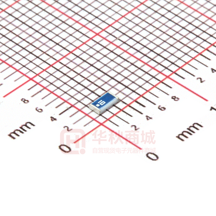

Approval sheet RFECA Series – RoHS Compliance CERAMIC ANTENNA Halogens Free Product 2.4 GHz ISM Band Working Frequency P/N: RFECA3216060A1T *Contents in this sheet are subject to change without prior notice. Page 1 of 9 ASC_RFECA3216060A1T_V07 May. 2013 Approval sheet FEATURES 3 1. Surface Mounted Devices with a small dimension of 3.2 X 1.6 X 0.6 mm meet future miniaturization trend. 2. LTCC process. 3. High stability in Temperature / Humidity Change. 4. Superb performance to place on the middle of PCB edge and excellent peak/ average gain observed by field test application. APPLICATIONS 1. ISM Band 2.4GHz applications. 2. Bluetooth.. CONSTRUCTION PIN Connection 1 Feeding 2 Soldering terminal DIMENSIONS Figure Page 2 of 9 Symbol Dimension (mm) L 3.10 ± 0.20 W 1.60 ± 0.20 T 0.60 ± 0.10 A 0.25 ± 0.20 ASC_RFECA3216060A1T_V07 May. 2013 Approval sheet SOLDER LAND PATTERN DESIGN Figure (Empty Space 8.0 mm x 3.0 mm) The limited size for ECA3216 is L>30mm and D>6mm Land Pattern TYPE 1 ELECTRONIC CHARACTERISTICS Item Specification Working Frequency Range 2.4GHz~2.4835GHz (Note-1) Gain 2 dBi (Typical) VSWR 2.1 max. Polarization Linear Azimuth Beamwidth Omni-directional Impedance 50Ω *Note 1. Central Frequency should be defined after customers’ application approval. Page 3 of 9 ASC_RFECA3216060A1T_V07 May. 2013 Approval sheet Antenna on Test Board ( Thickness 0.8mm) Antenna S11 on Test Board -10.62 dB @ 2.40 GHz -19.34 dB @ 2.45 GHz -9.648 dB @ 2.50 GHz Antenna VSWR on Test Board 1.756 @ 2.40 GHz 1.391 @ 2.45 GHz 1.986 @ 2.50 GHz Page 4 of 9 ASC_RFECA3216060A1T_V07 May. 2013 Approval sheet RADIATION PATTERN Radiation Pattern and Gain were dependent on measurement board design. The specification of RFECA3216060A1T antenna was measured based on the PCB size and installation position as shown in the below figure Test Board. x Z Y Vertical Horizontal X Cut X Cut 90 120 -10 150 -20 Y-Z Plane 90 60 0 120 -10 Y 30 150 -20 -30 180 Average Gain= -1.511 dBi 0 Z 210 180 330 240 -40 300 330 300 270 Peak Gain= -1.82 dBi Average Gain=-5.33 dBi X Cut X Cut 90 90 120 60 0 150 30 -20 Average Gain= -0.571 dBi -30 -40 Z X 210 240 0 180 -40 240 300 300 Peak Gain= 0.36 dBi Average Gain= -4.72 dBi X Cut X Cut 90 90 120 60 Plane Average Gain= -1.166 dBi 150 30 -20 X-Y x -30 -40 0 Y 210 30 -20 -30 180 60 0 -10 -10 150 180 x -40 Y 210 330 0 240 240 300 270 Peak Gain= -8.74 dBi Average Gain= -13.63dBi Page 5 of 9 330 270 Peak Gain= 1.02 dBi Average Gain= -2.68 dBi 0 0 Z X 210 330 270 120 30 -20 -30 180 60 0 -10 -10 Plane 0 Z 240 Peak Gain = -2.15 dBi Average Gain = -3.84 dBi X-Z 30 210 270 150 Y -30 -40 120 60 0 330 300 270 Peak Gain= 2.64dBi Average Gain=-1.42 dBi ASC_RFECA3216060A1T_V07 May. 2013 Approval sheet RELIABILITY TEST Test condition / Test method Test item Solderability *Solder bath temperature:235 ± 5°C Specification At least 95% of a surface of each terminal JIS C 0050-4.6 *Immersion time:2 ± 0.5 sec electrode must be covered by fresh solder. JESD22-B102D Solder:Sn3Ag0.5Cu for lead-free Leaching *Solder bath temperature:260 ± 5°C (Resistance to *Leaching immersion time:30 ± 0.5 sec dissolution of Loss of metallization on the edges of each electrode shall not exceed 25%. Solder : SN63A metallization) IEC 60068-2-58 Resistance to soldering *Preheating temperature:120~150℃, No mechanical damage. heat JIS C 0050-5.4 1 minute. Electrical specification shall satisfy the *Solder temperature:270±5°C descriptions in electrical characteristics under *Immersion time:10±1 sec the operational temperature range within -40 ~ 85°C. Solder:Sn3Ag0.5Cu for lead-free Loss of metallization on the edges of each Measurement to be made after keeping at electrode shall not exceed 25%. room temperature for 24±2 hrs Drop Test JIS C 0044 Customer’s specification. *Height:75 cm No mechanical damage. *Test Surface:Rigid surface of concrete or Electrical specification shall satisfy the steel. *Times:6 surfaces for each units;2 times for each side. Vibration JIS C 0040 descriptions in electrical characteristics under the operational temperature range within -40 ~ 85°C. *Frequency:10Hz~55Hz~10Hz(1min) No mechanical damage. *Total amplitude:1.5mm Electrical specification shall satisfy the *Test times:6hrs.(Two hrs each in three mutually perpendicular directions) descriptions in electrical characteristics under the operational temperature range within -40 ~ 85°C. Adhesive Strength of Termination JIS C 0051- 7.4.3 Page 6 of 9 *Pressurizing force: 5N(≦0603);10N(>0603) No remarkable damage or removal of the termination. *Test time:10±1 sec ASC_RFECA3216060A1T_V07 May. 2013 Approval sheet Bending test The middle part of substrate shall be JIS C 0051- 7.4.1 pressurized by means of the pressurizing rod Electrical specification shall satisfy the No mechanical damage. at a rate of about 1 mm/s per second until the descriptions in electrical characteristics under deflection becomes 1mm/s and then pressure the operational temperature range within -40 shall be maintained for 5±1 sec. ~ 85°C. Measurement to be made after keeping at room temperature for 24±2 hours Temperature cycle JIS C 0025 1. 30±3 minutes at -40°C±3°C, No mechanical damage. 2. 10~15 minutes at room temperature, Electrical specification shall satisfy the 3. 30±3 minutes at +85°C±3°C, 4. 10~15 minutes at room temperature, Total 100 continuous cycles descriptions in electrical characteristics under the operational temperature range within -40 ~ 85°C. Measurement to be made after keeping at room temperature for 24±2 hrs High temperature JIS C 0021 *Temperature:85°C±2°C No mechanical damage. *Test duration:1000+24/-0 hours Electrical specification shall satisfy the Measurement to be made after keeping at room temperature for 24±2 hrs descriptions in electrical characteristics under the operational temperature range within -40 ~ 85°C. Humidity (steady conditions) *Humidity:90% to 95% R.H. No mechanical damage. *Temperature:40±2°C Electrical specification shall satisfy the JIS C 0022 *Time:1000+24/-0 hrs. Measurement to be made after keeping at room temperature for 24±2 hrs descriptions in electrical characteristics under the operational temperature range within -40 ~ 85°C. ※ 500hrs measuring the first data then 1000hrs data Low temperature JIS C 0020 *Temperature:-40°C±2°C No mechanical damage. *Test duration:1000+24/-0 hours Electrical specification shall satisfy the Measurement to be made after keeping at room temperature for 24±2 hrs descriptions in electrical characteristics under the operational temperature range within -40 ~ 85°C. Page 7 of 9 ASC_RFECA3216060A1T_V07 May. 2013 Approval sheet SOLDERING CONDITION Typical examples of soldering processes that provide reliable joints without any damage are given in Fig 2 Fig 2. Infrared soldering profile ORDERING CODE RF Walsin RF device ECA Product code ANT : Antenna 321606 0 Dimension code Unit of dimension Per 2 digits of Length, Width, Thickness : A 0 : 0.1 mm 1 T Application Specification Packing A : 2.4GHz ISM Band Design Code T : Reeled 1 : 1.0 mm e.g. : 321606 = Length 32, Width 16, Thickness 06 Minimum Ordering Quantity: 2000 pcs per reel. PACKAGING Plastic Tape specifications (unit :mm) E Index Dimension (mm) Index Dimension (mm) Page 8 of 9 E E E E Ao Bo ΦD T W 1.85 ± 0.10 3.45 ± 0.10 1.55 ± 0.05 0.75 ± 0.10 8.00 ± 0.30 E F Po P1 P2 1.75 ± 0.10 3.50 ± 0.05 4.00 ± 0.10 4.00 ± 0.10 2.00 ± 0.10 ASC_RFECA3216060A1T_V07 May. 2013 Approval sheet Reel dimensions C Index Dimension (mm) A B A B C Φ178.0 Φ60.0 Φ13.0 Taping Quantity:2000 pieces per 7” reel CAUTION OF HANDLING Limitation of Applications Please contact us before using our products for the applications listed below which require especially high reliability for the prevention of defects, which might directly cause damage to the third party’s life, body or property. (1) Aircraft equipment (2) Aerospace equipment (3) Undersea equipment (4) Medical equipment (5) Disaster prevention / crime prevention equipment (6) Traffic signal equipment (7) Transportation equipment (vehicles, trains, ships, etc.) (8) Applications of similar complexity and /or reliability requirements to the applications listed in the above. Storage condition (1) Products should be used in 6 months from the day of WALSIN outgoing inspection, which can be confirmed. (2) Storage environment condition. Products should be storage in the warehouse on the following conditions. Temperature : -10 to +40℃ Humidity : 30 to 70% relative humidity Don’t keep products in corrosive gases such as sulfur. Chlorine gas or acid or it may cause oxidization of electrode, resulting in poor solderability. Products should be storage on the palette for the prevention of the influence from humidity, dust and son on. Products should be storage in the warehouse without heat shock, vibration, direct sunlight and so on. Products should be storage under the airtight packaged condition. Page 9 of 9 ASC_RFECA3216060A1T_V07 May. 2013
