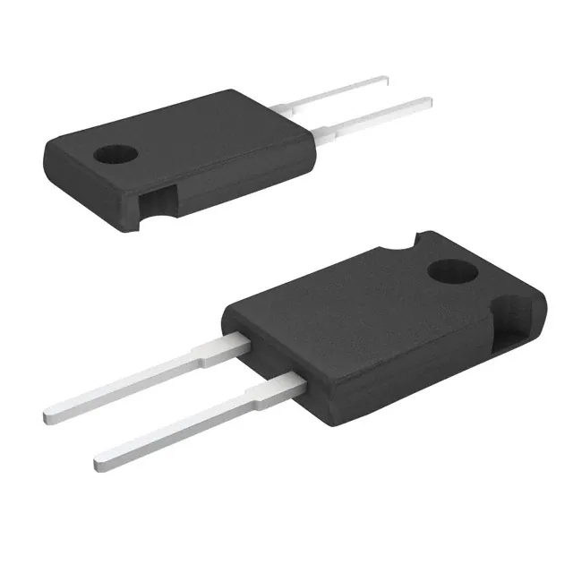

    插件电阻 20Ω ±1% 60W -20ppm/℃~+80ppm/℃
MP2060-20.0-1% 数据手册
MP2060 Kool-Pak® Clip Mount Power Film Resistor TO-220 Style Power Resistor Designed for Clip Mounting - Non-Inductive • • • • • • • • Up to 60 Watts continuous power at +25°C case temperature, 0.020Ω and above. Up to 60 Amps continuous current at +25°C case temperature, 0.015Ω and below. TO-220 Style package utilizes proven power semiconductor thermal solutions. Equivalent to UL94 V-0 flammability rating. Excellent pulse/surge performance. Non-inductive design for high speed switching, snubbers and rf applications. Operation up to +150°C case temperature. Electrically isolated case. Model Package Power Rating Resistance 0.010Ω TO-220 Style 0.015Ω RATED POWER % 0.020Ω to 1.00K Derating Curve 100 80 60 40 20 0 25 100 150 CASE TEMPERATURE, °C Current Limited Current Limited Current Limited 60 Arms 18 Watts 0.005Ω MP2060 * 36 Watts * 54 Watts * 60 Watts * Max. Current Max. Rating (Amps) Voltage 60 Arms 60 Arms I= 250 Vrms P/R Thermal Resistance RθJC Film (J) to Case (C) 6.94°C/Watt 3.47°C/Watt 2.31°C/Watt 2.08°C/Watt * Derating Using Case Temperature (TC): All power and associated overload ratings are derated based upon case temperature using the derating curve. The case temperature is measured at the center of the ceramic mounting surface, with the part properly mounted and under electrical load. Without a heat sink, when in free air at +25°C, the MP2060 is rated for 2.5 watts. The thermal design should satisfy the following equation: Case Temperature (Tc) + [Thermal Resistance (RθJC) x power applied (Watts)] ≤ 150°C, considering the full operating temperature range of the application. Mounting Note: Mount on a smooth, clean and flat heat sink surface with a thermal interface material, such as thermal grease. The entire exposed ceramic portion must be in contact with the heat sink. When using a spring clip, it is recommended that a mounting force of 8 to 30 pounds (35 to 130 N) be applied to the center of the package. The clip should be round or smooth in the contact area to avoid concentrating the load on a small point of the plastic body of the package. Another mounting option is to use a pressure bar method which can achieve a greater mounting force with a greater contact area. For additional applications information regarding mounting and pulse handling see the Caddock Applications Notes at caddock.com or contact Applications Engineering. 0.175 ± 0.010 (4.45 ± 0.26) 0.410 ± 0.010 (10.41 ± 0.26) 0.150 ± 0.030 (3.81 ± 0.76) 0.640 ± 0.010 (16.26 ± 0.26) MP2060 50.0 1% 0.100 ± 0.020 (2.54 ± 0.51) 0.500 ± 0.050 (12.70 ± 1.27) 0.050 ± 0.007 (1.27 ± 0.18) 0.200 ± 0.010 (5.08 ± 0.26) 0.035 ± 0.007 (0.89 ± 0.18) 0.105 ± 0.010 (2.67 ± 0.26) DIMENSIONS IN INCHES AND (MILLIMETERS) Ordering Information: Model Number: Standard Resistance Values: Tolerance: 1% Standard (except as noted) 0.005 Ω 5% 0.010 Ω 2% 0.015 Ω 2% 0.020 Ω 0.025 Ω 0.030 Ω 0.033 Ω 0.040 Ω 0.050 Ω 0.075 Ω 0.10 Ω 0.15 Ω 0.20 Ω 0.25 Ω 0.30 Ω 10.0 Ω 12.0 Ω 15.0 Ω 20.0 Ω 25.0 Ω 27.0 Ω 30.0 Ω 33.0 Ω 40.0 Ω 47.0 Ω 50.0 Ω 56.0 Ω 75.0 Ω 100 Ω 120 Ω 150 Ω 200 Ω 250 Ω 300 Ω 330 Ω 400 Ω 470 Ω 500 Ω 560 Ω 750 Ω 1.00 K For custom values and tolerances contact Applications Engineering MP2060 - 0.050 - 1% Resistor Value: 0.33 Ω 0.40 Ω 0.50 Ω 0.75 Ω 1.00 Ω 1.50 Ω 2.00 Ω 2.50 Ω 3.00 Ω 3.30 Ω 4.00 Ω 5.00 Ω 7.50 Ω 8.00 Ω Tolerance Packaging Information: MP2060 resistors are packaged in plastic shipping tubes, 50 pieces per tube. These resistors are available in a 50 piece minimum quantity and in full tube quantity increments (i.e. 50, 100, 150, etc.). ELECTRONICS, INC. e-mail: caddock@caddock.com • web: www.caddock.com For Caddock Distributors listed by country see caddock.com/contact/dist.html © 2003-2017 Caddock Electronics, Inc. New Clip M Value ount 0.005s to � These products are covered by one or more patents, also patents pending. Specifications: Temperature Coefficient: TC referenced to +25°C, ∆R taken at +150°C 0.50 ohm and above, -20 to +80 ppm/°C 0.050 ohm to 0.49 ohm, 0 to +100 ppm/°C 0.015 ohm to 0.049 ohm, 0 to +200 ppm/°C 0.005 ohm to 0.014 ohm, 0 to +300 ppm/°C Operating Temperature: -55°C to +150°C Inductance: 10 nH typical in series when measured at the shoulder of the lead. Capacitance:
