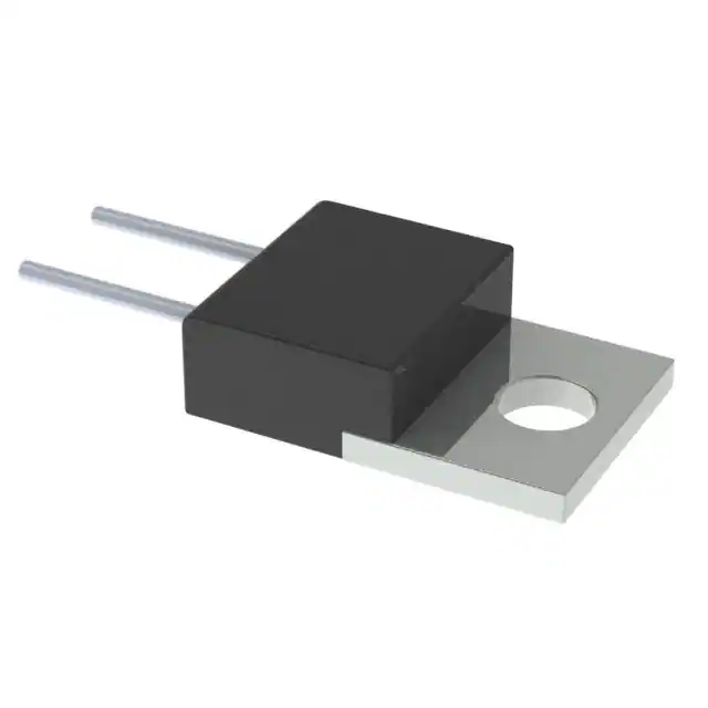

    插件电阻 TO220-2 200mΩ ±1% 20W 0~+200ppm/℃
MP821-0.20-1% 数据手册
MP800 Series Kool-Pak® Power Film Resistors TO-220 Style and TO-126 Style - Non-Inductive Designs Page 1 of 2 Use your thermal design experience with power semiconductors in TO-220 and TO-126 style power packages to help you get the most out of this unique family of power resistors. The thermal design issues are the same where power handling capability is based on the case temperature which is maintained in your design. MP820 and MP821 TO-220 Style Power Package with Metal Mounting Tab • • • • • • 20 Watts at +25°C Case Temperature derated to zero at +175°C. Metal Heat Sink Mounting Tab. MP820 Resistance Range of 10.0 ohm to 10.0 K. MP821 Resistance Range of 0.020 ohm to 9.99 ohm. Resistor element is electrically isolated from the mounting surface. Non-Inductive design for high speed switching, snubbers, and rf applications. Construction of MP820 and MP821: The MP820 and MP821 Kool-Tab® Power Film Resistors are constructed with Caddock's Micronox® resistance film fired onto a flat ceramic substrate which is thermally bonded to the copper heat sink tab. The resistor body is then molded with a high temperature molding compound to finish the metal tab TO-220 package. The lead wire attachment and resistance element geometry are configured to provide outstanding non-inductive performance. MP825 and MP850 Power Film Resistors Include an Integral Metal Mounting Surface for Highly Efficient Thermal Transfer MP821 Standard Resistance Values: Tolerance MP821: ±1% Standard (0.5%, 5%, and 20% are available for most resistance values). 0.020 Ω 0.025 Ω 0.030 Ω 0.033 Ω 0.040 Ω 0.050 Ω 0.075 Ω 0.10 Ω 0.15 Ω 0.20 Ω 0.25 Ω 0.30 Ω 0.33 Ω 0.40 Ω 0.50 Ω 0.75 Ω 1.00 Ω 1.50 Ω 2.00 Ω 2.50 Ω 3.00 Ω 3.30 Ω 4.00 Ω 5.00 Ω 7.50 Ω 8.00 Ω MP820 Standard Resistance Values: Tolerance MP820: ±1% Standard (0.5%, 5%, and 20% are available for most resistance values). 10.0 Ω 12.0 Ω 15.0 Ω 20.0 Ω 25.0 Ω 27.0 Ω 30.0 Ω 33.0 Ω 40.0 Ω 47.0 Ω 50.0 Ω 56.0 Ω 75.0 Ω 100 Ω 120 Ω 150 Ω 200 Ω 250 Ω 300 Ω 330 Ω 400 Ω 470 Ω 500 Ω 560 Ω 750 Ω 1.00 K 1.50 K 2.00 K 2.50 K 3.00 K 3.30 K 4.00 K 5.00 K 7.50 K 10.0 K MP825 TO-126 Style Power Package • • • • • 25 Watts at +25°C Case Temperature derated to zero at +150°C. Copper Heat Sink Integral in the Molded Package. Resistance Range of 0.020 ohm to 10.0 K. Resistor element is electrically isolated from the mounting surface. Non-inductive Design. • • • • • 50 Watts at +25°C Case Temperature derated to zero at +150°C. Copper Heat Sink Integral in the Molded Package. Resistance Range of 0.20 ohm to 10.0 K. Resistor element is electrically isolated from the mounting surface. Non-inductive Design. MP850 TO-220 Style Power Package Construction of MP825 and MP850: Kool-Pak® The MP825 and MP850 Power Film Resistors are constructed with Caddock's Micronox® resistance film fired onto a flat ceramic substrate. The ceramic substrate is bonded to a copper heat sink which becomes the metal mounting surface. This assembly is molded with the copper heat sink flush with the back surface of the part. The terminal attachment and resistance element geometry are configured to provide outstanding non-inductive performance. Ordering Information: Model Number: Resistor Value: MP850 - 50.0 - 1% Tolerance MP825: ±1% standard (except as noted), (0.5%, 5%, and 20% are available for most resistance values). 0.020 Ω 5% 0.025 Ω 5% 0.030 Ω 5% 0.033 Ω 5% 0.040 Ω 5% 0.050 Ω 0.075 Ω 0.10 Ω 0.15 Ω 0.20 Ω 0.25 Ω 0.30 Ω 0.33 Ω 0.40 Ω 0.50 Ω 0.75 Ω 1.00 Ω 1.50 Ω 2.00 Ω 2.50 Ω 3.00 Ω 3.30 Ω 4.00 Ω 5.00 Ω 7.50 Ω 8.00 Ω 10.0 Ω 12.0 Ω 15.0 Ω 20.0 Ω 25.0 Ω 27.0 Ω 30.0 Ω 33.0 Ω 40.0 Ω 47.0 Ω 50.0 Ω 56.0 Ω 75.0 Ω 100 Ω 120 Ω 150 Ω 200 Ω 250 Ω 300 Ω 330 Ω 400 Ω 470 Ω 500 Ω 560 Ω 750 Ω 1.00 K 1.50 K 2.00 K 2.50 K 3.00 K 3.30 K 4.00 K 5.00 K 7.50 K 10.0 K MP850 Standard Resistance Values: Tolerance Packaging: MP800 Series Resistors are packaged in plastic shipping tubes, 50 pieces per tube when the order quantity permits. For custom resistance values and tolerances contact applications engineering Certain products shown in this catalog are covered by one or more patents, there are also patents pending. ELECTRONICS, INC. e-mail: caddock@caddock.com • web: www.caddock.com For Caddock Distributors listed by country see caddock.com/contact/dist.html © 2003-2020 Caddock Electronics, Inc. MP825 Standard Resistance Values: Tolerance MP850: ±1% standard, (0.5%, 5%, and 20% are available for most resistance values). 0.20 Ω 0.25 Ω 0.30 Ω 0.33 Ω 0.40 Ω 0.50 Ω 0.75 Ω 1.00 Ω 1.50 Ω 2.00 Ω 2.50 Ω 3.00 Ω 3.30 Ω 4.00 Ω 5.00 Ω 7.50 Ω 8.00 Ω 10.0 Ω 12.0 Ω 15.0 Ω 20.0 Ω 25.0 Ω 27.0 Ω 30.0 Ω 33.0 Ω 40.0 Ω 47.0 Ω 50.0 Ω 56.0 Ω 75.0 Ω 100 Ω 120 Ω 150 Ω 200 Ω 250 Ω 300 Ω 330 Ω 400 Ω 470 Ω 500 Ω 560 Ω 750 Ω 1.00 K 1.50 K 2.00 K 2.50 K 3.00 K 3.30 K 4.00 K 5.00 K 7.50 K 10.0 K Sales and Applications Engineering 17271 North Umpqua Hwy. Roseburg, Oregon 97470-9422 Phone: (541) 496-0700 Fax: (541) 496-0408 28_IL103.0420 Resistance Min. Max. Model No. Package MP820 TO-220 Style 10.0 Ω 10.0 K MP821 TO-220 Style 0.020 Ω 9.99 Ω 20 Watts* MP825 TO-126 Style 0.020 Ω 10.0 K 25 Watts* MP850 TO-220 Style 0.20 Ω 10.0 K 50 Watts* POWER RATING, % Max.Vo ltage 20 Watts* 300 Thermal Resistance RθJC Film (J) to Case (C) Page 2 of 2 Max. Temp. T MAX Dimensions Comments 7.50°C/Watt 175°C Figure 1 Metal Mounting Tab 7.50°C/Watt 175°C Figure 1 Metal Mounting Tab 300 5.00°C/Watt 150°C Figure 2 Integral Metal Mounting Surface in Molded Package 300 2.50°C/Watt 150°C Figure 3 Power Limited Derating Curve 100 * Derating Using Case Temperature (TC): 80 60 40 A 20 0 Power Rating 25 B 100 150 175 CASE TEMPERATURE, °C All power and associated overload ratings are derated based upon case temperature using the derating curve. The case temperature is measured at the center of the metal mounting surface, with the part properly mounted and under electrical load. Without a heat sink, when in free air at +25°C, the MP820, MP821, and MP850 are rated for 2.25 watts, the MP825 is rated for 1.25 watts. A - MP825 / MP850 Max. Temperature, TMax = 150°C Case Temperature (Tc ) + [Thermal Resistance (RθJC) x power applied (Watts)] ≤ TMAX considering the full operating temperature range of the application. Mounting Note: Mount on a smooth, clean and flat heat sink surface with a thermal interface material, such as thermal grease. The entire exposed metal backface portion must be in thermal contact with the heat sink. When screw mounting, use a compression washer which provides a mounting force of 150 to 300 pounds (665 to 1330 N). This will provide sufficient pressure on the package over time and through large temperature variations to maintain the maximum power dissipation capability. Mounting torque to avoid package damage is 8 in-lbs (0.90 N-m). If a spring clip is used, a clip force of 8 to 30 pounds (35 to 130 N) is recommended to be applied to the center of the package. The clip should be round or smooth in the contact area to avoid concentrating the load on a small point of the plastic body of the package. Another mounting option is to use a pressure bar method which can achieve a greater mounting force with a greater contact area. For additional applications information regarding mounting and pulse handling see the Caddock Applications Notes at caddock.com or contact Applications Engineering. .400 ±.010 (10.16 ±.26) .142 ±.003 (3.61 ±.08) DIA. CL .240 ±.010 (6.10 ±.26) MP820 50.0 1% .540 ±.040 (13.72 ±1.02) .117 ±.003 (2.97 ±.08) Figure 2 TO-126 Style MP825 .320 ±.010 (8.12 ±.26) CL MP825 0.10 Ω 1% .115 ±.010 (2.92 ±.26) .030 ±.004 (.76 ± .10) .200 ±.010 (5.08 ±.26) Figure 3 TO-220 Style MP850 .130 ±.030 (3.30 ±.76) .500 ±.050 (12.70 ±1.27) .410 ±.010 (10.41 ±.26) CL .440 ±.010 (11.18 ±.26) MP850 10.0 1% .023 ± .004 (.58 ±.10) .058 ±.007 (1.47 ±.18) .125 ±.010 (3.18 ±.26) .125 ±.010 (3.18 ±.26) .640 ±.010 (16.26 ±.26) .030 ±.004 (.76 ± .10) .025 ± .004 (.64 ±.10) .070 ±.010 (1.78 ±.26) ELECTRONICS, INC. e-mail: caddock@caddock.com • web: www.caddock.com For Caddock Distributors listed by country see caddock.com/contact/dist.html © 2003-2020 Caddock Electronics, Inc. Temperature Coefficient: TC referenced to +25°C, ∆R taken at TMAX 5.00 ohms and above, -20 to +50 ppm/°C 0.50 ohm to 4.99 ohms, -20 to +80 ppm/°C 0.050 ohm to 0.49 ohm, 0 to +200 ppm/°C 0.020 ohm to 0.049 ohm, 0 to +300 ppm/°C Inductance: 10nH typical in series when measured at a point 0.2 inches from the resistor body. DWV: The dielectric strength rating of 1500 VrmsAC is based upon connections made between terminals shorted and either the metal surface the part is mounted to or a metal clip in contact with the top surface of the part. Insulation Resistance: 10,000 Megohms, min. The resistor element is electrically isolated from the mounting surface. Load Stability: 2,000 hours at rated power. ∆R ±(1.0 percent + 0.001 ohm) max. Power rating dependent upon case temperature. See derating curve. Momentary Overload: MP820, MP821, MP850: 2 times rated power with applied voltage not to exceed 1.5 times maximum continuous operating voltage for 5 seconds. ∆R ±(0.3 percent + 0.001 ohm) max. MP825: 1.5 times rated power with applied voltage not to exceed 1.5 times maximum continuous operating voltage for 5 seconds. ∆R ±(0.3 percent + 0.001 ohm) max. Moisture Resistance: Mil-Std-202, Method 106. ∆R ±(0.5 percent + 0.001 ohm) max. Thermal Shock: Mil-Std-202, Method 107, Cond. F. ∆R ±(0.3 percent + 0.001 ohm) max. Shock: 100G, Mil-Std-202, Method 213, Cond. I. ∆R ±(0.2 percent + 0.001 ohm) max. Vibration, High Frequency: Mil-Std-202, Method 204, Cond. D. ∆R ±(0.2 percent + 0.001 ohm) max. Terminal Strength: Mil-Std-202, Method 211, Cond. A (Pull Test) 5 lbs. ∆R ±(0.2 percent + 0.001 ohm) max. Terminal Material: Solderable .053 ± .007 (1.35 ± .18) .200 ±.010 (5.08 ±.26) DIMENSIONS IN INCHES AND (MILLIMETERS) .097 ±.010 (2.46 ±.26) .053 ± .007 (1.35 ± .18) .450 ±.050 (11.43 ±1.27) .125 ±.004 (3.18 ±.10) DIA. .580 ±.010 (14.73 ±.26) .110 ±.010 (2.79 ±.26) + .080 ±.020 (2.03 ±.51) .175 ±.015 (4.45 ±.38) .052 ±.003 (1.32 ±.08) .032 ± .004 DIA. (.81 ± .10) .200 ±.010 (5.08 ±.26) .094 ±.004 (2.39 ±.10) DIA. Specifications: Operating Temperature: -55°C to TMAX B - MP820 / MP821 Max. Temperature, TMax = 175°C The thermal design should satisfy the following equation: Figure 1 Metal Tab TO-220 Style MP820 and MP821 Integral Metal Mounting Surface in Molded Package Measurement Note: For these specifications, resistance measurement shall be made at a point 0.2 inch (5.08 mm) from the resistor body. Sales and Applications Engineering 17271 North Umpqua Hwy. Roseburg, Oregon 97470-9422 Phone: (541) 496-0700 Fax: (541) 496-0408 28_IL103.0420
MP821-0.20-1%
物料型号: - MP820:TO-220样式,金属安装片,电阻范围10.0欧姆至10.0千欧姆。 - MP821:TO-220样式,电阻范围0.020欧姆至9.99欧姆。 - MP825:TO-126样式,电阻范围0.020欧姆至10.0千欧姆。 - MP850:TO-220样式,电阻范围0.20欧姆至10.0千欧姆。
器件简介: 这些电阻器采用Caddock的Micronox®电阻膜,烧录在平面陶瓷基板上,并与铜散热器热结合。电阻体与安装表面电气隔离,具有非感性设计,适用于高速开关、扼流圈和射频应用。
引脚分配: 文档中未明确提供引脚分配信息,但提到了电阻体与金属安装片的配置,以提供出色的非感性性能。
参数特性: - 所有型号的电阻器在+25°C的外壳温度下均有特定的功率等级,并随温度升高而降低。 - 电阻器具有金属安装片,有助于散热。 - 提供多种标准电阻值和公差选项。
功能详解: - 非感性设计允许在高速开关应用中使用,减少了电磁干扰。 - 电阻器的热设计考虑了外壳温度,以维持设计中的功率处理能力。
应用信息: - 适用于需要高功率处理和良好散热的应用场合。 - 提供了安装注意事项,包括使用热界面材料和适当的安装扭矩。
封装信息: - 提供了不同样式(TO-220和TO-126)的封装尺寸和最大电压、热阻、最大工作温度等参数。
