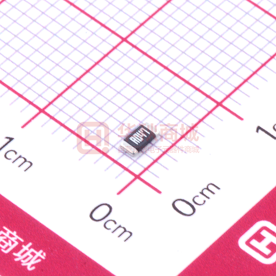

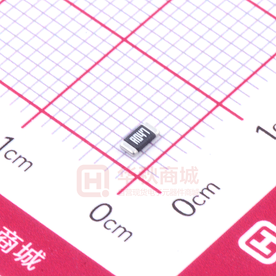

LMJ12MF1P0R047
LMJ12MF1P0R047
    PROSEMI(普罗森美)
    1206
    电流采样电阻 1206 47mΩ ±1% ±50ppm/℃ 1W
LMJ12MF1P0R047 数据手册
Current Sensing Resistors LMJ12 Series Description Proprietary processing technique produces extremely low resistance values Very low inductance Low thermal EMF Metallic Material Part Numbering System LMJ 12 M x xPx Rxxx Resistance Code R003 : 3mΩ R020 : 20 mΩ Power Rating 0P5 : 0.5W 1P0 : 1W Series Metal foil Size 12: 1206 (3216) Material M:MnCu Resistance Tol. F: ± 1% G: ±2% J: ±5% Standard Parameter Power Rating 0.5~1W Resistance Value 1~30m Ω Operating Temperature Range -55 to +170°C Component Temperature Coefficient (TCR) ± 50 ppm/°C Maximum Working Voltage (V) (P x R)1/2 Dimensions L C W d Unit: Millimeters Style L W LMJ 12 3.2 ±0.2 1.6 ±0.2 Specifications are subject to change without notice. C PROSEMI Document No : EPG121001824 C d 1.1±0.3 (1mΩ) 0.5±0.3 (2~30m Ω) 1 of 2 0.75± 0.2 Rev.D 06/15/2016 www.prosemitech.com Current Sensing Resistors LMJ12 Series Recommended land pattern a1 a Unit: Millimeters Resistance Range (Ω) d a a1 d 0.001 1.0 2.3 1.8 0.002~0.030 1.6 1.7 1.8 Typical sensing traces Packaging Quantity: 5, 000pcs 8mm wide tape on 178mm(7 inch) diameter reel -specification EIA Standard 481. Performance Test Items Thermal shock Short time overload Low temperature operation High temperature exposure Moisture resistance Load life Resistance to bonding exposure Conditions of Test - 55 °C to + 150 °C, 300 cy cles, 15 min at each extreme 5 x rated power for 5 s - 55 °C, 1000 h 1000h at + 170 °C MIL-STD- 202, method 106, 0 % power, 7b not required 1000 h at 70 °C , 1.5 h "ON", 0.5 h "OFF" 260 °C for 10 s Test Limits ± 1.0 % ± 0.5 % ± 0.5 % ± 1.0 % ± 1.0 % ± 1.0 % ± 0.5 % Power Ratio (%) Derating Curve 100 -55 70 170 Ambient Temperature (°C) Specifications are subject to change without notice. C PROSEMI Document No : EPG121001824 2 of 2 Rev.D 06/15/2016 www.prosemitech.com
