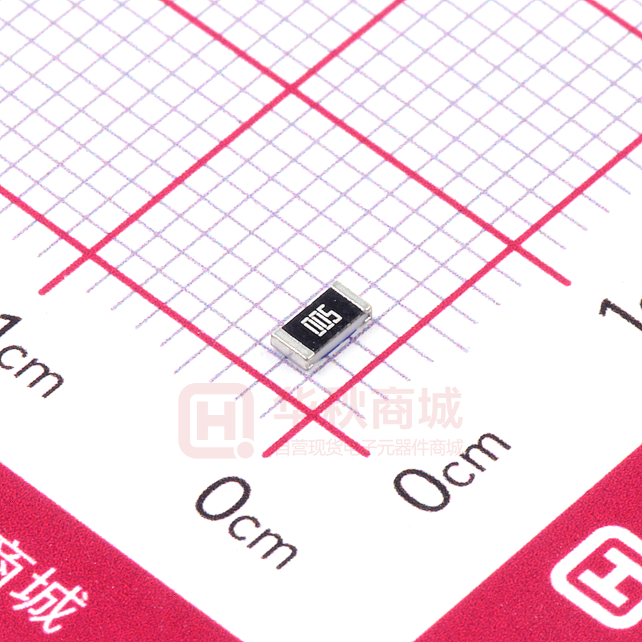

    电流采样电阻 1206 5mΩ ±1% ±50ppm/℃ 1W
LMS12CF1P0R005 数据手册
Current Sensing Resistors LMS Series RoHS 2015/863/EC Description Proprietary processing technique produces extremely low resistance values Very low inductance Low thermal EMF Metallic Material Part Numbering System LMS 08 C x xPx Rxxx Resistance Code R003 : 3mΩ R0065 : 6.5mΩ R020 : 20 mΩ Power Rating 0P5 : 0.5W 1P0 : 1W Series Size 08: 0805 (2012) 12: 1206 (3216) Material Resistance Tol. F: ± 1% G: ±2% J: ±5% Specifications Type Size Power Tolerance (mΩ) (W) LMS08 0805 0.75 LMS12 1206 1.0 Resistance Value ±1% ±2% ±5% Operation Temperature Range T.C.R -55 ~+155℃ ±50ppm/℃ 5 ~ 30 mΩ 5 ~ 40 mΩ Dimensions L C Unit: Millimeters W d Type L W C d LMS08 2.00±0.20 1.25±0.20 0.40±0.30 0.70±0.20 LMS12 3.20±0.20 1.60±0.20 0.50±0.30 0.70±0.20 Specifications are subject to change without notice. C PROSEMI Document No:P0R0210133117003 1 of 2 www.prosemitech.com Current Sensing Resistors LMS Series Recommended land pattern Unit: Millimeters Series L Resistance (mΩ) A L 1.4 3.2 5 ≦ R < 10 LMS08 B 10 ≦ R ≦ 30 0.8 1.2 5 ≦ R < 10 A LMS12 10 ≦ R < 20 20 ≦ R ≦ 40 Cu Trace B 1.2 1.8 4.7 1.8 2.2 Sensing Trace Packaging Type Pieces/Package LMS08 4,000 8mm wide tape on 178mm(7 inch) diameter reel -specification EIA Standard 481. LMS12 4,000 Performance Test Items Thermal shock Short time overload Low temperature operation High temperature exposure Moisture resistance Load life Resistance to bonding exposure Conditions of Test - 55 °C to + 150 °C, 300 cycles, 15 min at each extreme 5 x rated power for 5 s - 55 °C, 1000 h 1000h at + 170 °C MIL-STD- 202, method 106, 0 % power, 7b not required 1000 h at 70 °C , 1.5 h "ON", 0.5 h "OFF" 260 °C for 10 s Test Limits ± 1.0 % ± 0.5 % ± 0.5 % ± 1.0 % ± 1.0 % ± 1.0 % ± 0.5 % Power Ratio (%) Derating Curve 100 -55 70 170 Ambient Temperature (°C) Specifications are subject to change without notice. C PROSEMI Document No:P0R0210133117003T 2 of 2 www.prosemitech.com
