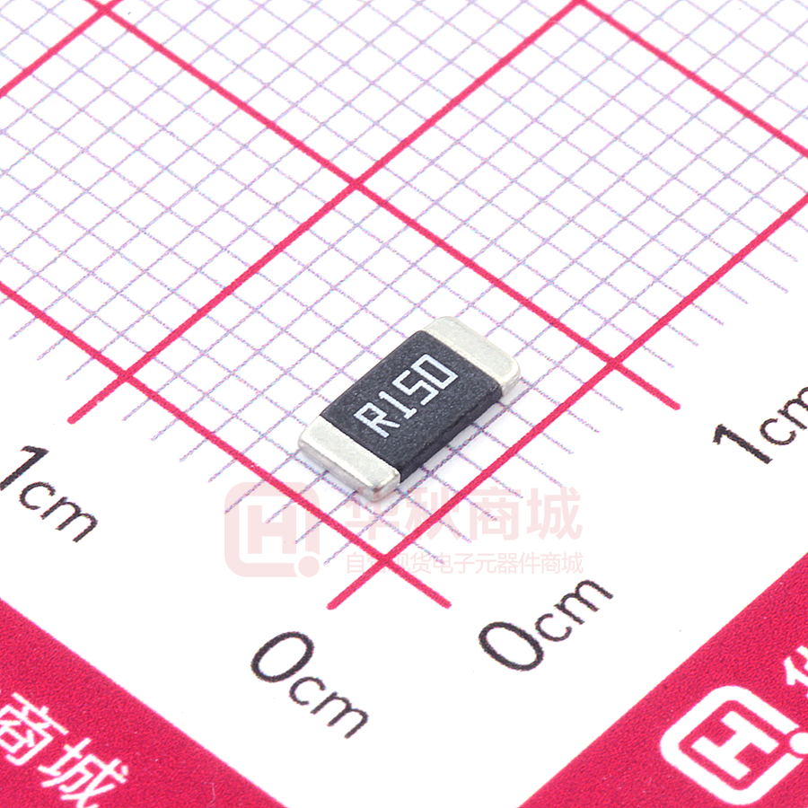

    电流采样电阻 2512 150mΩ ±1% ±50ppm/℃ 2W
LMP25KF2P0R150 数据手册
Current Sensing Resistors LMP25 Series Description Proprietary processing technique produces extremely low resistance values Very low inductance Low thermal EMF Metallic Material Part Numbering System LMP 25 N F 3P0 R001 - S Wide electrode Resistance Code R001 : 1mΩ R010 : 10mΩ Power Rating R500 : 500 mΩ 2P0 : 2W 3P0 : 3W Series Metal foil Size 25: 2512(6432) Material M:MnCu N :N i Cu K :Kamar Resistance Tol. F: ± 1% G: ±2% J: ±5% Standard Parameter 1mΩ~100mΩ : 3W 1mΩ~500mΩ : 2W Power Rating 1~500mΩ Resistance Value Operating Temperature Range -55 to +170°C ± 50 ppm/°C Component Temperature Coefficient (TCR) (P x R)1/2 Maximum Working Voltage (V) Standard Electrical Specifications Type Rating T.C.R. Power at (ppm/℃) 70℃ 2W 50 LMP25 3W 50 Specifications are subject to change without notice. C PROSEMI Document No:P0R0210130418001L Resistance Range(mΩ) 1.0%(F) 2.0%(G) 5.0%(J) Meterial Electrode 1-10 R001-R010:MnCu R001-R004:Wide 1-100 R001-R100:NiCu R005-R100:Narrow 101-500 R101-R500:Kamar R101-R500:Narrow 1-100 R001- R100:MnCu R001-R004:Wide 1-100 R001-R100:NiCu R005-R100:Narrow 1 of 4 Operating Temperature(℃) -55~+170°C www.prosemitech.com Current Sensing Resistors LMP25 Series Unit: Millimeters Type Power L W 2W 6.4 ±0.2 3.2 ±0.2 3W 6.4 ±0.2 3.2 ±0.2 t C 1.0±0.2 (Narrow) 2.2±0.2 (Wide) LMP25 1.0±0.2 (Narrow) 2.2±0.2 (Wide) 0.7±0.2 0.9±0.2 Recommended land pattern Unit: Millimeters Specifications are subject to change without notice. C PROSEMI Document No:P0R0210130418001L Resistance Range (Ω ) a b L 0.001-0.004(Wide) 4.0±0.1 3.1±0.1 1.3±0.1 0.005~0.500(Narrow) 4.0±0.1 2.1±0.1 4.1±0.1 2 of 4 www.prosemitech.com Current Sensing Resistors LMP25 Series Tapping & Package Type A ±0.2 Pack B ±0.2 D0 +0.5-0 E ±0.1 F ±0.05 P0 ±0.1 P1 ±0.1 P2 ±0.1 W ±0.2 D1 ±0.05 T ±0.15 Reel Specification Type A 2512 2.00±0.5 B 13.50±0.5 Specifications are subject to change without notice. C PROSEMI Document No:P0R0210130418001L C D M W 21.00±0.5 80.00±1.0 178.00±2.0 13.80±0.5 3 of 4 www.prosemitech.com Current Sensing Resistors LMP25 Series Performance Test Items Thermal shock Short time overload Low temperature operation High temperature exposure Moisture resistance Load life Resistance to bonding exposure Conditions of Test - 55 °C to + 150 °C, 300 cycles, 15 min at each extreme 5 x rated power for 5 s - 55 °C, 1000 h 1000h at + 170 °C MIL-STD- 202, method 106, 0 % power, 7b not required 1000 h at 70 °C , 1.5 h "ON", 0.5 h "OFF" 260 °C for 10 s Test Limits ± 1.0 % ± 0.5 % ± 0.5 % ± 1.0 % ± 1.0 % ± 1.0 % ± 0.5 % Derating Curve Packaging Quantity: 4, 000pcs 8mm wide tape on 178mm(7 inch) diameter reel -specification EIA Standard 481. Specifications are subject to change without notice. C PROSEMI Document No:P0R0210130418001L 4 of 4 www.prosemitech.com
