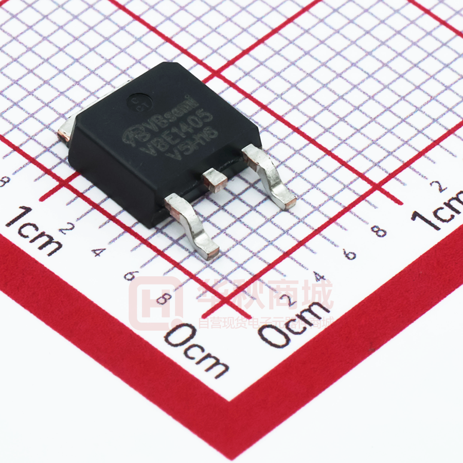

VBE1405 www.VBsemi.com N-Channel 40-V (D-S) MOSFET FEATURES PRODUCT SUMMARY VDS (V) 40 RDS(on) (Ω) ID (A)a, c 0.0050 at VGS = 10 V 85 0.0065 at VGS = 4.5 V 70 Qg (Typ.) • TrenchFET® Power MOSFET • 100 % Rg and UIS Tested RoHS 80 nC COMPLIANT APPLICATIONS • Synchronous Rectification • Power Supplies D TO-252 G G D S S N-Channel MOSFET ABSOLUTE MAXIMUM RATINGS TA = 25 °C, unless otherwise noted Symbol Limit Drain-Source Voltage VDS 40 Gate-Source Voltage VGS ± 25 Parameter TC = 70 °C TA = 25 °C c 70 ID 59 b Pulsed Drain Current IDM Avalanche Current Pulse IAS 80 EAS 320 Continuous Source-Drain Diode Current L = 0.1 mH TC = 25 °C TA = 25 °C 250 110 IS TC = 70 °C TA = 25 °C A 312a 200 PD W 3.13b 2.0b TA = 70 °C TJ, Tstg Operating Junction and Storage Temperature Range V a, c 2.6b TC = 25 °C Maximum Power Dissipation A 53b TA = 70 °C Single Pulse Avalanche Energy V 85 a, c TC = 25 °C Continuous Drain Current (TJ = 175 °C) Unit - 55 to 150 °C THERMAL RESISTANCE RATINGS Parameter Maximum Junction-to-Ambientb Maximum Junction-to-Case Steady State Steady State Symbol RthJA RthJC Typical Maximum Unit 32 0.33 40 0.4 °C/W Notes: a. Based on TC = 25 °C. b. Surface Mounted on 1" x 1" FR4 board. c. Calculated based on maximum junction temperature. Package limitation current is 110 A. 1 VBE1405 www.VBsemi.com SPECIFICATIONS TJ = 25 °C, unless otherwise noted Parameter Symbol Test Conditions Min. VDS VGS = 0 V, ID = 250 µA 40 Typ. Max. Unit Static Drain-Source Breakdown Voltage VDS Temperature Coefficient ΔVDS/TJ V 41 ID = 250 µA mV/°C VGS(th) Temperature Coefficient ΔVGS(th)/TJ Gate-Source Threshold Voltage VGS(th) VDS = VGS, ID = 250 µA 2.5 V IGSS VDS = 0 V, VGS = ± 20 V ± 100 nA VDS = 40 V, VGS = 0 V 1 VDS = 40 V, VGS = 0 V, TJ = 55 °C 10 Gate-Source Leakage Zero Gate Voltage Drain Current IDSS On-State Drain Currenta ID(on) Drain-Source On-State Resistancea Forward Transconductancea RDS(on) gfs VDS ≥ 5 V, VGS = 10 V -8 1.2 120 µA A VGS = 10 V, ID = 30 A 0.0050 0.0064 VGS = 4.5 V, ID = 20 A 0.0065 0.0075 VDS = 15 V, ID = 30 A 180 Ω S Dynamicb Input Capacitance Ciss Output Capacitance Coss Reverse Transfer Capacitance Crss 250 Total Gate Charge Qg 80 Gate-Source Charge Qgs Gate-Drain Charge Qgd Gate Resistance Rg Turn-On Delay Time Rise Time Turn-Off Delay Time Fall Time Turn-On Delay Time Rise Time Turn-Off Delay Time Fall Time 2380 VDS = 20 V, VGS = 0 V, f = 1 MHz VDS = 20 V, VGS = 10 V, ID = 20 A tr 120 20 nC 12 f = 1 MHz td(on) td(off) pF 550 VDD = 20 V, RL = 1.0 Ω ID ≅ 20 A, VGEN = 10 V, Rg = 1 Ω 0.85 1.3 20 30 11 17 77 115 tf 10 15 td(on) 102 155 tr td(off) VDD = 20 V, RL = 1.0 Ω ID ≅ 20 A, VGEN = 4.5 V, Rg = 1 Ω tf 62 95 180 270 60 90 Ω ns Drain-Source Body Diode Characteristics Continuous Source-Drain Diode Current IS Pulse Diode Forward Currenta ISM Body Diode Voltage VSD Body Diode Reverse Recovery Time trr Body Diode Reverse Recovery Charge Qrr Reverse Recovery Fall Time ta Reverse Recovery Rise Time tb TC = 25 °C 110 200 IS = 20 A IF = 20 A, di/dt = 100 A/µs, TJ = 25 °C A 0.8 1.2 V 50 75 ns 70 105 nC 30 20 ns Notes: a. Pulse test; pulse width ≤ 300 µs, duty cycle ≤ 2 %. b. Guaranteed by design, not subject to production testing. Stresses beyond those listed under “Absolute Maximum Ratings” may cause permanent damage to the device. These are stress ratings only, and functional operation of the device at these or any other conditions beyond those indicated in the operational sections of the specifications is not implied. Exposure to absolute maximum rating conditions for extended periods may affect device reliability. 2 VBE1405 www.VBsemi.com TYPICAL CHARACTERISTICS 25 °C, unless otherwise noted 250 5 VGS = 10 thru 5 V 4 I D - Drain Current (A) I D - Drain Current (A) 200 150 VGS = 4 V 100 VGS = 3 V 3 TC = 125 °C 2 TC = 25 °C 50 1 TC = - 55 °C 0 0.0 0 0.5 1.0 1.5 2.0 2.5 0 VDS - Drain-to-Source Voltage (V) 1 2 3 4 VGS - Gate-to-Source Voltage (V) Output Characteristics Transfer Characteristics 0.010 400 TC = - 55 °C R DS(on) - On-Resistance (Ω) g fs - Transconductance (S) 320 240 TC = 25 °C 160 TC = 125 °C 80 0.008 VGS = 4.5 V 0.006 0.004 VGS = 10 V 0.002 0.0000 0 0 30 15 45 60 75 0 90 20 ID - Drain Current (A) 40 60 80 100 120 ID - Drain Current (A) Transconductance On-Resistance vs. Drain Current 3000 10 ID = 20 A VGS - Gate-to-Source Voltage (V) C - Capacitance (pF) Ciss 2000 1000 Coss Crss 0 0 8 VDS = 20 V 6 VDS = 10 V VDS = 30 V 4 2 0 10 20 30 VDS - Drain-to-Source Voltage (V) Capacitance 40 0 50 100 150 200 250 Qg - Total Gate Charge (nC) Gate Charge 3 VBE1405 www.VBsemi.com TYPICAL CHARACTERISTICS 25 °C, unless otherwise noted 2.0 100 ID = 30 A 10 I S - Source Current (A) VGS = 10 V (Normalized) R DS(on) - On-Resistance 1.7 1.4 VGS = 4.5 V 1.1 TJ = 150 °C 0.1 0.8 0.01 0.5 - 50 - 25 0 25 50 75 100 125 0.001 0.0 150 0.2 0.4 0.6 1.0 TJ - Junction Temperature (°C) On-Resistance vs. Junction Temperature Forward Diode Voltage vs. Temperature 1.2 0.6 0.008 VGS(th) Variance (V) 0.2 0.006 0.004 TJ = 150 °C - 0.2 ID = 5 mA - 0.6 0.002 ID = 250 µA TJ = 25 °C - 1.0 - 50 0.000 0 2 6 4 8 10 - 25 1000 Limited by RDS(on)* 10 µs 100 µs I D - Drain Current (A) 100 1 ms 10 ms 100 ms, DC 10 1 TC = 25 °C Single Pulse BVDSS 0.01 0.1 25 50 75 Threshold Voltage On-Resistance vs. Gate-to-Source Voltage 0.1 0 TJ - Temperature (°C) VGS - Gate-to-Source Voltage (V) 1 10 100 VDS - Drain-to-Source Voltage (V) * VGS > minimum VGS at which RDS(on) is specified Safe Operating Area, Junction-to-Ambient 4 0.8 VSD - Source-to-Drain Voltage (V) 0.010 R DS(on) - On-Resistance (Ω) TJ = 25 °C 1 100 125 150 VBE1405 www.VBsemi.com TYPICAL CHARACTERISTICS 25 °C, unless otherwise noted 350 400 350 280 Power (W) I D - Drain Current (A) 300 210 140 Package Limited 250 200 150 100 70 50 0 0 0 25 50 75 100 125 150 0 25 50 75 100 TJ - Junction to Case (°C) TJ - Junction to Case (°C) Current Derating* Power Derating 125 150 * The power dissipation PD is based on TJ(max) = 150 °C, using junction-to-case thermal resistance, and is more useful in settling the upper dissipation limit for cases where additional heatsinking is used. It is used to determine the current rating, when this rating falls below the package limit. 1 Normalized Effective Transient Thermal Impedance Duty Cycle = 0.5 0.2 0.1 0.05 0.1 0.02 Single Pulse 0.01 10-4 10 -3 10-2 10 -1 1 Square Wave Pulse Duration (s) Normalized Thermal Transient Impedance, Junction-to-Case 5 VBE1405 www.VBsemi.com TO-252AA CASE OUTLINE E MILLIMETERS A C2 e b2 D1 e1 E1 L gage plane height (0.5 mm) L4 b L5 H D L3 b3 C A1 MIN. MAX. MIN. MAX. A 2.18 2.38 0.086 0.094 A1 - 0.127 - 0.005 b 0.64 0.88 0.025 0.035 b2 0.76 1.14 0.030 0.045 b3 4.95 5.46 0.195 0.215 C 0.46 0.61 0.018 0.024 C2 0.46 0.89 0.018 0.035 D 5.97 6.22 0.235 0.245 D1 5.21 - 0.205 0.265 E 6.35 6.73 0.250 E1 4.32 - 0.170 - H 9.40 10.41 0.370 0.410 e 2.28 BSC 0.090 BSC e1 4.56 BSC 0.180 BSC L 1.40 1.78 0.055 0.070 L3 0.89 1.27 0.035 0.050 L4 - 1.02 - 0.040 L5 1.14 1.52 0.045 0.060 ECN: X12-0247-Rev. M, 24-Dec-12 DWG: 5347 Note • Dimension L3 is for reference only. 6 INCHES DIM. VBE1405 www.VBsemi.com RECOMMENDED MINIMUM PADS FOR DPAK (TO-252) 0.224 0.243 0.087 (2.202) 0.090 (2.286) (10.668) 0.420 (6.180) (5.690) 0.180 0.055 (4.572) (1.397) Recommended Minimum Pads Dimensions in Inches/(mm) 7 VBE1405 www.VBsemi.com Disclaimer All products due to improve reliability, function or design or for other reasons, product specifications and data are subject to change without notice. Taiwan VBsemi Electronics Co., Ltd., branches, agents, employees, and all persons acting on its or their representatives (collectively, the "Taiwan VBsemi"), assumes no responsibility for any errors, inaccuracies or incomplete data contained in the table or any other any disclosure of any information related to the product.(www.VBsemi.com) Taiwan VBsemi makes no guarantee, representation or warranty on the product for any particular purpose of any goods or continuous production. To the maximum extent permitted by applicable law on Taiwan VBsemi relinquished: (1) any application and all liability arising out of or use of any products; (2) any and all liability, including but not limited to special, consequential damages or incidental ; (3) any and all implied warranties, including a particular purpose, non-infringement and merchantability guarantee. Statement on certain types of applications are based on knowledge of the product is often used in a typical application of the general product VBsemi Taiwan demand that the Taiwan VBsemi of. Statement on whether the product is suitable for a particular application is non-binding. It is the customer's responsibility to verify specific product features in the products described in the specification is appropriate for use in a particular application. Parameter data sheets and technical specifications can be provided may vary depending on the application and performance over time. All operating parameters, including typical parameters must be made by customer's technical experts validated for each customer application. Product specifications do not expand or modify Taiwan VBsemi purchasing terms and conditions, including but not limited to warranty herein. Unless expressly stated in writing, Taiwan VBsemi products are not intended for use in medical, life saving, or life sustaining applications or any other application. Wherein VBsemi product failure could lead to personal injury or death, use or sale of products used in Taiwan VBsemi such applications using client did not express their own risk. Contact your authorized Taiwan VBsemi people who are related to product design applications and other terms and conditions in writing. The information provided in this document and the company's products without a license, express or implied, by estoppel or otherwise, to any intellectual property rights granted to the VBsemi act or document. Product names and trademarks referred to herein are trademarks of their respective representatives will be all. Material Category Policy Taiwan VBsemi Electronics Co., Ltd., hereby certify that all of the products are determined to be RoHS compliant and meets the definition of restrictions under Directive of the European Parliament 2011/65 / EU, 2011 Nian. 6. 8 Ri Yue restrict the use of certain hazardous substances in electrical and electronic equipment (EEE) - modification, unless otherwise specified as inconsistent.(www.VBsemi.com) Please note that some documents may still refer to Taiwan VBsemi RoHS Directive 2002/95 / EC. We confirm that all products identified as consistent with the Directive 2002/95 / EC European Directive 2011/65 /. Taiwan VBsemi Electronics Co., Ltd. hereby certify that all of its products comply identified as halogen-free halogen-free standards required by the JEDEC JS709A. Please note that some Taiwanese VBsemi documents still refer to the definition of IEC 61249-2-21, and we are sure that all products conform to confirm compliance with IEC 61249-2-21 standard level JS709A.
