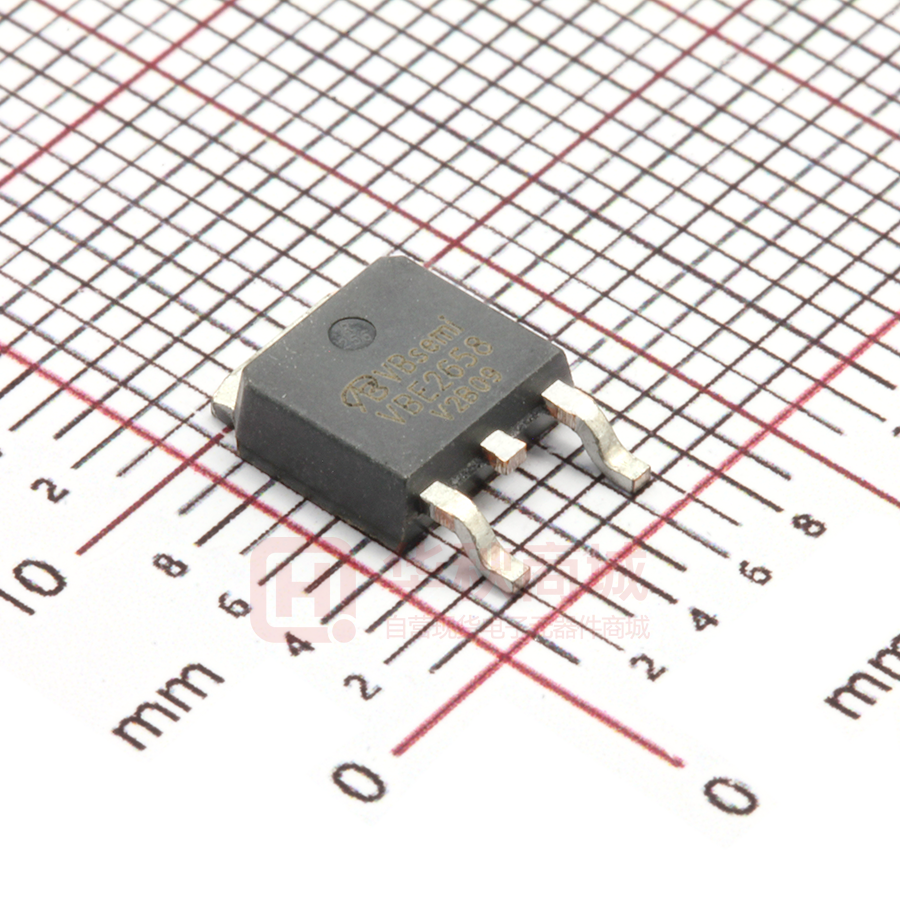

VBE2658
VBE2658
    VBSEMI(微碧)
    TO-252AA
    MOS管 P-Channel VDS=60V VGS=±20V ID=35A RDS(ON)=58mΩ@4.5V TO252AA
VBE2658 数据手册
VBE2658 www.VBsemi.com VBE2658 Datasheet P-Channel 60 V (D-S) MOSFET FEATURES PRODUCT SUMMARY RDS(on) () ID (A)d 0.046 at VGS = - 10 V - 35 0.058 at VGS = - 4.5 V - 30 VDS (V) - 60 • Halogen-free According to IEC 61249-2-21 Definition • Trench Power MOSFET • 100 % UIS Tested Qg (Typ) 26 • Compliant to RoHS Directive 2002/95/EC APPLICATIONS • High Side Switch for Full Bridge Converter • DC/DC Converter for LCD Display TO-252 S G Drain Connected to Tab G D S Top View D P-Channel MOSFET ABSOLUTE MAXIMUM RATINGS (TA = 25 °C, unless otherwise note) Parameter Symbol Limit Drain-Source Voltage VDS - 60 Gate-Source Voltage VGS ± 20 Continuous Drain Current (TJ = 150 °C) TC = 25 °C TC = 125 °C Avalanche Current, Single Pulse Repetitive Avalanche Energy, Single Pulsea Power Dissipation L = 0.1 mH TC = 25 °C TA = 25 °C - 25 A - 100 IAS - 22 EAS 24.2 38.5 PD mJ c W 2.3b, c TJ, Tstg Operating Junction and Storage Temperature Range V - 35 ID IDM Pulsed Drain Current Unit - 55 to 150 °C THERMAL RESISTANCE RATINGS Parameter Maximum Junction-to-Ambientb Maximum Junction-to-Case Notes: a. Duty cycle 1 %. b. When mounted on 1" square PCB (FR-4 material). c. See SOA curve for voltage derating. d. Based up on TC = 25 °C. Symbol t  10 s Steady State RthJA RthJC Typical Maximum Unit 17 45 2.7 21 55 3.25 °C/W 服务热线:400-655-8788 1 VBE2658 www.VBsemi.com SPECIFICATIONS (TJ = 25 °C, unless otherwise note) Parameter Symbol Test Conditions Min . Typ. Max. Unit -3 V nA Static Drain-Source Breakdown Voltage Gate Threshold Voltage Gate-Body Leakage VDS VGS = 0 V, ID = - 250 µA - 60 VGS(th) VDS = VGS, ID = - 250 µA -1 IGSS VDS = 0 V, VGS = ± 20 V ± 100 VDS = - 60 V, VGS = 0 V -1 VDS = - 60 V, VGS = 0 V, TJ = 125 °C - 50 Zero Gate Voltage Drain Current IDSS On-State Drain Currenta ID(on) V VDS = - 60 V, VGS = 0 V, TJ = 150 ° C Drain-Source On-State Resistancea a Forward Transconductance RDS(on) VDS  - 5 V, VGS = - 10 V - 125 - 20 A VGS = - 10 V, ID = - 10 A 0.046 VGS = - 10 V, ID = - 10 A, TJ = 125 °C 0.095 VGS = - 10 V, ID = - 10 A, TJ = 150 °C 0.115 VGS = - 4.5 V, ID = - 5 A 0.058 VDS = - 15 V, ID = - 10 A 22 gfs µA  S Dynamicb Input Capacitance Ciss Output Capacitance Coss Reverse Transfer Capacitance Crss 90 Total Gate Chargec Qg 26 c Gate-Source Charge Qgs Gate-Drain Chargec Qgd c Rise Timec Turn-Off Delay VDS = - 30 V, VGS = - 10 V, ID = - 10 A Fall Timec f = 1 MHz td(on) tr Timec td(off) VDD = - 30 V, RL = 3  ID  - 19 A, VGEN = - 10 V, Rg = 2.5  tf Drain-Source Body Diode and Characteristics (TC = 25 pF 130 40 nC 4.5 7 Rg Gate Resistance Turn-On Delay Time 1900 VGS = 0 V, VDS = - 25 V, f = 1 MHz  7 8 15 9 15 65 100 30 45 ns °C)b IS - 20 Pulsed Current ISM - 30 Forward Voltagea VSD IF = - 19 A, VGS = 0 V -1 - 1.5 V trr IF = - 19 A, di/dt = 100 A/µs 41 61 ns Continuous Current Reverse Recovery Time A Notes: a. Pulse test; pulse width  300 µs, duty cycle  2 %. b. Guaranteed by design, not subject to production testing. c. Independent of operating temperature. Stresses beyond those listed under “Absolute Maximum Ratings” may cause permanent damage to the device. These are stress ratings only, and functional operation of the device at these or any other conditions beyond those indicated in the operational sections of the specifications is not implied. Exposure to absolute maximum rating conditions for extended periods may affect device reliability. 服务热线:400-655-8788 2 VBE2658 www.VBsemi.com TYPICAL CHARACTERISTICS (25 °C, unless otherwise noted) 30 30 VGS = 10 thru 5 V 4V 25 ID - Drain Current (A) ID - Drain Current (A) 25 20 15 10 3V 5 20 15 10 TC = 125 °C 5 25 °C - 55 °C 0 0 2 4 6 8 0 0.0 10 0.5 1.0 VDS - Drain-to-Source Voltage (V) Output Characteristics 2.5 3.0 3.5 4.0 4.5 0.12 TC = - 55 °C 0.10 RDS(on) - On-Resistance (Ω) 30 g fs - Transconductance (S) 2.0 Transfer Characteristics 35 25 °C 25 125 °C 20 15 10 5 0 0.08 VGS = 4.5 V 0.06 VGS = 10 V 0.04 0.02 0.00 0 10 5 15 20 25 30 0 10 5 15 20 25 30 ID - Drain Current (A) VGS - Gate-to-Source Voltage (V) Transconductance On-Resistance vs. Drain Current 1800 20 V GS - Gate-to-Source Voltage (V) 1500 C - Capacitance (pF) 1.5 VGS - Gate-to-Source Voltage (V) Ciss 1200 900 600 300 Coss Crss 0 0 VDS = 30 V ID = 10 A 16 12 8 4 0 10 20 30 40 VDS - Drain-to-Source Voltage (V) Capacitance 50 60 0 10 20 30 40 50 Qg - Total Gate Charge (nC) Gate Charge 服务热线:400-655-8788 3 VBE2658 www.VBsemi.com TYPICAL CHARACTERISTICS (25 °C, unless otherwise noted) 40 ID = 10 A I S - Source Current (A) RDS(on) - On-Resistance (normalized) 1.9 VGS = 10 V 1.6 1.3 1.0 10 TJ = 150 °C TJ = 25 °C 0.7 1 0.4 - 50 - 25 0 25 50 75 100 125 150 0.0 0.6 0.3 0.9 1.2 1.5 VSD - Source-to-Drain Voltage (V) TJ - Junction Temperature (°C) On-Resistance vs. Junction Temperature Source-Drain Diode Forward Voltage THERMAL RATINGS 25 100 Limited by rDS(on)* 100 ms 10 I D - Drain Current (A) I D - Drain Current (A) 20 15 10 5 1s DC 0.1 BVDSS Limited 0.01 0 0 25 50 75 100 125 150 10 s 1 TC = 25 °C Single Pulse 0.001 0.1 TC - Case Temperature (°C) * VGS Maximum Drain Current vs. Case Temperature 1 10 100 1000 VDS - Drain-to-Source Voltage (V) minimum VGS at which rDS(on) is specified Safe Operating Area 2 Normalized Effective Transient Thermal Impedance 1 Duty Cycle = 0.5 0.2 0.1 0.1 0.05 0.02 Single Pulse 0.01 10- 4 10- 3 10 - 2 10 - 1 1 Square Wave Pulse Duration (sec) 10 100 600 Normalized Thermal Transient Impedance, Junction-to-Ambient 服务热线:400-655-8788 4 VBE2658 www.VBsemi.com THERMAL RATINGS 2 Normalized Effective Transient Thermal Impedance 1 Duty Cycle = 0.5 0.2 0.1 0.1 0.05 0.02 Single Pulse 0.01 10 -4 10 -3 10- 2 10 -1 1 10 100 Square Wave Pulse Duration (sec) Normalized Thermal Transient Impedance, Junction-to-Case 服务热线:400-655-8788 5 VBE2658 www.VBsemi.com TO-252AA Case Outline E C2 L3 H D b2 D1 e1 E1 L gage plane height (0.5 mm) e L5 L4 b C A1 INCHES MILLIMETERS A b3 DIM. MIN. MAX. MIN. MAX. A 2.18 2.38 0.086 0.094 A1 - 0.127 - 0.005 b 0.64 0.88 0.025 0.035 b2 0.76 1.14 0.030 0.045 b3 4.95 5.46 0.195 0.215 0.024 C 0.46 0.61 0.018 C2 0.46 0.89 0.018 0.035 D 5.97 6.22 0.235 0.245 D1 4.10 - 0.161 - E 6.35 6.73 0.250 0.265 E1 4.32 - 0.170 - H 9.40 10.41 0.370 0.410 e 2.28 BSC e1 0.090 BSC 4.56 BSC 0.180 BSC L 1.40 1.78 0.055 0.070 L3 0.89 1.27 0.035 0.050 L4 - 1.02 - 0.040 L5 1.01 1.52 0.040 0.060 ECN: T16-0236-Rev. P, 16-May-16 DWG: 5347 Notes • Dimension L3 is for reference only. 服务热线:400-655-8788 6 VBE2658 www.VBsemi.com RECOMMENDED MINIMUM PADS FOR DPAK (TO-252) 0.224 0.243 0.087 (2.202) 0.090 (2.286) (10.668) 0.420 (6.180) (5.690) 0.180 0.055 (4.572) (1.397) Recommended Minimum Pads Dimensions in Inches/(mm) Return to Index 服务热线:400-655-8788 7 VBE2658 www.VBsemi.com Disclaimer All products due to improve reliability, function or design or for other reasons, product specifications and data are subject to change without notice. Taiwan VBsemi Electronics Co., Ltd., branches, agents, employees, and all persons acting on its or their representatives (collectively, the "Taiwan VBsemi"), assumes no responsibility for any errors, inaccuracies or incomplete data contained in the table or any other any disclosure of any information related to the product.(www.VBsemi.com) Taiwan VBsemi makes no guarantee, representation or warranty on the product for any particular purpose of any goods or continuous production. To the maximum extent permitted by applicable law on Taiwan VBsemi relinquished: (1) any application and all liability arising out of or use of any products; (2) any and all liability, including but not limited to special, consequential damages or incidental ; (3) any and all implied warranties, including a particular purpose, non-infringement and merchantability guarantee. Statement on certain types of applications are based on knowledge of the product is often used in a typical application of the general product VBsemi Taiwan demand that the Taiwan VBsemi of. Statement on whether the product is suitable for a particular application is non-binding. It is the customer's responsibility to verify specific product features in the products described in the specification is appropriate for use in a particular application. Parameter data sheets and technical specifications can be provided may vary depending on the application and performance over time. All operating parameters, including typical parameters must be made by customer's technical experts validated for each customer application. Product specifications do not expand or modify Taiwan VBsemi purchasing terms and conditions, including but not limited to warranty herein. Unless expressly stated in writing, Taiwan VBsemi products are not intended for use in medical, life saving, or life sustaining applications or any other application. Wherein VBsemi product failure could lead to personal injury or death, use or sale of products used in Taiwan VBsemi such applications using client did not express their own risk. Contact your authorized Taiwan VBsemi people who are related to product design applications and other terms and conditions in writing. The information provided in this document and the company's products without a license, express or implied, by estoppel or otherwise, to any intellectual property rights granted to the VBsemi act or document. Product names and trademarks referred to herein are trademarks of their respective representatives will be all. Material Category Policy Taiwan VBsemi Electronics Co., Ltd., hereby certify that all of the products are determined to be oHS compliant and meets the definition of restrictions under Directive of the European Parliament 2011/65 / EU, 2011 Nian. 6. 8 Ri Yue restrict the use of certain hazardous substances in electrical and electronic equipment (EEE) - modification, unless otherwise specified as inconsistent.(www.VBsemi.com) Please note that some documents may still refer to Taiwan VBsemi RoHS Directive 2002/95 / EC. We confirm that all products identified as consistent with the Directive 2002/95 / EC European Directive 2011/65 /. Taiwan VBsemi Electronics Co., Ltd. hereby certify that all of its products comply identified as halogen-free halogen-free standards required by the JEDEC JS709A. Please note that some Taiwanese VBsemi documents still refer to the definition of IEC 61249-2-21, and we are sure that all products conform to confirm compliance with IEC 61249-2-21 standard level JS709A.
