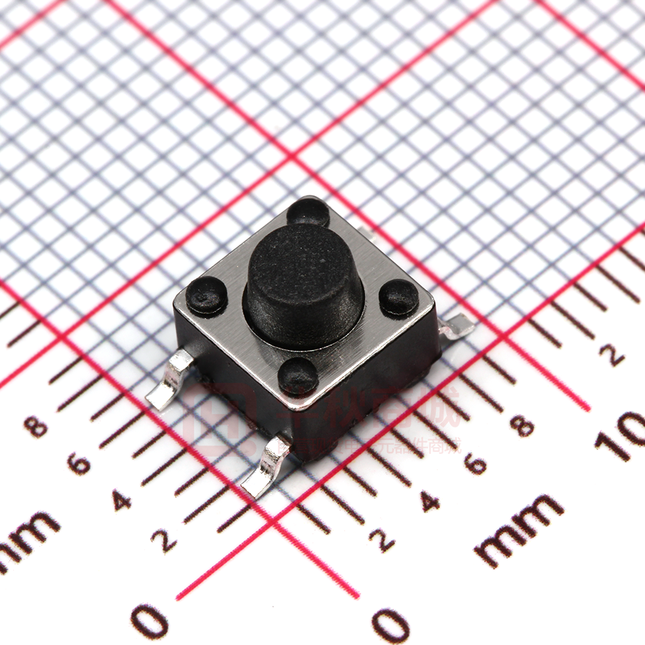

    SMD-4P,6x6mm
    轻触开关 6*6*5.5mm 立贴
TS-1002S-05526C 数据手册
ISO14001: 2004 ISO9001: 2000 APPROVAL SPECIFICATIONS Title. TACT SWITCH Product Model. TS-1002S Customer’s Part NO. Customer’s Model: Customer’s Approval Requested. Please return this copy as a certification of your approval. Checked by: Date: Approved by: Date: APPROVE 王凱 REVIEW POLT 李成功 許志明 XUNPU ELECTRONICS CO.,LTD APPROVAL SPECIFICATIONS XUNPU CUSTOMER CUSTOMER’S P/N GYE’S P/N TS-1002S PRODUCT REVISION TACT SWITCH 产品符合ROHS General tolerance:±0.2mm NO. NAME MATERIAL 1 Terminal 2 QTY. FINISHING Brass 4 Plating silver Contact SUS 1 3 Cover SPCC 1 PLAting nickel 4 Base Nylon 1 Black 5 Keystoke Nylon 1 BlacK APPROVE BY 王凯12.05.21 CHECKED BY NATIONALITY 李成功12.05.21 PRPARE BY 许志明12.05.21 Page 1of 10 APPROVAL SPECIFICATIONS XUNPU CUSTOMER CUSTOMER’S P/N GYE’S P/N PRODUCT TS-1002S REVISION TACT SWITCH A.Specification & meanings The name of the tact switch is composed by type and specification,the particular meaning of the type、specification and code is as follows. TS-1002S- Product L and L1values(refer to chart3) Operating force(refer to chart 2) Product height(refer to chart 1) 1、Product height: It is denoted by three figures: Code 043 045 Product height(mm) 4.3 050 055 060 065 070 075 080 085 5.0 4.5 5.5 6.0 6.5 7.0 7.5 8.0 8.5 Code 090 095 100 105 110 115 120 125 130 135 Product height(mm) Code 9.0 140 9.5 145 10.0 150 10.5 155 Product height(mm) 14.0 14.5 15.0 15.5 160 165 170 175 180 185 11.0 11.5 12.0 12.5 13.0 13.5 16.0 16.5 17.0 17.5 18.0 18.5 2、Operating force: An English letter expresses it, unite: Newton (N),as chart 3 shows: force Code Operating Spec 16 26 Press force(N) 1.6 2.6 1.6±0.5 2.6±0.5 Return force 0.4min 0.4min 3、Product L and L1 values: one letter: PART NO A B C D E L 8.0 8.5 9.0 9.5 10.0 L1 10 11 11 12 12 Examples: “TS-1002S-04316A” denotes the ta ct switch with 6×6 base, the height is 4.3mm,the stem is black , the operating force is 1.6N ,The L value is 8 and the L1 value is 10. APPROVE BY 王凱12.05.21 CHECKED BY 李成功12.05.21 PRPARE BY 許志明12.05.21 Page 2 of 10 APPROVAL SPECIFICATIONS XUNPU CUSTOMER CUSTOMER’S P/N GYE’S P/N TS-1002S PRODUCT REVISION TACT SWITCH 1、 概述 GENERAL 1.2 适用范围 APPLICATION 此规格书适用于机械式轻触开关的相关要求 This specification is applied to the requirements for TACTILE SWITCH (MECHANICAL CONTACT) 1.3 工作温度范围 Operating Temperature Range -20℃~70℃(在标准大气压、标准湿度条件下) -20℃~70℃(Normal humidity, normal air pressure) 1.4 贮藏温度范围 Storage Temperature Range -30℃~80℃(在标准大气压、标准湿度条件下) -30℃~80℃(Normal humidity, normal air pressure) 1.5 测试条件 Test Conditions 在没有其它特定的条件下,应该在以下的条件下进行测试和测量: Unless otherwise specified, tests and measurement shall be made in the following standard conditions: 常温…………………………………5℃~35℃ Normal temperature………………5℃~35℃ 标准湿度……………………………相对湿度 25%~85% Normal humidity…………………relative humidity 25%~85% 标准大气压…………………………86KPa~106Kpa Normal air pressure…………………86Kpa~106Kpa 在制造过程中,测试和测量应该在以下的条件下进行: If any doubt arise from the judgment, tests shall be conducted at the following conditions: 温度…………………………………20℃±2℃ Temperature………………………20℃±2℃ 相对湿度……………………………65%±5% Relative humidity………………65%±5% 环境气压…………………………86KPa~106Kpa Airpressure…………………………86KPa~106Kpa APPROVE BY 王凱12.05.21 CHECKED BY 李成功12.05.21 PRPARE BY 許志明12.05.21 Page 3 of 10 APPROVAL SPECIFICATIONS XUNPU CUSTOMER CUSTOMER’S P/N GYE’S P/N TS-1002S 2、 PRODUCT REVISION TACT SWITCH 详细说明 2.1 Detailed specification 外观:应无影响、降低产品性能的缺陷; 2.2 Appearance: There should be no defects that affect the serviceability of product. 结构尺寸和安装尺寸:应符合装配图要求; 2.3 Style and dimension: shall conform to the assemble drawings. 操作形式:有触觉反应的操作 Type of actuating: Tactile feedback. 2.4 开关结构:单回路单输出(具体的触点结构在装配图中已绘出); Contact arrangement: 1 pole, 1 throw (Details of contact arrangement are given in the assembly drawings.) 2.5 开关工作额定值:DC 12V,50mA(有效值) Ratings: 12V DC, 50mA (effective value) 3.电气性能: ELECTRICAL SPECIFICATION 项 目 试 验 条 件 ITEM 1 要求 TEST CONDITIONS 在以 5V 10mA 的直流电源或不低于1KHz 的交流电源 的电路中,以一个等于 2 倍按力的静负荷施加于手柄中心 接触电阻 Contact Resistance REQUIREMENTS Applying a static load of 2 times operating force to the center of the stem, measurements shall be made by ≤100mΩ 5V DC 10mA or more than 1KHZ AC small-current contact resistance meter. 绝缘电阻 2 Insulation Resistance 在端子之间施加 DC 100V /1min 的条件下,测量端 子之间底座、盖板的电阻值 Measurement shall be made following application of ≥100MΩ 100V DC potential, across terminals, and across terminals and cover, for one minute. 介质耐压 3 在端子之间施加 250V AC(50HZ 或 60HZ)/1min Dielectric 250V AC (50HZ or 60HZ) shall be applied across voltage proof terminals, for one minute. APPROVE BY 王凱12.05.21 CHECKED BY 李成功12.05.21 无击穿、无飞弧 There should be no breakdown and flashover PRPARE BY 許志明12.05.21 Page 4 of 10 APPROVAL SPECIFICATIONS XUNPU CUSTOMER CUSTOMER’S P/N GYE’S P/N TS-1002S PRODUCT REVISION TACT SWITCH 项目 试 验 条 件 要求 ITEM TEST CONDITIONS REQUIREMENTS 开关垂直于操作方向放置,在开关驱动件顶端中心逐渐施力,测 量开关导通所需的最大力度。 Placing the switch such that the direction of switch operation is vertical and then gradually increasing the load applied to the center of the stem, the maximum load required for the switch to come to a stop shall be measured. refer to chart 3 开关垂直于操作方向放置,以一个等于 2 倍按力的静负荷施加在 开关驱动件顶端中心,测量顶端移动的距离。 Placing the switch such that the direction of switch operation is vertical and then applying static load of 2times operating force to the center of the stem; the travel distance for the switch to come to a stop shall be measured. 0.25±0.1mm 4.机械性能: MECHANICAL SPECIFICATION 按力 1 2 Operating Force 最大行程 Full Travel APPROVE BY 王凱12.05.21 CHECKED BY 李成功12.05.21 PRPARE BY 許志明12.05.21 Page 5 of 10 APPROVAL SPECIFICATIONS XUNPU CUSTOMER CUSTOMER’S P/N GYE’S P/N TS-1002S 3 4 5 6 PRODUCT REVISION TACT SWITCH 项目 试 验 条 件 要求 ITEM TEST CONDITIONS REQUIREMENTS 回弹力 Return Force 停止强度 Stop Strength 手柄拔出强度 Stem Strength 可焊性 Solderability APPROVE BY 开关垂直于操作方向放置,在开关驱动件顶端中心下降至全行程 后,测量顶端向自由位置转换的力度。 The sample switch is installed such that the direction of switch operation is vertical and upon depressing the stem in its center to the whole travel distance, the force of the stem to return to its free position shall be measured. refer to chart 3 开关垂直于操作方向放置,从操作方向向驱动件施加 30N 的静负 荷持续 1min。 Placing the switch such that the direction of switch operation is 无机械和电气损坏 vertical, and then a static load of 30N shall be applied in the There shall be no sign of direction of stem operation for a period of 1 min. damage mechanically and electrically. 开关垂直于操作方向放置,反方向实施最大操作力,并测量手柄 的行程范围。 Placing the switch such that the direction of switch operation is vertical, and then the maximum force to withstand a pull applied opposite to the direction of stem operation shall be measured. 在以下设定条件下进行测量: Measurements shall be made following the test set forth below: (1) 焊接温度:245±5℃ Solder temperature : 245±5℃ (2) 浸入时间:2s±0.5s Immersion time: 2s±0.5s 对于其它步骤参考《GB 5095.6—86》试验 12a The other steps please refer to《GB 5095.6-86》TEST 12a 王凱12.05.21 CHECKED BY 李成功12.05.21 20N.min. 除边缘外涂层应均匀覆盖 90%以上 Except for the edge, the coating should cover a minimum 90% PRPARE BY 許志明12.05.21 Page 6 of 10 APPROVAL SPECIFICATIONS XUNPU CUSTOMER CUSTOMER’S P/N GYE’S P/N TS-1002S PRODUCT REVISION TACT SWITCH 项目 试 验 条 件 要求 ITEM TEST CONDITIONS REQUIREMENTS 低温测试 Resistance to low temperature 样品应按照以下实验条件进行测试,实验后样品应放在常温及 标准湿度的环境中 1 小时后做性能测试: Following the test set forth below the sample shall be left in normal temperature and humidity conditions for 1 h before measurements are made: (1) 温度:-30±2℃ Temperature : -30±2℃ (2) 时间:96h Time: 96h 接触电阻:≤200mΩ Contact resistance: ≤200mΩ 项目 3,4.1,4.2,4.3 Item 3,4.1,4.2,4.3 高温测试 样品应按照以下实验条件进行测试,实验后样品应放在常温及 标准湿度的环境中 1 小时后做性能测试:Following the test set forth below the sample shall be left in normal temperature and humidity conditions for 1 h before measurements are made: (1) 温度:80±2℃ temperature:80±2℃ (2) 时间:96h time: 96h 5、极限电气性能: ENVIRONMENTAL SPECIFICATION 1 2 Heat resistance 接触电阻:≤200mΩ Contact resistance: ≤200mΩ 项目 3,4.1,4.2,4.3 Item 3,4.1,4.2,4.3 根据下面的测试要求进行 5 次循环的温度周期性测试, 实验后 样品应放在常温及标准湿度的环境中 1 小时后做性能测试。测 试期间样品应保持干燥. After 5 cycles of following conditions, the sample shall be allowed to stand under normal temperature and humidity conditions for 1 h. and measurements shall be made. During the test water drops shall be removed. APPROVE BY 王凱12.05.21 1cycle 3 温度周期性测试 Change of temperature Temperature Time -10±2℃ 2(hour) -10~65℃ 1 65±2℃ 2 65~-10℃ 1 CHECKED BY 李成功12.05.21 接触电阻:≤200mΩ Contact resistance: ≤200mΩ 项目 3,4.1,4.2,4.3 Item 3,4.1,4.2,4.3 PRPARE BY 許志明12.05.21 Page 7 of 10 APPROVAL SPECIFICATIONS XUNPU CUSTOMER CUSTOMER’S P/N GYE’S P/N TS-1002S PRODUCT REVISION TACT SWITCH 项目 试 验 条 件 要求 ITEM TEST CONDITIONS REQUIREMENTS 样品应按照以下实验条件进行测试,实验后样品应放在常温及 4 湿温测试 Moisture resistance 标准湿度的环境中 1 小时后做性能测试:Following the test set forth below the sample shall be left in normal temperature and humidity conditions for 1 h before measurements are made: (1) 温度:60±2℃ temperature: 60±2℃ (2) 相对湿度:90%~95% relative humidity:90% to 95% (3) 时间:96h time: 96h 接触电阻:≤200mΩ Contact resistance: ≤200mΩ 项目 3,4.1,4.2,4.3 Item 3,4.1,4.2,4.3 样品应按照以下实验条件进行测试,实验后样品应放在常温及 5 6 硫化试验 Sulfuration resistance 盐雾试验 Salt Mist APPROVE BY 标准湿度的环境中 1 小时后做性能测试:Following the test set forth below the sample shall be left in normal temperature and humidity conditions for 1 h before measurements are made: (1) H2S 气体浓度:3ppm±1ppm H2S gas concentration: 3ppm±1ppm (2) 时间:72h Time: 72h (3) 温度:40±2℃(90~95%RH) temperature: 40±2℃(90~95%RH) 在以下设定条件下进行测量: The switch shall be checked after following test: (1)温度:35℃±2℃ temperature: 35℃±2℃ (2)盐溶液浓度:5±1%(质量百分比) salt solution : 5±1%(solids by mass) (3)时间:8h±1h Time: 8h±1 hour 实验后的盐沉积物后水冲掉 After test, salt deposit shall be removed by running water. 王凱12.05.21 CHECKED BY 李成功12.05.21 接触电阻:≤200mΩ Contact resistance: ≤200mΩ 项目 3,4.1,4.2,4.3 Item 3,4.1,4.2,4.3 金属件上没有腐蚀斑点 No remarkable corrosion shall be recognized in metal part. PRPARE BY 許志明12.05.21 Page 8 of 10 XUNPU CUSTOMER CUSTOMER’S P/N 1 2 工作寿命 Operation life 振动Vibration GYE’S P/N PRODUCT TS-1002S 6、极限机械性能: ENDURANCE SPECIFICATION 项目 ITEM APPROVAL SPECIFICATIONS REVISION TACT SWITCH 试 验 条 件 要求 TEST CONDITIONS 根据下面的测试要求进行测试: Measurement shall be made following the test set forth below: (1) DC 12V,50mA 带负载 DC 12V, 50 mA resistive load (2) 按动速率:1 次/秒 Rate of operation: 1times/s (3) 按力:按力的 1.5 倍 Operating Force: Operating Force1.5double (4) 平均无故障寿命:Average fault-free life REQUIREMENTS 16 25 100000 次 100000次 1.6 2.5 根据以下给定条件进行测试: Measurement shall be made following the test set forth below: (1) 振动频率范围:10~55~10Hz Vibration frequency range: 10 to 55 to 10Hz (2) 振幅(峰-峰):1.5mm Amplitude: 1.5mm (3) 振动方向:包括手柄行程方向在内的三个相互垂直的方 向 Direction of vibration:Three mutually perpendicular direction including the direction of stem travel (4) 测试时间:每次 2hours . 接触电阻≤200mΩContact resistance≤200mΩ 触点弹力≤10ms Contact bounce≤10ms按 力 : 初 值 的 ±30% Operating Force: initial value±30% 项目 3,4.1,4.2,4.3 Item 3,4.1,4.2,4.3 项目 3,4.1,4.2,4.3 Item 3,4.1,4.2,4.3 Duration: Each 2hours. 7.焊接条件: SOLDERING CONDITIONS: 请按以下条件进行焊接: (1) 焊锡温度:≤350℃ 7.1 手工焊接 (2) 连续焊接时间:≤3 s Hand soldering Please practice according to below conditions: (1) Soldering temperature: 350℃ Max. (2) Continuous soldering time: 3 s Max. APPROVE BY 王凱12.05.21 CHECKED BY 李成功12.05.21 PRPARE BY 許志明12.05.21 Page 9 of 10 APPROVAL SPECIFICATIONS XUNPU CUSTOMER CUSTOMER’S P/N GYE’S P/N TS-1002S Conditions for 助焊剂附着量 条件 Condition 不附着于零部件贴装面的程度 Flux built-up Mounting surface should not be coated with flax 预热温度 印刷电路板焊接面的周围温度 100℃ max. Preheating temperature Ambient temperature of the soldered surface of PC board. 100℃ max. 预热温度时间 7.2 REVISION TACT SWITCH 项目 Items 自动浸焊 Auto-dip PRODUCT 60s max. Preheating time 焊接温度 260℃ max. Soldering temperature 焊接浸渍时间 5s max. Continuous dipping time 2 次以下 焊接次数 2times max. Number of soldering 焊接说明: 1、开关浸焊后,注意不要用溶剂清洗。 After switches were soldered,please be careful not to clean switches with solvent. 1.1 在使用烙铁的情况下,焊锡温度应在 350℃以下、3 秒以内。 In the case of using solding iron, solding conditions shall be 350℃ max and 3 sec.max. 1.2 浸焊后,注意不要在顶部施加负荷。 Right after switches were soidered;please be careful not to load to on the knobs of switches. 2、设计中应注意的事项( Design instructions) 2.1 印刷基板的安装孔尺寸参见产品图。 Follow recommended P.W.B. piercing plan in outside drawing page. 3、注意点(Note): 3.1 注意不要施加超负荷的压力或晃动开关。 Please be cautions not to give excessive static load or shock to swiches. 3.2 开关浸焊后,印刷基板注意不要叠放。 Please be careful not to pile up P.W.B.after switches were soldered. 3.3 保管时尤其应注意避开高湿高温和有腐蚀性气体的环境。如需要长时间保存,请不要 打开包装箱。 Preservation under high temperature and high high humidity or corrosive gas should be avoided Especially . When you need to preserve for a long period ,do not open the carton. APPROVE BY 王凱12.05.21 CHECKED BY 李成功12.05.21 PRPARE BY 許志明12.05.21 Page 10 of 10
TS-1002S-05526C
1. 物料型号: TS-1002S 2. 器件简介: 轻触开关,适用于机械式轻触开关的相关要求,具有触觉反馈的操作形式。 3. 引脚分配: 文档中未明确提供引脚分配信息。 4. 参数特性: - 工作温度范围: -20°C~70°C - 贮藏温度范围: -30°C~80°C - 测试条件: 常温5°C~35°C,标准湿度25%~85%,标准大气压6KPa~106Kpa - 电气性能: DC12V, 50mA (有效值),接触电阻≤100mΩ,绝缘电阻≥100MΩ,介质耐压250VAC(50HZ或60HZ)/1min无击穿、无飞弧 - 机械性能: 最大行程0.25±0.1mm - 回弹力参照图表3 5. 功能详解: - 结构尺寸和安装尺寸应符合装配图要求。 - 开关结构为单回路单输出。 - 操作形式为有触觉反应的操作。 6. 应用信息: 适用于需要机械式接触反馈的场合。 7. 封装信息: 文档中提供了装配图和电路图,但具体的封装尺寸信息需要参考装配图。
