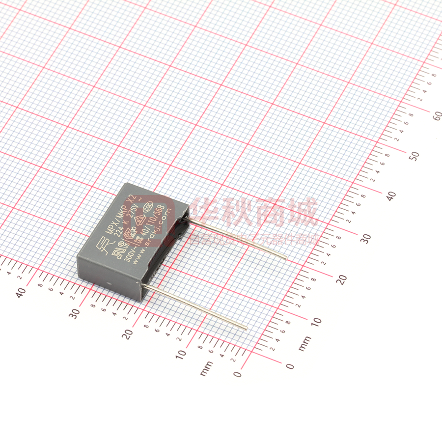

    安规电容 CAP_18X6MM_TM 220nF ±10% 275V
MP2224K27D2R890 数据手册
Metallized Polypropylene Film Interference Suppression Capacitors 金属化聚丙烯膜抑制电磁电源干扰用电容器 (MPX/MKP X2 275VAC--MP2 Series/ MP2 系列) ■ 引用标准 Reference standards GB/T6346.14-2015/ UL60384-14/VDE0565-1/ CSA E60384-14 IEC60384-14 /EN60384-14/KC60384-14/KC60384-1 ■ 结构 Structure 介质:(金属化)聚丙烯膜 封装:阻燃环氧树脂,符合 UL94 V-0 外壳:阻燃 PBT 塑壳,符合 UL94 V-0 Dielectric:(Metallized )Polypropylene film Encapsulation: Flame retardant epoxy resin, conforming to UL94 V-0 Shell: Flame retardant PBT plastic shell, conforming to UL94 V-0 ■ 典型应用 Typical Application 跨线、抑制突波、交流场合 EMI 滤波;电源开关等。如:灯具、电源等 Interlines, Surge suppression, Across-in-line as EMI filter; Power switch etc. Such as: Lamps, Power Sources etc. ■ 特点 Features 外观一致性好;有良好自愈性 抗湿性强;高耐温 长寿命,耐过电压优良 Good appearance consistency; Good self-healing property; Good resistance to humidity; Can withstand high temperature; Long lifetime; Good ability to withstand surge voltage. ■ 符合 RoHS 及 REACH 环保标准 Compliance with RoHs & ■ 电性能规范 Performance Specifications 气候类别 Climate category 阻燃等级 Passive flammability class 额定电压 Rated Voltage 容量误差 Capacitance Tolerance REACH requirements. 40/110/56 B 275VAC(VDE,ENEC, KC); 300Vac (UL&CUL) K: ±10% 容量范围 0.0022μF~4.7μF Capacitance Range Test Condition: 耐电压 No breakdown or electric arcing Withstand Voltage Terminal to terminal:4.3UR(Vdc),5S Terminal to shell:2100VAC 60S 损耗角 ≤0.0020 10KHZ CR≤1.0μF Test Condition : 20℃ 1V Dissipation factor ≤0.0010 1KHZ CR>1.0μF 绝缘电阻或时间常数 CR≤0.33μF IR≥15000MΩ Insulation Resistance CR>0.33μF IR≥5000S 最大脉冲爬升速率 Max. Pulse Rise Time (dV / dt) 20℃, 1KHz, 1Vrms Test Condition : 20℃ 100V P=7.5mm dV / dt = 800V/μs P=10mm dV / dt = 500V/μs P=15mm dV / dt = 400V/μs P=22.5mm dV / dt = 200V/μs P=27.5mm dV / dt = 150V/μs 1 min Metallized Polypropylene Film Interference Suppression Capacitors 金属化聚丙烯膜抑制电磁电源干扰用电容器 (MPX/MKP X2 275VAC--MP2 Series/ MP2 系列) ■ 电性能规范 Performance Specifications 稳态湿热 温度 Temp.:40±2℃ 无可见损伤,标志清晰 Steady-state Damp-heat Test 相对湿度 Humidity:93%RH no visible damage,clear mark 绝缘电阻 IR:≥ 额定值的 50% IR:≥ 50% of Rated value 持续时间 Duration Time:56 Days 容量变化(相对初始值): Capacitance change:△C/C≤±5% 损耗角增加 Dissipation factor: Rise ≤0.0080(10KHZ),CR≤1uF Rise ≤0.0050(1KHZ),CR>1uF 绝缘电阻 Insulation Resistance 耐久性试验 温度 Temp.: +110℃, Endurance Test 施加电压:1.25×额定电压(每小时 IR:≥ 50% of rated value 增加电压到 1000Vac,0.1 秒,1 次) 容量变化(相对初始值):△C/C≤±10% Test Voltage: Capacitance change: △C/C≤±10% 1.25 Times Rated Voltage(Rise the voltage to 1000Vac for .01s once per hours ) 持续时间 Duration Time: 1000H ■ ■ 安规认证 Safety Certification 认证标志 额定电压 证书号码 引用标准 认证国家 Certification Rated Voltage Certificate No. Reference standard Certification Country UL/CUL 300VAC E319615 UL60384-14 CSA E60384-14 美国、加拿大 America / Canada VDE 275VAC 40028812 EN60384-14 德国 Germany ENEC 275VAC 40028812 EN60384-14 欧盟 Europe CQC 275VAC CQC09001035778 GB/T6346.14-2015 中国 China KC 275VAC SU030803(16001-16005) KC60384-14 韩国 Korea 产品编码说明 Part No. Description: 15 位产品编码如下: The Part No. Is total 15 digits, details as follow: 1 2 3 4 5 6 7 8 9 10 M Digit 1-3 P 2 1 0 5 K 2 型号代码 Product Name Code 7 E 11 12 13 14 15 4 X 8 * * MP2= Class X2 Capacitors Digit 4-6 标称容量 Rated Capacitance Value For example : 105 = 10×105pF = 1.0F Digit 7 容量偏差 Capacitance Tolerance K=±10% Digit 8-9 额定电压 Rated Voltage Code 27=275VAC Digit 10-11 壳号 Plastic shell code Digit 12 塑壳颜色 Plastic Shell Color X = Yellow Color with LOGO on the shell top Digit 13 线径代码 Line diameter code 6=0.6 8=0.8 Digit 14-15 成型或内部识别码 Forming Type or Internal Use Metallized Polypropylene Film Interference Suppression Capacitors 金属化聚丙烯膜抑制电磁电源干扰用电容器 (MPX/MKP X2 275VAC--MP2 Series/ MP2 系列) ■ 料号明细及尺寸 Part No. List and Dimensions 成品编码 等级 电压 Part No. Class MP2103K27B1R5LC 尺寸 Dimension (mm) 容量 Voltage Capacitance (μF) W±0.5 T±0.5 H±0.5 P±0.5 Φd±0.05 X2 275VAC 0.01 10 4 9 7.5 0.5 MP2103K27C2R6LC X2 275VAC 0.01 13 5 11 10 0.6 MP2103K27C2S6LC X2 275VAC 0.01 13 5 11 10 0.6 MP2103K27C2X6LC X2 275VAC 0.01 13 5 11 10 0.6 MP2104K27B2R6LC X2 275VAC 0.1 10 5 11 7.5 0.6 MP2104K27C2S6LC X2 275VAC 0.1 13 5 11 10 0.6 MP2104K27C2X6LC X2 275VAC 0.1 13 5 11 10 0.6 MP2104K27C3R6LC X2 275VAC 0.1 13 6 12 10 0.6 MP2104K27C3X6LC X2 275VAC 0.1 13 6 12 10 0.6 MP2104K27D1R6LC X2 275VAC 0.1 18 5 11 15 0.6 MP2104K27D2R8LC X2 275VAC 0.1 18 6 12 15 0.8 MP2104K27D2X8LC X2 275VAC 0.1 18 6 12 15 0.8 MP2105K27C5X6LC X2 275VAC 1.0 13 7.8 13.8 10 0.6 MP2105K27D6X8LC X2 275VAC 1.0 18 10 15.8 15 0.8 MP2105K27D8R8LC X2 275VAC 1.0 18 11.2 19.2 15 0.8 MP2105K27D8X8LC X2 275VAC 1.0 18 11.2 19.2 15 0.8 MP2105K27E2X8LC X2 275VAC 1.0 26.5 7 16.5 22.5 0.8 MP2105K27E3R8LC X2 275VAC 1.0 26.5 8.5 17 22.5 0.8 MP2105K27E3S8LC X2 275VAC 1.0 26.5 8.5 17 22.5 0.8 MP2105K27E3X8LC X2 275VAC 1.0 26.5 8.5 17 22.5 0.8 MP2105K27E4R8LC X2 275VAC 1.0 26.5 10 19 22.5 0.8 MP2105K27E4X8LC X2 275VAC 1.0 26.5 10 19 22.5 0.8 MP2105K27E5R8LC X2 275VAC 1.0 26.5 11 20 22.5 0.8 MP2105K27E6R8LC X2 275VAC 1.0 26 12 21.5 22.5 0.8 MP2105K27F1R8LC X2 275VAC 1.0 31.5 10.8 19.5 27.5 0.8 MP2105K27F1S8LC X2 275VAC 1.0 31.5 10.8 19.5 27.5 0.8 MP2105K27F1X8LC X2 275VAC 1.0 31.5 10.8 19.5 27.5 0.8 MP2105K27F2R8LC X2 275VAC 1.0 31.5 13 21.5 27.5 0.8 MP2123K27C2X6LC X2 275VAC 0.012 13 5 11 10 0.6 MP2124K27C2X6LC X2 275VAC 0.12 13 5 11 10 0.6 MP2124K27C3X6LC X2 275VAC 0.12 13 6 12 10 0.6 MP2124K27D1X6LC X2 275VAC 0.12 18 5 11 15 0.6 MP2124K27D2R8LC X2 275VAC 0.12 18 6 12 15 0.8 说明 Note: “**”表示内部特征码 “**”=Internal use. Metallized Polypropylene Film Interference Suppression Capacitors 金属化聚丙烯膜抑制电磁电源干扰用电容器 (MPX/MKP X2 275VAC--MP2 Series/ MP2 系列) ■ 料号明细及尺寸 Part No. List and Dimensions 成品编码 等级 电压 Part No. Class MP2124K27D2X8LC 尺寸 Dimension (mm) 容量 Voltage Capacitance (μF) W±0.5 T±0.5 H±0.5 P±0.5 Φd±0.5 X2 275VAC 0.12 18 6 12 15 0.8 MP2125K27D7X8LC X2 275VAC 1.2 18 10.8 19 15 0.8 MP2125K27E2X8LC X2 275VAC 1.2 26.5 7 16.5 22.5 0.8 MP2125K27E4X8LC X2 275VAC 1.2 26.5 10 19 22.5 0.8 MP2125K27E6R8LC X2 275VAC 1.2 26 12 21.5 22.5 0.8 MP2125K27E7X8LC X2 275VAC 1.2 26.5 13 23 22.5 0.8 MP2125K27F1X8LC X2 275VAC 1.2 31.5 10.8 19.5 27.5 0.8 MP2125K27F2X8LC X2 275VAC 1.2 31.5 13 21.5 27.5 0.8 MP2153K27C2R6LC X2 275VAC 0.015 13 5 11 10 0.6 MP2153K27C2X6LC X2 275VAC 0.015 13 5 11 10 0.6 MP2154K27C2X6LC X2 275VAC 0.15 13 5 11 10 0.6 MP2154K27C3R6LC X2 275VAC 0.15 13 6 12 10 0.6 MP2154K27C3X6LC X2 275VAC 0.15 13 6 12 10 0.6 MP2154K27D1X6LC X2 275VAC 0.15 18 5 11 15 0.6 MP2154K27D2R8LC X2 275VAC 0.15 18 6 12 15 0.8 MP2154K27D2X8LC X2 275VAC 0.15 18 6 12 15 0.8 MP2154K27D3R8LC X2 275VAC 0.15 18 7.5 13.5 15 0.8 MP2154K27D3S8LC X2 275VAC 0.15 18 7.5 13.5 15 0.8 MP2154K27E1R8LC X2 275VAC 0.15 26.5 6 15 22.5 0.8 MP2155K27D8X8LC X2 275VAC 1.5 18 11.2 19.5 15 0.8 MP2155K27E3X8LC X2 275VAC 1.5 26.5 8.5 17 22.5 0.8 MP2155K27E5X8LC X2 275VAC 1.5 26.5 11 20 22.5 0.8 MP2155K27E6R8LC X2 275VAC 1.5 26.5 12 21.5 22.5 0.8 MP2155K27E7X8LC X2 275VAC 1.5 26.5 13 23 22.5 0.8 MP2155K27F1S8LC X2 275VAC 1.5 31.5 10.8 19.5 27.5 0.8 MP2155K27F1X8LC X2 275VAC 1.5 31.5 10.8 19.5 27.5 0.8 MP2155K27F2R8LC X2 275VAC 1.5 31.5 13 21.6 27.5 0.8 MP2155K27F2X8LC X2 275VAC 1.5 31.5 13 21.6 27.5 0.8 MP2155K27F3R8LC X2 275VAC 1.5 31 14 25 27.5 0.8 MP2183K27C2X6LC X2 275VAC 0.018 13 5 11 10 0.6 MP2184K27C3R6LC X2 275VAC 0.18 13 6 12 10 0.6 MP2184K27C3X6LC X2 275VAC 0.18 13 6 12 10 0.6 MP2184K27C5R6LC X2 275VAC 0.18 13 7.8 13.8 10 0.6 说明 Note: “**”表示内部特征码 “**”=Internal use. Metallized Polypropylene Film Interference Suppression Capacitors 金属化聚丙烯膜抑制电磁电源干扰用电容器 (MPX/MKP X2 275VAC--MP2 Series/ MP2 系列) ■ 料号明细及尺寸 Part No. List and Dimensions 成品编码 等级 电压 Part No. Class MP2184K27D1X6LC 尺寸 Dimension (mm) 容量 Voltage Capacitance (μF) W±0.5 T±0.5 H±0.5 P±0.5 Φd±0.5 X2 275VAC 0.18 18 5 11 15 0.6 MP2184K27D2R8LC X2 275VAC 0.18 18 6 12 15 0.8 MP2184K27D2X8LC X2 275VAC 0.18 18 6 12 15 0.8 MP2184K27D3X8LC X2 275VAC 0.18 18 7.5 13.5 15 0.8 MP2185K27D8X8LC X2 275VAC 1.8 18 11.2 19.2 15 0.8 MP2185K27E4X8LC X2 275VAC 1.8 26.5 10 19 22.5 0.8 MP2185K27E6R8LC X2 275VAC 1.8 26 12 21.5 22.5 0.8 MP2185K27E7X8LC X2 275VAC 1.8 26.5 13 23 22.5 0.8 MP2185K27F1X8LC X2 275VAC 1.8 31.5 10.8 19.5 27.5 0.8 MP2185K27F2X8LC X2 275VAC 1.8 31.5 13 21.6 27.5 0.8 MP2205K27D8X8LC X2 275VAC 2.0 18 11.2 19.2 15 0.8 MP2205K27E4X8LC X2 275VAC 2.0 26.5 10 19 22.5 0.8 MP2205K27E7R8LC X2 275VAC 2.0 26.5 13 23 22.5 0.8 MP2205K27E7X8LC X2 275VAC 2.0 26.5 13 23 22.5 0.8 MP2205K27F1R8LC X2 275VAC 2.0 31.5 10.8 19.5 27.5 0.8 MP2205K27F1X8LC X2 275VAC 2.0 31.5 10.8 19.5 27.5 0.8 MP2205K27F2X8LC X2 275VAC 2.0 31.5 13 21.6 27.5 0.8 MP2205K27F3R8LC X2 275VAC 2.0 31 14 25 27.5 0.8 MP2222K27C2R6LC X2 275VAC 0.0022 13 5 11 10 0.6 MP2222K27C2X6LC X2 275VAC 0.0022 13 5 11 10 0.6 MP2223K27C1R6LC X2 275VAC 0.022 13 4 9 10 0.6 MP2223K27C2R6LC X2 275VAC 0.022 13 5 11 10 0.6 MP2223K27C2X6LC X2 275VAC 0.022 13 5 11 10 0.6 MP2223K27D1R6LC X2 275VAC 0.022 18 5 11 15 0.6 MP2224K27C3R6LC X2 275VAC 0.22 13 6 12 10 0.6 MP2224K27C3S6LC X2 275VAC 0.22 13 6 12 10 0.6 MP2224K27C3X6LC X2 275VAC 0.22 13 6 12 10 0.6 MP2224K27C5R6LC X2 275VAC 0.22 13 7.8 13.8 10 0.6 MP2224K27C5X6LC X2 275VAC 0.22 13 7.8 13.8 10 0.6 MP2224K27D1X6LC X2 275VAC 0.22 18 5 11 15 0.6 MP2224K27D2R890 X2 275VAC 0.22 18 6 12 15 0.8 MP2224K27D2X8LC X2 275VAC 0.22 18 6 12 15 0.8 说明 Note: “**”表示内部特征码 ■ 料号明细及尺寸 Part “**”=Internal use. No. List and Dimensions Metallized Polypropylene Film Interference Suppression Capacitors 金属化聚丙烯膜抑制电磁电源干扰用电容器 (MPX/MKP X2 275VAC--MP2 Series/ MP2 系列) 成品编码 等级 电压 Part No. Class MP2224K27D3R8LC 尺寸 Dimension (mm) 容量 Voltage Capacitance (μF) W±0.5 T±0.5 H±0.5 P±0.5 Φd±0.5 X2 275VAC 0.22 18 7.5 13.5 15 0.8 MP2224K27D3X8LC X2 275VAC 0.22 18 7.5 13.5 15 0.8 MP2224K27D4R8LC X2 275VAC 0.22 18 8.4 14.5 15 0.8 MP2224K27D4S8LC X2 275VAC 0.22 18 8.4 14.5 15 0.8 MP2224K27D4X8LC X2 275VAC 0.22 18 8.4 14.5 15 0.8 MP2224K27E1X8LC X2 275VAC 0.22 26.5 6 15 22.5 0.8 MP2224K27E2R8LC X2 275VAC 0.22 26.5 7 16.5 22.5 0.8 MP2225K27D8X8LC X2 275VAC 2.2 18 11.2 19.5 15 0.8 MP2225K27E4X8LC X2 275VAC 2.2 26.5 10 19 22.5 0.8 MP2225K27E7R8LC X2 275VAC 2.2 26.5 13 23 22.5 0.8 MP2225K27E7X8LC X2 275VAC 2.2 26.5 13 23 22.5 0.8 MP2225K27F1X8LC X2 275VAC 2.2 31.5 10.8 19.5 27.5 0.8 MP2225K27F2R8LC X2 275VAC 2.2 31.5 13 21.6 27.5 0.8 MP2225K27F2X8LC X2 275VAC 2.2 31.5 13 21.6 27.5 0.8 MP2225K27F3R8LC X2 275VAC 2.2 31 14 25 27.5 0.8 MP2225K27F3X8LC X2 275VAC 2.2 31 14 25 27.5 0.8 MP2272K27C2X6LC X2 275VAC 0.0027 13 5 11 10 0.6 MP2273K27C2X6LC X2 275VAC 0.027 13 5 11 10 0.6 MP2274K27C5X6LC X2 275VAC 0.27 13 7.8 13.8 10 0.6 MP2274K27D1X6LC X2 275VAC 0.27 18 5 11 15 0.6 MP2274K27D2X8LC X2 275VAC 0.27 18 6 12 15 0.8 MP2274K27D3X8LC X2 275VAC 0.27 18 7.5 13.5 15 0.8 MP2274K27D4R8LC X2 275VAC 0.27 18 8.4 14.5 15 0.8 MP2274K27D4X8LC X2 275VAC 0.27 18 8.4 14.5 15 0.8 MP2275K27E5X8LC X2 275VAC 2.7 26.5 11 20 22.5 0.8 MP2275K27F1X8LC X2 275VAC 2.7 31.5 10.8 19.5 27.5 0.8 MP2275K27F4X8LC X2 275VAC 2.7 31 16 25.5 27.5 0.8 MP2305K27E6X8LC X2 275VAC 3.0 26 12 21.5 22.5 0.8 MP2305K27F2X8LC X2 275VAC 3.0 31.5 13 21.6 27.5 0.8 MP2305K27F3R8LC X2 275VAC 3.0 31 14 25 27.5 0.8 MP2305K27F3X8LC X2 275VAC 3.0 31 14 25 27.5 0.8 MP2305K27F4X8LC X2 275VAC 3.0 31 16 26.5 27.5 0.8 MP2332K27C2R6LC X2 275VAC 0.0033 13 5 11 10 0.6 说明 Note: “**”表示内部特征码 ■ 料号明细及尺寸 Part “**”=Internal use. No. List and Dimensions Metallized Polypropylene Film Interference Suppression Capacitors 金属化聚丙烯膜抑制电磁电源干扰用电容器 (MPX/MKP X2 275VAC--MP2 Series/ MP2 系列) 成品编码 等级 电压 Part No. Class MP2332K27C2X6LC 尺寸 Dimension (mm) 容量 Voltage Capacitance (μF) W±0.5 T±0.5 H±0.5 P±0.5 Φd±0.5 X2 275VAC 0.0033 13 5 11 10 0.6 MP2333K27C1R6LC X2 275VAC 0.033 13 4 9 10 0.6 MP2333K27C2R6LC X2 275VAC 0.033 13 5 11 10 0.6 MP2333K27C2X6LC X2 275VAC 0.33 13 5 11 10 0.6 MP2334K27C5S6LC X2 275VAC 0.33 13 7.8 13.8 10 0.6 MP2334K27C5X6LC X2 275VAC 0.33 13 7.8 13.8 10 0.6 MP2334K27D2R8LC X2 275VAC 0.33 18 6 12 15 0.8 MP2334K27D2X8LC X2 275VAC 0.33 18 6 12 15 0.8 MP2334K27D3R8LC X2 275VAC 0.33 18 7.5 13.5 15 0.8 MP2334K27D3X8LC X2 275VAC 0.33 18 7.5 13.5 15 0.8 MP2334K27D4R8LC X2 275VAC 0.33 18 8.4 14.5 15 0.8 MP2334K27D4S8LC X2 275VAC 0.33 18 8.4 14.5 15 0.8 MP2334K27D6R8LC X2 275VAC 0.33 18 10 15.8 15 0.8 MP2334K27D6X8LC X2 275VAC 0.33 18 10 15.8 15 0.8 MP2334K27E1X8LC X2 275VAC 0.33 26.5 6 15 22.5 0.8 MP2334K27E2R8LC X2 275VAC 0.33 26.5 7 16.5 22.5 0.8 MP2334K27E2X8LC X2 275VAC 0.33 26.5 7 16.5 22.5 0.8 MP2334K27E3R8LC X2 275VAC 0.33 26.5 8.5 17 22.5 0.8 MP2335K27E7X8LC X2 275VAC 3.3 26.5 13 23 22.5 0.8 MP2335K27F1X8LC X2 275VAC 3.3 31.5 10.8 19.5 27.5 0.8 MP2335K27F3X8LC X2 275VAC 3.3 31 14 25 27.5 0.8 MP2335K27F8R8LC X2 275VAC 3.3 31.5 21 31 27.5 0.8 MP2392K27C2X6LC X2 275VAC 0.0039 13 5 11 10 0.6 MP2393K27C2X6LC X2 275VAC 0.039 13 5 11 10 0.6 MP2394K27C5X6LC X2 275VAC 0.39 13 7.8 13.8 10 0.6 MP2394K27D2X8LC X2 275VAC 0.39 18 6 12 15 0.8 MP2394K27D3R8LC X2 275VAC 0.39 18 7.5 13.5 15 0.8 MP2394K27D3X8LC X2 275VAC 0.39 18 7.5 13.5 15 0.8 MP2394K27D4X8LC X2 275VAC 0.39 18 8.4 14.5 15 0.8 MP2394K27D5R8LC X2 275VAC 0.39 18 9.5 15.5 15 0.8 MP2394K27D5X8LC X2 275VAC 0.39 18 9.5 15.5 15 0.8 MP2394K27D6R8LC X2 275VAC 0.39 18 10 15.8 15 0.8 MP2394K27E1X8LC X2 275VAC 0.39 26.5 6 15 22.5 0.8 说明 Note: “**”表示内部特征码 ■ 料号明细及尺寸 Part “**”=Internal use. No. List and Dimensions Metallized Polypropylene Film Interference Suppression Capacitors 金属化聚丙烯膜抑制电磁电源干扰用电容器 (MPX/MKP X2 275VAC--MP2 Series/ MP2 系列) 成品编码 等级 电压 Part No. Class MP2394K27E2X8LC 尺寸 Dimension (mm) 容量 Voltage Capacitance (μF) W±0.5 T±0.5 H±0.5 P±0.5 Φd±0.5 X2 275VAC 0.39 26.5 7 16.5 22.5 0.8 MP2394K27E4R8LC X2 275VAC 0.39 26.5 10 19 22.5 0.8 MP2405K27F2X8LC X2 275VAC 4.0 31.5 13 21.6 27.5 0.8 MP2405K27F4R8LC X2 275VAC 4.0 31 16 25.5 27.5 0.8 MP2405K27F4X8LC X2 275VAC 4.0 31 16 25.5 27.5 0.8 MP2472K27C2R6LC X2 275VAC 0.0047 13 5 11 10 0.6 MP2472K27C2X6LC X2 275VAC 0.0047 13 5 11 10 0.6 MP2473K27B2R6LC X2 275VAC 0.047 10 5 11 7.5 0.6 MP2473K27C2R6LC X2 275VAC 0.047 13 5 11 10 0.6 MP2473K27C2X6LC X2 275VAC 0.047 13 5 11 10 0.6 MP2473K27C3R6LC X2 275VAC 0.047 13 6 12 10 0.6 MP2473K27D1R6LC X2 275VAC 0.047 18 5 11 15 0.6 MP2473K27D1X6LC X2 275VAC 0.047 18 5 11 15 0.6 MP2473K27D3R8LC X2 275VAC 0.047 18 7.5 13.5 15 0.8 MP2474K27C5X6LC X2 275VAC 0.47 13 7.8 13.8 10 0.6 MP2474K27D3X8LC X2 275VAC 0.47 18 7.5 13.5 15 0.8 MP2474K27D4R8LC X2 275VAC 0.47 18 8.4 14.5 15 0.8 MP2474K27D4X8LC X2 275VAC 0.47 18 8.4 14.5 15 0.8 MP2474K27D5R8LC X2 275VAC 0.47 18 9.5 15.5 15 0.8 MP2474K27D6R8LC X2 275VAC 0.47 18 10 15.8 15 0.8 MP2474K27D6S8LC X2 275VAC 0.47 18 10 15.8 15 0.8 MP2474K27D6X8LC X2 275VAC 0.47 18 10 15.8 15 0.8 MP2474K27E1X8LC X2 275VAC 0.47 26.5 6 15 22.5 0.8 MP2474K27E2R8LC X2 275VAC 0.47 26.5 7 16.5 22.5 0.8 MP2474K27E2X8LC X2 275VAC 0.47 26.5 7 16.5 22.5 0.8 MP2474K27E4R8LC X2 275VAC 0.47 26.5 10 19 22.5 0.8 MP2474K27F1R8LC X2 275VAC 0.47 31.5 10.8 19.5 27.5 0.8 MP2475K27F3X8LC X2 275VAC 4.7 31 14 25 27.5 0.8 MP2475K27F7R8LC X2 275VAC 4.7 31.5 18 26 27.5 0.8 MP2475K27F8R8LC X2 275VAC 4.7 31.5 21 31 27.5 0.8 MP2562K27C2X6LC X2 275VAC 0.0056 13 5 11 10 0.6 MP2563K27C2X6LC X2 275VAC 0.056 13 5 11 10 0.6 MP2563K27C3R6LC X2 275VAC 0.056 13 6 12 10 0.6 说明 Note: “**”表示内部特征码 ■ 料号明细及尺寸 Part “**”=Internal use. No. List and Dimensions Metallized Polypropylene Film Interference Suppression Capacitors 金属化聚丙烯膜抑制电磁电源干扰用电容器 (MPX/MKP X2 275VAC--MP2 Series/ MP2 系列) 成品编码 等级 电压 Part No. Class MP2563K27D1R6LC 尺寸 Dimension (mm) 容量 Voltage Capacitance (μF) W±0.5 T±0.5 H±0.5 P±0.5 Φd±0.5 X2 275VAC 0.056 18 5 11 15 0.6 MP2563K27D1X6LC X2 275VAC 0.056 18 5 11 15 0.6 MP2564K27C5X6LC X2 275VAC 0.56 13 7.8 13.8 10 0.6 MP2564K27D3X8LC X2 275VAC 0.56 18 7.5 13.5 15 0.8 MP2564K27D5X8LC X2 275VAC 0.56 18 9.5 15.5 15 0.8 MP2564K27D8X8LC X2 275VAC 0.56 18 11.2 19.2 15 0.8 MP2564K27E1X8LC X2 275VAC 0.56 26.5 6 15 22.5 0.8 MP2564K27E2X8LC X2 275VAC 0.56 26.5 7 16.5 22.5 0.8 MP2564K27E3R8LC X2 275VAC 0.56 26.5 8.5 17 22.5 0.8 MP2564K27E4R8LC X2 275VAC 0.56 26.5 10 19 22.5 0.8 MP2682K27C2X6LC X2 275VAC 0.0068 13 5 11 10 0.6 MP2683K27C2R6LC X2 275VAC 0.068 13 5 11 10 0.6 MP2683K27C2X6LC X2 275VAC 0.068 13 5 11 10 0.6 MP2683K27C3R6LC X2 275VAC 0.068 13 6 12 10 0.6 MP2683K27D1R6LC X2 275VAC 0.068 18 5 11 15 0.6 MP2683K27D1X6LC X2 275VAC 0.068 18 5 11 15 0.6 MP2684K27C5X6LC X2 275VAC 0.68 13 7.8 13.8 10 0.6 MP2684K27D4X8LC X2 275VAC 0.68 18 8.4 14.5 15 0.8 MP2684K27D6X8LC X2 275VAC 0.68 18 10 15.8 15 0.8 MP2684K27D8X8LC X2 275VAC 0.68 18 11.2 19.5 15 0.8 MP2684K27E1X8LC X2 275VAC 0.68 26.5 6 15 22.5 0.8 MP2684K27E2R8LC X2 275VAC 0.68 26.5 7 16.5 22.5 0.8 MP2684K27E2X8LC X2 275VAC 0.68 26.5 7 16.5 22.5 0.8 MP2684K27E3R8LC X2 275VAC 0.68 26.5 8.5 17 22.5 0.8 MP2684K27E3X8LC X2 275VAC 0.68 26.5 8.5 17 22.5 0.8 MP2684K27E4R8LC X2 275VAC 0.68 26.5 10 19 22.5 0.8 MP2684K27E4S8LC X2 275VAC 0.68 26.5 10 19 22.5 0.8 MP2684K27F1R8LC X2 275VAC 0.68 31.5 10.8 19.5 27.5 0.8 MP2684K27F1X8LC X2 275VAC 0.68 31.5 10.8 19.5 27.5 0.8 MP2822K27C2X6LC X2 275VAC 0.0082 13 5 11 10 0.6 MP2823K27C2X6LC X2 275VAC 0.082 13 5 11 10 0.6 MP2823K27C3R6LC X2 275VAC 0.082 13 6 12 10 0.6 MP2823K27C3X6LC X2 275VAC 0.082 13 6 12 10 0.6 说明 Note: “**”表示内部特征码 ■ 料号明细及尺寸 Part “**”=Internal use. No. List and Dimensions Metallized Polypropylene Film Interference Suppression Capacitors 金属化聚丙烯膜抑制电磁电源干扰用电容器 (MPX/MKP X2 275VAC--MP2 Series/ MP2 系列) 成品编码 等级 电压 Part No. Class MP2823K27D1R6LC 尺寸 Dimension (mm) 容量 Voltage Capacitance (μF) W±0.5 T±0.5 H±0.5 P±0.5 Φd±0.5 X2 275VAC 0.082 18 5 11 15 0.6 MP2823K27D1X6LC X2 275VAC 0.082 18 5 11 15 0.6 MP2823K27D2R8LC X2 275VAC 0.082 18 6 12 15 0.8 MP2823K27D2X8LC X2 275VAC 0.082 18 6 12 15 0.8 MP2824K27C5X6LC X2 275VAC 0.82 13 7.8 13.8 10 0.6 MP2824K27D6X8LC X2 275VAC 0.82 18 10 15.8 15 0.8 MP2824K27D8X8LC X2 275VAC 0.82 18 11.2 19.5 15 0.8 MP2824K27E1X8LC X2 275VAC 0.82 26.5 6 15 22.5 0.8 MP2824K27E2X8LC X2 275VAC 0.82 26.5 7 16.5 22.5 0.8 MP2824K27E4R8LC X2 275VAC 0.82 26.5 10 19 22.5 0.8 MP2824K27E4X8LC X2 275VAC 0.82 26.5 10 19 22.5 0.8 MP2824K27F1X8LC X2 275VAC 0.82 31.5 10.8 19.5 27.5 0.8 说明 Note: “**”表示内部特征码 “**”=Internal use. We can customize the capacitors according to customers special requirements.
MP2224K27D2R890
物料型号:MP2系列,例如MP2103K27B1R5LC、MP2104K27C2R6LC等。
器件简介:金属化聚丙烯膜抑制电磁电源干扰用电容器,用于跨线、抑制突波、交流场合EMI滤波、电源开关等,如灯具、电源等。
引脚分配:未在文档中明确说明具体的引脚分配,但通常这类电容器会有至少两个引脚,分别连接电源线和地线。
参数特性: - 介质:金属化聚丙烯膜 - 封装:阻燃环氧树脂,符合UL94 V-0 - 外壳:阻燃PBT塑壳,符合UL94 V-0 - 额定电压:275VAC(VDE,ENEC, KC); 300Vac(UL&CUL) - 容量误差:K:±10% - 耐电压:终端至终端4.3UR(Vdc),5S; 终端至外壳2100VAC 60S,无击穿或电弧 - 损耗角:10KHz时≤0.0020,1KHz时CRS1.0 F ≤0.0010,CRS>1.0F - 绝缘电阻:CRS0.33 F时IR≥15000MΩ,CRS>0.33 F时IR≥5000S - 最大脉冲爬升速率:根据电容器尺寸不同,dV/dt值不同
功能详解:具有良好的外观一致性、自愈性、抗湿性、耐高温、长寿命和耐过电压能力,符合RoHS及REACH环保标准。
应用信息:适用于灯具、电源等需要抑制电磁干扰的场合。
封装信息:提供了详细的产品编码说明,包括型号代码、标称容量、容量偏差、额定电压、塑壳编码、颜色编码、线径代码以及成型或内部识别码。
