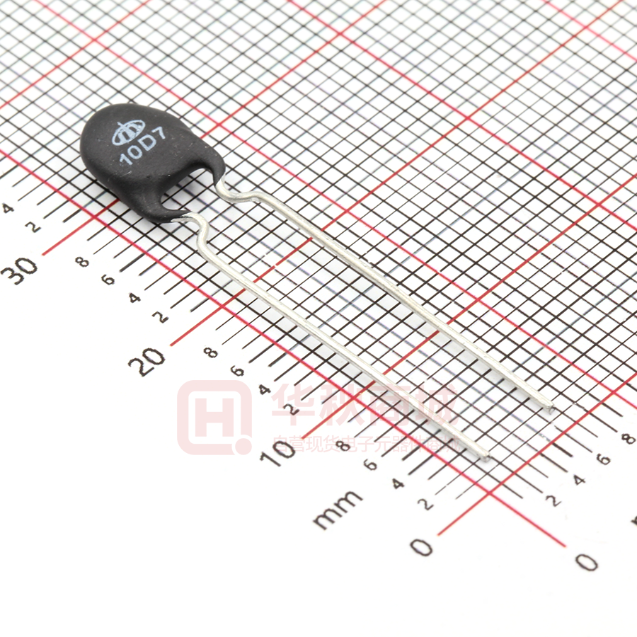

    NTC热敏电阻 10Ω ±20% 2800K 插件,P=5mm
