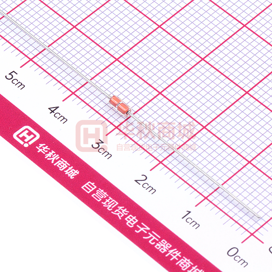

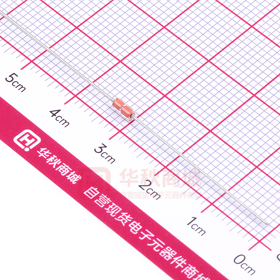

    插件,D1.8xL4mm
    NTC热敏电阻 100KΩ ±1% 3950K 插件,D1.8xL4mm
