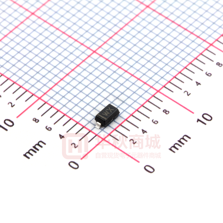

    稳压二极管 Vz=2.4V 2.2V~2.6V Izt=5mA P=500mW SOD123
BZT52C2V4 数据手册
BZT52C2V0-BZT52C51 Surface Mount Zener Diodes SOD-123 0.022(0.55) Typ. Min. 0.053(1.35) Max. Features 0.152(3.85) 0.140(3.55) z Planar die construction. 500mW power dissipation on ceramic PCB. General purpose, medium current. z Ideally suited for automated assembly processes. z z 0.112(2.85) 0.100(2.55) 0.010(0.25) Min. 0.067(1.70) 0.055(1.40) 0.006(0.15) Typ. Min. 0.004(0.10) Max. Applications Dimensions in inches and (millimeters) z Zener diode. z Ultra-small surface mount package. Ordering Information Type No. Marking Package Code BZT52C2V4-BZT52C51 See table 2 SOD-123 MAXIMUM RATING @ Ta=25℃ unless otherwise specified Characteristic Symbol Value Unit VF 0.9 V Power Dissipation Pd 500 mW Thermal resistance,junction to ambient air RθjA 305 ℃/W Junction temperature Tj 150 ℃ Storage temperature range Tstg -65-150 ℃ Forward Voltage @ IF=10mA Notes: 1. Device mounted on ceramic PCB; 7.6mm x 9.4mm x 0.87mm with pad areas 25mm2 2. Short duration test pulse used to minimize self-heating effect. 3. When provided, otherwise, parts are provided with date code only, and type number identifications appears on reel only. 4. f = 1KHz ht t p : // Revision:20170701-P1 www.lgesemi .c o m mail:lge@lgesemi.com BZT52C2V0-BZT52C51 Surface Mount Zener Diodes ELECTRICAL CHARACTERISTICS @ Ta=25℃ unless otherwise specified Type Marking Number Code Maximum Zener Zener Voltage Range VZ@IZT Impedance IZT Nom(V) Min(V) Max(V) mA ZZT@IZT ZZK@IZK Ω Maximum Typical Reverse Temperature Current Coefficient@ IZTC mV/℃ Test Current IZTC IZK IR @VR mA μA V Min Max mA BZT52C2V0 WY 2.0 1.91 2.09 5 100 600 1.0 150 1 -3.5 0 5 BZT52C2V4 WX 2.4 2.2 2.6 5 100 600 1.0 50 1.0 -3.5 0 5 BZT52C2V7 W1 2.7 2.5 2.9 5 100 600 1.0 20 1.0 -3.5 0 5 BZT52C3V0 W2 3.0 2.8 3.2 5 95 600 1.0 10 1.0 -3.5 0 5 BZT52C3V3 W3 3.3 3.1 3.5 5 95 600 1.0 5.0 1.0 -3.5 0 5 BZT52C3V6 W4 3.6 3.4 3.8 5 90 600 1.0 5.0 1.0 -3.5 0 5 BZT52C3V9 W5 3.9 3.7 4.1 5 90 600 1.0 3.0 1.0 -3.5 0 5 BZT52C4V3 W6 4.3 4.0 4.6 5 90 600 1.0 3.0 1.0 -3.5 0 5 BZT52C4V7 W7 4.7 4.4 5.0 5 80 500 1.0 3.0 2.0 -3.5 0 5 BZT52C5V1 W8 5.1 4.8 5.4 5 60 480 1.0 2.0 2.0 -2.7 1.2 5 BZT52C5V6 W9 5.6 5.2 6.0 5 40 400 1.0 1.0 2.0 -2 2.5 5 BZT52C6V2 WA 6.2 5.8 6.6 5 10 150 1.0 3.0 4.0 0.4 3.7 5 BZT52C6V8 WB 6.8 6.4 7.2 5 15 80 1.0 2.0 4.0 1.2 4.5 5 BZT52C7V5 WC 7.5 7.0 7.9 5 15 80 1.0 1.0 5.0 2.5 5.3 5 BZT52C8V2 WD 8.2 7.7 8.7 5 15 80 1.0 0.7 5.0 3.2 6.2 5 BZT52C9V1 WE 9.1 8.5 9.6 5 15 100 1.0 0.5 6.0 3.8 7.0 5 BZT52C10 WF 10 9.4 10.6 5 20 150 1.0 0.2 7.0 4.5 8.0 5 BZT52C11 WG 11 10.4 11.6 5 20 150 1.0 0.1 8.0 5.4 9.0 5 BZT52C12 WH 12 11.4 12.7 5 25 150 1.0 0.1 8.0 6.0 10.0 5 BZT52C13 WI 13 12.4 14.1 5 30 170 1.0 0.1 8.0 7.0 11.0 5 BZT52C15 WJ 15 13.8 15.6 5 30 200 1.0 0.1 10.5 9.2 13.0 5 BZT52C16 WK 16 15.3 17.1 5 40 200 1.0 0.1 11.2 10.4 14.0 5 BZT52C18 WL 18 16.8 19.1 5 45 225 1.0 0.1 12.6 12.4 16.0 5 BZT52C20 WM 20 18.8 21.2 5 55 225 1.0 0.1 14.0 14.4 18.0 5 BZT52C22 WN 22 20.8 23.3 5 55 250 1.0 0.1 15.4 16.4 20.0 5 BZT52C24 WO 24 22.8 25.6 5 70 250 1.0 0.1 16.8 18.4 22.0 5 BZT52C27 WP 27 25.1 28.9 2 80 300 0.5 0.1 18.9 21.4 25.3 2 BZT52C30 WQ 30 28.0 32.0 2 80 300 0.5 0.1 21.0 24.4 29.4 2 BZT52C33 WR 33 31.0 35.0 2 80 325 0.5 0.1 23.1 27.4 33.4 2 BZT52C36 WS 36 34.0 38.0 2 90 350 0.5 0.1 25.2 30.4 37.4 2 BZT52C39 WT 39 37.0 41.0 2 130 350 0.5 0.1 27.3 33.4 41.2 2 BZT52C43 WU 43 40.0 46.0 5 100 700 1.0 0.1 32 10.0 12.0 5 BZT52C47 WV 47 44.0 50.0 5 100 750 1.0 0.1 35 10.0 12.0 5 BZT52C51 WW 51 48.0 54.0 5 100 750 1.0 0.1 38 10.0 12.0 5 ht t p : // Revision:20170701-P1 www.lgesemi .c o m mail:lge@lgesemi.com BZT52C2V0-BZT52C51 Surface Mount Zener Diodes TYPICAL CHARACTERISTICS @ Ta=25℃ unless otherwise specified PACKAGE SPQ/PCS CARTON SPQ/PCS CARTON SIZE/CM CARTON GW/KG CARTON NW/KG SOD-123 3000/REEL 90000 40X20X22 5.00 4.00 ht t p : // Revision:20170701-P1 www.lgesemi .c o m mail:lge@lgesemi.com
BZT52C2V4
物料型号:BZT52C2V0-BZT52C51
器件简介:这些是表面安装的Zener二极管,符合RoHS标准,采用SOD-123封装,具有平面芯片结构,适用于中等电流的通用应用,非常适合自动化装配流程。
引脚分配:文档中提到了阳极和阴极的标记,但没有具体说明引脚分配
参数特性: - 典型最小值为0.022英寸(0.55毫米),典型最大值为0.067英寸(1.70毫米)。 - 存储温度范围为-65℃至150℃。
功能详解: - Zener二极管,具有超小型表面安装封装。 - 正向电压在10mA电流下为0.9V,功率耗散为500mW。 - 热阻从结到环境空气为305℃/W。
应用信息:文档中没有提供具体的应用案例,但Zener二极管通常用于电压稳定和过压保护。
封装信息:SOD-123封装,每卷3000个,每箱90000个,箱尺寸为40x20x22厘米,毛重5.00公斤,净重4.00公斤。
电气特性表格提供了不同型号的Zener电压范围、最大Zener阻抗、最大反向电流、典型温度系数等参数。
典型特性图表显示了在25℃环境温度下,Zener电压、功率耗散与环境温度的关系,以及Zener击穿特性和结电容与Zener电压的关系。
