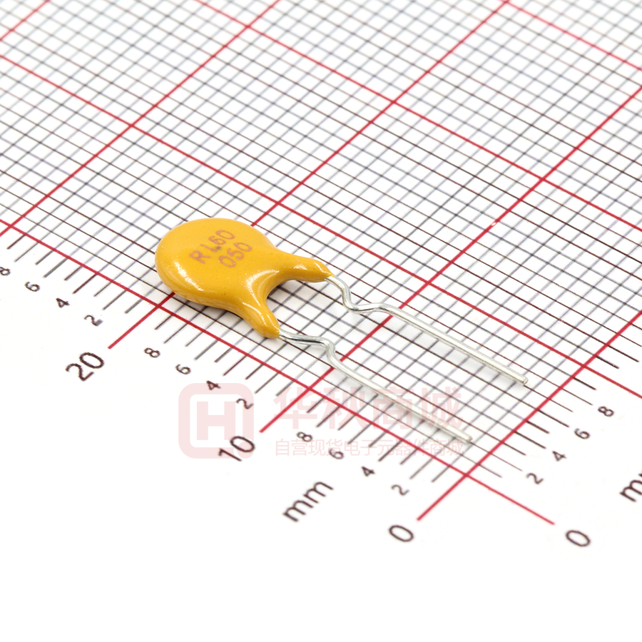

    PTC-D7.8XT3MM_TM
    最大电压:60V 最大电流:40A 保持电流:500mA 跳闸电流:1A
RL60-050 数据手册
ELECTRONICS Positive Thermal Coefficent RL60 Series Circuit Protection System Specifications are subject to change without notice. Positive Thermal Coefficent - RL60 Series Features 1. I(hold):005~500mA 2. 60V Operating voltages 3. Radial leaded devices. 4. Very high voltage surge capabilities. 5. Available in lead-free version. 6. Fast time–to–trip 7. RoHS compliant, Lead- Free and Halogen-Free Applications 1. Overcurrent and overtemperature 2. protection of automotive electronics 3. Hard disk drives 4. PC motherboards 5. PC peripherals • Point-of-sale (POS) equipment • PCMCIA cards • USB port protection • HDMI 1.4 Source protection • Computers & peripherals • General Electronics Product Name R L 6 LOGO Circuit Protection System 0 Vmax:60V - 0 0 5 Ihold:0.05A Specifications are subject to change without notice. Page:1 Positive Thermal Coefficent - RL60 Series Dimension E E EE DD D D E E EE Fig.1 Type Number Fig.2 Ihold Vmax Itrip Imax Rmax Rmin Pdtyp A V A A Ω Ω W RL60-005 0.05 60 0.1 40 20 7.3 RL60-010 0.1 60 0.2 40 7.5 2.5 EE DD Package Dimensions (mm) A B C D E Circuit Figure 0.3 5 8.5 5.1 3 0.8 Fig.1/2 0.38 5.5 9.5 5.1 3 0.8 Fig.1/2 RL60-017 0.17 60 0.34 40 5.21 2.84 0.48 7.4 12.7 5.1 3 0.8 Fig.1/2 RL60-020 0.2 60 0.4 40 2.84 1.83 0.41 7.4 12.7 5.1 3 0.8 Fig.1/2 RL60-025 0.25 60 0.5 40 1.95 1 0.45 7.4 12.7 5.1 3 0.8 Fig.1/2 RL60-030 0.3 60 0.6 40 1.38 0.76 0.49 7.4 13 5.1 3 0.8 Fig.1/2 RL60-040 0.4 60 0.8 40 0.88 0.55 0.56 7.8 13.5 5.1 3 0.8 Fig.2 RL60-050 0.5 60 1 40 0.79 0.5 0.77 7.8 13.5 5.1 3 0.8 Fig.2 RL60-065 0.65 60 1.3 40 0.5 0.31 0.88 9.7 14.5 5.1 3 0.8 Fig.2 RL60-075 0.75 60 1.5 40 0.42 10.4 15.2 5.1 3 0.8 Fig.2 0.9 60 1.8 40 0.33 0.25 EE 0.2 0.92 RL60-090 0.99 11.7 15.8 5.1 3 0.8 Fig.2 RL60-110 1.1 60 2.2 40 0.27 0.15 1.5 13 18 5.1 3 0.8 Fig.1 RL60-135 1.35 60 2.7 40 0.21 0.12 1.7 14.5 19.6 5.1 3 0.8 Fig.1 RL60-160 1.6 60 3.2 40 0.16 0.09 1.9 16.3 21.3 5.1 3 0.8 Fig.1 RL60-185 1.85 60 3.7 40 0.14 0.08 2.1 17.8 22.9 5.1 3 0.8 Fig.1 DD RL60-250 2.5 60 5 40 0.1 0.05 2.5 21.3 26.4 10.5 3 0.8 Fig.1 RL60-300 3 60 6 40 0.08 0.04 2.8 21.3 26.4 10.5 3 0.8 Fig.1 RL60-375 3.75 60 7.5 40 0.07 0.03 3.2 28.5 33.5 10.5 3 0.8 Fig.1 RL60-500 5 60 10 40 0.02 0.03E E 4.2 28.5 33.5 10.5 3 0.8 Fig.1 I hold = Hold Current. Maximum current device will not trip in 25°C still air. I trip = Trip Current. Minimum current at which the device will always trip in 25°C still air. V max = Maximum operating voltage device can withstand without damage at rated current (Imax). I max = Maximum fault current device can withstand without damage at rated voltage (V max). R min/max = Minimum/Maximum device resistance prior to tripping at 25°C. Circuit Protection System Specifications are subject to change without notice. Page:2 ting Curren 1.4 1.2 1.0 Percentage 0.8 0.6 0.4 Positive Thermal Coefficent - RL60 Series 0.2 0.0 -40 -20 Average Time Current Curves 0 20 40 60 80 Temperature (C°) Soldering Parameters TP 20~40 S Profile Feature Pb-Free Assembly Average Ramp-Up Rate(Ts max to T p) 3°C/second mac. TP 260 Critical Zone Ramp-up TL 217 TL to TP tL 60~150 s Tsmax 200 Tsmin Ramp-down 150 ts Preheat 60~180 s Preheat -Temperature Min(Ts min) -Temperature Max(Ts max) -Time(Ts min to Ts max) 150°C 200°C 60~180 seconds Time maintained above: -Temperature(TL) -Time(tL) +217°C 60~150 seconds 25 t 25 C to peak Time Peak Temperature(Tp) Ramp-Down Rate Recommended reflow methods: IR, vapor phase oven, hot air oven, N2 environment for lead-free Recommended maximum paste thickness is 0.25mm Devices can be cleaned using standard industry methods and solvents. Note 1:All temperature refer to topside of the package, measured on the package body surface. Note 2: If reflow temperatures exceed the recommended profile, devices may not meet the performance requirements. Circuit Protection System Time 25°C to Peak Temperature Storage Condition 260°C 6°C/second max. 8 minutes max 0°C~35°C,70%RH Specifications are subject to change without notice. Page:3 Positive Thermal Coefficent - RL60 Series Ihold Versus Temperature Type Number -40°C -20°C 0°C 25°C 40°C 50°C 60°C 70°C 85°C RL60-010 0.16 0.14 0.12 0.10 0.08 0.07 0.06 0.05 0.04 RL60-017 0.26 0.23 0.20 0.17 0.14 0.12 0.11 0.09 0.07 RL60-020 0.31 0.27 0.24 0.20 0.16 0.14 0.13 0.11 0.08 RL60-025 0.39 0.34 0.30 0.25 0.20 0.18 0.16 0.14 0.10 RL60-030 0.47 0.41 0.36 0.30 0.24 0.22 0.19 0.16 0.12 RL60-040 0.62 0.54 0.48 0.40 0.32 0.29 0.25 0.22 0.16 RL60-050 0.78 0.68 0.60 0.50 0.41 0.36 0.32 0.27 0.20 RL60-065 1.01 0.88 0.77 0.65 0.53 0.47 0.41 0.35 0.26 RL60-075 1.16 1.02 0.89 0.75 0.61 0.54 0.47 0.41 0.30 RL60-090 1.40 1.22 1.07 0.90 0.73 0.65 0.57 0.49 0.36 RL60-110 1.71 1.50 1.31 1.10 0.89 0.79 0.69 0.59 0.44 RL60-135 2.09 1.84 1.61 1.35 1.09 0.97 0.85 0.73 0.54 RL60-160 2.48 2.18 1.90 1.60 1.30 1.15 1.01 0.86 0.64 RL60-185 2.87 2.52 2.20 1.85 1.50 1.33 1.17 1.00 0.74 RL60-250 3.88 3.40 2.98 2.50 2.03 1.80 1.58 1.35 1.00 RL60-300 4.65 4.08 3.57 3.00 2.43 2.16 1.89 1.62 1.20 RL60-375 5.81 5.10 4.46 3.75 3.04 2.70 2.36 2.03 1.50 Warehouse Storage Conditions of Products · Storage Conditions: 1. Storage Temperature: -10°C~+40°C 2. Relative Humidity:≤75%RH 3. Keep away from corrosive atmosphere and sunlight. · Period of Storage: 1 year Circuit Protection System Specifications are subject to change without notice. Page:4 RuiLongYuan Electronics Co., Ltd. · Reproducing and modifying information of the document is prohibited without permission from Ruilongyuan International Inc. · Ruilongyuan International Inc. reserves the rights to make changes of the content herein the document anytime without notification. Please refer to our website for the latest document. · Ruilongyuan International Inc. disclaims any and all liability arising out of the application or use of any product including damages incidentally and consequentially occurred. · Ruilongyuan International Inc. does not assume any and all implied warranties, including warranties of fitness for particular purpose, non-infringement and merchantability. · Applications shown on the herein document are examples of standard use and operation. Customers are responsible in comprehending the suitable use in particular applications.Ruilongyuan International Inc. makes no representation or warranty that such applications will be suitable for the specifed use without further testing or modifcation. · The products shown herein are not designed and authorized for equipments requiring high level of reliability or relating to human life and for any applications concerning life-saving or life-sustaining, such as medical instruments, transportation equipment,aerospace machinery et cetera. Customers using or selling these products for use in such applications do so at their own risk and agree to fullyindemnify Ruilongyuan International Inc. for any damages resulting from such improper use or sale. Circuit Protection System Specifications are subject to change without notice. Page:5
