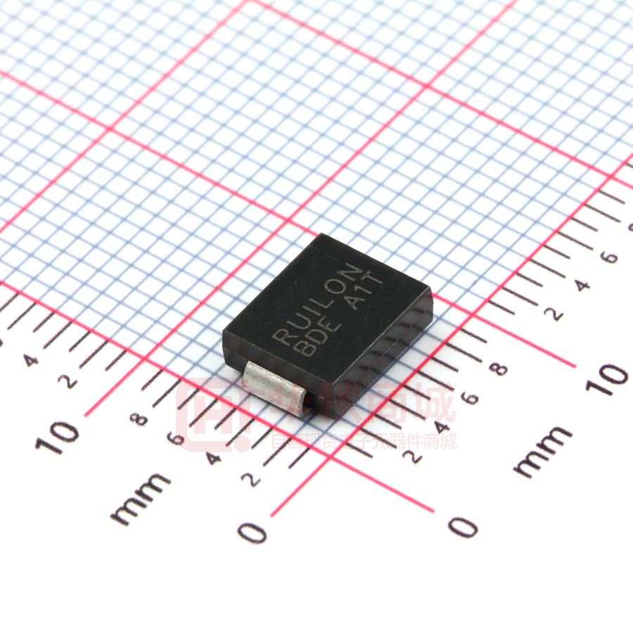

    TVS二极管 VRWM=5V VBR(Min)=6.4V VC=9.2V IPP=163A Ppp=1.5KW SMC
SMCJ5.0CA 数据手册
Transient Voltage Suppressors (TVS) SMCJ Series Description The SMCJ series is designed specifically to protect sensitive electronic equipment from voltage transients induced by lightning and other transient voltage events. Features l Low profile package l Very fast response time l Halogen free and RoHS compliant Electrical symbol l Low incremental surge resistance l Typical IR less than 1μA above 10V l For surface mounted applications to optimize board space l Compatible with industrial standard package DO-214AB BI l 1500W peak pulse power capability with at 10/1000μs waveform, repetition rate (duty cycle): 0.01% l High temperature soldering:260°C/ 10 Anode Cathode seconds at UNI terminals Part Number Code S M C J Series code x x x C Reverse Stand-Off Voltage A 5% Voltage Tolerance Blank:Uni-Directional C:Bi-Directional Mechanical Characteristics Rating Symbol Value Units Peak Pulse Power Dissipation at TA=25ºC by 10/1000μs Waveform (Fig.2)(Note 1), (Note 2) PPP 1500 W Power Dissipation on Infinite Heat Sink at TL=75°C(Fig.6) PD 5.0 W Peak Forward Surge Current, 8.3ms Single Half Sine Wave (Note 3) IFSM 200 A TJ -55 to 150 °C TSTG -55 to 150 °C Operating Temperature Range Storage Temperature Range Notes: 1. Non-repetitive current pulse , per Fig. 4 and derated above TA = 25°C per Fig. 3. 2. Mounted on copper pad area of 0.31x0.31” (8.0 x 8.0mm) to each terminal. 3. Measured on 8.3ms single half sine wave or equivalent square wave for unidirectional device only, duty cycle=4 per minute maximum. Specifications are subject to change without notice. Please refer to http://www.ruilon.com.cn for current information. Revised: 2018-06-22 Page:1 Transient Voltage Suppressors (TVS) SMCJ Series Electrical Characteristics Type Number Reverse Stand-Off Voltage Marking VRWM Breakdown Voltage VBR @IT Min Max Test Current Max. Max. Clamping Peak Pulse Reverse Voltage Current Leakage 10/1000μs 10/1000μs IT VC@IPP IPP IR@VRWM UNI BI UNI BI V V V mA V A µA SMCJ5.0A SMCJ5.0CA GDE BDE 5.0 6.40 7.07 10 9.2 163.0 500 SMCJ6.0A SMCJ6.0CA GDG BDG 6.0 6.67 7.37 10 10.3 145.6 500 SMCJ6.5A SMCJ6.5CA GDK BDK 6.5 7.22 7.98 10 11.2 133.9 300 SMCJ7.0A SMCJ7.0CA GDM BDM 7.0 7.78 8.60 10 12.0 125.0 200 SMCJ7.5A SMCJ7.5CA GDP BDP 7.5 8.33 9.21 1 12.9 116.3 100 SMCJ8.0A SMCJ8.0CA GDR BDR 8.0 8.89 9.83 1 13.6 110.3 50 SMCJ8.5A SMCJ8.5CA GDT BDT 8.5 9.44 10.4 1 14.4 104.2 30 SMCJ9.0A SMCJ9.0CA GDV BDV 9.0 10.0 11.1 1 15.4 97.4 30 SMCJ10A SMCJ10CA GDX BDX 10.0 11.1 12.3 1 17.0 88.2 5 SMCJ11A SMCJ11CA GDZ BDZ 11.0 12.2 13.5 1 18.2 82.4 1 SMCJ12A SMCJ12CA GEE BEE 12.0 13.3 14.7 1 19.9 75.4 1 SMCJ13A SMCJ13CA GEG BEG 13.0 14.4 15.9 1 21.5 69.8 1 SMCJ14A SMCJ14CA GEK BEK 14.0 15.6 17.2 1 23.2 64.7 1 SMCJ15A SMCJ15CA GEM BEM 15.0 16.7 18.5 1 24.4 61.5 1 SMCJ16A SMCJ16CA GEP BEP 16.0 17.8 19.7 1 26.0 57.7 1 SMCJ17A SMCJ17CA GER BER 17.0 18.9 20.9 1 27.6 54.3 1 SMCJ18A SMCJ18CA GET BET 18.0 20.0 22.1 1 29.2 51.4 1 SMCJ20A SMCJ20CA GEV BEV 20.0 22.2 24.5 1 32.4 46.3 1 SMCJ22A SMCJ22CA GEX BEX 22.0 24.4 26.9 1 35.5 42.3 1 SMCJ24A SMCJ24CA GEZ BEZ 24.0 26.7 29.5 1 38.9 38.6 1 SMCJ26A SMCJ26CA GFE BFE 26.0 28.9 31.9 1 42.1 35.6 1 SMCJ28A SMCJ28CA GFG BFG 28.0 31.1 34.4 1 45.4 33.0 1 SMCJ30A SMCJ30CA GFK BFK 30.0 33.3 36.8 1 48.4 31.0 1 SMCJ33A SMCJ33CA GFM BFM 33.0 36.7 40.6 1 53.3 28.1 1 SMCJ36A SMCJ36CA GFP BFP 36.0 40.0 44.2 1 58.1 25.8 1 SMCJ40A SMCJ40CA GFR BFR 40.0 44.4 49.1 1 64.5 23.3 1 SMCJ43A SMCJ43CA GFT BFT 43.0 47.8 52.8 1 69.4 21.6 1 SMCJ45A SMCJ45CA GFV BFV 45.0 50.0 55.3 1 72.7 20.6 1 SMCJ48A SMCJ48CA GJT BJT 48.0 53.3 58.9 1 77.4 19.4 1 SMCJ51A SMCJ51CA GJV BJV 51.0 56.7 62.7 1 82.4 18.2 1 Specifications are subject to change without notice. Please refer to http://www.ruilon.com.cn for current information. Revised: 2018-06-22 Page:2 Transient Voltage Suppressors (TVS) SMCJ Series Electrical Characteristics Type Number Reverse Stand-Off Voltage Marking VRWM Breakdown Voltage VBR @IT Min Max Test Current Max. Max. Clamping Peak Pulse Reverse Voltage Current Leakage 10/1000μs 10/1000μs IT VC@IPP IPP IR@VRWM UNI BI UNI BI V V V mA V A µA SMCJ54A SMCJ54CA GFX BFX 54.0 60.0 66.3 1 87.1 17.2 1 SMCJ58A SMCJ58CA GFZ BFZ 58.0 64.4 71.2 1 93.6 16.0 1 SMCJ60A SMCJ60CA GGE BGE 60.0 66.7 73.7 1 96.8 15.5 1 SMCJ64A SMCJ64CA GGG BGG 64.0 71.1 78.6 1 103.0 14.6 1 SMCJ70A SMCJ70CA GGK BGK 70.0 77.8 86.0 1 113.0 13.3 1 SMCJ75A SMCJ75CA GGM BGM 75.0 83.3 92.1 1 121.0 12.4 1 SMCJ78A SMCJ78CA GGP BGP 78.0 86.7 95.8 1 126.0 11.9 1 SMCJ85A SMCJ85CA GGR BGR 85.0 94.4 104.0 1 137.0 10.9 1 SMCJ90A SMCJ90CA GGT BGT 90.0 100.0 111.0 1 146.0 10.3 1 SMCJ100A SMCJ100CA GGV BGV 100.0 111.0 123.0 1 162.0 9.3 1 SMCJ110A SMCJ110CA GGX BGX 110.0 122.0 135.0 1 177.0 8.5 1 SMCJ120A SMCJ120CA GGZ BGZ 120.0 133.0 147.0 1 193.0 7.8 1 SMCJ130A SMCJ130CA GHE BHE 130.0 144.0 159.0 1 209.0 7.2 1 SMCJ150A SMCJ150CA GHG BHG 150.0 167.0 185.0 1 243.0 6.2 1 SMCJ160A SMCJ160CA GHK BHK 160.0 178.0 197.0 1 259.0 5.8 1 SMCJ170A SMCJ170CA GHM BHM 170.0 189.0 209.0 1 275.0 5.5 1 SMCJ180A SMCJ180CA GHP BHP 180.0 201.0 222.0 1 292.0 5.2 1 SMCJ190A SMCJ190CA GHR BHR 190.0 209.0 243.0 1 308.0 4.8 1 SMCJ200A SMCJ200CA GHX BHX 200.0 224.0 247.0 1 324.0 4.6 1 SMCJ210A SMCJ210CA GHZ BHZ 210.0 231.0 268.0 1 340.0 4.4 1 SMCJ220A SMCJ220CA GJE BJE 220.0 246.0 272.0 1 356.0 4.2 1 SMCJ250A SMCJ250CA GJG BJG 250.0 279.0 309.0 1 405.0 3.7 1 SMCJ300A SMCJ300CA GJK BJK 300.0 335.0 371.0 1 486.0 3.1 1 SMCJ350A SMCJ350CA GJM BJM 350.0 391.0 432.0 1 567.0 2.6 1 SMCJ400A SMCJ400CA GJP BJP 400.0 447.0 494.0 1 648.0 2.3 1 SMCJ440A SMCJ440CA GJR BJR 440.0 492.0 543.0 1 713.0 2.1 1 Notes: For bidirectional type having VR of 10V and less, the IR limit is double. Specifications are subject to change without notice. Please refer to http://www.ruilon.com.cn for current information. Revised: 2018-06-22 Page:3 Transient Voltage Suppressors (TVS) SMCJ Series I-V Curve Characteristics Uni-directional I Bi-directional VC VBR VR IR VF IT IPP IT IR VC VBR VR V IR IT VR VBR VC V IPP IPP PPPM Peak Pulse Power Dissipation -- Max power dissipation VR Stand-off Voltage -- Maximum voltage that can be applied to the TVS without operation VBR Breakdown Voltage -- Maximum voltage that flows though the TVS at a specified test current (IT) VC Clamping Voltage -- Peak voltage measured across the TVS at a specified Ippm (peak impulse current) IR Reverse Leakage Current -- Current measured at VR VF Forward Voltage Drop for Uni-directional Ratings and Characteristic Curves (TA=25°C unless otherwise noted) Figure 1 - TVS Transients Clamping Waveform Figure 2 - Peak Pulse Power Rating Curve 100 PPPM-Peak Pulse Power (kW) Voltage or Current Voltage Transients Voltage Across TVS Current Through TVS TJ initial = Tamb stacked-die, 2kW at 10x1000µs, 25°C 10 Single die, 1.5kW at 10x1000µs, 25°C 1 0.1 Time 0.001 0.01 0.1 1 10 td-Pulse Width (ms) Specifications are subject to change without notice. Please refer to http://www.ruilon.com.cn for current information. Revised: 2018-06-22 Page:4 Transient Voltage Suppressors (TVS) SMCJ Series Ratings and Characteristic Curves (TA=25°C unless otherwise noted) (Continued) Peak Pulse Power (PPP) or Current (IPP) Derating in Percentage % Figure 3 - Pulse Derating Curve Figure 4 - Pulse Waveform 100 150 tr=10μsec IPPM - Peak Pulse Cur rent, % IRSM 80 60 40 20 0 0 25 50 75 100 125 150 TJ =25°C Pulse Width(td) is defined as the point where the peak current decays to 50% of IPPM Peak Value IPPM 100 Half Value IPPM ( IPPM ) 2 50 0 175 10/1000μsec.Waveform as defined by R.E.A td 0 1.0 2.0 3.0 4.0 t-Time(ms) TA-Ambient temperature (ºC) Figure 6 - Steady State Power Derating Curve Figure 5 - Typical Junction Capacitance 10000 Bi-directional V=0V Uni-directional V=0V Cj (pF) 1000 Uni-directional @VR 100 Bi-directional @VR 10 Tj=25ºC f=1.0MHz Vsig=50mVp-p 1 1.0 10.0 100.0 1000.0 PM(AV), Steady State Power Dissipation (W) 100000 5.0 4.0 3.0 2.0 60Hz Resistive or Inductive Load 1.0 0.0 VBR - Reverse Breakdown Voltage (V) 0 25 50 75 100 125 150 TL-Lead Temperature(ºC) 175 200 Figure 7 - Maximum Non-Repetitive Surge Current IFSM - Peak Forward Surve Current (A) 200 180 160 140 120 100 80 60 40 20 0 1 10 100 Number of Cycles at 60 Hz Specifications are subject to change without notice. Please refer to http://www.ruilon.com.cn for current information. Revised: 2018-06-22 Page:5 Transient Voltage Suppressors (TVS) SMCJ Series Soldering Parameters - Reflow Soldering (Surface Mount Devices) Reflow Condition TP Ramp-up Critical Zone TL to TP TL Pre Heat Temperature TS(max) Ramp-down TS(min) Preheat Time to peak temperature (t 25℃ to peak) -Temperature Min (Ts(min)) 150°C -Temperature Max (Ts(max)) 200°C - Time (min to max) (ts) 60 -180 Seconds Average ramp up rate ( Liquids Temp TL) to peak 3°C/second max TS(max) to TL - Ramp-up Rate 3°C/second max Reflo w 25 Pb - Free assembly Time - Temperature (TL) (Liquids) 217°C - Time (min to max) (ts) 60 -150 Seconds Peak Temperature (TP) 260 +0/-5°C Time within 5°C of actual peak Temperature (tp) 20 - 40 Seconds Ramp-down Rate 6°C/second max Time 25°C to peak Temperature (TP) 8 minutes Max Do not exceed 260°C Part Marking System Cathode band(for Uni-directional products only) RUILON XXX XXX Date Code Product Code Marking code Dimensions Cathode Band Specifications are subject to change without notice. Please refer to http://www.ruilon.com.cn for current information. DIM Revised: 2018-06-22 Millimeters Inches Min Max Min Max A 2.75 3.25 0.108 0.128 B 6.50 7.11 0.260 0.280 C 5.50 6.22 0.217 0.246 D 2.06 2.70 0.079 0.106 E 0.76 1.52 0.030 0.060 G 7.40 8.40 0.291 0.331 I 3.300 - 0.129 - J 2.400 - 0.094 - K - 4.200 - 0.165 L 2.400 - 0.094 - Page:6 Transient Voltage Suppressors (TVS) SMCJ Series Taping and Reel Specifications Symbol Millimeters Inches W 16±0.3 0.630±0.012 P 8±0.1 0.315±0.004 F 7.25±0.1 0.285±0.004 E 1.75±0.1 0.069±0.004 D 1.5+0.1/-0.0 0.059+0.004/-0.0 P0 4±0.1 0.157±0.004 P2 2±0.1 0.079±0.004 D0 16.7±0.15 0.657±0.006 D1 178±2 7.007±0.079 D2 59.6+1/-2 2.346+0.039/-0.079 W1 17.2±0.4 0.677±0.016 Direction of Unreeling Part Number Component package Quantity Packaging option Packaging specification SMCJXXXA/CA DO-214AB(SMC) 500 Tape&Reel-16mm/7”tape EIA STD RS-481 Specifications are subject to change without notice. Please refer to http://www.ruilon.com.cn for current information. Revised: 2018-06-22 Page:7
