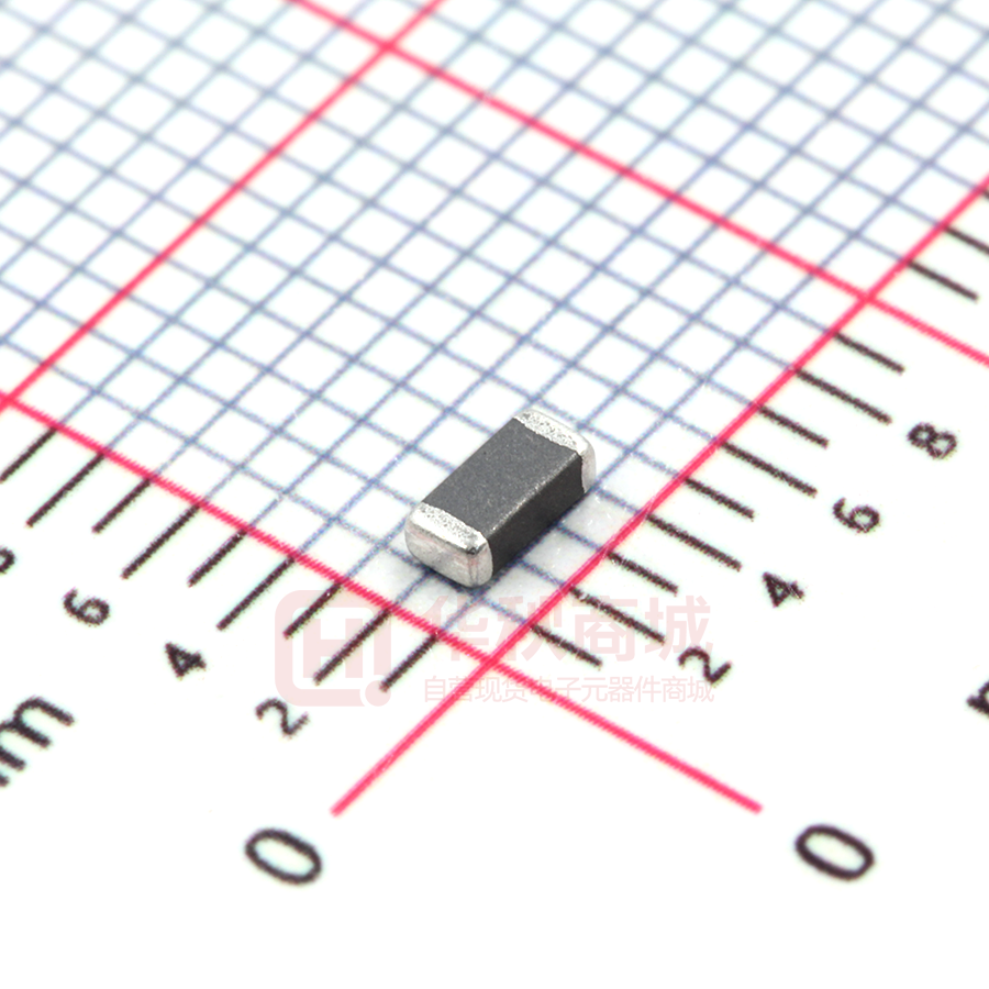

    贴片磁珠 1206 120Ω@100MHz ±25% 30mΩ
HCB3216KF-121T40 数据手册
TAI-TECH KBM01-181000201 P2. High Current Ferrite Chip Bead(Lead Free) HCB3216KF-121T40 1.Features 1. Monolithic inorganic material construction. 2. Closed magnetic circuit avoids crosstalk. Halogen 3. Suitable for reflow soldering. 4. Shapes and dimensions follow E.I.A. spec. Halogen-free 5. Available in various sizes. 6. Excellent solder ability and heat resistance. 7. High reliability. 8.100% Lead(Pb) & Halogen-Free and RoHS compliant. 9. Low DC resistance structure of electrode to prevent wasteful electric power consumption. Pb Pb-free 2.Dimensions Chip Size A 3.20±0.20 B 1.60±0.20 C 1.10±0.20 D 0.50±0.30 Units: mm 3.Part Numbering HCB 3216 KF A B C A: Series B: Dimension C: Material D: Impedance E: Packaging F: Rated Current - 121 T 40 D E F LxW Lead Free Material 121=120Ω T=Taping and Reel, B=Bulk(Bags) 40=4000mA 4.Specification Tai-Tech Part Number Impedance (Ω) HCB3216KF-121T40 ● DC Resistance (Ω) max. Rated Current (mA) max. 60mV/100M 0.03 4000 120±25% Rated current: based on temperature rise test In compliance with EIA 595  Impedance-Frequency Characteristics HCB3216KF-121T40 300 IMPEDANCE(Ohm) ● Test Frequency (Hz) 200 Z 100 X R 0 1 10 100 FREQUENCY(MHz) www.tai-tech.com.tw 1000 TAI-TECH KBM01-181000201 P3. 5. Reliability and Test Condition Item Series No. Operating Temperature Performance FCB FCM HCB Test Condition GHB FCA -55~+125℃ (Including self-temperature rise) -55~+125℃ (on board) Transportation Storage Temperature --- For long storage conditions, please see the Application Notice Agilent4291 Agilent E4991 Impedance (Z) Agilent4287 Refer to standard electrical characteristics list Agilent16192 DC Resistance Agilent 4338 Rated Current DC Power Supply Over Rated Current requirements, there will be some risk Temperature Rise Test Rated Current < 1A ΔT 20℃Max Rated Current ≧ 1A ΔT 40℃Max Life test Appearance: no damage. Impedance: within±15%of initial value. Inductance: within±10%of initial value. Q:Shall not exceed the specification value. RDC:within ±15% of initial value and shall not exceed the specification value Load Humidity Appearance: no damage. Thermal shock Impedance: within±15%of initial value. Inductance: within±10%of initial value. Q:Shall not exceed the specification value. RDC:within ±15% of initial value and shall not exceed the specification value 1. Applied the allowed DC current. 2. Temperature measured by digital surface thermometer. Preconditioning: Run through IR reflow for 2 times.( IPC/JEDEC J-STD-020D Classification Reflow Profiles) Temperature: 125±2℃ Applied current: rated current. Duration: 1000±12hrs. Measured at room temperature after placing for 24±2 hrs. Preconditioning: Run through IR reflow for 2 times.( IPC/JEDEC J-STD-020D Classification Reflow Profiles) Humidity: 85±2%R.H. Temperature: 85±2℃. Duration: 1000hrs Min. with 100% rated current. Measured at room temperature after placing for 24±2 hrs. Preconditioning: Run through IR reflow for 2 times.( IPC/JEDEC J-STD-020D Classification Reflow Profiles) Condition for 1 cycle Step1: -55±2℃ 30±5 min. Step2: 25±2℃ ≦0.5min Step3: +125±2℃ 30±5min. Number of cycles: 500 Measured at room temperature after placing for 24±2 hrs. Appearance:No damage. Impedance:within±15% of initial value Inductance:within±10% of initial value Q:Shall not exceed the specification value. RDC:within ±15% of initial value and shall not exceed the specification value Preconditioning: Run through IR reflow for 2 times.( IPC/JEDEC J-STD-020D Classification Reflow Profiles) Oscillation Frequency: 10~2K~10Hz for 20 minutes Equipment: Vibration checker Total Amplitude:1.52mm±10% Testing Time : 12 hours(20 minutes, 12 cycles each of 3 orientations)。 Bending Appearance:No damage. Impedance:within±10% of initial value Inductance:within±10% of initial value Q:Shall not exceed the specification value. RDC:within ±15% of initial value and shall not exceed the specification value Shall be mounted on a FR4 substrate of the following dimensions: >=0805inch(2012mm):40x100x1.2mm =0805inch(2012mm):1.2mm 0805inch(2012mm):1kg
