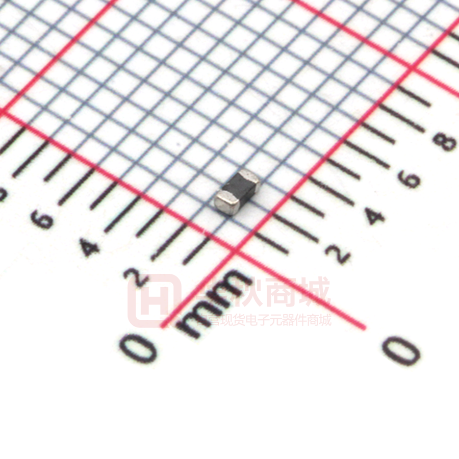

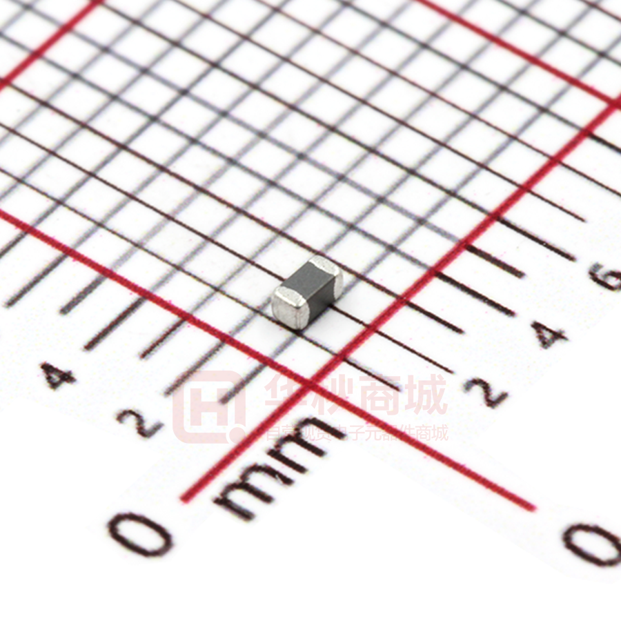

    信号/去耦电感 270nH 50mA ±10% 800mΩ 0603
FCI1608F-R27K 数据手册
TAI-TECH KBM01-171100469 P1. Ferrite Chip Inductor(Lead Free) FCI1608F-Series ECN HISTORY LIST REV DATE DESCRIPTION APPROVED CHECKED DRAWN 楊祥忠 羅培君 張嘉玲 楊祥忠 羅培君 張嘉玲 1.0 13/06/06 變更可靠度條件 2.0 14/01/24 3.0 14/08/01 變更 Reflow 圖示 楊祥忠 羅培君 張嘉玲 3.1 14/08/01 修正包裝帶尺寸 楊祥忠 羅培君 張嘉玲 4.0 14/10/13 訂正 1608 包裝帶 Ao 尺寸 楊祥忠 羅培君 張嘉玲 5.0 16/01/26 楊祥忠 詹偉特 張嘉玲 6.0 17/02/16 修訂 Recommended PC Board Pattern 楊祥忠 詹偉特 張嘉玲 變更電鍍錫層厚度 3.0um min.=>3.5um min. 修訂可靠度 Life Test: (Inductor) Temperature:85±2℃105±2℃. 備 註 www.tai-tech.com.tw TAI-TECH KBM01-171100469 P2. Ferrite Chip Inductor(Lead Free) FCI1608F-Series 1.Features 1. Monolithic inorganic material construction. 2. Closed magnetic circuit avoids crosstalk. 3. S.M.T. type. 4. Suitable for reflow soldering. 5. Shapes and dimensions follow E.I.A. spec. 6. Available in various sizes. 7. Excellent solder ability and heat resistance. 8. High reliability. 9. 100% Lead(Pb) & Halogen-Free and RoHS compliant. Halogen Pb Halogen-free Pb-free 2. Dimensions Chip Size A 1.60±0.15 1.80±0.15 B 0.80±0.15 C 0.80±0.15 D 0.30±0.20 Units: mm 3. Part Numbering FCI 1608 F A B C - 1R8 K D A: Series B: Dimension C: Material D: Inductance E: Inductance Tolerance E LxW Lead Free Material 1R8=1.8uH K=±10%,L=±15%,M=±20% 4.Specification Tai-Tech Inductance(uH) Q Rated Current DCR SRF Test Frequency (MHz) (mA) max. (Ω) max. (MHz) min. Part Number Tolerance Test Frequency (Hz) FCI1608F-47N□ 0.047 60mV / 50M 10 50 50 0.30 260 FCI1608F-68N□ 0.068 60mV / 50M 10 50 50 0.30 250 FCI1608F-82N□ 0.082 60mV / 50M 10 50 50 0.30 245 FCI1608F-R10□ 0.10 60mV / 25M 15 25 50 0.50 240 FCI1608F-R12□ 0.12 60mV / 25M 15 25 50 0.50 205 FCI1608F-R15□ 0.15 60mV / 25M 15 25 50 0.60 180 FCI1608F-R18□ 0.18 60mV / 25M 15 25 50 0.60 165 FCI1608F-R22□ 0.22 60mV / 25M 15 25 50 0.80 150 FCI1608F-R27□ 0.27 60mV / 25M 15 25 50 0.80 136 FCI1608F-R33□ 0.33 60mV / 25M 15 25 35 0.85 125 FCI1608F-R39□ 0.39 60mV / 25M 15 25 35 1.00 110 FCI1608F-R47□ 0.47 60mV / 25M 15 25 35 1.35 105 FCI1608F-R56□ 0.56 60mV / 25M 15 25 35 1.55 95 FCI1608F-R68□ 0.68 60mV / 25M 15 25 35 1.70 80 0.82 60mV / 25M 15 25 35 2.10 75 FCI1608F-R82□ NOTE: □:TOLERANCE min. K=±10%,L=±15%,M=±20% www.tai-tech.com.tw TAI-TECH Tai-Tech KBM01-171100469 P3. Inductance(uH) Q Rated Current ● SRF Part Number Tolerance FCI1608F-1R0□ 1.0 60mV / 10M 30 10 25 0.60 70 FCI1608F-1R5□ 1.5 60mV / 10M 30 10 25 0.80 55 FCI1608F-1R8□ 1.8 60mV / 10M 30 10 25 0.95 50 FCI1608F-2R2□ 2.2 60mV / 10M 30 10 15 1.15 45 FCI1608F-3R3□ 3.3 60mV / 10M 30 10 15 1.55 38 FCI1608F-4R7□ 4.7 60mV / 10M 30 10 15 2.10 33 FCI1608TF-100□ 10 60mV / 2M 30 2 15 2.55 17 min. Test Frequency (MHz) (mA) max. NOTE: □:TOLERANCE K=±10%,L=±15%,M=±20% (1608T) Dimension A=1.8±0.15mm ● DCR Test Frequency (Hz) Rated current: based on temperature rise test In compliance with EIA 595 www.tai-tech.com.tw (Ω) max. (MHz) min. TAI-TECH KBM01-171100469 P3. 5. Reliability and Test Condition Item Series No. Performance FCI FHI Test Condition FCH HCI -40~+105℃ (Including self-temperature rise) Operating Temperature -40~+105℃ (on board) Transportation Storage Temperature --- For long storage conditions, please see the Application Notice Agilent4291 Inductance (Ls) Agilent E4991 Agilent4287 Q Factor Refer to standard electrical characteristics list Agilent16192 DC Resistance Agilent 4338 Rated Current DC Power Supply Over Rated Current requirements, there will be some risk Temperature Rise Test 1. Applied the allowed DC current. 2. Temperature measured by digital surface thermometer. Rated Current < 1A ΔT 20℃Max Rated Current ≧ 1A ΔT 40℃Max Life test Appearance: no damage. Impedance: within±15%of initial value. Inductance: within±10%of initial value. Q:Shall not exceed the specification value. RDC:within ±15% of initial value and shall not exceed the specification value Load Humidity Appearance: no damage. Thermal shock Impedance: within±15%of initial value. Inductance: within±10%of initial value. Q:Shall not exceed the specification value. RDC:within ±15% of initial value and shall not exceed the specification value Vibration Appearance:No damage. Impedance:within±15% of initial value Inductance:within±10% of initial value Q:Shall not exceed the specification value. RDC:within ±15% of initial value and shall not exceed the specification value Bending Appearance:No damage. Impedance:within±10% of initial value Inductance:within±10% of initial value Q:Shall not exceed the specification value. RDC:within ±15% of initial value and shall not exceed the specification value Shock Appearance:No damage. Impedance:within±10% of initial value Inductance:within±10% of initial value Q:Shall not exceed the specification value. RDC:within ±15% of initial value and shall not exceed the specification value Preconditioning: Run through IR reflow for 2 times.( IPC/JEDEC J-STD-020D Classification Reflow Profiles) Temperature: 105±2℃ Applied current: rated current. Duration: 1000±12hrs. Measured at room temperature after placing for 24±2 hrs. Preconditioning: Run through IR reflow for 2 times.( IPC/JEDEC J-STD-020D Classification Reflow Profiles) Humidity: 85±2%R.H. Temperature: 85±2℃. Duration: 1000hrs Min. with 100% rated current. Measured at room temperature after placing for 24±2 hrs. Preconditioning: Run through IR reflow for 2 times.( IPC/JEDEC J-STD-020D Classification Reflow Profiles) Condition for 1 cycle Step1: -40±2℃ 30±5 min. ≦0.5min Step2: 25±2℃ Step3: +105±2℃ 30±5min. Number of cycles: 500 Measured at room temperature after placing for 24±2 hrs. Preconditioning: Run through IR reflow for 2 times.( IPC/JEDEC J-STD-020D Classification Reflow Profiles) Oscillation Frequency: 10 ~ 2K ~ 10Hz for 20 minutes Equipment: Vibration checker Total Amplitude:1.52mm±10% Testing Time : 12 hours(20 minutes, 12 cycles each of 3 orientations)。 Shall be mounted on a FR4 substrate of the following dimensions: >=0805inch(2012mm):40x100x1.2mm =0805inch(2012mm):1.2mm 1GΩ More than 95% of the terminal electrode should be covered with solder. www.tai-tech.com.tw Preheat: 150℃,60sec. Solder: Sn96.5%-Ag3%-Cu0.5% Solder temperature: 245±5℃ Flux for lead free: Rosin. 9.5% Depth: completely cover the termination. Dip time: 4±1sec. TAI-TECH KBM01-171100469 P4. Item Performance Test Condition Number of heat cycles: 1 Resistance to Soldering Heat Appearance:No damage. Impedance:within±15% of initial value Inductance:within±10% of initial value Q:Shall not exceed the specification value. RDC:within ±15% of initial value and shall not exceed the specification value Temperature (°C) Time (s) Temperature ramp/immersion and emersion rate 260 ±5 (solder temp) 10 ±1 25mm/s ±6 mm/s Depth: completely cover the termination Terminal strength Preconditioning: Run through IR reflow for 2 times.( IPC/JEDEC J-STD-020D Classification Reflow Profiles) Component mounted on a PCB apply a force >0805inch(2012mm):1kg
