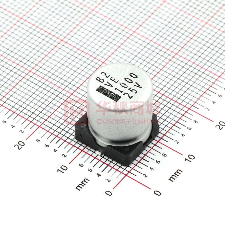

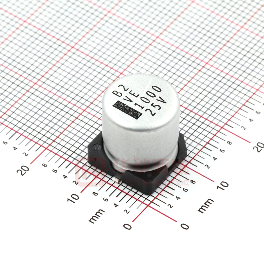

    贴片铝电解电容 SMD,D12.5xL13.5mm 1mF ±20% 25V 2000Hrs@85℃
VE-102M1ETR-1313 数据手册
SMD Aluminum Electrolytic Capacitors VE Features ‧ 3 ~ 18φ, 85℃, 2,000 hours assured ‧ Chip type large capacitance capacitors ‧ Designed for surface mounting on high density PC board ‧ RoHS Compliance Marking color: Black SPECIFICATIONS Items Category Temperature Range Capacitance Tolerance Performance -40℃ ~ +85℃ ±20% Rated Voltage Time Case size Leakage Current (at 20℃) (at 120Hz, 20℃) 6.3 ~ 100V after 2 minutes 160 ~ 450V after 5 minutes 3 ~ 10φ 12.5 ~ 18φ 12.5 ~ 18φ I = 0.01CV or 3µA, I = 0.03CV or 4µA, Leakage Current I = 0.04CV +100µA whichever is greater whichever is greater Where, C = rated capacitance in µF V = rated DC working voltage in V Dissipation Factor (Tanδ at 120Hz, 20℃) Rated Voltage 4 6.3 10 16 25 35 50 63 100 160 ~ 250 400 ~ 450 0.42 0.28 0.24 0.20 0.14 0.12 0.10 0.10 0.10 3 ~ 10φ 0.38 0.34 0.30 0.26 0.22 0.18 0.14 0.10 0.20 0.25 12.5 ~ 16φ When the capacitance exceeds 1,000µF, 0.02 shall be added every 1,000µF increase. Impedance ratio shall not exceed the values given in the table below. Rated Voltage 4.0 6.3 10 16 25 35 50 63 100 160 ~ 250 400 ~ 450 Z(-25℃) φD<12.5 7 4 4 3 2 2 2 2 2 Impedance /Z(+20℃) φD≧12.5 5 5 4 2 2 2 2 2 3 6 Z(-40℃) φD<12.5 15 Ratio 8 5 4 3 3 3 3 3 /Z(+20℃) φD≧12.5 14 12 10 5 4 3 3 3 6 10 Low Temperature Characteristics (at 120Hz) Test Time 2,000 Hrs Capacitance Change Within ±20% of initial value (4V: ±30%) Dissipation Factor Less than 200% of specified value (4V: ±300%) Leakage Current Within specified value * The above specifications shall be satisfied when the capacitors are restored to 20℃after the rated voltage applied for 2,000 hours at 85℃. Test time: 1,000 hours; other items are the same as those for the Endurance. The rated voltage shall be applied to the capacitors before the measurements for 160 ~ 450V (Refer to JIS C 5101-4 4.1). Endurance Shelf Life Test Freq. (Hz) Cap. ( μF) Under 1,000 1,000 < C ≦ 4,700 Ripple Current & Frequency Multipliers 50 120 1k 10k up 0.80 0.85 1.00 1.00 1.25 1.15 1.40 1.25 DIAGRAM OF DIMENSIONS Fig. 1 φD±0.5 Vent≧8φ×10L LEAD SPACING AND DIAMETER B±0.2 W L 0.3 Max A± 0.2 0.4 max P C±0.2 Fig. 2 φD±0.5 Vent B±0.2 W 0.4 Max L A±0.2 1.0 Max P C±0.2 2011 Version φD 3 4 5 6.3 6.3 8 8 10 10 10 12.5 12.5 16 18 L 5.3 ± 0.2 5.3 ± 0.2 5.3 ± 0.2 5.3 ± 0.2 7.7 ± 0.3 10 ± 0.5 10.3 ± 0.5 7.7 ± 0.3 10 ± 0.5 10.3 ± 0.5 13.5 ± 0.5 16 ± 0.5 16.5 ± 0.5 16.5 ± 0.5 A 3.3 4.3 5.3 6.6 6.6 8.4 8.4 10.4 10.4 10.4 13.0 13.0 17.0 19.0 B 3.3 4.3 5.3 6.6 6.6 8.4 8.4 10.4 10.4 10.4 13.0 13.0 17.0 19.0 Unit: mm P ± 0.2 Fig. No. C W 4.1 0.45 ~ 0.75 0.8 1 5.1 0.5 ~ 0.8 1.0 1 6.1 0.5 ~ 0.8 1.5 1 7.4 0.5 ~ 0.8 2.0 1 7.4 0.5 ~ 0.8 2.0 1 9.2 0.7 ~ 1.1 3.1 1 9.2 0.7 ~ 1.1 3.1 1 11.2 0.7 ~ 1.1 4.7 1 11.2 0.7 ~ 1.1 4.7 1 11.2 0.7 ~ 1.1 4.7 1 15.0 1.1 ~ 1.4 4.4 2 15.0 1.1 ~ 1.4 4.4 2 19.0 1.1 ~ 1.4 6.4 2 21.0 1.1 ~ 1.4 6.4 2 SMD Aluminum Electrolytic Capacitors VE MARKING φD = 3 mm Negative polarity φD = 4 ~ 6.3mm Rated cap. 4.7 a16 Negative polarity a1 10 16V Rated voltage Date code φD = 8 ~ 10 mm Date code Negative polarity Rated cap. Rated voltage φD ≧ 12.5mm a1 VE 470 6.3V V. DC Contents 4V (0G) φD×L 6.3V (0J) mA φD×L mA 10V (1A) φD×L mA a1 VE 2200 6.3V Negative polarity Series name Rated cap. Rated voltage Date code Series name Rated cap. Rated voltage Dimension: φD × L(mm) Ripple Current: mA/rms at 120 Hz, 85°C DIMENSION & PERMISSIBLE RIPPLE CURRENT µF Date code 16V (1C) φD×L mA 25V (1E) φD×L mA 35V (1V) φD×L mA 50V (1H) 63 (1J) φD×L mA φD×L mA 0.1 0R1 4×5.3 3 4×5.3 2 0.22 R22 4×5.3 5 4×5.3 3 0.33 R33 4×5.3 6 4×5.3 4 0.47 R47 4×5.3 7 4×5.3 5 1 010 4×5.3 10 4×5.3 8 2.2 2R2 4×5.3 14 4×5.3 12 3.3 3R3 4.7 4R7 10 100 22 33 47 68 220 330 470 3×5.3 3×5.3 4×5.3 4×5.3 16 31 34 16 3×5.3 14 3×5.3 14 4×5.3 17 5×5.3 22 3×5.3 14 3×5.3 14 4×5.3 26 4×5.3 26 4×5.3 20 5×5.3 25 4×5.3 26 4×5.3 26 5×5.3 44 5×5.3 44 5×5.3 35 6.3×5.3 40 30 44 47 59 55 67 75 98 5×5.3 6.3×5.3 6.3×5.3 6.3×7.7 47 59 67 85 6.3×5.3 6.3×7.7 50 65 8×10 139 6.3×7.7 75 8×10 139 6.3×7.7 98 6.3×7.7 8×10 75 190 10×10 200 26 5×5.3 44 4×5.3 5×5.3 4×5.3 31 4×5.3 5×5.3 31 55 5×5.3 55 4×5.3 5×5.3 5×5.3 6.3×5.3 34 55 58 89 6.3×5.3 75 5×5.3 6.3×5.3 55 75 5×5.3 6.3×5.3 5×5.3 6.3×5.3 6.3×5.3 6.3×7.7 5×5.3 6.3×5.3 6.3×5.3 6.3×7.7 58 89 89 109 6.3×5.3 89 6.3×7.7 109 6.3×7.7 109 8×10 190 10×10 226 6.3×5.3 6.3×7.7 89 109 6.3×7.7 109 8×10 252 8×10 190 10×10 226 6.3×7.7 8×10 8×10 10×7.7 124 270 290 290 8×10 10×7.7 270 270 10×7.7 8×10 10×10 252 270 370 10×10 320 12.5×13.5 500 10×10 400 10×10.3 400 12.5×13.5 600 12.5×16 600 10×10 400 10×10 400 12.5×13.5 750 12.5×16 740 16×16.5 850 10×10 410 12.5×13.5 680 12.5×13.5 680 16×16.5 1,000 18×16.5 1,100 18×16.5 1,350 4×5.3 680 5×5.3 58 100 101 5×5.3 6.3×5.3 58 89 6.3×5.3 89 150 151 220 221 6.3×5.3 6.3×7.7 89 124 6.3×5.3 6.3×7.7 89 124 6.3×7.7 8×10 124 270 330 331 6.3×7.7 124 6.3×7.7 124 8×10 290 470 471 8×10 290 8×10 290 680 681 10×7.7 290 10×7.7 10×10 10×10 290 400 410 1,000 102 10×10 430 10×10 430 12.5×13.5 750 12.5×13.5 750 16×16.5 1,100 2,200 222 12.5×13.5 890 12.5×13.5 890 16×16.5 1,100 16×16.5 1100 18×16.5 1,450 3,300 332 12.5×16 1,000 16×16.5 1,300 16×16.5 1,300 18×16.5 1,450 4,700 472 16×16.5 1,400 16×16.5 1,400 18×16.5 1,600 6,800 682 18×16.5 1,700 18×16.5 1,700 V. DC µF Contents 100V (2A) φD×L mA 160V (2C) φD×L 4.7 4R7 10 100 8×10 90 22 220 8×10 90 33 330 10×10 120 12.5×13.5 47 470 10×10 120 mA 200V (2D) φD×L mA 250V (2E) φD×L mA 400V (2G) 450V (2W) φD×L mA φD×L mA 12.5×13.5 120 12.5×13.5 120 12.5×13.5 150 12.5×13.5 120 12.5×16 130 12.5×13.5 240 12.5×13.5 150 16×16.5 140 16×16.5 140 290 12.5×16 310 12.5×16 240 16×16.5 140 18×16.5 180 12.5×16 370 16×16.5 420 16×16.5 340 18×16.5 280 18×16.5 440 68 680 12.5×13.5 380 16×16.5 500 16×16.5 420 100 101 12.5×13.5 440 18×16.5 650 18×16.5 550 220 221 16×16.5 600 330 331 18×16.5 780 2011 Verison
