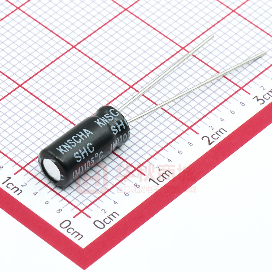

    直插铝电解电容 插件,D5xL11mm 10µF ±20% Ф5.00 x 11.00mm 50V 50mA 5000Hrs@105℃
01EC1809SHC10UF50V 数据手册
SHC Series Aluminum Electrolytic Capacitors Item Name SHC1H100M-0511 Rating SHC50V10μF Case size Φ5*11L KNSCHA Lifetime 5000 hours 1. Operating Temp. Range -40℃ ~ + 105℃ 2. Electrical Characteristics 【Table 1】 Rated Voltage VDC Surge Voltage VDC 50 63 Nominal Tolerance Dissipation Leakage Static on Factor Current Capacitance Capacitance(%) (tanδ)max 2min. 20℃ (μF) 20℃ 120Hz 20℃ 120Hz (μA)max 10 -20~+20 Permissible Ripple Current (mArms)max 105℃120Hz 5 0.10 50 3. Dimensions Rubber Bung Sleeve Фd=0.05 Tinned copper-ply wire φd Safety Vent φ6.3 or over F±0.5 ФD+αmax 15min. L+βmax. Unit(mm) φD+0.5Max 5 φD+0.5 4min. L+1Max 11 F±0.5 2.0 d±0.05 0.5 4. Marking Following items are printed with white color on black color sleeve ① Rated voltage & Nominal Capacitance ② Polarity (negative) ③ Trade Mark ④ Symbol of Capacitance Tolerance (M) ⑤ Max Operating Temp. Example of Marking 50V 10μF ① ② KNSCHA SHC (M )105℃ ③ ④⑤ 5.MULTIPLIER FOR RIPPLE CURRENT ①. Frequency Coefficient Freq.(Hz) 120 60(50) Cap(μF) 0.75 1.00 0.1-47 0.80 1.00 68-680 1000-22000 0.85 1.00 ②. Temperature Coefficient Ambient 40 60 Temperature(℃) Coefficient 2.40 2.10 300 1K 10K 1.35 1.25 1.10 1.55 1.34 1.13 2.00 1.50 1.15 70 85 105 1.78 1.65 1.00 No,KNS-20200320004 (1/5) 6. No. Characteristics Item 1 Leakage Current Performance I= 5.0 μA Test Method (I=0.01CV) I= Max Leakage Current C=Ctatic Capacitor: V=Rated Voltage Protection Resistor : 1000±10Ω Applied Volt : Rated Voltage Mesauring time : 2minutes Measured Frequency : 120Hz±20% 2 Static Capacitance 3 Dissiption Factor (tanδ) 8 ~ 12 μF Measured Voltage ≤ 0.5Vrms, 1.5 ~ 2.0VDC 0.10 and Under Same as condition of Capacitors 4 High Temp. Load Characteristics Leakage Current Cap. Change Dissipation Factor Appearance ≦the value specified in Table 1 Test Temp. : 105±2℃ Applied voltage: Rated voltage ≦±20% of initial value ≦200% of value specified in Table 1 Test Time :2,000 hours No remarkable abnormality +72, -0 hours 5 High Temp. no load Characteristics Leakage Current Cap. Change Dissipation Factor Appearance ≦the value specified in Table 1 Test Temp. : 105±2℃ No voltage applied ≦±20% of initial value ≦200% of value specified in Table 1 Test Time :1000 hours No remarkable abnormality +24, -0 hurs 6 Terminal Strength Tensile Strength Bending Strength 7 Impedance Ratio 45N {4.5kg} 25N {2.5kg} WV Z-25℃/Z+20℃ Z-40℃/Z+20℃ Keeping time Tensile 1~5sec Bending 30±5sec 50 2 3 8 Temperature Stage Item Charac 2,3 Impedance Ratio teristics 5 Cap, Change Performance Stage Test Temp(℃) 20±2 less than the value mentioned in 5-7, 1 -25±3; ≤±25% against value in stage 4 2 -25±3; 3 20±2 4 105±2 After the capacitor is held at tempereture of each stage 5 20±2 and reaches temperature stability, measure performance. 6 9 Surge Voltage Item Leakage Current Cap, Change Dissipation Factor Appearance Perforemance ≤ the initial specified value ≤ ±15% against value before test ≤ the initial specified value No remakable abnormality Test Temp. 15~35℃ Test volt. Surge Volt.Specified in 2 Voltage apply. 1,000times of chage for 30±5sec, under frequency of 6±0.5sec, and discharge for 5min30sec. No,KNS-20200320004 (2/5) 6-2. Characteristics No. Item Performance 10 Vibration Resistance Test Method Stability required Capacitance ≤±5% of the initial specified value Cap. Change Appearance No remarkable abnormality Frequency : 10~55Hz/1min. Width of vibration, 1.5mm Direction and duration X, Y and Z directions, each for 2 hours (Total 9 hours) 11 Solderbility 3/4 area of surrounding directions of surface should be covered with new solder. Solder: Sn-Ag, Sn-Cu Type Soldering Temp : 240±5℃ Dipping degree : 2~2.5mm Flux : Ethanol solution (JIS K8101) or Isopropylalchol (JIS K8839) solution of Rosin (JIS K5902) 12 Resistance to Soldering Leakage Current Cap. Change Dissipation Factor Appearance ≦ Initial specified value ≦±10% of initial value ≦ Initial specified in value No remarkable abnormality Soldering Temp. 280±5℃ Soldering Time . 10±1sec. 13 Resistance to Humidity Leakage Current Cap. Change Dissipation Factor Appearance ≦ Initial specified value ≦±15% of initial value ≦ Initial spesified value No remarkable abnormality Test Temp. : 40±2℃ Humidity 90~95% Test Time : 500 ± 8 hours After the above condition,restored to normal temp, and then measured. 14 Perssure valve There must not be thing ignition, scattering moment the resolution that that case works safely characterstics Dcmethod: impress the reverse voltage and of 1A, I cancel an electric current. 7 Packing method Packaging shape, size, quantity Component Quanity size per 5*11 40000PCS H L W 8 Related Standards JIS C 5141 9 Marking on packing box ① ② ③ ④ ⑤ ⑥ ⑦ Item name Series name Rated Voltage Nominal Static Capacitance Case size Lot No. Quantity No,KNS-20200320004 (3/5) 10 Soldeing 10-1 10-2 11 Soldering by soldering iron Temperature of iron top : 270~350℃ Operating time : within 3 sec. Flow soldering. Preheat : PCB surface temperature 120℃±5℃ Solder Temp : 260℃±5℃ Solder Dipping Temp. : 2~4sec. Cleaning of PC boad after soldering Using follwing solvents is possible but make sure followingcondition Solvent IPA or Alcoholic agent like Pinealpha ST-100S, Cleanthrough 750H, 750L, 710M, 750K, or Technocare FRW-14~17 ① Cleaning should be made by ultrasonic within 5min, at the temperature less then 60℃. ② Control of pollution is necessary (conductivity,pH, specific gravity, water volume) ③ Please do not keep near cleaning agent. Please do not store in air-tight container. Please let it dry by hot air at the temperature less than maximum operating temp. 12 13 14 The situation of using Please do not use a condenser in the next use environment. ① One circumference environment(weatherability) condition. (a) Direct water,salt water and environment oil works or become a dew condensation state. (b) Environment full of harmful gas (a hydrogen chloride, sulfurous acid. nitrous acid hydrochloric acid, ammonia). (c) Ozone, infrared rays and the environment where radioactive rays are done collation of ② Vibration shock condition is extreme environment more than rule ranges of delivery specifications. A country of origin A country of origin of an SHC series alminum electrolysis condenser of specifications: China Effective life for storage Storage conditions: ① Temperature range must be between 5-35℃ ② Relative humidity must be less than 75% ③ Must be stored indoor ④ Must be free from water, oil or salt water ⑤ Must be free from toxic gasses (hydrogen sulfide, sulfurous acid, chlorine, ammonium, etc.) ⑥ Must be free from ozone, ultraviolet rays or any other radiation ⑦ Must be kept in capacitor original package Ⅰ Storage life is 12 months for capacitor of rated voltage ≤ 160V Ⅱ Storage life is 6 months for capacitor of rated voltage ≥ 200V No,KNS-20200320004 (4/5) Aluminum Electrolytic Capacitor SHC Series Structure Safety Vent (≧φ6.3) ① ② No. ① ③ Name Case ⑤ ④ Material Aluminum Element (Electrode) High Purity Aluminum foil ② (Separator) Manila hemp pulp (Electrolyte) --- ③ Rubber Bung Synthetic Rubber ④ Sleeve PET ⑤ Lead Wire Tin plated Steel Wire Controls of ozone layer destructive chemical materials Regulated materials : CFCs, Halon, Carbon Tetrachloride, 1.1.1-Trichloroethane The products and parts do not include the above materials The products and parts are not used the above materials on process. The products and parts are not used PBBOs (Poly Bromo Bi-phenyl Oxides ). All materials are mentioned as existing chemical material in the "Law of examine and control of Production of Chemical Material" The products are not listed in Appendix 1 of Export Trade Rule and Regulation A condenser of this series supports RoHS regulation. No,KNS-20200320004 (5/5)
