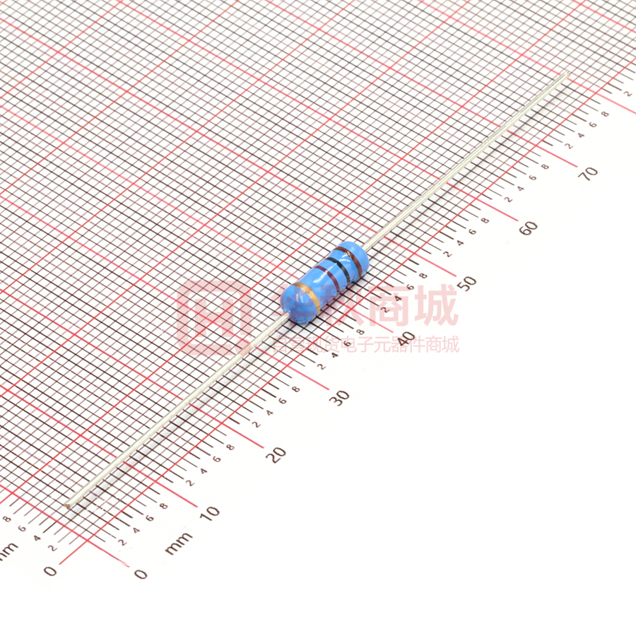

    金属膜电阻 AXIAL_D4.5X11.5MM_TM 1KΩ ±5% 2W
MFR2WSJT-73-1K 数据手册
Through-hole resistors General Type Metal Film Resistors Normal & Miniature Style [ MFR Series ] FEATURES Power Rating 1/6W, 1/4W, 1/2W, 1W, 2W, 3W Resistance Tolerance ±0.5%, ±1%, ±5% T.C.R. ±15ppm/°C, ±25ppm/°C, ±50ppm/°C, ±100ppm/°C DERATING CURVE For resistors operated in ambient temperatures above 70°C, power rating must be derated in accordance with the curve below. INTRODUCTION The MFR Series Metal Film Resistors are manufactured using a vacuum sputtering system to deposit multiple layers of mixed metal alloys and passivative materials onto a carefully treated high grade ceramic substrate. After a helical groove has been cut in the resistive layer, tinned connecting leads of electrolytic copper are welded to the end-caps. The resistors are coated with layers of blue color lacquer. Rated Load (%) 70 155 °C 100 80 60 40 20 20 40 60 80 100 120 140 160 Ambient Temperature (°C) DIMENSIONS Unit: mm STYLE ød H L øD DIMENSION Normal Miniature L øD H ød MFR-12 MFR25S 3.4±0.3 1.9±0.2 28±2.0 0.45±0.05 MFR-25 MFR50S 6.3±0.5 2.4±0.2 28±2.0 0.55±0.05 MFR-50 MFR1WS 9.0±0.5 3.3±0.3 26±2.0 0.55±0.05 MFR100 MFR2WS 11.5±1.0 4.5±0.5 35±2.0 0.8±0.05 MFR200 MFR3WS 15.5±1.0 5.0±0.5 33±2.0 0.8±0.05 5 Note: ELECTRICAL CHARACTERISTICS STYLE MFR-12 MFR25S Power Rating at 70°C 1/6W 1/4W Maximum Working Voltage 200V 250V 300V 350V 400V 500V Maximum Overload Voltage 400V 500V 600V 700V 800V 1,000V Voltage Proof on Insulation 300V 700V 1,000V Resistance Range 1Ω - 10MΩ & 0Ω for E24 & E96 series value Operating Temp. Range -55°C to +155°C Temperature Coefficient ±15ppm/°C, ±25ppm/°C, ±50ppm/°C, ±100ppm/°C 400V MFR-25 MFR50S MFR-50 1/2W 500V MFR1WS MFR100 MFR2WS MFR200 MFR3WS 1W 2W 3W Note: Special value is available on request ENVIRONMENTAL CHARACTERISTICS PERFORMANCE TEST TEST METHOD APPRAISE Short Time Overload IEC 60115-1 4.13 2.5 times RCWV for 5 Sec. ±0.25%+0.05Ω Voltage Proof on Insulation IEC 60115-1 4.7 in V-block for 60 Sec., test voltage by type By type Temperature Coefficient IEC 60115-1 4.8 -55°C to +155°C By type Insulation Resistance IEC 60115-1 4.6 in V-block for 60 Sec. >10,000MΩ Solderability IEC 60115-1 4.17 235±5°C for 3±0.5 Sec. 95% Min. coverage Solvent Resistance of Marking IEC 60115-1 4.30 IPA for 5±0.5 Min. with ultrasonic No deterioration of coatings and markings Robustness of Terminations IEC 60115-1 4.16 Direct load for 10 Sec. in the direction of the terminal leads ≥2.5kg (24.5N) Periodic-pulse Overload IEC 60115-1 4.39 4 times RCWV 10,000 cycles (1 Sec. on, 25 Sec. off) ±1.0%+0.05Ω Damp Heat Steady State IEC 60115-1 4.24 40±2°C, 90-95% RH for 56 days, loaded with 0.1 times RCWV ±1.5%+0.05Ω Endurance at 70°C IEC 60115-1 4.25 70±2°C at RCWV for 1,000 Hr. (1.5 Hr. on, 0.5 Hr. off) ±1.5%+0.05Ω Temperature Cycling IEC 60115-1 4.19 -55°C  Room Temp.  +155°C  Room Temp. (5 cycles) ±0.75%+0.05Ω Resistance to Soldering Heat IEC 60115-1 4.18 260±3°C for 10±1 Sec., immersed to a point 3±0.5mm from the body ±0.25%+0.05Ω Note: RCWV(Rated Continuous Working Voltage) = Power Rating x Resistance Value or Max. working voltage listed above, whichever less. Revision: 201304 88 Explanations Of Ordering Code MFR -12 F Code 7 Tolerance T F Code 8 Packing Style Code 9 Temperature Coefficient of Resistance Code 1 - 3 Series Name Code 4 - 6 Power Rating See Index -05 = ød0.5mm P = ±0.02 % T = Tape/Box -06 = ød0.6mm A = ±0.05 % R = Tape/Reel - = Base on Spec. -07 = ød0.7mm B = ±0.1 % B = Bulk 52- 100R Code 10 - 12 Forming Type Code 13 - 17 Resistance Value 26- = 26mm 0R1 = 0.1 52- = 52.4mm 100R = 100 A = ±5 ppm/°C 73- = 73mm 10K = 10,000 81- = 81mm 10M = 10,000,000 -08 = ød0.8mm C = ±0.25% B = ±10 ppm/°C -10 = ød1.0mm D = ±0.5 % C = ±15 ppm/°C 91- = 91mm -14 = ød1.4mm F = ±1 % S = ± 20ppm/°C F = F Type -12 = 1/6W G = ±2 % D = ±25 ppm/°C FK = FK Type -25 = 1/4W J = ±5 % E = ±50 ppm/°C FKK = FKK Type 25S = 1/4WS K = ±10 % F = ±100 ppm/°C FFK = F-form Kink -50 = 1/2W - = Base on Spec. G = ±200 ppm/°C M = M-Type Forming 50S = 1/2WS H = ±250 ppm/°C MB = M-form W/flat 100 = 1W I = ±300 ppm/°C MT = MT Type Forming 1WS = 1WS J = ±350 ppm/°C MR = MR Type 200 = 2W AV = AVIsert 2WS = 2WS PN = PANAsert 204 = 0.4W 207 = 0.6W 300 = 3W 3WS = 3WS 3WM = 3WM 400 = 4W 500 = 5W 5WS = 5WS 5SS = 5WSS 700 = 7W 7WS = 7WS 10A = 10W 20A = 20W 30A = 30W 40A = 40W 50A = 50W 10S = 10WS 15A = 15W 25A = 25W 10B = 100W 25B = 250W EXCEPTION: • Cement series: • JPW series: : Special packing style code B: B  ulk with wirewound or metal oxide sub-assembly for resistance value W: Bulk with ceramic based wirewound sub-assembly for resistance value M: Bulk with metal oxide sub-assembly for resistance value F: Bulk with Fiberglass based wirewound sub-assembly for resistance value : Without forming code Example: SQP500JB-10R : without resistance value code Example: JPW-06-T-52-

物料型号:MFR系列金属膜电阻器
器件简介:MFR系列金属膜电阻器采用真空溅射系统在经过精细处理的高等级陶瓷基板上沉积多层混合金属合金和被动材料。在电阻层上切割螺旋槽后,将镀锡的电解铜连接引线焊接到端盖。电阻器涂有蓝色漆层。
引脚分配:文档中没有明确说明引脚分配
参数特性: - 功率等级:1/6W, 1/4W, 1/2W, 1W, 2W, 3W - 电阻公差:±0.5%, ±1%, ±5% - 温度系数:±15ppm/°C, 25ppm/°C, 50ppm/°C, ±100ppm/°C
功能详解:文档中没有提供详细的功能解释。
应用信息:文档中没有提供具体的应用信息
封装信息:提供了不同尺寸的封装信息,包括Normal和Miniature两种风格,以及具体的尺寸数据。
