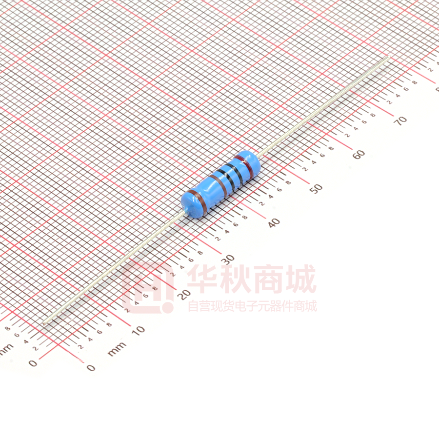

    插件,D5xL15.5mm
    插件电阻 2KΩ ±1% 3W ±50ppm/℃
MFR3WSFTE73-2K 数据手册
Through-hole resistors General Type Metal Film Resistors Normal & Miniature Style [ MFR Series ] FEATURES Power Rating 1/6W, 1/4W, 1/2W, 1W, 2W, 3W Resistance Tolerance ±0.5%, ±1%, ±5% T.C.R. ±15ppm/°C, ±25ppm/°C, ±50ppm/°C, ±100ppm/°C DERATING CURVE For resistors operated in ambient temperatures above 70°C, power rating must be derated in accordance with the curve below. INTRODUCTION The MFR Series Metal Film Resistors are manufactured using a vacuum sputtering system to deposit multiple layers of mixed metal alloys and passivative materials onto a carefully treated high grade ceramic substrate. After a helical groove has been cut in the resistive layer, tinned connecting leads of electrolytic copper are welded to the end-caps. The resistors are coated with layers of blue color lacquer. Rated Load (%) 70 155 °C 100 80 60 40 20 20 40 60 80 100 120 140 160 Ambient Temperature (°C) DIMENSIONS Unit: mm STYLE ød H L øD DIMENSION Normal Miniature L øD H ød MFR-12 MFR25S 3.4±0.3 1.9±0.2 28±2.0 0.45±0.05 MFR-25 MFR50S 6.3±0.5 2.4±0.2 28±2.0 0.55±0.05 MFR-50 MFR1WS 9.0±0.5 3.3±0.3 26±2.0 0.55±0.05 MFR100 MFR2WS 11.5±1.0 4.5±0.5 35±2.0 0.8±0.05 MFR200 MFR3WS 15.5±1.0 5.0±0.5 33±2.0 0.8±0.05 5 Note: ELECTRICAL CHARACTERISTICS STYLE MFR-12 MFR25S Power Rating at 70°C 1/6W 1/4W Maximum Working Voltage 200V 250V 300V 350V 400V 500V Maximum Overload Voltage 400V 500V 600V 700V 800V 1,000V Voltage Proof on Insulation 300V 700V 1,000V Resistance Range 1Ω - 10MΩ & 0Ω for E24 & E96 series value Operating Temp. Range -55°C to +155°C Temperature Coefficient ±15ppm/°C, ±25ppm/°C, ±50ppm/°C, ±100ppm/°C 400V MFR-25 MFR50S MFR-50 1/2W 500V MFR1WS MFR100 MFR2WS MFR200 MFR3WS 1W 2W 3W Note: Special value is available on request ENVIRONMENTAL CHARACTERISTICS PERFORMANCE TEST TEST METHOD APPRAISE Short Time Overload IEC 60115-1 4.13 2.5 times RCWV for 5 Sec. ±0.25%+0.05Ω Voltage Proof on Insulation IEC 60115-1 4.7 in V-block for 60 Sec., test voltage by type By type Temperature Coefficient IEC 60115-1 4.8 -55°C to +155°C By type Insulation Resistance IEC 60115-1 4.6 in V-block for 60 Sec. >10,000MΩ Solderability IEC 60115-1 4.17 235±5°C for 3±0.5 Sec. 95% Min. coverage Solvent Resistance of Marking IEC 60115-1 4.30 IPA for 5±0.5 Min. with ultrasonic No deterioration of coatings and markings Robustness of Terminations IEC 60115-1 4.16 Direct load for 10 Sec. in the direction of the terminal leads ≥2.5kg (24.5N) Periodic-pulse Overload IEC 60115-1 4.39 4 times RCWV 10,000 cycles (1 Sec. on, 25 Sec. off) ±1.0%+0.05Ω Damp Heat Steady State IEC 60115-1 4.24 40±2°C, 90-95% RH for 56 days, loaded with 0.1 times RCWV ±1.5%+0.05Ω Endurance at 70°C IEC 60115-1 4.25 70±2°C at RCWV for 1,000 Hr. (1.5 Hr. on, 0.5 Hr. off) ±1.5%+0.05Ω Temperature Cycling IEC 60115-1 4.19 -55°C  Room Temp.  +155°C  Room Temp. (5 cycles) ±0.75%+0.05Ω Resistance to Soldering Heat IEC 60115-1 4.18 260±3°C for 10±1 Sec., immersed to a point 3±0.5mm from the body ±0.25%+0.05Ω Note: RCWV(Rated Continuous Working Voltage) = Power Rating x Resistance Value or Max. working voltage listed above, whichever less. Revision: 201304 88 Explanations Of Ordering Code MFR -12 F Code 7 Tolerance T F Code 8 Packing Style Code 9 Temperature Coefficient of Resistance Code 1 - 3 Series Name Code 4 - 6 Power Rating See Index -05 = ød0.5mm P = ±0.02 % T = Tape/Box -06 = ød0.6mm A = ±0.05 % R = Tape/Reel - = Base on Spec. -07 = ød0.7mm B = ±0.1 % B = Bulk 52- 100R Code 10 - 12 Forming Type Code 13 - 17 Resistance Value 26- = 26mm 0R1 = 0.1 52- = 52.4mm 100R = 100 A = ±5 ppm/°C 73- = 73mm 10K = 10,000 81- = 81mm 10M = 10,000,000 -08 = ød0.8mm C = ±0.25% B = ±10 ppm/°C -10 = ød1.0mm D = ±0.5 % C = ±15 ppm/°C 91- = 91mm -14 = ød1.4mm F = ±1 % S = ± 20ppm/°C F = F Type -12 = 1/6W G = ±2 % D = ±25 ppm/°C FK = FK Type -25 = 1/4W J = ±5 % E = ±50 ppm/°C FKK = FKK Type 25S = 1/4WS K = ±10 % F = ±100 ppm/°C FFK = F-form Kink -50 = 1/2W - = Base on Spec. G = ±200 ppm/°C M = M-Type Forming 50S = 1/2WS H = ±250 ppm/°C MB = M-form W/flat 100 = 1W I = ±300 ppm/°C MT = MT Type Forming 1WS = 1WS J = ±350 ppm/°C MR = MR Type 200 = 2W AV = AVIsert 2WS = 2WS PN = PANAsert 204 = 0.4W 207 = 0.6W 300 = 3W 3WS = 3WS 3WM = 3WM 400 = 4W 500 = 5W 5WS = 5WS 5SS = 5WSS 700 = 7W 7WS = 7WS 10A = 10W 20A = 20W 30A = 30W 40A = 40W 50A = 50W 10S = 10WS 15A = 15W 25A = 25W 10B = 100W 25B = 250W EXCEPTION: • Cement series: • JPW series: : Special packing style code B: B  ulk with wirewound or metal oxide sub-assembly for resistance value W: Bulk with ceramic based wirewound sub-assembly for resistance value M: Bulk with metal oxide sub-assembly for resistance value F: Bulk with Fiberglass based wirewound sub-assembly for resistance value : Without forming code Example: SQP500JB-10R : without resistance value code Example: JPW-06-T-52-
