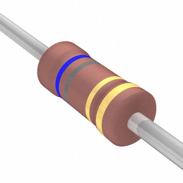

    金属膜电阻 AXIAL_D5X15.5MM_TM 6.8Ω ±5% 3W
FMP300JR-73-6R8 数据手册
Through-hole resistors High Power & Flame-Proof Type Metal Film Resistors Ultra Miniature Style [ FMP Series ] FEATURES Power Rating 1/2W, 1W, 2W, 3W Resistance Tolerance ±1%, ±5% T.C.R. ±100ppm/°C Flameproof Multi-layer Coating Meets UL-94V-0 Flameproof Feature Meets Overload Test UL-1412 INTRODUCTION DERATING CURVE The FMP Series Metal Film High Power Resistors are manufactured using a vacuum sputtering system to deposit multiple layers of mixed metal alloys and passivative materials onto a carefully treated high grade ceramic substrate. After a helical groove has been cut in the resistive layer, tinned connecting leads of electrolytic copper are welded to the end-caps. The resistors are coated with layers of pink color lacquer. For resistors operated in ambient temperatures above 70°C, power rating must be derated in accordance with the curve below. 70 Rated Load (%) 155 °C 100 80 60 40 20 20 40 60 80 Ambient Temperature (°C) 100 120 140 160 DIMENSIONS Unit: mm ød H L øD STYLE DIMENSION Ultra Miniature L øD H ød FMP-50 3.4±0.3 1.9±0.2 28±2.0 0.45±0.05 FMP100 6.3±0.5 2.4±0.2 28±2.0 0.55±0.05 FMP200 9.0±0.5 3.9±0.3 26±2.0 0.55±0.05 FMP3WS 11.5±1.0 4.5±0.5 35±2.0 0.8±0.05 FMP300 15.5±1.0 5.0±0.5 33±2.0 0.8±0.05 15 Note: ELECTRICAL CHARACTERISTICS STYLE FMP-50 FMP100 FMP200 FMP3WS FMP300 Power Rating at 70°C 1/2W 1W 2W 3W Maximum Working Voltage 200V 350V 500V 750V Maximum Overload Voltage 400V 600V 700V 1,000V Voltage Proof on Insulation 300V 500V Resistance Range 1Ω - 4M7Ω & for E24 & E96 series value Operating Temp. Range -55°C to +155°C Temperature Coefficient ±100ppm/°C , ±50ppm/°C (FMP-50 & FMP100 types, R ≥ 10RΩ) Note: Special value is available on request ENVIRONMENTAL CHARACTERISTICS PERFORMANCE TEST TEST METHOD APPRAISE Short Time Overload IEC 60115-1 4.13 2.5 times RCWV for 5 sec. (Not more than maximum Overload Voltage) ±1.0%+0.05Ω Voltage Proof on Insulation IEC 60115-1 4.7 In V-Block for 60 sec., test voltage as above table No Breakdown Temperature Coefficient IEC 60115-1 4.8 Between -55°C to +155°C By type Insulation Resistance IEC 60115-1 4.6 in V-block for 60 Sec. >1,000MΩ Solderability IEC 60115-1 4.17 245±5°C for 3±0.5 Sec. 95% Min. coverage Solvent Resistance of Marking IEC 60115-1 4.30 IPA for 5±0.5 Min. with ultrasonic No deterioration of coatings and markings Robustness of Terminations IEC 60115-1 4.16 Direct load for 10 Sec. in the direction of the terminal leads ≥2.5kg (24.5N) Periodic-pulse Overload IEC 60115-1 4.39 4 times RCWV 10,000 cycles (1 Sec. on, 25 Sec. off) ±1.0%+0.05Ω Damp Heat Steady State IEC 60115-1 4.24 40±2°C, 90-95% RH for 56 days, loaded with 0.1 times RCWV ±2.0%+0.05Ω Endurance at 70°C IEC 60115-1 4.25 70±2°C at RCWV (or Umax., Whichever less) for 1,000 Hr. (1.5Hr.on, 0.5Hr. Off) ±2.0%+0.05Ω Temperature Cycling IEC 60115-1 4.19 -55°C  Room Temp.  +155°C  Room Temp. (5 cycles) ±1.0%+0.05Ω Resistance to Soldering Heat IEC 60115-1 4.18 260±3°C for 10±1 Sec., immersed to a point 3±0.5mm from the body ±0.25%+0.05Ω Accidental Overload Test IEC 60115-1 4.26 4 times RCWV for 1 Min. No evidence of flaming or arcing Note: RCWV(Rated Continuous Working Voltage) = Power Rating x Resistance Value or Max. working voltage listed above, whichever less. Revision: 2020
