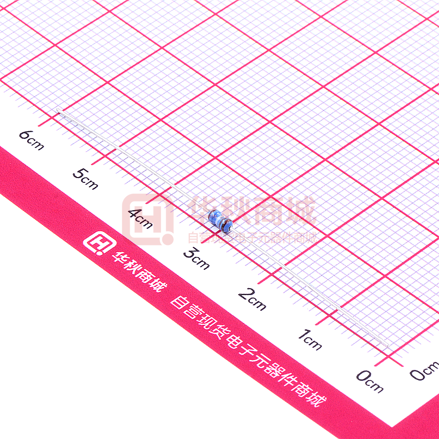

    金属膜电阻 AXIAL_D1.9X3.4MM_TM 1.69KΩ ±1% 1/6W
