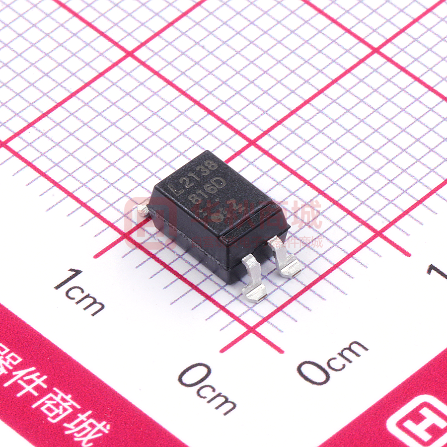

Photocoupler Product Data Sheet LTV-816/ 826/ 846 (M, S, S-TA, S-TA1, S-TP) Series Spec No.: DS-70-97-0013 Effective Date: 01/26/2016 Revision: H LITE-ON DCC RELEASE BNS-OD-FC001/A4 LITE-ON Technology Corp. / Optoelectronics No.90,Chien 1 Road, Chung Ho, New Taipei City 23585, Taiwan, R.O.C. Tel: 886-2-2222-6181 Fax: 886-2-2221-1948 / 886-2-2221-0660 http://www.liteon.com/opto Photocoupler LTV-816 826 846 (M, S, S-TA, S-TA1, S-TP) Series 1. DESCRIPTION 1.1 Features   Current transfer ratio ( CTR : MIN. 50% at IF = 5mA, VCE = 5V ) High input-output isolation voltage ( Viso = 5,000Vrms )   Response time ( tr : TYP. 4s at VCE = 2V, IC = 2mA, RL = 100 ) Dual-in-line package : LTV-816 : 1-channel type LTV-826 : 2-channel type LTV-846 : 4-channel type  Wide lead spacing package : LTV-816M : 1-channel type LTV-826M : 2-channel type LTV-846M : 4-channel type  Surface mounting package : LTV-816S : 1-channel type LTV-826S : 2-channel type LTV-846S : 4-channel type  Tape and reel packaging : LTV-816S -TA : 1-channel type LTV-816S -TA1 : 1-channel type LTV-816S -TP : 1-channel type LTV-826S -TA : 2-channel type LTV-826S -TA1 : 2-channel type  Safety approval UL 1577 VDE DIN EN60747-5-5 (VDE 0884-5) CSA CA5A CQC GB4943.1-2011/ GB8898-2011 (meet Altitude up to 5000m) Nordic Safety ( FIMKO/NEMKO/SEMKO/DEMKO) BSI    RoHS Compliance All materials be used in device are followed EU RoHS directive (No.2002/95/EC). ESD pass HBM 8000V/MM2000V MSL class1 1.2 Applications   Hybrid substrates that require high density mounting. Programmable controllers 1/17 Part No.: LTV-816 826 846 (M, S, S-TA, S-TA1, S-TP) Series BNC-OD-FC002/A4 Photocoupler LTV-816 826 846 (M, S, S-TA, S-TA1, S-TP) Series 2. PACKAGE DIMENSIONS 2.1 2.3 LTV-816 2.2 LTV-816M LTV-816S Notes : 1. Year date code. 2. 2-digit work week. 3. Factory identification mark shall be marked (W: China-CZ, Y: Thailand) 4. Rank shall be or shall not be marked. 5. “●” for halogen free option. 6. “4”or”V” for VDE option. Dimensions in millimeters (inches). 2/17 Part No.: LTV-816 826 846 (M, S, S-TA, S-TA1, S-TP) Series BNC-OD-FC002/A4 Photocoupler LTV-816 826 846 (M, S, S-TA, S-TA1, S-TP) Series 2.4 LTV-826 2.6 LTV-826S 2.5 LTV-826M Notes : 1. Year date code. 2. 2-digit work week. 3. Factory identification mark shall be marked (W: China-CZ, Y: Thailand) 4. Rank shall be or shall not be marked. 5. “●” for halogen free option. Dimensions in millimeters (inches). 3/17 Part No.: LTV-816 826 846 (M, S, S-TA, S-TA1, S-TP) Series BNC-OD-FC002/A4 Photocoupler LTV-816 826 846 (M, S, S-TA, S-TA1, S-TP) Series 2.7 LTV-846 2.8 LTV-846M 2.9 LTV-846S Notes : 1. Year date code. 2. 2-digit work week. 3. Factory identification mark shall be marked (W: China-CZ, Y: Thailand) 4. Rank shall be or shall not be marked. 5. “●” for halogen free option. Dimensions in millimeters (inches). 4/17 Part No.: LTV-816 826 846 (M, S, S-TA, S-TA1, S-TP) Series BNC-OD-FC002/A4 Photocoupler LTV-816 826 846 (M, S, S-TA, S-TA1, S-TP) Series 3. TAPING DIMENSIONS 3.1 LTV-816S-TA 3.2 Description Symbol Dimension in mm (inch) Tape wide W 16±0.3 (0.63) Pitch of sprocket holes P0 4±0.1 (0.15) F 7.5±0.1 (0.295) Distance of compartment Distance of compartment to compartment 3.3 LTV-816S-TA1 P2 2±0.1 (0.079) P1 12±0.1 (0.472) Quantities Per Reel Package Type TA/TA1 Quantities (pcs) 1000 5/17 Part No.: LTV-816 826 846 (M, S, S-TA, S-TA1, S-TP) Series BNC-OD-FC002/A4 Photocoupler LTV-816 826 846 (M, S, S-TA, S-TA1, S-TP) Series 3.4 LTV-816S-TP Description Symbol Dimension in mm (inch) Tape wide W 16±0.3 (0.63) Pitch of sprocket holes P0 4±0.1 (0.15) F 7.5±0.1 (0.295) P2 2±0.1 (0.079) P1 8±0.1 (0.472) Distance of compartment Distance of compartment to compartment 3.5 Quantities Per Reel Package Type TP Quantities (pcs) 2000 6/17 Part No.: LTV-816 826 846 (M, S, S-TA, S-TA1, S-TP) Series BNC-OD-FC002/A4 Photocoupler LTV-816 826 846 (M, S, S-TA, S-TA1, S-TP) Series 3.6 LTV-826S-TA 3.7 LTV-826S-TA1 Description Symbol Dimension in mm (inch) Tape wide W 16±0.3 (0.63) Pitch of sprocket holes P0 4±0.1 (0.15) F 7.5±0.1 (0.295) P2 2±0.1 (0.079) P1 12±0.1 (0.47) Distance of compartment Distance of compartment to compartment 3.8 Quantities Per Reel Package Type TA/TA1 Quantities (pcs) 1000 7/17 Part No.: LTV-816 826 846 (M, S, S-TA, S-TA1, S-TP) Series BNC-OD-FC002/A4 Photocoupler LTV-816 826 846 (M, S, S-TA, S-TA1, S-TP) Series 4. RATING AND CHARACTERISTICS 4.1 Absolute Maximum Ratings at Ta=25°C Parameter Symbol Rating Unit Forward Current IF 50 mA Reverse Voltage VR 6 V Power Dissipation P 70 mW Junction Temperature TJ 125 Collector - Emitter Voltage VCEO 80 V Emitter - Collector Voltage VECO 6 V Collector Current IC 50 mA Collector Power Dissipation PC 150 mW Total Power Dissipation Ptot 200 mW Isolation Voltage Viso 5000 Vrms Operating Temperature (LTV-826/846) Topr -30 ~ +100 o C Operating Temperature (LTV-816) Topr -50 ~ +110 o C C C Input o C Output 1. 2. 1. AC For 1 Minute, Storage Temperature Tstg -55 ~ +125 o Soldering Temperature Tsol 260 o R.H. = 40 ~ 60% Isolation voltage shall be measured using the following method. (1) Short between anode and cathode on the primary side and between collector and emitter on the secondary side. (2) The isolation voltage tester with zero-cross circuit shall be used. (3) The waveform of applied voltage shall be a sine wave. 2. For 10 Seconds 8/17 Part No.: LTV-816 826 846 (M, S, S-TA, S-TA1, S-TP) Series BNC-OD-FC002/A4 Photocoupler LTV-816 826 846 (M, S, S-TA, S-TA1, S-TP) Series 4.2 ELECTRICAL OPTICAL CHARACTERISTICS at Ta=25°C Parameter Input Symbol Min. Typ. Max. Unit Forward Voltage VF — 1.2 1.4 V IF=20mA Reverse Current IR — — 10 A VR=4V Terminal Capacitance Ct — 30 250 pF V=0, f=1KHz Collector Dark Current ICEO — — 100 nA VCE=20V, IF=0 BVCEO 80 — — V IC=0.1mA, IF=0 BVECO 6 — — V IE=10A, IF=0 IC 2.5 — 30 mA Collector-Emitter Output Test Condition Breakdown Voltage Emitter-Collector Breakdown Voltage Collector Current IF=5mA, VCE=5V 1. Current Transfer Ratio CTR 50 — 600 % VCE(sat) — 0.1 0.2 V Riso 51010 11011 —  Collector-Emitter IF=20mA, IC=1mA Saturation Voltage Isolation Resistance TRANSFER DC500V, 40 ~ 60% R.H. CHARACTERISTICS Floating Capacitance Cf — 0.6 1 pF Cut-off Frequency fc — 80 — kHz 40 ~ 60% R.H. V=0, f=1MHz VCE=5V, IC=2mA RL=100,-3dB Response Time (Rise) Response Time (Fall) 1. CTR  tr tf — — 4 3 18 18 s s VCE=2V, IC=2mA RL=100, IC 100% IF 9/17 Part No.: LTV-816 826 846 (M, S, S-TA, S-TA1, S-TP) Series BNC-OD-FC002/A4 Photocoupler LTV-816 826 846 (M, S, S-TA, S-TA1, S-TP) Series 5. RANK TABLE OF CURRENT TRANSFER RATIO LTV-816 LTV-826 LTV-846 CTR Rank Min Max L 50 100 A 80 160 B 130 260 C 200 400 D 300 600 L or A or B or C or D 50 600 No Bin 50 600 B 130 260 C 200 400 BC 130 400 CD 200 600 No Bin 50 600 BC 130 400 CD 200 600 Condition IF=5mA, VCE=5V, Ta=25oC 10/17 Part No.: LTV-816 826 846 (M, S, S-TA, S-TA1, S-TP) Series BNC-OD-FC002/A4 Photocoupler LTV-816 826 846 (M, S, S-TA, S-TA1, S-TP) Series 6. CHARACTERISTICS CURVES Fig.1 Forword Current vs. Ambient Temperatute PC - Collecter Power Dissipation - mW Collector Power dissipation Pc (mW) 160 60 140 50 Forward current IF(mA) IF - Forward Current - mA 50 40 30 20 120 40 100 30 20 10 10 0 -30 -20 0 -60 -40 00 25 20 5040 75 60 100 80125 100 oC TA -Ambient Ambienttemperature Temperature Ta (- C) 80 60 40 20 0 120 -60 o 100 50 0 -30 -40 7mA IF - Forward Current - mA 1mA 3mA 5mA Ic= 0.5mA 500 O Ta= 25 C 4 3 2 1 50 20 7540 10060 125 80 100 120 10 1 TA = 115oCo Ta= 75 C TA = 75oC o 50 C TA = 25oC TA = 0oC TA = -55oC 200 100 50 o 25 C 0C -25 C o o 20 10 5 2 0 5 10 1 0.1 15 0 0.6 1.0 0.5 0.8 1.5 1 2.0 2.5 1.2 3.0 1.4 1.6 Forward voltage VVoltage VF - Forward -V F (V) Forward current IF (mA) Fig.5 Transfer vs. Fig.5Current Normalized CTRRatio vs. Forward Current Forward Current Fig.6 Collector Current vs. Collector-emitter Voltage 80 0.1 0.01 70 o 160 IC - Collector Emitter - mA 1 60 VCE = 5V 140 50 120 40 100 30 80 60 20 40 10 IF = 30mA o Ta= 25 C 20mA 25 Pc(MAX.) 20 IF = 10mA 15 10mA PC MAX. 10 IF = 5mA 5mA 5 IF = 1mA 20 0 0 0.1 TA = 25oC 30 VCE= 5V Ta= 25 C Collector current Ic (mA) 200 to IF = 5mA Normalized oC TA = 25180 Current transfer ratio CTR (%) Normalized Current Transfer Ratio 25 0 Fig.4 Forward Current vs. Forward Voltage 0 10 -200 100 6 Collecotr-emitter saturation voltage VCE (sat) (V) 150 o Fig.3 Collector-emitter Saturation Voltage vs. Forward Current 5 200 Ambient temperature Ta ( C) - oC TA - Ambient Temperature Forward current IF (mA) 60 Fig.2 Collector Power Dissiption vs. Ambient Temperature 1 2 1 5 10 2010 IForward Current - mA current IF (mA) F - Forward 50 100 0 0 0 12 2 3 44 5 6 76 8 9 8 10 VCE(non-sat) - Non-Saturated Collector Emitter Voltage - V Collector-emitter voltage V (V) CE 11/17 Part No.: LTV-816 826 846 (M, S, S-TA, S-TA1, S-TP) Series BNC-OD-FC002/A4 Photocoupler LTV-816 826 846 (M, S, S-TA, S-TA1, S-TP) Series 1 0.8 0.6 0.4 0.2 I F =Normalized 5mA to 5mA, VCEI=F =5V VCE = 5V TA = 25oC 100 50 0 -30 0 0 25 50 75 100 125 o -40 I F= 20mA Ic= 1mA IF = 5mA, IC = 1mA 0.14 0.12 0.12 0.1 0.10 IF = 10mA, IC = 1mA 0.08 0.08 0.06 0.06 Ambient Ta 0 20temperature 40 60( C) 80 -20 100 120 0.04 0.04 IF = 20mA, IC = 1mA 0.02 0.02 0 -25 0 25 50 75 100 125 0 o Ambient temperature Ta ( C) -60 -40 -20 0 20 40 60 80 100 Fig.9 Collector Dark Current vs. Ambient Temperature Fig.10 Response Time vs. Load Resistance -5 500 10 120 TA - Ambient Temperature - oC TA - Ambient Temperature - oC VCE= 20V 200 100 -6 10 Response time ( s) Collector dark current I CEO (A) -60 0.14 0.16 VCE (sat) (V) Relative current transfer ratio (%) 150 -7 10 -8 10 -9 10 -10 10 VCE = 2V Ic= 2mA Ta= 25 C o 50 tr 20 10 td tf 5 ts 2 1 0.5 -11 10 -25 0 25 50 75 100 o 0.2 0.05 0.1 0.2 0.5 1 2 5 10 Test Circuit for Response Time Fig.11 Frequency Response VCE = 2V Ic= 2mA Ta= 25 C o 0 10 RL= 10k 1k 100 Test Circuit for Frequency Response 20 0.5 1 125 Load resistance R L(k ) Ambient temperature Ta ( C) Voltage gain Av (dB) Normalized Current Transfer Ratio 1.2 Fig.8 Collector-emitter Saturation Voltage vs. Ambient Temperature VCE(sat) - Saturated Collector-Emitter Collector-emitter voltage Voltagesaturation -V Fig.7 Relative Current Transfer Ratio vs. Ambient Temperature 2 5 10 20 50 100 500 Frequency f (kHz) 12/17 Part No.: LTV-816 826 846 (M, S, S-TA, S-TA1, S-TP) Series BNC-OD-FC002/A4 Photocoupler LTV-816 826 846 (M, S, S-TA, S-TA1, S-TP) Series 7. TEMPERATURE PROFILE OF SOLDERING 7.1 IR Reflow soldering (JEDEC-STD-020C compliant) One time soldering reflow is recommended within the condition of temperature and time profile shown below. Do not solder more than three times. Profile item Conditions Preheat - Temperature Min (TSmin) 150˚C - Temperature Max (TSmax) 200˚C - Time (min to max) (ts) 90±30 sec Soldering zone - Temperature (TL) 217˚C - Time (tL) 60 sec Peak Temperature (TP) 260˚C 3˚C / sec max. Ramp-up rate 3~6˚C / sec Ramp-down rate 20 sec Temperature ( C) Ramp-up TP 260 C TL 217 C Tsmax 200 C Ramp-down 60 sec Tsmin 150 C tL (Soldering) 25 C 60 ~ 120 sec ts (Preheat) 35~70 sec 13/17 Time (sec) Part No.: LTV-816 826 846 (M, S, S-TA, S-TA1, S-TP) Series BNC-OD-FC002/A4 Photocoupler LTV-816 826 846 (M, S, S-TA, S-TA1, S-TP) Series 7.2 Wave soldering (JEDEC22A111 compliant) One time soldering is recommended within the condition of temperature. Temperature: 260+0/-5˚C Time: 10 sec. Preheat temperature:25 to 140˚C Preheat time: 30 to 80 sec. 7.3 Hand soldering by soldering iron Allow single lead soldering in every single process. One time soldering is recommended. Temperature: 380+0/-5˚C Time: 3 sec max. 14/17 Part No.: LTV-816 826 846 (M, S, S-TA, S-TA1, S-TP) Series BNC-OD-FC002/A4 Photocoupler LTV-816 826 846 (M, S, S-TA, S-TA1, S-TP) Series 8. RRECOMMENDED FOOT PRINT PATTERNS (MOUNT PAD) 8.1 4 PIN 8.2 8 PIN 8.3 16PIN Note : Dimensions in millimeters. 15/17 Part No.: LTV-816 826 846 (M, S, S-TA, S-TA1, S-TP) Series BNC-OD-FC002/A4 Photocoupler LTV-816 826 846 (M, S, S-TA, S-TA1, S-TP) Series 9. Naming rule LTV- 8X6(1)-(2)-( 3 )-G DEVICE PART NUMBER (1) No suffix = Dual-in-Line package M = Wide lead spacing package S = Surface mounting package - (2) TAPING TYPE (TA,TA1,TP or none) LTV-816 and LTV-826 have tape and reel solution. Please refer to orientation of taping on Page: 5-7 (3) CTR RANK (A,B,C,D,BC,CD or none) Please refer to the CTR table on Page: 10 (4) Halogen free option Example : LTV-816S-TA1-A-G, LTV-846S-BC LTV 8X6(1)(2)(3)-V-G DEVICE PART NUMBER (1) No suffix = Dual-in-Line package M = Wide lead spacing package S = Surface mounting package (2) TAPING TYPE (TA,TA1,TP or none) LTV-816 and LTV-826 have tape and reel solution Please refer to orientation of taping on Page: 5-7 (3) CTR RANK (A,B,C,D, BC,CD or none) Please refer to the CTR table on Page: 10 (4) VDE order option (5) Halogen free option Example : LTV816STA1A-V-G, LTV846SBC-V 16/17 Part No.: LTV-816 826 846 (M, S, S-TA, S-TA1, S-TP) Series BNC-OD-FC002/A4 Photocoupler LTV-816 826 846 (M, S, S-TA, S-TA1, S-TP) Series 10. Notes:  LiteOn is continually improving the quality, reliability, function or design and LiteOn reserves the right to make changes without further notices.  The products shown in this publication are designed for the general use in electronic applications such as office automation equipment, communications devices, audio/visual equipment, electrical application and instrumentation.  For equipment/devices where high reliability or safety is required, such as space applications, nuclear power control equipment, medical equipment, etc, please contact our sales representatives.  When requiring a device for any ”specific” application, please contact our sales in advice.  If there are any questions about the contents of this publication, please contact us at your convenience.  The contents described herein are subject to change without prior notice.  Immerge unit’s body in solder paste is not recommended.  The contents described herein are subject to change without prior notice.  Immerge unit’s body in solder paste is not recommended. 17/17 Part No.: LTV-816 826 846 (M, S, S-TA, S-TA1, S-TP) Series BNC-OD-FC002/A4
LTV-816S-TP-D-CU
1. 物料型号:文档中提到了多种型号,包括LTV-816(1通道类型)、LTV-826(2通道类型)、LTV-846(4通道类型),以及它们的不同封装版本,例如M(宽引脚间距封装)、S(表面贴装封装)等。
2. 器件简介:这些光耦具有最小50%的电流传输比(CTR),在IF=5mA、VCE=5V的条件下,具有高达5000Vrms的高输入输出隔离电压,以及典型的4μs响应时间。
3. 引脚分配:文档提供了不同型号的引脚分配图,例如LTV-816、LTV-816M、LTV-816S等,包括它们的引脚编号和内部连接图。
4. 参数特性:包括绝对最大额定值,如输入端的正向电流(IF)为50mA,反向电压(VR)为6V,功耗(P)为70mW,以及输出端的集电极-发射极电压(VCEO)为80V等。还提供了电气光学特性,如正向电压(VF)、反向电流(IR)、终端电容(Ct)等。
5. 功能详解:文档描述了光耦的主要特性,包括电流传输比、隔离电压、响应时间等,并提供了不同环境温度下的特性曲线图。
6. 应用信息:这些光耦适用于需要高密度安装的混合基板和可编程控制器。
7. 封装信息:文档提供了不同封装类型的尺寸信息,包括双列直插封装、宽引脚间距封装、表面贴装封装等。
