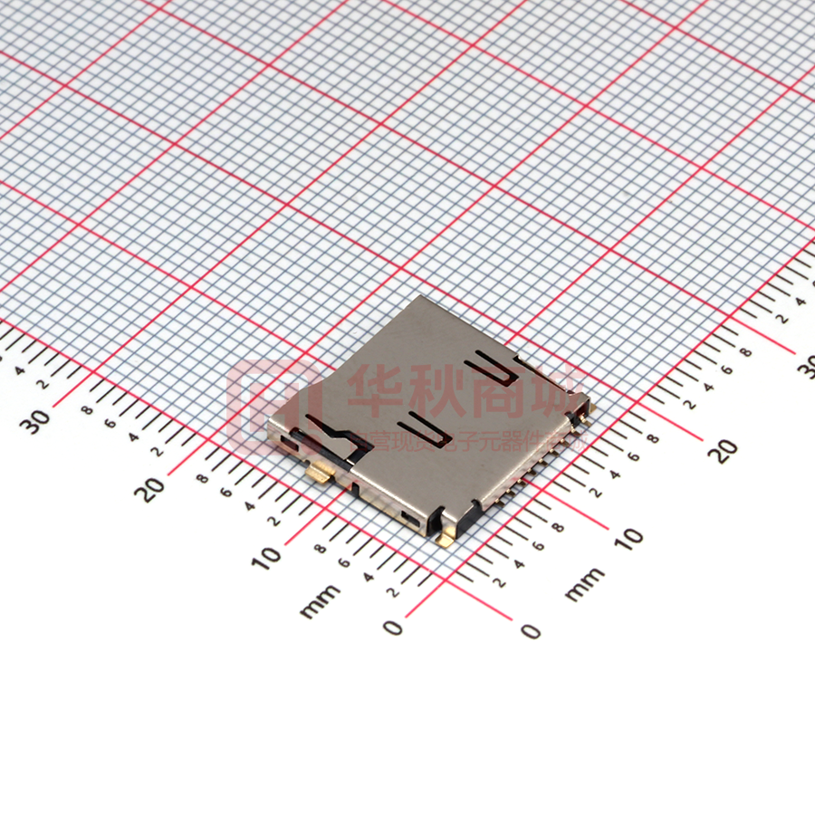

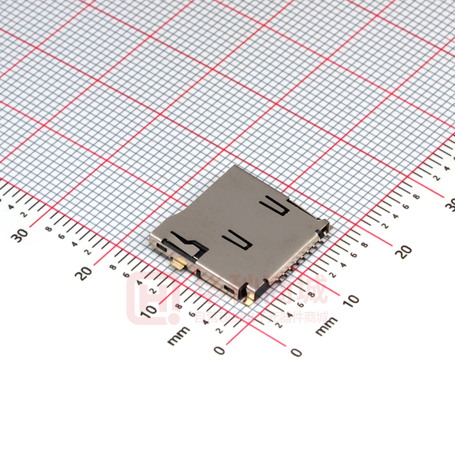

www.Sofng.com C ARD SOCKETS Operation:SMT&(Push-Push)自弹式 外焊常开型 LTEM NO.:TF-015 T-Flash 连接器 (Consumer Electronics) (14.50L× (14.50L×14.70W× 14.70W×1.85H & T-Flash Sockets) MEMORY-CARD-SOCKETS Technical parameter ╲ LEVEL A[better product] ╲ PROJECT Contact Rating B[average product] 25mA, 24V DC Electrical Initial Contact Resistance Properties Insulation Resistance 30mΩ max. 50mΩ max. COMPONENT 100MΩ min.500V DC Withstand Voltage 500V AC for 1 minute 350 V AC for 1 minut Durable There No Load 6,500 Cycles 5,500 Cycles Performance Rated Load 5,500 Cycles 4,000 Cycles Sterage temp. Page1 -35℃~+85℃(Operating Temp: ﹥ Unit:mm Material declaration No. NAME MATERIAL PLATING ①A 外壳 SUS301-3/4H(t=0.15mm)不锈钢【焊点镀金 1u〞】 G/F ②B 线簧 象唛不锈钢线 OD=0.21mm - ③C 弹簧 SUS304(t=0.30mm)不锈钢 - ④D 滑块 PA6T (Black)耐热尼龙塑料 THERMAL PLASTIC SET ⑤E 基座 LCP 30% (Black)耐热塑料 THERMAL PLASTIC - ⑥F 接触端子 C5191R-H (t=0.15mm)磷青铜【30u〞锡基镀金 1u〞】 G/F ⑦G 检测端子 C5191R-H (t=0.15mm)磷青铜【30u〞锡基镀金 1u〞】 G/F ) SOFNG ELECTRONIC TECHNOLOGY Co., LTD CIRCUIT BOARD SIZE (Vertical view) Operating Force Inward 8.0~12.0N.(1N.=100gram-force) Exiting 6.0N.(1N.=100gram-force) Solder-ability IR Reflow:250℃,5sec. (Max.) Manual:350℃,3sec. DECIMALS ANGLES X :±0.25 X° :±3° X.X :±0.20 X.X° :±1° X.XX :±0.15 X.XX° :±0.5° Pin definition T-Flash CARD Pin No. Pin NAME Type Description PIN① DAT2 I/0/PP Date Line[Bit 2] PIN② CD/DAT3 I/0/PP Card Detect Date Lin(Bit 3) PIN③ CMD PP Command Response PIN④ VDD S Supply voltage PIN⑤ CLX l Clock PIN⑥ Vss S Supply voltage ground PIN⑦ DAT 0 l/0/PP Date Line [Bit 0] PIN⑧ DAT 1 l/0/PP Date Line [Dit 1] P1 P8 T-Flash CARD 本品不屬於危害性廢棄物,須丟棄時可以委託 回收商予以回收再生處理。Products do not belong to hazardous waste,When waste can recycling processing 運送時本產品不要直接與水、酸鹼性化學物質 接觸,或放置於含有以上氣體環境中,並且需要 注記 NOTICE 注意會有滑落、側翻的危險發生;運輸過程中 不能有碰撞或者擠壓,須保證溫度與濕度適中 1.碩方公司擁有最終解釋權;The SOFNG company reserves the right of final interpretation; [常溫 25℃,濕度在 50℃以內],不可導致材料變 2.文件禁止外洩、轉載;Leaked and reproduced prohibited; 3.未經授權修改無效。Modify is invalid. 形或氧化。
