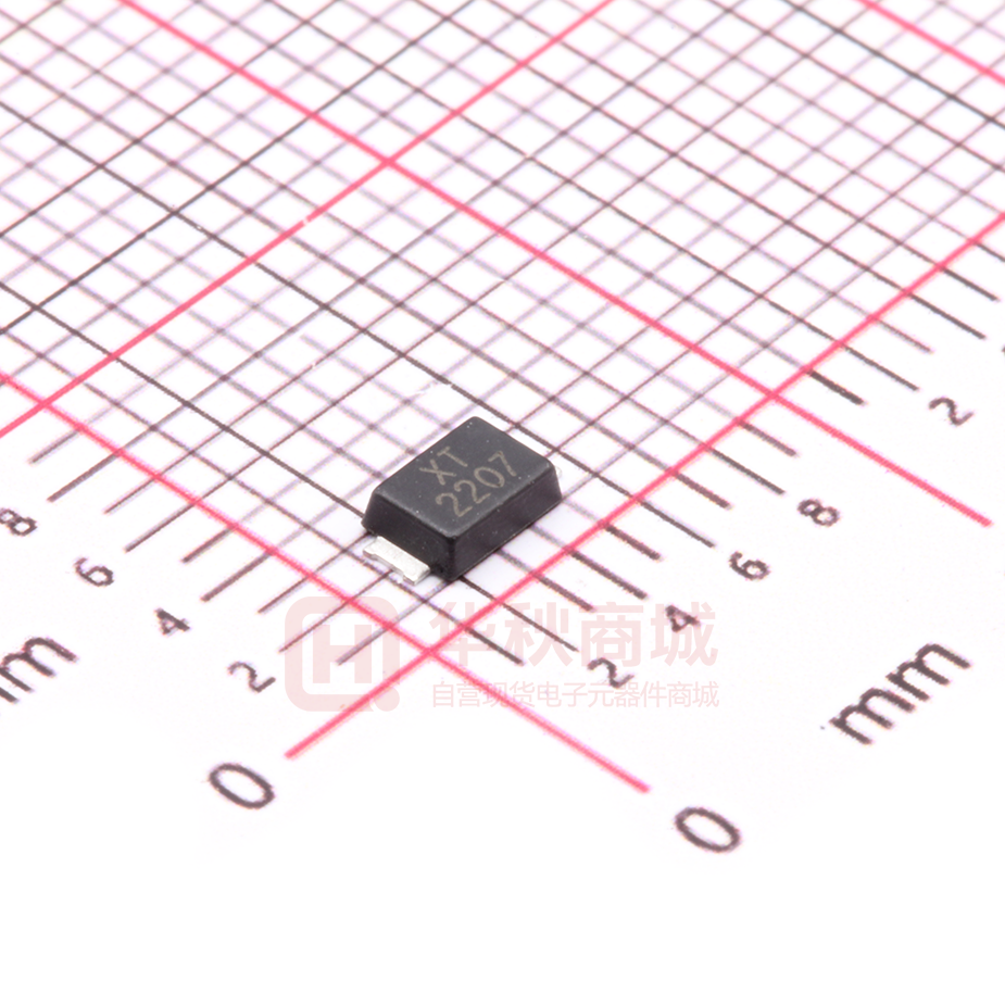

    ESD抑制器/TVS二极管 Vrrm=18V Vbr(min)=20V Vc= 29.2V@Ipp =13.7A
SMAFJ18CA 数据手册
山东晶导微电子股份有限公司 Jingdao Microelectronics co.LTD SMAFJ Series Surface mount transient voltage suppressor power 400 watts Stand-Off Voltage:5V~440V FEATURES PINNING • For surface mounted applications in order to PIN optimize board space. DESCRIPTION 1 Cathode 2 Anode • Low profile package • Glass passivated junction 2 • Low inductance Unipolar 1 • Plastic package has Underwriters Laboratory Flammability Bipolar MECHANICAL DATA Top View Simplified outline SMAF and symbol • Case: SMAF • Terminals: Solderable per MIL-STD-750, Method 2026 • A pprox. Weight: 27mg 0.00095oz Maximum Ratings and Electrical characteristics Ratings at 25 °C ambient temperature unless otherwise specified. Symbol Value Unit Peak Pulse Power Dissipation on 10/1000us waveform P PPM 400 W Peak Forward Surge Current (Note 2,Fig 4) I FSM 60 A Peak Pulse Current on 10/1000 us waveform (Note 1, Fig 2) I PPM see Table 1 A Typical Junction capacitance at VR=4V, f=1MHz CJ 390 pF Parameter ESD Voltage per IEC6100-4-2 Contact Air V ESD1 V ESD2 Typical Thermal Resistance Junction to Ambient(Note 2) RθJA Operating Junction Temperature and Storage Temperature Range T j , T stg 8 15 kV 120 °C/W -55 ~ +175 °C NOTES: 1. Non-repetitive current pulse, per Fig.3 and derated above T A = 25°C per Fig. 2. 2. Mounted on FR-4 PCB single-sided copper, mini pad. 3. Peak Forward Surge Current : 8.3ms single half sine-wave Superimposed on rated load (JEDEC method). 4. Peak pulse power waveform is 10/1000μS. 2020.07 SMAF-TVS-SMAFJ Series-400W Page 1 of 4 山东晶导微电子股份有限公司 Jingdao Microelectronics co.LTD SMAFJ Series Characteristics at Ta = 25°C Table 1 Reverse Stand-off Voltage Type Breakdown Voltage V BR @ I T Reverse Leakage Max. Clamp Voltage Peak Pulse Current Package IT I R @ V RRM V C @ I PP I PP Device Marking Ccode Test Current SMAF V RRM Min Max BI V V V mA μA V A UNI BI SMAFJ5.0A SMAFJ5.0CA 5 6.4 7 10 800 9.2 43.5 AE WE SMAFJ6.0A SMAFJ6.0CA 6 6.67 7.37 10 800 10.3 38.8 AG WG SMAFJ6.5A SMAFJ6.5CA 6.5 7.22 7.98 10 500 11.2 35.7 AK WK SMAFJ7.0A SMAFJ7.0CA 7 7.78 8.6 10 200 12 33.3 AM WM SMAFJ7.5A SMAFJ7.5CA 7.5 8.33 9.21 1 100 12.9 31 AP WP SMAFJ8.0A SMAFJ8.0CA 8 8.89 9.83 1 50 13.6 29.4 AR WR SMAFJ8.5A SMAFJ8.5CA 8.5 9.44 10.4 1 20 14.4 27.8 AT WT SMAFJ9.0A SMAFJ9.0CA 9 10 11.1 1 10 15.4 26 AV WV UNI SMAFJ10A SMAFJ10CA 10 11.1 12.3 1 5 17 23.5 AX WX SMAFJ11A SMAFJ11CA 11 12.2 13.5 1 1 18.2 22 AZ WZ SMAFJ12A SMAFJ12CA 12 13.3 14.7 1 1 19.9 20.1 BE XE SMAFJ13A SMAFJ13CA 13 14.4 15.9 1 1 21.5 18.6 BG XG SMAFJ14A SMAFJ14CA 14 15.6 17.2 1 1 23.2 17.2 BK XK SMAFJ15A SMAFJ15CA 15 16.7 18.5 1 1 24.4 16.4 BM XM SMAFJ16A SMAFJ16CA 16 17.8 19.7 1 1 26 15.4 BP XP SMAFJ17A SMAFJ17CA 17 18.9 20.9 1 1 27.6 14.5 BR XR SMAFJ18A SMAFJ18CA 18 20 22.1 1 1 29.2 13.7 BT XT SMAFJ20A SMAFJ20CA 20 22.2 24.5 1 1 32.4 12.3 BV XV XX SMAFJ22A SMAFJ22CA 22 24.4 26.9 1 1 35.5 11.3 BX SMAFJ24A SMAFJ24CA 24 26.7 29.5 1 1 38.9 10.3 BZ XZ SMAFJ26A SMAFJ26CA 26 28.9 31.9 1 1 42.1 9.5 CE YE YG SMAFJ28A SMAFJ28CA 28 31.1 34.4 1 1 45.4 8.8 CG SMAFJ30A SMAFJ30CA 30 33.3 36.8 1 1 48.4 8.3 CK YK SMAFJ33A SMAFJ33CA 33 36.7 40.6 1 1 53.3 7.5 CM YM SMAFJ36A SMAFJ36CA 36 40 44.2 1 1 58.1 6.9 CP YP SMAFJ40A SMAFJ40CA 40 44.4 49.1 1 1 64.5 6.2 CR YR SMAFJ43A SMAFJ43CA 43 47.8 52.8 1 1 69.4 5.8 CT YT SMAFJ45A SMAFJ45CA 45 50 55.3 1 1 72.7 5.5 CV YV SMAFJ48A SMAFJ48CA 48 53.3 58.9 1 1 77.4 5.2 CX YX SMAFJ51A SMAFJ51CA 51 56.7 62.7 1 1 82.4 4.9 CZ YZ SMAFJ54A SMAFJ54CA 54 60 66.3 1 1 87.1 4.6 RE ZE SMAFJ58A SMAFJ58CA 58 64.4 71.2 1 1 93.6 4.3 RG ZG SMAFJ60A SMAFJ60CA 60 66.7 73.7 1 1 96.8 4.1 RK ZK SMAFJ64A SMAFJ64CA 64 71.1 78.6 1 1 103 3.9 RM ZM SMAFJ70A SMAFJ70CA 70 77.8 86 1 1 113 3.5 RP ZP SMAFJ75A SMAFJ75CA 75 83.3 92.1 1 1 121 3.3 RR ZR SMAFJ78A SMAFJ78CA 78 86.7 95.8 1 1 126 3.2 RT ZT SMAFJ85A SMAFJ85CA 85 94.4 104 1 1 137 2.9 RV ZV ZX SMAFJ90A SMAFJ90CA 90 100 111 1 1 146 2.7 RX SMAFJ100A SMAFJ100CA 100 111 123 1 1 162 2.5 RZ ZZ SMAFJ110A SMAFJ110CA 110 122 135 1 1 177 2.3 SE VE VG SMAFJ120A SMAFJ120CA 120 133 147 1 1 193 2.1 SG SMAFJ130A SMAFJ130CA 130 144 159 1 1 209 1.9 SK VK SMAFJ150A SMAFJ150CA 150 167 185 1 1 243 1.6 SM VM SMAFJ160A SMAFJ160CA 160 178 197 1 1 259 1.5 SP VP SMAFJ170A SMAFJ170CA 170 189 209 1 1 275 1.5 SR VR SMAFJ180A SMAFJ180CA 180 201 222 1 1 292 1.4 ST VT SMAFJ200A SMAFJ200CA 200 224 247 1 1 324 1.2 SV VV VX SMAFJ220A SMAFJ220CA 220 246 272 1 1 356 1.1 SX SMAFJ250A SMAFJ250CA 250 279 309 1 1 405 1 SZ VZ SMAFJ300A SMAFJ300CA 300 335 371 1 1 486 0.8 TE UE UG SMAFJ350A SMAFJ350CA 350 391 432 1 1 567 0.7 TG SMAFJ400A SMAFJ400CA 400 447 494 1 1 648 0.6 TK UK SMAFJ440A SMAFJ440CA 440 492 543 1 1 713 0.6 TM UM 2020.07 www.sdjingdao.com Page 2 of 4 山东晶导微电子股份有限公司 Jingdao Microelectronics co.LTD SMAFJ Series Fig.2 Forward Current Derating Curve 100 Non-Repetive Pulse.Wavefom Shown in Figure.3 T A=25°C 10 1.0 Mounted on 5.0mm Copper Land Areas 0.1 0.1 1 10 100 1000 10000 PEAK PULSE POWER(P PP)OR CURRENT(I PP) DERATINGIN PERCENTAGE% P PPM,PEAK PULSE FORWARD ,kW Fig.1 Peak Pulse Power Rating Curve 100 80 60 40 20 0 25 I ppm ,Peak Pulse Current (%) Peak Value Pulse Width (td) is Defined as the Point where the Peak. Current Decayst to 50% of Ipp I ppm 80 Half Value-I pp /2 60 10/1000usec Waveform as Defined bye R.E.A. 40 20 0 0 1.0 2.0 3.0 4.0 I FSM,PEAK FORWARD SURGE CURRENT, AMPERES T A =25°C 100 125 150 175 60 50 40 30 20 10 T,TIME,ms 2020.07 100 Fig.4 Maximum Non-Repetitive Peak Forward Surge Current Fig.3 Pulse Waveform t f =10usec 75 T A,AMBIENT TEMPERATURE,°C t d,PULSE WIDTH ,us 120 50 T J=T Jmax 8.3ms Single Half Sinepwave JEDEC Method 0 1 10 100 Number of Cycles at 60Hz www.sdjingdao.com Page 3 of 4 山东晶导微电子股份有限公司 Jingdao Microelectronics co.LTD SMAFJ Series PACKAGE OUTLINE Plastic surface mounted package; 2 leads SMAF ∠ALL ROUND C A ∠ALL ROUND HE V M g Top View mil Bottom View A C D E e g HE max 1.2 0.20 3.7 2.7 1.6 1.2 4.9 min 0.9 0.12 3.3 2.4 1.3 0.8 4.4 max 47 7.9 146 106 63 47 193 min 35 4.7 130 94 51 31 173 UNIT mm g pad e E A pad D E A ∠ 7° The recommended mounting pad size 2.2 (86) 1.6 (63) 1.8 (71) 1.6 (63) mm Unit : (mil) 2020.07 JD 200731 6B0/7B2 Page 4 of 4
