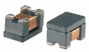

SMW-B Series
Wire-wound Common Mode Filter
Pb
◆ Features
1
、Powerful component with composite co-fired
material to solve EMI problem for high-speed
differential signal transmission line as USB,
IEEE1394 and LVDS, without distortion to
high speed signal transmission
、High coupling constant : 0.99
3、Small size and low profile
4、Various common mode impedance items
2
of 67 to 220 ohm can be used, considering
noise level and signal frequency
5 Small dimension enable higher density packaging
6 RoHS Compliant.
