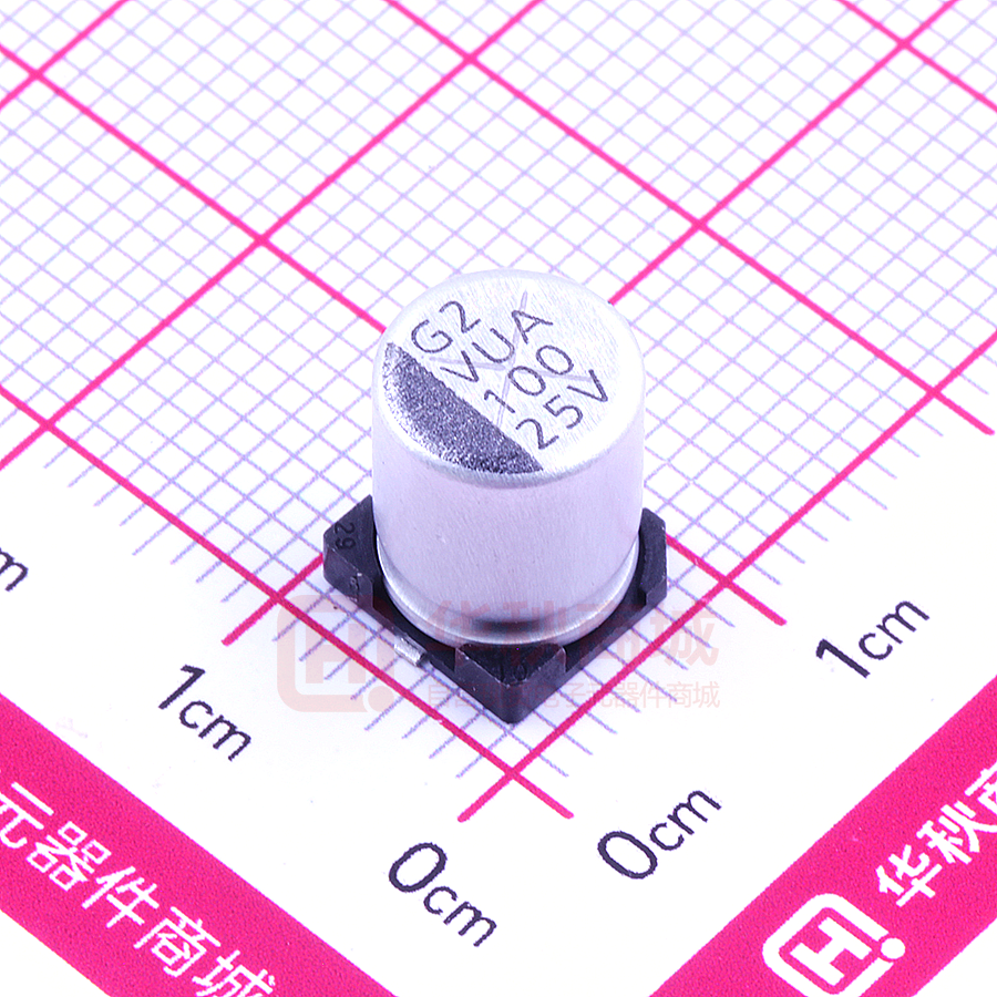

    贴片铝电解电容 SMD,D8xL10mm 100µF ±20% 25V 2000Hrs@105℃
VUA101M1ETR-0810K 数据手册
SMD Aluminum Electrolytic Capacitors VUA Features ‧ 6.3 ~ 18φ, 125℃, 1,000 ~ 2,000 hours assured ‧ Chip type high temperature range, for +125℃ use ‧ For automobile modules and other high temperature applications ‧ RoHS Compliance Marking color: Black SPECIFICATIONS Items Category Temperature Range Capacitance Tolerance Performance -40℃ ~ +125℃ ±20% I = 0.03CV or 4 (µA) whichever is greater (after 1 minutes) Where, C = rated capacitance in µF V = rated DC working voltage in V Leakage Current (at 20℃) Dissipation Factor (Tanδ at 120Hz, 20℃) Rated Voltage Tanδ(max) 10 0.32 16 0.24 25 0.21 (at 120Hz, 20℃) 35 0.18 50 0.15 Impedance ratio shall not exceed the values given in the table below. Rated Voltage 10 16 25 35 Impedance Z(-25℃)/Z(+20℃) 6 5 4 3 Z(-40℃)/Z(+20℃) Ratio 12 8 6 4 Low Temperature Characteristics (at 120Hz) 50 3 4 1,000 Hrs for φD ≦ 8 × 6.5mm 2,000 Hrs for φD ≧ 8 × 10mm Capacitance Change Within ±30% of initial value Dissipation Factor Less than 300% of specified value Leakage Current Within specified value * The above specifications shall be satisfied when the capacitors are restored to 20℃after the rated voltage applied for 1,000 / 2,000 hours at 125℃. Test Time Endurance Test Time 1,000 Hrs Capacitance Change Within ±30% of initial value Dissipation Factor Less than 300% of specified value Leakage Current Within specified value * The above specifications shall be satisfied when the capacitors are restored to 20℃after exposing them for 1,000 hours at 125℃ without voltage applied. Shelf Life Test Freq.(Hz) Cap.(μ F ) Under 330 300 < C ≦ 1,000 Ripple Current & Frequency Multipliers 50 120 1k 10k up 0.80 0.85 1.0 1.0 1.25 1.20 1.40 1.30 DIAGRAM OF DIMENSIONS Fig. 1 φD±0.5 Vent≧8φ×10L LEAD SPACING AND DIAMETER B± 0.2 W L 0.3 Max A±0.2 0.4 max P C±0.2 φD±0.5 Fig. 2 Vent B±0.2 W 0.4 Max L A±0.2 1.0 Max P C±0.2 2011 Version φD 6.3 6.3 8 8 10 12.5 12.5 16 18 L 5.7± 0.3 7.7 ± 0.3 6.5 ± 0.3 10 ± 0.5 10 ± 0.5 13.5 ± 0.5 16 ± 0.5 16.5 ± 0.5 16.5 ± 0.5 A 6.6 6.6 8.4 8.4 10.4 13.0 13.0 17.0 19.0 B 6.6 6.6 8.4 8.4 10.4 13.0 13.0 17.0 19.0 C 7.4 7.4 9.2 9.2 11.2 15.0 15.0 19.0 21.0 Unit: mm P ± 0.2 Fig. No. W 0.5 ~ 0.8 2.0 1 0.5 ~ 0.8 2.0 1 0.5 ~ 0.8 2.3 1 0.7 ~ 1.1 3.1 1 0.7 ~ 1.1 4.7 1 1.1 ~ 1.4 4.4 2 1.1 ~ 1.4 4.4 2 1.1 ~ 1.4 6.4 2 1.1 ~ 1.4 6.4 2 SMD Aluminum Electrolytic Capacitors VUA MARKING φD = 6.3 mm Negative polarity φD = 8 ~ 10 mm Date code a1 10 16u Negative polarity Rated cap. Rated voltage & Series code φD ≧ 12.5mm Date code a1 VUA 470 6.3V Rated cap. Rated voltage µF Contents 10V (1A) mA φD×L 22 220 33 330 47 470 68 680 6.3×5.7 50 100 101 8×6.5 220 221 330 16V (1C) mA φD×L 25V (1E) mA φD×L a1 VUA 2200 6.3V Date code Series name Rated cap. Rated voltage Dimension: φD × L(mm) Ripple Current: mA/rms at 120 Hz, 125°C DIMENSION & PERMISSIBLE RIPPLE CURRENT V. DC Negative polarity Series name 35V (1V) mA φD×L 50V (1H) mA φD×L 6.3×5.7 50 8×6.5 75 6.3×5.7 50 6.3×5.7 50 6.3×7.7 70 8×10 130 6.3×7.7 70 6.3×7.7 70 8×6.5 75 8×10 130 8×6.5 75 8×6.5 75 8×10 130 10×10 180 75 8×6.5 75 8×10 130 10×10 180 12.5×13.5 357 8×10 130 10×10 180 10×10 180 12.5×13.5 357 12.5×16 400 331 8×10 130 12.5×13.5 480 12.5×13.5 480 16×16.5 650 16×16.5 650 470 471 12.5×13.5 480 12.5×13.5 480 12.5×13.5 480 16×16.5 650 16×16.5 650 680 681 12.5×13.5 480 12.5×13.5 480 12.5×16 585 16×16.5 650 18×16.5 855 1,000 102 12.5×16 585 12.5×16 585 16×16.5 650 18×16.5 855 1,500 152 12.5×16 585 16×16.5 650 18×16.5 855 2,200 222 16×16.5 650 18×16.5 855 3,300 332 18×16.5 855 4,700 472 18×16.5 855 2011 Verison
