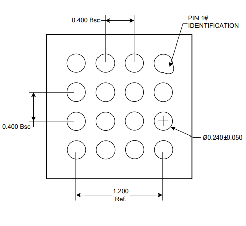

    FC-16_2X2MM
    高效、超低失真、恒定大音量、第六代K类音频放大器
AW8736FCR 数据手册
AW8736 Data Sheet May 2013 V1.5 High efficiency、Ultralow distortion、Constant large volume、Sixth generation Class K Audio Amplifier FEATURES DESCRIPTION  New generation charge pump technology : AW8736 is designed to enhance smart mobile phone sound quality,which is a new high efficiency, ultra-low distortion, constant large volume, sixth generation class K audio amplifiers. Using a new generation of charge pump technology:K -Chargepump structure, efficiency as high as 92%, power amplifier’s overall efficiency reaches 75%, greatly prolong the mobile phone usage time. 0.02% ultra-low distortion and unique non-crack-noise (NCN) technology brings high quality music enjoyment.           K-Chargepump,efficiency reaches as high as 92% Power amplifier overall efficiency 75%,greatly prolong mobile phone usage time Ultra-low distortion:0.02% Within Lithium battery voltage range, output power is maintained constant Output Power level:0.8W、1W、1.2W Second generation Non-crack-noise (NCN) technology Super TDD-Noise suppression Ultra-low EMI One wire pulse control High PSRR:-65dB(217Hz) Small 2mm×2mm FC-16package AW8736 integrated K-Chargepump booster circuit, the output power cannot drop along with lithium battery voltage lower down. Within lithium battery voltage range(3.3 V - 4.35V), output power is constant, providing high quality music enjoyment. AW8736 has 0.8 W, 1 W and 1.2 W three output power level, recommended using rated power of 0.7W and above speakers, which greatly improve the volume, and effectively protect speakers. The AW8736 uses awinic proprietary TDD-Noise suppression technology and EMI suppression technology, effectively restrain TDD-Noise and EMI interference. AW8736 built-in over current protection, over-temperature protection and short circuit protection function, effectively protect the chip. The AW8736 uses small 2mmx2mm FC-16 package. APPLICATIONS  Smart phone DEVICE PINOUT AW8736FCR TOP VIEW AW8736FCR MARKING D C2P C1P PVDD VON D C C1N GND GND GND C 8736 B C2N C2N VDD VOP B XXXX A INP INN VDD SHDN A 1 2 3 4 1 2 3 8736 – AW8736FCR XXXX–Production tracking code Please notice the pin number Figure 1 AW8736FCR pin diagram top view and device marking COPYRIGHT ©2012 SHANGHAI AWINIC TECHNOLOGY CO., LTD. 1 4 AW8736 Data Sheet May 2013 V1.5 High efficiency、Ultralow distortion、Constant large volume、Sixth generation Class K Audio Amplifier PIN DESCRIPTION Number Symbol Description A1 A2 A3,B3 A4 B1 B2 B4 C1 C2 C3 C4 D1 D2 D3 D4 INP INN VDD SHDN C2N Positive audio input terminal Negative audio input terminal Power supply Chip power down pin,active low;one wire pulse control; Negative side of the external charge pump flying capacitor C2 VOP C1N Positive audio output terminal Negative side of the external charge pump flying capacitor C1 GND Ground C2P C1P PVDD VON Positive side of the external charge pump flying capacitor C2 Positive side of the external charge pump flying capacitor C1 Boost charge pump output voltage Negative audio output terminal APPLICATION DIAGRAM VBAT CS1 4.7uF A3,B3 VDD A4 Pulse Input 1 Single-Ended Input 2 3 CF2 2.2uF CF1 2.2uF CS2 0.1uF D2 C1 C1P C1N D1 C2P SHDN B1,B2 C2N PVDD D3 COUT 4.7uF 4 15nF 3KΩ Cin Rin A2 INN AW8736 C1 220pF Cin Rin 15nF 3KΩ A1 VOP B4 B1 C2 1nF INP VON D4 B2 C3 1nF GND C2,C3,C4 Figure 2 AW8736 single-ended input application diagram (Note 1) Note1:when single-ended input,input audio signal can arbitrarily connect to one of INN,INP input terminal, the other terminal connects to ground through input capacitor and resistance. COPYRIGHT ©2012 SHANGHAI AWINIC TECHNOLOGY CO., LTD. 2 AW8736 Data Sheet May 2013 V1.5 High efficiency、Ultralow distortion、Constant large volume、Sixth generation Class K Audio Amplifier Filter capacitor Cs suggest using X7R/X5R ceramic capacitors, if using tantalum capacitors, one ceramic capacitor greater than 1 uF must be placed near the VDD pin to filter high frequency interference signal. VBAT CS1 4.7uF A3,B3 D2 C1 C1P C1N VDD A4 Pulse Input 1 Differential Input 3 2 3KΩ Cin Rin SHDN A2 B1,B2 C2N PVDD D3 COUT 4.7uF INN AW8736 C1 220pF 15nF D1 C2P 4 15nF Cin CF2 2.2uF CF1 2.2uF CS2 0.1uF Rin A1 VOP B4 B1 C2 1nF INP 3KΩ VON D4 B2 C3 1nF GND C2,C3,C4 Figure 3 AW8736 differential input application diagram ORDERING INFORMATION Product Type Operation temperature range Package Device Marking Delivery Form AW8736FCR -40℃~85℃ FC-16 8736 Tape and Reel 3000 pcs AW8736 Shipment R: Tape & Reel Package type FC: FC16 COPYRIGHT ©2012 SHANGHAI AWINIC TECHNOLOGY CO., LTD. 3 AW8736 Data Sheet May 2013 V1.5 High efficiency、Ultralow distortion、Constant large volume、Sixth generation Class K Audio Amplifier ABSOLUTE MAXIMUM RATING(Note2) Parameter Range Supply Voltage VDD -0.3V to 6V INP,INN Input Pin Voltage -0.3V to VDD+0.3V Package Thermal Resistance θJA 69℃/W Ambient Temperature Range -40℃ to 85℃ Maximum Junction Temperature TJMAX 125℃ Storage Temperature Range TSTG -65℃ to 150℃ Lead Temperature(Soldering 10 Seconds) 260℃ ESD Rating(Note 3) HBM(human body model) ±6KV Latch-up Test Condition:JEDEC STANDARD NO.78B DECEMBER 2008 +IT:450mA -IT:-450mA Note 2:Stresses beyond those listed under "absolute maximum ratings" may cause permanent damageto the device. These are stress ratings only and functional operation of the device at these or any other conditions beyond those indicated under "recommended operating conditions" is not implied. Exposure to absolute-maximum-rated conditions for extended periods may affect device reliability. Note 3:The human body model is a 100pF capacitor discharged through a 1.5kΩ resistor into each pin. Test method: MIL-STD-883G Method 3015.7 MODE DESCRIPTION AW8736 audio amplifier outer input capacitor is Cin,outer input resist is Rin,inner input resist is 16.5KΩ, gain Av is 320K/(Rin+16.5K). Recommended typical application is: 1、 Cin=15nF,Rin=3KΩ,Av=16.3V/V; 2、 Cin=15nF,Rin=10KΩ,Av=12V/V; Mode Enable Signal NCN Power(W) RL=8Ω RL=4Ω NCN function Gain(V/V) MODE1 16.3 12 1.2 2.25 √ MODE2 16.3 12 1 2 √ MODE3 16.3 12 0.8 1.6 √ MODE4 16.3 12 1.65W@THD=1% 2.15W@THD=1% COPYRIGHT ©2012 SHANGHAI AWINIC TECHNOLOGY CO., LTD. 4 AW8736 Data Sheet May 2013 V1.5 High efficiency、Ultralow distortion、Constant large volume、Sixth generation Class K Audio Amplifier ELECTRICAL CHARACTERISTICS Test condition:TA=25℃(unless otherwise noted) Parameter Test conditions Min Typ Max Units VDD Power supply voltage 3.0 5.0 V VIH SHDN high input voltage 1.3 VDD V VIL SHDN low input voltage 0 0.35 V 30 mV 1 μA |VOS| Output offset voltage Vin=0V,VDD=3.0V to 5.0V -30 0 ISD Shutdown current VDD=3.6V, SHDN =0V TTG Thermal AGC start temperature threshold 150 ℃ TTGR Thermal AGC exit temperature threshold 130 ℃ TSD Over temperature protection threshold 160 ℃ TSDR Over temperature protection recovery threshold 130 ℃ TON Start-up time 40 ms K-Chargepump 1.5* VDD =3.0V to 3.8V PVDD V VDD Output voltage VDD >3.8V 5.8 V OVP hysteresis VDD >3.8V 50 mV FCP Charge Pump frequency VDD=3.0V to 5.0V ηCP Charge pump efficiency VDD=4.2V, Iload=200mA TST Soft-start time No load,COUT=4.7uF Vhys IL 0.8 1.06 1.33 92 1 Current limit when PVDD short to ground 1.2 MHz % 1.4 ms 350 mA Class K power amplifier(mode1-mode4) Iq Quiescent current VDD=3.6V,Vin=0,no load 9.5 mA η Efficiency VDD=4.2V,Po=1.2W,RL=8Ω 75 % Modulation frequency VDD=3.0V to 5.0V Av gain Outside input resistance=3kΩ Rini Inner input resistance Fosc 600 800 1000 kHz 16.3 V/V 16.5 kΩ VDD=4.2V,RL=8Ω 1.2 W VDD=4.2V,RL=4Ω 2.25 W VDD=4.2V,RL=8Ω 1 W VDD=4.2V,RL=4Ω 2 W VDD=4.2V,RL=8Ω 0.8 W VDD=4.2V,RL=4Ω 1.6 W -65 dB Mode1 NCN output power Pncn Mode2 NCN output power Mode3 NCN output power PSRR Power supply rejection ratio VDD=4.2V,Vp-p_sin=200mV 217Hz -53 COPYRIGHT ©2012 SHANGHAI AWINIC TECHNOLOGY CO., LTD. 5 AW8736 Data Sheet May 2013 V1.5 High efficiency、Ultralow distortion、Constant large volume、Sixth generation Class K Audio Amplifier 1kHz SNR Vn THD+N PO Signal-to-noise ratio Output noise voltage Total harmonic distortion+noise -53 -65 dB VDD=4.2V,Po=0.8W,RL=8Ω 84.5 dB VDD=4.2V,Po=1.65W,RL=8Ω 87.5 dB VDD=4.2V,f=20Hz to 20kHz, A-weighting input ac grounded 155 uVrms VDD=4.2V,Po=1W,RL=8Ω,f=1kHz,Mode1 0.02 % VDD=4.2V,Po=1.2W,RL=8Ω,f=1kHz,Mode4 0.02 % THD+N=10%,f=1kHz,RL=8Ω,VDD=4.2V 2.0 W THD+N=1%,f=1kHz,RL=8Ω,VDD=4.2V 1.65 W THD+N=10%,f=1kHz,RL=8Ω,VDD=3.6V 1.5 W THD+N=1%,f=1kHz,RL=8Ω,VDD=3.6V 1.23 W THD+N=10%,f=1kHz,RL=4Ω,VDD=4.2V 2.58 W THD+N=1%,f=1kHz,RL=4Ω,VDD=4.2V 2.15 W THD+N=10%,f=1kHz,RL=4Ω,VDD=3.6V 1.85 W THD+N=1%,f=1kHz,RL=4Ω,VDD=3.6V 1.55 W Mode4 output power One wire pulse control TH SHDN high level duration time VDD=3.0V to 5.0V 0.75 2 10 us TL SHDN low level duration time VDD=3.0V to 5.0V 0.75 2 10 us TLATCH SHDN turn on delay time VDD=3.0V to 5.0V 150 500 us TOFF SHDN turn off delay time VDD=3.0V to 5.0V 150 500 us NCN(note 4) TAT Attack time(-13.5dB) 40 ms TRL Release time(13.5dB) 1.2 s -13.5 dB AMAX Maximum attenuation Note 4:Attack time points to 13.5dB gain attenuation time;Release time points to 13.5dB gain recovery time. MEASUREMENT SYSTEM AW8736 features switching digital output, as shown in Figure 4. Need to connect a low pass filter to VOP/VON output respectively to filter out switch modulation frequency, then measure the differential output of filter to obtain ananlog output signal. 10nF 500Ω VOP INP Cin Rin 30kHz Low-Pass Fliter K6 VON INN Cin 500Ω Rin 10nF Figure 4 AW8736 test setup COPYRIGHT ©2012 SHANGHAI AWINIC TECHNOLOGY CO., LTD. 6 AW8736 Data Sheet May 2013 V1.5 High efficiency、Ultralow distortion、Constant large volume、Sixth generation Class K Audio Amplifier Low pass filter uses resistance and capacitor values listed in Table 2. Rfilter Cfilter Low-pass cutoff frequency 500Ω 10nF 32kHz 1kΩ 4.7nF 34kHz Table 2 AW8736 recommended values for low pass filter COPYRIGHT ©2012 SHANGHAI AWINIC TECHNOLOGY CO., LTD. 7 AW8736 Data Sheet May 2013 V1.5 High efficiency、Ultralow distortion、Constant large volume、Sixth generation Class K Audio Amplifier TYPICAL CHARACTERISTICS AMPLIFIER EFFICIENCY vs OUTPUT POWER 100 90 90 80 VDD=3.6V VDD=3.3V 70 80 VDD=4.2V Efficiency( % ) Efficiency( % ) K-CHARGEPUMP EFFICIENCY vs OUTPUT POWER 100 60 50 40 30 70 60 50 40 30 20 20 RL=8Ω+33μH 10 VDD=4.2V CF1,CF2=2.2μF COUT=4.7μF 10 0 0 0 0.2 0.4 0.6 0.8 1 1.2 1.4 1.6 1.8 2 0 0.2 0.4 0.6 0.8 1 1.2 1.4 Output Power ( W ) Output Power ( W ) NCN OUTPUT POWER vs SUPPLY VOLTAGE GAIN vs FREQUENCY 1.6 1.8 2 1.4 24 AW8736 output power remain constant MODE1 1.2 22 18 Gain( V/V ) NCN Output Power( W ) 20 MODE2 1.0 Rine=3kΩ Cin=1μF RL=8Ω+33μH MODE3 0.8 0.6 16 14 12 10 8 0.4 6 4 0.2 2 RL=8Ω+33μH 0 3.3 3.5 3.7 3.9 4.3 4.1 50 100 1K Supply Voltage ( V ) THD+N vs FREQUENCY 20K THD+N vs FREQUENCY 10 10 MODE2 VDD=4.2V Rine=3kΩ Cin=1μF RL=8Ω+33μH MODE1 VDD=4.2V Rine=3kΩ Cin=1μF RL=8Ω+33μH 1 THD+N (%) THD+N (%) 10K Frequency ( Hz ) 1 0.1 0.1 0.01 0.01 50 100 1K 10K 50 20K 100 1K Frequency ( Hz ) Frequency ( Hz ) COPYRIGHT ©2012 SHANGHAI AWINIC TECHNOLOGY CO., LTD. 8 10K 20K AW8736 Data Sheet May 2013 V1.5 High efficiency、Ultralow distortion、Constant large volume、Sixth generation Class K Audio Amplifier THD+N vs OUTPUT POWER THD+N vs FREQUENCY 10 10 Mode4 f=1kHz Cin=1μF RL=8Ω+33μH 1 1 THD+N (%) THD+N (%) Mode3 VDD=4.2V Rine=3kΩ Cin=1μF RL=8Ω+33μH VDD=3.6V VDD=4.2V 0.1 0.1 0.01 0.01 50 100 10K 1K 20K 0.5 0.2 Frequency ( Hz ) OUTPUT POWER vs VIN 2 Mode2 VDD=4.2V f=1kHz RL=8Ω+33μH Mode1 VDD=4.2V f=1kHz RL=8Ω+33μH 1 Output Power (W) Output Power (W) 2 OUTPUT POWER vs VIN 2 1 1 Output Power( W ) NCN 0.5 0.1 0.5 NCN 0.1 0.1 0.5 1 2 0.1 1 0.5 VIN ( Vp ) 2 VIN ( Vp ) QUIESCENT CURRENT vs SUPPLY VOLTAGE OUTPUT POWER vs VIN 14 2 Mode3 VDD=4.2V f=1kHz RL=8Ω+33μH 12 Quiescent Current(mA ) Output Power (W) 1 0.5 NCN 10 8 6 4 2 RL=8Ω+33μH 0.1 0.1 0 0.5 1 2 3.3 3.5 3.7 3.9 Supply Voltage ( V ) VIN ( Vp ) COPYRIGHT ©2012 SHANGHAI AWINIC TECHNOLOGY CO., LTD. 9 4.1 4.3 AW8736 Data Sheet May 2013 V1.5 High efficiency、Ultralow distortion、Constant large volume、Sixth generation Class K Audio Amplifier PSRR vs FREQUENCY PSRR vs FREQUENCY 0 0 Mode1 Rine=3kΩ Cin=1μF RL=8Ω+33μH -10 -20 -20 -30 PSRR (dB) -30 PSRR (dB) Mode2 Rine=3kΩ Cin=1μF RL=8Ω+33μH -10 -40 -50 VDD=3.6V VDD=4.2V -40 -50 -60 -60 -70 -70 -80 -80 -90 VDD=3.6V VDD=4.2V -90 20 100 10K 20K 1K 20 100 Frequency ( Hz ) PSRR vs FREQUENCY PSRR vs FREQUENCY 0 0 Mode3 Rine=3kΩ Cin=1μF RL=8Ω+33μH -10 -20 Mode4 Rine=3kΩ Cin=1μF RL=8Ω+33μH -10 -20 -30 PSRR (dB) -30 PSRR (dB) 10K 20K 1K Frequency ( Hz ) -40 -50 VDD=4.2V VDD=3.6V -40 -50 -60 -60 -70 -70 -80 -80 -90 VDD=4.2V VDD=3.6V -90 20 100 10K 20K 1K 20 100 Frequency ( Hz ) 10K 20K 1K Frequency ( Hz ) START-UP SEQUENCE SHUTDOWN SEQUENCE SHDN SHDN VOP&VON 6ms/div VOP&VON COPYRIGHT ©2012 SHANGHAI AWINIC TECHNOLOGY CO., LTD. 10 50μs/div AW8736 Data Sheet May 2013 V1.5 High efficiency、Ultralow distortion、Constant large volume、Sixth generation Class K Audio Amplifier NCN ATTACK TIME NCN RELEASE TIME Vin Vin VOP-VON VOP-VON 200ms/div 10ms/div FUNCTIONAL DIAGRAM C1P VDD C1N C2P C2N OVP SHDN K-Chargepump SHDN&BIAS PVDD Current Limit SEGMENTED OTP OSC VOP INP INPUT BUFFER Class-K Modulator INN Ultra Low EMI output stage OCP NCN Noise Cancellor AW8736 GND Figure 5 AW8736 functional diagram COPYRIGHT ©2012 SHANGHAI AWINIC TECHNOLOGY CO., LTD. 11 VON AW8736 Data Sheet May 2013 V1.5 High efficiency、Ultralow distortion、Constant large volume、Sixth generation Class K Audio Amplifier OPERATION AW8736 is designed to enhance smart mobile phone sound quality,which is a new high efficiency, ultra-low distortion, constant large volume, sixth generation class K audio amplifiers. Using a new generation of charge pump technology:K -Chargepump structure, built in current limiting control loop and over-voltage-protection(OVP) loop,efficiency as high as 92%, power amplifier’s overall efficiency reaches 75%, greatly prolong the mobile phone usage time. 0.02% of the ultra-low distortion and unique non-crack-noise (NCN) technology brings high quality music enjoyment. AW8736 integrated K-Chargepump booster circuit, the output power cannot drop along with lithium battery voltage lower down. Within lithium battery voltage range(3.3 V - 4.35V), output power is constant, providing high quality music enjoyment. AW8736 has 0.8 W, 1 W and 1.2 W three output power level, recommended using rated power of 0.7W and above speakers, which greatly improve the volume, and effectively protect speakers. The AW8736 uses awinic proprietary TDD-Noise suppression technology and EMI suppression technology, effectively restrain TDD-Noise and EMI interference. AW8736 built-in over current protection, over-temperature protection and short circuit protection function, effectively protect the chip. The AW8736 uses small 2mmx2mm FC-16 package. The AW8736 is specified over the industrial temperature range of -40℃ to 85℃. CONSTANT OUTPUT POWER In the mobile phone audio applications, the NCN function to promote music volume and quality is very attractive, but as the lithium battery voltage drops, general power amplifier output power will reduce gradually, leads to smaller and smaller music volume. So, it is hard to provide high quality music within the battery voltage range. The AW8736 uses unique second generation NCN technology, within lithium battery voltage range(3.3 V - 4.35V), output power is constant, the output power cannot drop along with lithium battery voltage lower down. Even if the battery voltage drops, AW8736 can still provide high quality large volume music enjoyment. There are four AW8736 operation modes, first three modes have NCN function, the output power level is 1.2W,1W,0.8W,respectively. Second Generation NCN technology In audio application, output signal will be undesirable distortion caused by too large input and power supply voltage down with battery, and clipped output signal may cause permanent damage to the speaker. The traditional NCN function adjusts system gain automatically to generate desired output by detecting the “Crack” distortion of output signal, makes the output audio signal maintain smooth, not only can effectively avoid overloading output power to the damage of speaker, at the same time bring the constant shock of high quality music enjoyment. The traditional NCN function is shown below in figure 6. COPYRIGHT ©2012 SHANGHAI AWINIC TECHNOLOGY CO., LTD. 12 AW8736 Data Sheet May 2013 V1.5 High efficiency、Ultralow distortion、Constant large volume、Sixth generation Class K Audio Amplifier Crack Noise Battery Voltage NCNOFF NCNON Crack Noise Battery Voltage NCNOFF Figure 6 NCNON Traditional NCN Operation Principle AW8736 adopts Awinic unique second generation NCN technology, the output signal is free from limitation of power rail. When battery voltage drops, NCN output signal will not distort, output amplitude remains unchanged, keeping constant output power, as shown in figure 7. Even if the battery voltage drops, AW8736 can still provide high quality large volume music enjoyment. Supply Rail Battery Voltage Traditional NCN function Figure 7 Constant output power Second Generation NCN funciton Second generation NCN Operation Principle Attack time Attack time is the time it takes for the gain to be attenuated -13.5dB once the audio signal exceeds the NCN threshold. Fast attack times allow the NCN to react quickly and prevent transients such as symbol crashes from being distorted. However, fast attack times can lead to volume pumping, where the gain reduction and release becomes noticeable, as the NCN cycles quickly. Slower attack times cause the NCN to ignore the fast transients, and instead act upon longer, louder passages. Selecting an attack time that is too slow can lead to increased distortion in the case of the No Clip function. According to mobile phone and portable equipment audio features, attack time of AW8736 is set to be 40ms, effectively keeping the music rhythm, and at the same time eliminating the crack distortion, protecting the speaker. COPYRIGHT ©2012 SHANGHAI AWINIC TECHNOLOGY CO., LTD. 13 AW8736 Data Sheet May 2013 V1.5 High efficiency、Ultralow distortion、Constant large volume、Sixth generation Class K Audio Amplifier Release time Release time is the time it takes for the gain to return to its normal level once the audio signal returns below the NCN threshold. A fast release time allows the NCN to react quickly to transients, preserving the original dynamics of the audio source. However, similar to a fast attack time, a fast release time contributes to volume pumping. A slow release time makes the music smooth and soft, it is better to suppress the crack distortion, but longer release time will make music sounds “boring” ,lack of impact. According to mobile phone and portable equipment audio features, release time of AW8736 is set to be 1.2s. K-Chargepump AW8736 adopts a new generation of charge pump technology:K -Chargepump structure, it has high efficiency and large driving ability, working frequency is 1.1MHz,built in soft start circuit, current limiting control loop and over-voltage-protection(OVP) loop, guaranteeing system stable and reliable operation. High Efficiency AW8736 uses K-chargepump structure,booster output voltage PVDD is 1.5 times of supply voltage VDD, the ideal efficiency can reach 100%. K-chargepump efficiency is the ratio of output power to input power, that is  POUT *100 % PIN For example, in an ideal M times chargepump, the input current IIN is M times of output current IOUT,the efficiency formula can be written as:  POUT V *I V *100 %  OUT OUT *100 %  OUT *100 % PIN VIN * M * I OUT M *VIN M is charge pump work mode variable (1.5 times), VOUT is charge pump output voltage, VIN is power supply voltage, IOUT is load current. For K-chargepump, the output voltage is 1.5 times of the input voltage, the ideal charge pump efficiency is 100%, due to the charge pump internal switch loss and IC static current loss, the actual efficiency will be less than ideal efficiency, up to 92%. Therefore, K-chargepump booster technology can greatly improve the power efficiency. Charge Pump Structure Figure 8 is charge pump basic principle diagram, the charge pump used in AW8736 has seven switches, the output voltage PVDD is 1.5 times as input voltage VDD through seven switches timing control. COPYRIGHT ©2012 SHANGHAI AWINIC TECHNOLOGY CO., LTD. 14 AW8736 Data Sheet May 2013 V1.5 High efficiency、Ultralow distortion、Constant large volume、Sixth generation Class K Audio Amplifier S1 C1P + VDD CIN 4.7uF S6 CF1 2.2uF S4 PVDD COUT 4.7uF C1N S2 + S7 C2P CF2 2.2uF S5 S3 C2N Figure 8 Charge Pump Principle Diagram The operation of the charge pump has two phases, as shown in figure 9. In Φ 1, swtiches S1, S2 and S3 are closed, VDD charges to the flying capacitor CF1 CF2. S1 C1P + VDD CIN 4.7uF S6 CF1 2.2uF S4 PVDD COUT 4.7uF C1N S2 + S7 C2P CF2 2.2uF S3 S5 C2N Charging Phase Figure 9 Φ1: Flying Capacitor Charging In Φ 2, as shown in figure 10: switches S1, S2 and S3 are disconnected, switches S4, S5, S6 and S7 are closed. Because the voltage across the capacitor can't mutation, so the voltage on flying capacitor CF1 CF2, is added to the VDD, which make PVDD risen to a higher voltage. COPYRIGHT ©2012 SHANGHAI AWINIC TECHNOLOGY CO., LTD. 15 AW8736 Data Sheet May 2013 V1.5 High efficiency、Ultralow distortion、Constant large volume、Sixth generation Class K Audio Amplifier S1 C1P + VDD CIN 4.7uF S6 CF1 2.2uF S4 PVDD COUT 4.7uF C1N S2 + S7 C2P CF2 2.2uF S3 S5 C2N Discharging Phase Figure 10 Φ2: Flying capacitor charge transfer to the output capacitance COUT Soft start K-chargepump has integrated soft start function in order to limit supply power inrush current during start-up. The supply current is limited to be 350 mA, and the soft start time is 1.2 ms. Current Limitation Control K-chargepump has integrated the current limitation control loop. In normal operation, when the heavy load or a situation that make charge pump flow through very large current, the current limitation control loop will control charge pump maximum output current capacity, that is 1.5 A; Over Voltage Protection(OVP)Control K-chargepump’s output voltage PVDD is a multiple of the input voltage VDD, which provide a high voltage rail for internal power amplifier circuits, allowing the amplifiers provide greater output dynamic range in the lithium battery voltage range, so as to realize the large volume, high quality class K audio enjoyment. K-chargepump has integrated the over voltage protection control loop, when the input voltage VDD is greater than 3.8V, the output voltage PVDD is no longer a multiple of VDD, but is controlled by over voltage protection(OVP) loop and is stable in 5.8V, and the hysteresis voltage is about 50mV. One-wire pulse control One wire pulse control technology only needs a single GPIO port to operate the chip, complete a variety of functions, it is very popular in the area of the GPIO port shortage and portable systems. When the control signal line is longer, because of the signal integrity or radio frequency interference problem, it will produce the narrow glitch signal. Awinic one wire pulse control technology integrated the Deglitch circuit in internal control pin, which can effectively eliminate the influence of the glitch signal, as COPYRIGHT ©2012 SHANGHAI AWINIC TECHNOLOGY CO., LTD. 16 AW8736 Data Sheet May 2013 V1.5 High efficiency、Ultralow distortion、Constant large volume、Sixth generation Class K Audio Amplifier shown in figure 11. AW8736 SHDN Deglitch Control signal with glitch Glitch is eleminated Figure 11 Awinic Deglitch function diagram The traditional one wire pulse control technology still receives pulse signal from control port when chip is startup, so when the master control chip (such as mobile phone BB) sends wrong pulse during normal operation, the system will enter into error states. AW8736 uses one wire pulse latch technology, after the master control chip has sent pulses, the state will be latched, no longer receive the latter mis-sending pulse signals, as shown in figure 12. TLATCH STATE 4 STATE 3 Traditional One Wire Pulse Control Shielding abnormal pulse signal STATE 4 STATE 3 Anti-interference One Wire Pulse Control Figure 12 Anti-interference One Wire Pulse Control Function Diagram One Wire Pulse Control AW8736 select each mode through the detection of number of the pulse signal rising edge of SHDN pin, as shown in figure 13: When SHDN pin pull high from shutdown mode, there is only a rising edge, AW8736 enter into mode 1,NCN output power is 1.2W; When high-low-high signal set to SHDN pin, there are two rising edges, AW8736 enter into mode 2, NCN output power is 1W; When there are three rising edges, AW8736 enter into mode 3,NCN output power is 0.8W; When there are four rising edges, AW8736 enter into mode 4,NCN function is turned off; AW8736 has four operation modes, the number of the rising edges does not allow more than four. COPYRIGHT ©2012 SHANGHAI AWINIC TECHNOLOGY CO., LTD. 17 AW8736 Data Sheet May 2013 V1.5 High efficiency、Ultralow distortion、Constant large volume、Sixth generation Class K Audio Amplifier MODE1 MODE2 MODE3 MODE4 TH TL 0.75us
