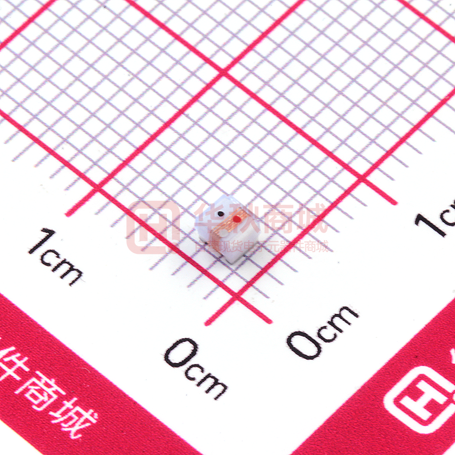

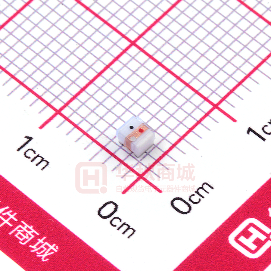

    固定电感器 82nH ±2% 60@350MHz 1008 2.92 x 2.79mm 1A 0.22Ω 1GHz 2.03mm
FEC1008CP-82NG-LRH 数据手册
FEC1008CP Series ■ SMD Wire Wound Ceramic Chip Inductors MECHANICAL DIMENSIONS 0.51 1.52 0.51 2.79 Max. 1.02 1.27 1.02 2.54 2.03 Max. 2.92 Max. 1R0~150: 2.10 Max. FEC1008CP Recommended Patterns unit: mm ELECTRICAL SPECIFICATION 1500 SRF (GHz) Min. 4.00 DCR (Ω) Max. 0.15 Part Number Inductance (nH) Inductance Tolerance Test Freq. (MHz) Q Min. Test Freq. (MHz) FEC1008CP-5N6□-LRH 5.6 K, J 50 50 Irms (mA) Color Code 1000 1st GREEN 2nd BLUE multiplier WHITE K, J 50 50 500 4.10 0.08 1000 BROWN BLACK BLACK 12 K, J 50 50 500 3.30 0.09 1000 BROWN RED BLACK FEC1008CP-15N□-LRH 15 K, J 50 50 500 2.50 0.10 1000 BROWN GREEN BLACK FEC1008CP-18N□-LRH 18 K, J, G 50 50 350 2.50 0.11 1000 BROWN GRAY BLACK FEC1008CP-22N□-LRH 22 K, J, G 50 55 350 2.40 0.12 1000 RED RED BLACK FEC1008CP-24N□-LRH 24 K, J, G 50 55 350 1.90 0.13 1000 RED YELLOW BLACK FEC1008CP-27N□-LRH 27 K, J, G 50 55 350 1.60 0.13 1000 RED VIOLET BLACK FEC1008CP-33N□-LRH 33 K, J, G 50 60 350 1.60 0.14 1000 ORANGE ORANGE BLACK FEC1008CP-36N□-LRH 36 K, J, G 50 60 350 1.60 0.15 1000 ORANGE BLUE BLACK FEC1008CP-39N□-LRH 39 K, J, G 50 60 350 1.50 0.15 1000 ORANGE WHITE BLACK FEC1008CP-47N□-LRH 47 K, J, G 50 65 350 1.50 0.16 1000 YELLOW VIOLET BLACK FEC1008CP-56N□-LRH 56 K, J, G 50 65 350 1.30 0.18 1000 GREEN BLUE BLACK FEC1008CP-62N□-LRH 62 K, J, G 25 45 350 1.25 0.20 1000 BLUE RED BLACK FEC1008CP-68N□-LRH 68 K, J, G 50 65 350 1.30 0.20 1000 BLUE GRAY BLACK FEC1008CP-75N□-LRH 75 K, J, G 50 60 350 1.10 0.21 1000 VIOLET GREEN BLACK FEC1008CP-82N□-LRH 82 K, J, G 50 60 350 1.00 0.22 1000 GRAY RED BLACK FEC1008CP-91N□-LRH 91 K, J, G 50 50 350 1.00 0.45 1000 WHITE BROWN BLACK FEC1008CP-R10□-LRH 100 K, J, G 25 60 350 1.00 0.56 650 BROWN BLACK BROWN FEC1008CP-R12□-LRH 120 K, J, G 25 60 350 0.950 0.63 650 BROWN RED BROWN FEC1008CP-R15□-LRH 150 K, J, G 25 45 100 0.850 0.70 580 BROWN GREEN BROWN BROWN FEC1008CP-R18□-LRH 180 K, J, G 25 45 100 0.750 0.77 620 BROWN GRAY FEC1008CP-R20□-LRH 200 K, J, G 25 50 100 0.750 0.81 500 RED BLACK BROWN FEC1008CP-R22□-LRH 220 K, J, G 25 45 100 0.700 0.84 500 RED RED BROWN FEC1008CP-R24□-LRH 240 K, J, G 25 50 100 0.650 0.84 500 RED YELLOW BROWN FEC1008CP-R27□-LRH 270 K, J, G 25 45 100 0.600 0.91 500 RED VIOLET BROWN BROWN FEC1008CP-R30□-LRH 300 K, J, G 25 45 100 0.590 1.00 660 ORANGE BLACK FEC1008CP-R33□-LRH 330 K, J, G 25 45 100 0.570 1.05 450 ORANGE ORANGE BROWN FEC1008CP-R36□-LRH 360 K, J, G 25 45 100 0.530 1.05 660 ORANGE BLUE BROWN FEC1008CP-R39□-LRH 390 K, J, G 25 45 100 0.500 1.12 470 ORANGE WHITE BROWN FEC1008CP-R43□-LRH 430 K, J, G 25 45 100 0.480 1.15 600 YELLOW ORANGE BROWN FEC1008CP-R47□-LRH 470 K, J, G 25 45 100 0.450 1.19 470 YELLOW VIOLET BROWN FEC1008CP-R56□-LRH 560 K, J, G 25 45 100 0.415 1.33 400 GREEN BLUE BROWN FEC1008CP-R62□-LRH 620 K, J, G 25 45 100 0.375 1.40 300 BLUE RED BROWN FEC1008CP-R68□-LRH 680 K, J, G 25 45 100 0.375 1.47 400 BLUE GRAY BROWN BROWN FEC1008CP-R75□-LRH 750 K, J, G 25 45 100 0.360 1.54 360 VIOLET GREEN FEC1008CP-R82□-LRH 820 K, J, G 25 45 100 0.350 1.61 400 GRAY RED BROWN FEC1008CP-R91□-LRH 910 K, J, G 25 35 50 0.320 1.68 380 WHITE BROWN BROWN FEC1008CP-1R0□-LRH 1000 K, J, G 25 35 50 0.290 1.75 370 BROWN BLACK RED FEC1008CP-1R2□-LRH 1200 K, J, G 7.9 35 50 0.250 2.00 310 BROWN RED RED FEC1008CP-1R5□-LRH 1500 K, J, G 7.9 28 50 0.200 2.30 330 BROWN GREEN RED FEC1008CP-1R8□-LRH 1800 K, J, G 7.9 28 50 0.160 2.60 300 BROWN GRAY RED FEC1008CP-2R0□-LRH 2000 K, J, G 7.9 25 50 0.160 2.80 280 RED BLACK RED FEC1008CP-2R2□-LRH 2200 K, J, G 7.9 28 50 0.160 2.80 280 RED RED RED FEC1008CP-2R7□-LRH 2700 K, J, G 7.9 22 25 0.140 3.20 290 RED VIOLET RED FEC1008CP-3R3□-LRH 3300 K, J, G 7.9 22 25 0.110 3.40 290 ORANGE ORANGE RED FEC1008CP-3R9□-LRH 3900 K, J, G 7.9 20 25 0.100 3.60 260 ORANGE WHITE RED FEC1008CP-4R7□-LRH 4700 K, J, G 7.9 20 25 0.090 4.00 260 YELLOW VIOLET RED FEC1008CP-5R6□-LRH 5600 K, J 7.9 16 7.96 0.020 4.00 240 GREEN BLUE RED Leaded 10 SMD FEC1008CP-10N□-LRH FEC1008CP-12N□-LRH 33 FEC1008CP Series ■ SMD Wire Wound Ceramic Chip Inductors ELECTRICAL SPECIFICATION Part Number Inductance (nH) Inductance Tolerance Test Freq. (MHz) Q Min. Test Freq. (MHz) FEC1008CP-6R8□-LRH 6800 K, J 7.9 15 7.96 SRF (GHz) Min. 0.040 DCR (Ω) Max. 4.90 Color Code Irms (mA) 1st BLUE 200 2nd GRAY multiplier RED FEC1008CP-8R2□-LRH 8200 K, J 7.9 15 7.96 0.025 6.00 170 GRAY RED RED FEC1008CP-100□-LRH 10000 K, J 2.52 15 7.96 0.020 9.00 150 BROWN BLACK ORANGE FEC1008CP-120□-LRH 12000 K, J 2.52 15 7.96 0.018 10.50 130 BROWN RED ORANGE FEC1008CP-150□-LRH 15000 K, J 2.52 15 7.96 0.015 11.50 120 BROWN GREEN ORANGE • External electrode: FEC1008CP (Sn-plating), FEC1008C (Au-plating) • Tolerance: K=±10%;J=±5%;G=±2% • Operating Temp: -40℃ to +125℃ • For 15℃ Temperature Rise. • Inductance & Q measured using the HP4291B. • SRF measured using the HP8753E,or HP8720D. • DCR measured using the 16502BC milli-ohm meter. • Unspecified values available on request. CHARACTERISTIC CURVE FEC1008CP Series SMD Inductance vs. Frequency R68 Leaded Inductance (nH) R68 R10 1000 34 Typical Q vs. Frequency 200 10000 150 R10 47N 47N 100 Q 100 15N 15N 50 10 1 0 1 10 100 Frequency (MHz) 1000 10000 1 10 100 Frequency (MHz) 1000 10000
