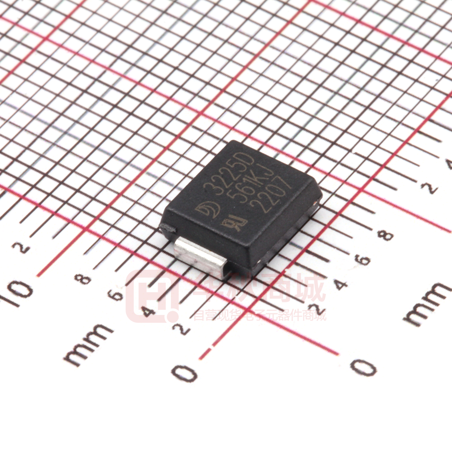

山东晶导微电子股份有限公司 3225 Series Jingdao Microelectronics co.LTD Applications Features • S urge protection in consumer electronics. • Surge protection in industrial electronics. • Surge protection in electronics home • Appliances,gas and petroleum appliances. • Relay and electromagnetic valve surge absorption • Wide operating voltage (V1mA) range from 18V to 750V • Fast responding to transient over-voltage • Large absorbing transient energy capability • Low clamping ratio and no following-on current Part Number Code 3225 D Package 封装名称 Chip Shap 芯片形状 圆形 Disc 7 4 1 K Varistor Voltage 压敏电阻动态电压 Tolerance 误差 Examples:例如 K ±10% L ±15% M ±20% or Customer Special Requirement 4 7 0 47*10 0 =47V 4 7 1 1 47*10 =470V 1 1 2 J High Surge/Lead Style 高焦/脚型 空白常规 J 高能品 11*10 2 =1100V 2020.12 www.sdjingdao.com Page 1 of 5 山东晶导微电子股份有限公司 3225 Series Jingdao Microelectronics co.LTD Mechanical Requirements Solderability Min. 95% of The Terminal Should Be Covered With Solder Uniformly V1mA/V1mA≤±5% Resistance of soldering heat Solder Temp:265±5℃ Immersed Time: 2±0.5Sec. Solder Temp: 260±5℃ Immersed Time: 10±1Sec. Enviromental Requirements High Temperature Storage △V1mA/V1mA ≦±5% Ambient Temp: 125±2℃ Duration:1000h Low Temperature Storage △V1mA/V1mA ≦±5% Ambient Temp: -40±2℃ Duration:1000h High Humidity Storage/Damp Heat △V1mA/V1mA ≦±5% Ambient Temp: 40±2℃ 90-95% R.H. Duration:1000h Step Temperature Temperature Cycle High Temperature Load Damp Heat Load/ Humidity Load △V1mA/V1mA ≦±5% 1 -50℃ 30min 2 Room Temp 15min 3 150℃ 30min 4 Room Temp 15min △V1mA/V1mA ≦±10% Ambient temp:85±2℃ Duration:1000h Load: Max. Allowable Voltage △V1mA/V1mA ≦±10% 1.Temperature : 40±2℃ 2.Humidity : 90~95% RH 3.Rated working voltage applied 4.Time : 500±2 hours 5.Test after placing in ambient temperature for 24 hours. Operating Temperature Range -40℃ ~ +125℃ -40℃ ~ +125℃ Storage Temperature Range -55℃ ~ +125℃ -55℃ ~ +125℃ 2020.12 Period www.sdjingdao.com Page 2 of 5 山东晶导微电子股份有限公司 3225 Series Jingdao Microelectronics co.LTD Characteristics at Ta = 25°C Maximum Allowable Voltage Type Number Marking V AC V DC Varistor Voltage V 1mA Maximum Withstanding Clamping Surge Voltage Current IT VC I(A) I(A) Rated Power Typical Capacitance (Reference) High Surge W @1KHz(pF) Maximum Energy (J) High Standard Surge Standard (J) Standard High Surge Standard High Surge V V V A V 3225D180K 3225D180KJ 3225D180K 3225D180KJ 11 14 18(15~21.6) 1 40 100 250 0.4 0.6 0.01 1400 3225D220K 3225D220KJ 3225D220K 3225D220KJ 14 18 22(19.5~26) 1 48 100 250 0.5 0.7 0.01 1150 930 3225D270K 3225D270KJ 3225D270K 3225D270KJ 17 22 27(24~30) 1 60 100 250 0.6 0.9 0.01 3225D330K 3225D330KJ 3225D330K 3225D330KJ 20 26 33(29.5~36.5) 1 73 100 250 0.8 1.1 0.01 760 3225D390K 3225D390KJ 3225D390K 3225D390KJ 25 31 39(35~43) 1 80 100 250 0.9 1.2 0.01 640 0.01 530 3225D470K 3225D470KJ 3225D470K 3225D470KJ 30 38 47(42~54) 1 104 100 250 1.1 1.5 3225D560K 3225D560KJ 3225D560K 3225D560KJ 35 45 56(50~62) 1 123 100 250 1.3 1.8 0.01 450 3225D680K 3225D680KJ 3225D680K 3225D680KJ 40 56 68(61~75) 1 150 100 250 1.6 2.2 0.01 370 3225D820K 3225D820KJ 3225D820K 3225D820KJ 50 65 82(74~90) 5 145 400 800 2.5 4 0.1 300 85 3225D101K 3225D101KJ 3225D101K 3225D101KJ 60 100(90~110) 5 177 400 800 3 4.1 0.1 250 3225D121K 3225D121KJ 3225D121K 3225D121KJ 75 100 120(108~132) 5 210 400 800 4 4.9 0.1 210 3225D151K 3225D151KJ 3225D151K 3225D151KJ 95 125 150(135~165) 5 260 400 800 4.1 6.5 0.1 165 3225D181K 3225D181KJ 3225D181K 3225D181KJ 115 150 180(162~198) 5 320 400 800 4.9 7.5 0.1 140 3225D201K 3225D201KJ 3225D201K 3225D201KJ 130 170 200(180~220) 5 355 400 800 6.5 8.5 0.1 125 3225D221K 3225D221KJ 3225D221K 3225D221KJ 140 180 220(198~242) 5 380 400 800 7.5 9 0.1 110 100 3225D241K 3225D241KJ 3225D241K 3225D241KJ 150 200 240(216~264) 5 415 400 800 8 10.5 0.1 3225D271K 3225D271KJ 3225D271K 3225D271KJ 175 225 270(243~297) 5 475 400 800 8.5 11 0.1 95 3225D301K 3225D301KJ 3225D301K 3225D301KJ 190 250 300(270~330) 5 520 400 800 9 12 0.1 85 75 3225D331K 3225D331KJ 3225D331K 3225D331KJ 210 275 330(297~363) 5 570 400 800 9.5 13 0.1 3225D361K 3225D361KJ 3225D361K 3225D361KJ 230 300 360(324~396) 5 620 400 800 10 16 0.1 70 3225D391K 3225D391KJ 3225D391K 3225D391KJ 250 320 390(351~429) 5 675 400 800 12 17 0.1 65 3225D431K 3225D431KJ 3225D431K 3225D431KJ 275 350 430(387~473) 5 745 400 800 13 20 0.1 60 385 3225D471K 3225D471KJ 3225D471K 3225D471KJ 300 470(423~517) 5 810 400 800 15 21 0.1 55 3225D511K 3225D511KJ 3225D511K 3225D511KJ 320 415 510(459~561) 5 845 400 800 16 22.5 0.1 50 3225D561K 3225D561KJ 3225D561K 3225D561KJ 350 460 560(504~616) 5 920 400 800 16 24 0.1 50 3225D621K 3225D621KJ 3225D621K 3225D621KJ 385 505 620(558~682) 5 1025 400 800 21 25 0.1 40 3225D681K 3225D681KJ 3225D681K 3225D681KJ 420 560 680(612~748) 5 1120 400 800 21 29 0.1 35 3225D751K 3225D751KJ 3225D751K 3225D751KJ 460 615 750(675~825) 5 1240 400 800 22.4 32 0.1 30 2020.12 www.sdjingdao.com Page 3 of 5 山东晶导微电子股份有限公司 3225 Series Jingdao Microelectronics co.LTD PACKAGE OUTLINE 3225 Plastic surface mounted package; 2 leads E A A1 A C b D L E1 VM A A E D E1 A1 C L b max 2.80 7.0 6.2 8.0 0.21 0.31 1.6 3.25 min 2.60 6.5 5.6 7.6 0.05 0.15 0.9 2.75 max 110 276 244 315 8.3 12 63 128 min 94 256 220 299 2.0 5.9 35 108 UNIT mm mil The recommended mounting pad size Marking code 1.4 55 Jingdao Logo UL Accreditation Logo 3.2 126 6.6 260 mm Unit : (mil) 2020.12 3225D 471KJ 2101 3225D: Package 471KJ:Type number 2101:年/周代码 Years/Week code 例:2101--2021年01周 说明 NOTE: 周代码按公历日期在本年度的实际周数为准。 The weekly code is based on the actual number of weeks in the calendar year. www.sdjingdao.com Page 4 of 5 山东晶导微电子股份有限公司 3225 Series Jingdao Microelectronics co.LTD 2,500 3225 5,000 25 , 000 2020.12 Symbol Spec Symbol Spec W E F D0 D1 P0 P1 P2 T t1 16.0±0.30 1.75±0.10 7.50±0.10 1.55±0.05 1.50±0.25 4.0±0.10 8.0±0.10 2.0±0.05 0.28±0.02 0.08以上 A0 B0 K0 10P0 6.22±0.10 8.31±0.10 2.49±0.10 40.0±0.20 www.sdjingdao.com Page 5 of 5
