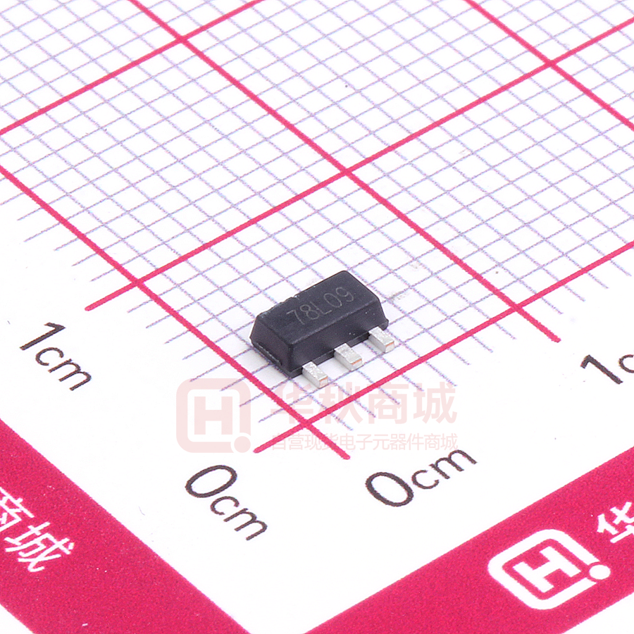

SL78L09 3-Terminal Voltage Regulator Features  Input voltage:up to 30V  Output: 9 V  Output current up to 100 mA, internal thermal 1. OUT 2. GND 3. IN overload protection and short-circuit limiting. SOT-89 Maximum Ratings Ratings at TA = 25℃ ambient temperature unless otherwise specified. Parameter Symbols Value Units Input Voltage VI 30 V Output Current IO 100 mA Junction Temperature TJ 150 ℃ TOPR -40~125 ℃ PD 500 mW TSTG -55~150 ℃ Operating Temperature Range Power Dissipation Storage Temperature Range Vi 1 3 C1 2 0.33 µF www.slkormicro.com Vo C2 0.1 µF 1 SL78L09 Electrical Characteristic Ratings at TA = 25℃ ambient temperature, 0℃≤TJ≤125℃ VI=15V, Io=40mA, Ci=0.33μF,Co=0.1μF,unless otherwise specified. Parameter Output Voltage Symbols VO Test Conditions Min Typ Max Unit TJ=25℃ 8.64 9 9.36 V 8.55 9 9.45 V 8.55 9 9.45 V VI=11.5V to 24V TJ=25℃ 200 mV VI=13V to 24V 150 mV IO=1mA to 100 mA, TJ=25℃ 90 mV IO=1mA to 40 mA, TJ=25℃ 45 mV IO=1mA to 30mA VI=11.5V to 24V IO=1mA to 70mA Line Regulation △ Load Regulation △ Vo VO TJ=25℃ Ripple Rejection RR VI=12V to 23V, TJ=25℃ f=120Hz Output Noise Voltage VN f=10Hz~100KHz Dropout Voltage VD Quiescent Current IQ Quiescent Current Change www.slkormicro.com △ IQ TJ=25℃ 36 44 dB 49 μV 1.7 V 5.5 mA VI=13V to 24V 1.5 mA IO=1mA to 40mA 0.1 mA 2 SL78L09 Ratings and Characteristic Curves www.slkormicro.com 3 SL78L09 Package Outline SOT-89 www.slkormicro.com Dimensions in mm 4
