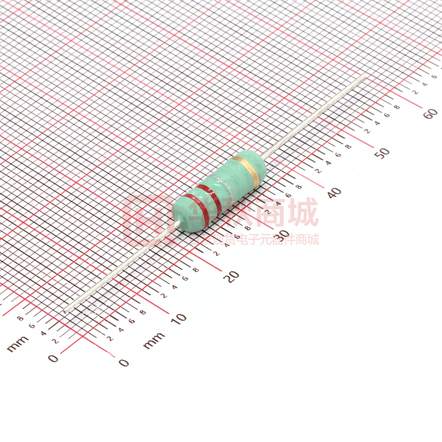

    插件电阻 220mΩ ±5% 3W ±300ppm/℃
KNP3WSJT-52-0R22 数据手册
Through-hole resistors General Type Wirewound Resistors Normal & Miniature Style [ KNP Series ] FEATURES INTRODUCTION Power Rating 1/4W, 1/2W, 1W, 2W, 3W, 4W, 5W, 7W Resistance Tolerance ±1%, ±5% T.C.R. ±300ppm/°C Flameproof Multi-layer Coating Meets UL-94V-0 Flameproof Feature Meets Overload Test UL-1412 DERATING CURVE The resistor element is a resistive wire which is wound in a single layer on a ceramic rod, with tinned connecting wires of electrolytic copper welded to the end-caps. The ends of the resistive wire are connected to the caps by welding. The resistors are coated with layers of green color flame-proof lacquer. For resistors operated in ambient temperatures above 40°C, power rating must be derated in accordance with the curve below. 40 70 Rated Load (%) 200 275 °C 100 3W-7W 80 1/4W-3WS 60 40 20 50 100 150 200 250 300 Ambient Temperature (°C) DIMENSIONS Unit: mm STYLE Miniature L øD H ød KNP-25 KNP50S 6.3±0.5 2.5±0.3 28±2.0 0.55±0.05 KNP-50 KNP1WS 9.0±0.5 3.5±0.3 26±2.0 0.55±0.05 11.5±1.0 4.6±0.5 35±2.0 0.8±0.05 KNP3WS 15.5±1.0 5.2±0.5 33±2.0 0.8±0.05 KNP5WS 17.5±1.0 6.2±0.5 32±2.0 0.8±0.05 KNP7WS 24.5±1.0 8.2±0.5 38±2.0 0.8±0.05 - 24.5±1.0 8.2±0.5 38±2.0 0.8±0.05 KNP100 ød H L øD KNP200 KNP300 KNP400 KNP500 KNP600 KNP700 Note: KNP1WS ( for MB Type ) ød = 0.8±0.05 mm DIMENSION Normal KNP2WS KNP3SS 43 ELECTRICAL CHARACTERISTICS Normal STYLE STYLE KNP-25 KNP-50 KNP100 KNP200 Power Rating at 40°C Power Rating at 70°C 1/4W 1/2W 1W KNP300 KNP400 KNP500 KNP600 KNP700 3W 4W 5W 6W 7W 2W Maximum working voltage PxR Voltage Proof on Insulation 250V 300V 400V Resistance Range (±1%) 0.1Ω - 150Ω 0.1Ω - 750Ω 0.1Ω - 1.5KΩ 0.1Ω - 2.4KΩ 0.1Ω - 3.3KΩ 0.1Ω - 6.2KΩ Resistance Range (±5%) 0.1Ω - 200Ω 0.1Ω - 800Ω 0.1Ω - 2.2KΩ 0.1Ω - 2.7KΩ 0.1Ω - 3.9KΩ 0.1Ω - 6.8KΩ Operating Temp. Range -40°C to +200°C Temperature Coefficient ±300ppm/°C Note: Special value is available on request MINIATURE STYLE STYLE KNP50S KNP1WS KNP2WS KNP3SS KNP3WS Power Rating at 40°C Power Rating at 70°C 1/2W 1W 2W KNP5WS KNP7WS 5W 7W 3W Maximum working voltage PxR Voltage Proof on Insulation 200V 300V 400V Resistance Range (±1%) 0.1Ω - 150Ω 0.1Ω - 750Ω 0.1Ω - 1.5KΩ 0.1Ω - 2.4KΩ 0.1Ω - 3.3KΩ Resistance Range (±5%) 0.1Ω - 200Ω 0.1Ω - 800Ω 0.1Ω - 2.2KΩ 0.1Ω - 2.7KΩ 0.1Ω - 3.9KΩ Operating Temp. Range -40°C to +200°C Temperature Coefficient ±300ppm/°C Note: Special value is available on request ENVIRONMENTAL CHARACTERISTICS PERFORMANCE TEST TEST METHOD APPRAISE Short Time Overload IEC 60115-1 4.13 10 times rated power for 5 Sec. ±2.0%+0.05Ω Voltage Proof on Insulation IEC 60115-1 4.7 In V-Block for 60 sec., test voltage as above table No Breakdown Temperature Coefficient IEC 60115-1 4.8 Between -40°C to +155°C By type Insulation Resistance IEC 60115-1 4.6 in V-block for 60 Sec. >100MΩ Solderability IEC 60115-1 4.17 235±5°C for 3±0.5 Sec 95% Min. coverage Solvent Resistance of Marking IEC 60115-1 4.30 IPA for 5±0.5 Min. with ultrasonic No deterioration of coatings and markings Robustness of Terminations IEC 60115-1 4.16 Direct load for 10 Sec. in the direction of the terminal leads ≥2.5kg (24.5N) Damp Heat Steady State IEC 60115-1 4.24 40±2°C, 90-95% RH for 56 days, loaded with 0.1 times RCWV ±5.0%+0.05Ω Endurance at 70°C IEC 60115-1 4.25 70±2°C at RCWV (or Umax., Whichever less) for 1,000 Hr. (1.5Hr.on, 0.5Hr. Off) ±5.0%+0.05Ω Temperature Cycling IEC 60115-1 4.19 -55°C  Room Temp.  +155°C  Room Temp. (5 cycles) ±1.0%+0.05Ω Resistance to Soldering Heat IEC 60115-1 4.18 260±3°C for 10±1 Sec., immersed to a point 3±0.5mm from the body ±1.0%+0.05Ω Accidental Overload Test IEC 60115-1 4.26 4 times RCWV for 1 Min. No evidence of flaming or arcing Note: Rated Continuous Working Voltage (RCWV) =  Power Rating x Resistance Value or Max. working voltage listed above, whichever less. Revision: 2020

参数特性:文档列出了电阻器的多种参数,包括功率等级(1/4W, 1/2W, 1W, 2W, 3W, 4W, 5W, 7W)、电阻容差(±1%, ±5%)、温度系数(±300ppm/°C)、阻燃特性(符合UL-94V-0和UL-1412)。
功能详解:文档提供了电阻器的电气特性,包括在不同温度下的最大工作电压、绝缘电压测试、电阻范围、工作温度范围等。
应用信息:文档中没有直接提供应用信息,但根据电阻器的特性,它们可能用于需要高功率和精确电阻值的场合。
封装信息:文档提供了不同型号电阻器的尺寸信息,包括直径、高度、外径等。
