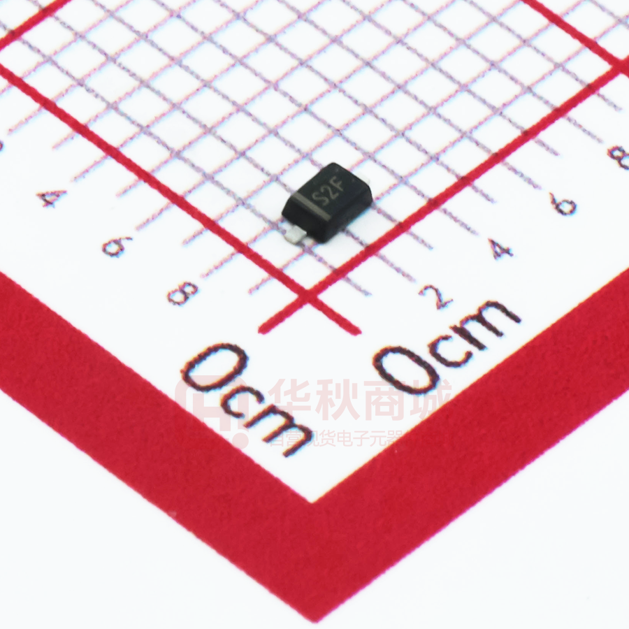

PSBD3DF40V2H Low VF Schottky Barrier Diode Feature  Forward Current: 2A  Reverse voltage: 40V  Low forward voltage  Low leakage current  Trench MOS barrier Schottky technology  Ultra Small mold type. (SOD-323F) SOD-323F(Top View) Applications Pin 1  Low current rectification  Voltage clamping  Protection circuits  Ultra high-speed switching Pin 2 Circuit Diagram S2F Marking (Top View) Mechanical Characteristics  Lead finish:100% matte Sn(Tin)  Mounting position: Any  Device meets MSL 1 requirements  Qualified max reflow temperature:260℃ Electrical characteristics per line@25℃ Parameter Symbol Min. Typ. Max. Unit Conditions Forward voltage VF - 0.38 0.42 V IF=500mA Forward voltage VF - 0.42 0.46 V IF=1A Forward voltage VF - 0.44 0.49 V IF=1.5A Forward voltage VF 0.47 0.53 V IF=2A Reverse current IR - - 50 uA VR=40V Junction Capacitance CJ - 300 - pF Rev.06.1 1 VR=0V f =1MHz www.prisemi.com Low VF Schottky Barrier Diode PSBD3DF40V2H Absolute maximum rating@25℃ Parameter Symbol limits Unit Reverse voltage(repetitive peak) VRM 40 V Reverse voltage (DC) VR 40 V Average rectified forward current Io 2 A IFSM 15 A Parameter Symbol limits Unit Power Dissipation PD 280 mW Thermal resistance,Note1 RθJA 350 ℃/W Operating Junction temperature Range TJ -55 to 125 ℃ Storage temperature TSTG -55 to 125 ℃ Non-Repetitive Peak Forward Surge Current(8.3ms single half sine-wave superimposed on rated load) Note1: R-4 PCB, Minimum recommended pad layout. 10000 10000 1000 1000 IR –Reverse Current (uA) IF –Forward Current (mA) Typical Characteristics 100 125℃ 10 75℃ 1 25℃ 0.1 125℃ 75℃ 100 10 25℃ 1 0.1 -25℃ -25℃ 0.01 0.01 0.001 0.0 0.1 0.2 0.3 0.4 VF – Forward Voltage (V) 0.5 Fig 1. Forward Voltage Rev.06.1 0.001 0 5 10 15 20 25 30 VR – Reverse Voltage (V) 35 Fig 2. Leakage Current 2 www.prisemi.com 40 Low VF Schottky Barrier Diode PSBD3DF40V2H 350 C-Junction capacitance (pF) 300 250 200 150 100 50 0 0 5 10 15 20 25 VR-Reverse voltage (V) 30 35 40 Fig 3. Capacitance vs. Reveres voltage Temperature of Soldering Solder Reflow Recommendation R Remark: Pb free for 260℃;Pb for 245℃. Rev.06.1 3 www.prisemi.com Low VF Schottky Barrier Diode PSBD3DF40V2H Product dimension (SOD-323F) Millimeters Dim A B E C MIN TYP MAX A 1.60 1.70 1.80 B 1.15 1.25 1.35 C 2.30 2.50 2.70 D 0.60 0.70 0.80 E 0.20 0.30 0.40 F 0.08 0.13 0.18 D F 2.9mm 0.5mm 0.8mm Suggested PCB Layout Ordering information Device Package Reel MPQ PSBD3DF40V2H SOD-323F(Pb-Free) 7" 3000 / Tape & Reel Rev.06.1 4 www.prisemi.com Low VF Schottky Barrier Diode PSBD3DF40V2H Load with information USER DIRECTION OF FEED 1.60 ± 0.05 4.00 ± 0.05 4.00 ± 0.05 1.75 ± 0.05 3.50 ± 0.05 8.00 ± 0.20 Φ1.00 ± 0.10 Unit:mm S2F Rev.06.1 5 www.prisemi.com Low VF Schottky Barrier Diode PSBD3DF40V2H IMPORTANT NOTICE and are registered trademarks of Prisemi Electronics Co., Ltd (Prisemi) ,Prisemi reserves the right to make changes without further notice to any products herein. Prisemi makes no warranty, representation or guarantee regarding the suitability of its products for any particular purpose, nor does Prisemi assume any liability arising out of the application or use of any product or circuit, and specifically disclaims any and all liability, including without limitation special, consequential or incidental damages. “Typical” parameters which may be provided in Prisemi data sheets and/or specifications can and do vary in different applications and actual performance may vary over time. All operating parameters, including “Typicals” must be validated for each customer application by customer’s technical experts. Prisemi does not convey any license under its patent rights nor the rights of others. The products listed in this document are designed to be used with ordinary electronic equipment or devices, Should you intend to use these products with equipment or devices which require an extremely high level of reliability and the malfunction of with would directly endanger human life (such as medical instruments, aerospace machinery, nuclear-reactor controllers, fuel controllers and other safety devices), please be sure to consult with our sales representative in advance. Website: http://www.prisemi.com For additional information, please contact your local Sales Representative. ©Copyright 2009, Prisemi Electronics is a registered trademark of Prisemi Electronics. All rights are reserved. Rev.06.1 6 www.prisemi.com
