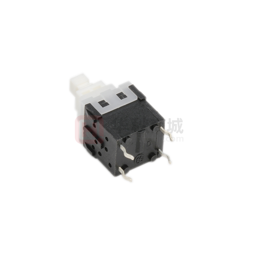

    ROCPU(台普)
    插件
    按动开关 5万次 直插 单刀双掷 100mA 3.5N 30V -10℃~+70℃
TP5124111250 数据手册
A B D C 12.40[0.488]±0.20 E G 6.50[0.256] 3 7.80 [0.307] 7.00[0.276]±0.20 1 2 [ .2 0 Ø1 .0 Ø0 47 ] 1 6.00[0.236] 1 11.00 [0.433]±0.20 F 2 4 9.40[0.370] 5 PCB LAYOUT 6 4 3 7 8.20[0.323]±0.20 2 Technical parameter 技术参数 1. Rated current: dc30v 0.1A DC 2V 10 μ A(min) 1.额定电流:DC30V 0.1A DC 2V 10μ A(min) 2. High voltage resistance: AC 500V (50 / 60Hz) for one minute 2.耐高压:AC 500V(50/60Hz)持续一分钟 3. Contact impedance: 100 milliohm Max 3.接触阻抗:100毫欧max 4. Insulation impedance: 100 megohm min.500v DC 4.绝缘阻抗:100兆欧min.500V DC 5. Operating force: 350 ± 100gf 3.50[0.138]±0.30 4 4.50 [0.177] 2.50[0.098] 1.00[0.0394] 1 2 3 4 Circuit diagram 25.00[0.984]±0.30 3.00[0.118] 12.80[0.504]±0.20 OT:3.00[0.118] 3 PTPT:1.50[0.059]±0.50 TT:4.50[0.177]±0.50 3.30[0.130]±0.10 9.10[0.358]±0.20 3.30[0.130]±0.10 7 6 5 4 3 0.80[0.031]±0.10 4-0.40 [0.016] 2 6.00 [0.236]±0.20 9.40[0.370]±0.30 10.70 [0.421]±0.30 1 9.70[0.382] NO 序号 A4 5 COMMON A3 台普 A2 A1 REV DATE REVISION DESCRIPTION ISSUE TOLERANCE X.XX ± 0.10 X.X ± 0.15 X ± 0.25 ANGULAR UNIT Crochet hook 钩针 Terminal 端子 Base 底座 Steel wire 钢丝 Brass 黄铜 1 4 Ag plating/min=0.15um 镀银/镀层=0.15um PA66 1 Black 黑色 Reed 簧片 Phosphor copper 磷铜 2 Ag plating/min=0.15um 镀银/镀层=0.15um Spring 弹簧 Cover 盖板 Guide core 导芯 Steel wire 钢丝 1 POM 1 white 白色 PA66 1 white 白色 Part name 部件名 Material 材料 QTY 数量 Remark 备注 MM DRAWN BY FUYUAN DATE 5.操作力:350±100gf 6. Full stroke: 4.5mm ± 0.5mm 6.全行程:4.5mm±0.5mm 7. Operation type: self-locking 7.运行类型:自锁 8. Mechanical life: 100000 times 8.机械寿命:100,000次 9. Load life: 50000 times 9.负载寿命:50,000次 10. Working temperature: - 10 ℃ ~ 70 ℃ 10.工作温度:-10℃~70℃ 2019 PROJCTED PRODUCT NAME: CHECKED BY COCO APPROVAL B ALEN MODEL NO: TP5124111250 Https: www.rocpu.tw ROCPU TECHNOLONGY CO.,LTD Copies are issued in strict confidence and shall not be reproduced or copied,or used as the basic of manufacture or sale of apparatus without permission F
