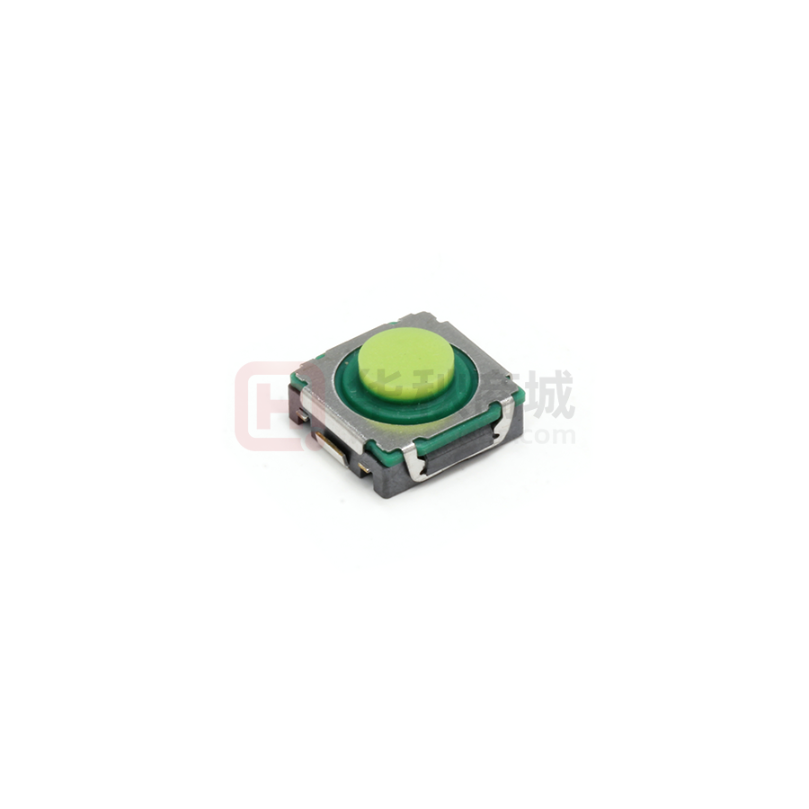

    ROCPU(台普)
    SMD
    防水轻触开关 8.4mm*8.4mm*3.95mm 按钮/盖帽颜色:黄绿色 额定值:DC16V 50mA MAX 接触电阻:100mΩ MAX 电路结构:单刀单掷 安装方式:立贴 按钮形状:圆形按钮 ...
TP1602370395 数据手册
A B D C 8.40 [0.331]±0.20 E 2 8.70[0.342]±0.20 8.40[0.331]±0.20 1 Ø4.30 [0.169] 2.70[0.106] 3.95[0.156]±0.20 2.55[0.100] 4 2.10 [0.083] 8.10 [0.319] PCB LAND DIMENSION A4 5 COMMON A3 台普 A2 A1 REV DATE REVISION DESCRIPTION ISSUE TOLERANCE X.XX ± 0.10 X.X ± 0.15 X ± 0.25 ANGULAR 2 CIRCUITDIAGRAM 1.70 [0.067] UNIT MM DRAWN BY FUYUAN DATE 2019 G SPECIFICATION 规格 1.Rating:DC16V 50mA MAX 1.额定值:DC16V 50mA MAX 2.Contact resistance:100mΩ MAX 2.接触电阻:100mΩ MAX 3.Insulation resistance:100MΩ Min,100V DC 3.绝缘电阻:100MΩMin,100V DC 4.Dielectric strength:250VAC 4.介电强度:250VAC 5.Operating temperature range:-40℃ to ﹢90℃ 5.工作温度范围:-40℃至﹢90℃ 6.Operating force:700±80gf 6.操作力:700±80gf 7.Operating life:500,000 cycles 7.使用寿命:500000次循环 8.Travel:0.9±0.2mm 8.行程:0.9±0.2mm Waterproof grade:IP67 9.防水等级:IP67 1.00 [0.039]±0.10 1 3 F 5 Terminal 端子 Brass 黄铜 1 Ag plating 镀银 4 Base 基座 LCP 1 Black 黑色 3 Contact 弹片 SUS 1 Ag plating 镀银 2 Stem 按钮 Silicone 硅胶 1 Yellow green 黄绿色 1 Cover 盖板 SUS 1 NO 序号 Part name 部件名 Material 材料 QTY 数量 PROJCTED Remark 备注 PRODUCT NAME: CHECKED BY COCO MODEL NO: TP1602370395 APPROVAL B ALEN Https: www.rocpu.tw ROCPU TECHNOLONGY CO.,LTD Copies are issued in strict confidence and shall not be reproduced or copied,or used as the basic of manufacture or sale of apparatus without permission F
