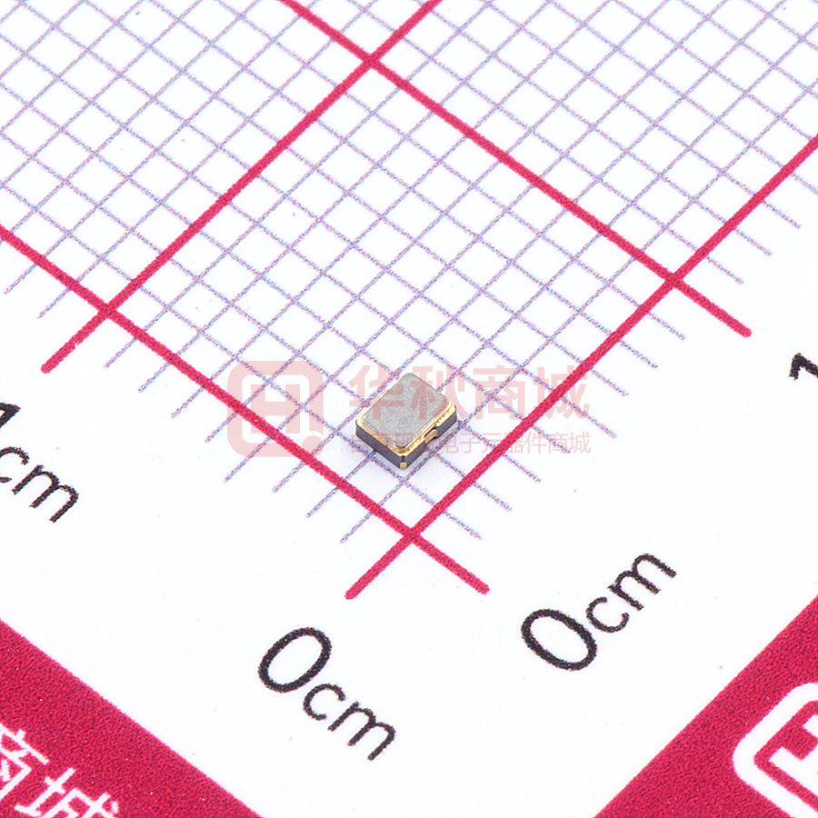

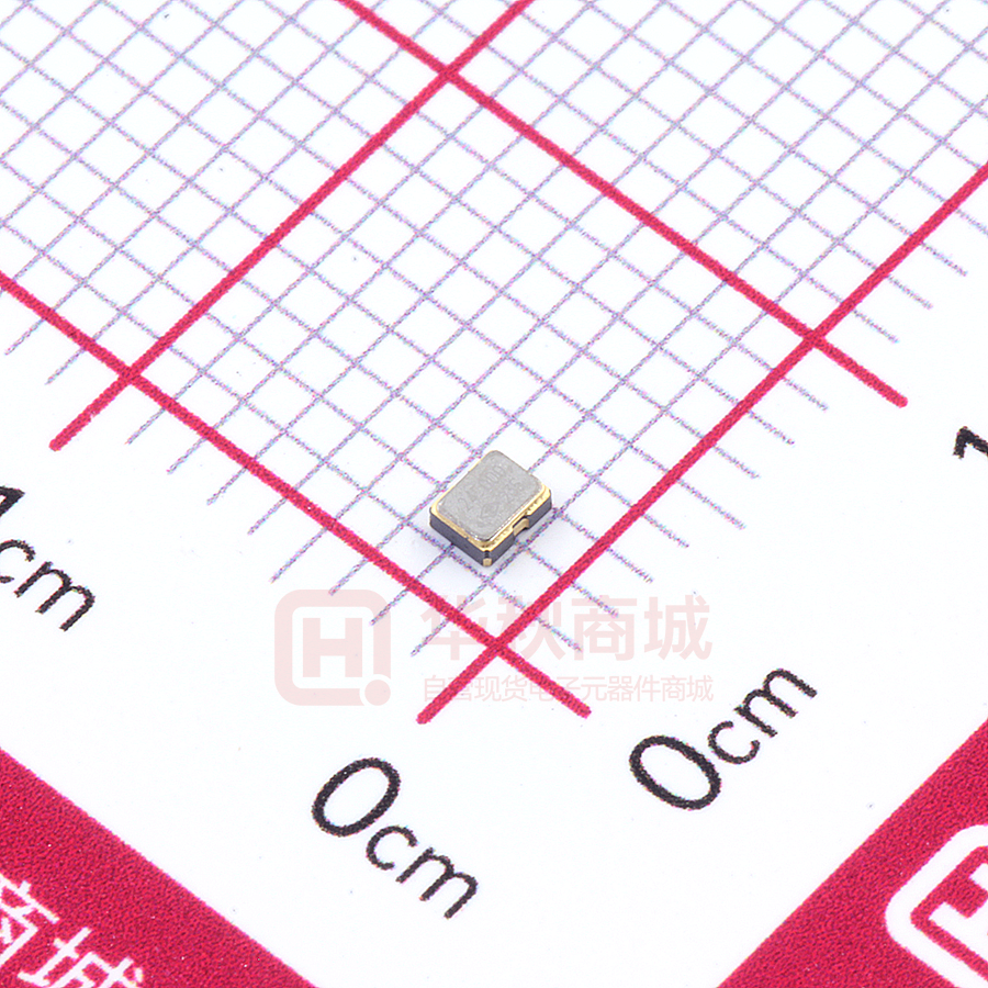

    有源晶振 24MHz 15pF ±25ppm 2.8V/3.0V/3.3V SMD2016_4P
PZEUDLJANF-24M 数据手册
PZ-U Type Crystal Oscillator FASTXO 2.0 x 1.6 mm SMD XO Frequency up to 200MHz Actual Size FEATURE - Typical 2.05 x 1.65 x 0.75 mm ceramic SMD package - Operation supply voltage: 1.8V, 2.5V and 3.3V - FASTXO series, Fast delivery at any frequency - Tri-State Enable/Disable - Frequency Stability ±25ppm over -40oC to 85oC - Pb-free/RoHS compliant RoHS Compliant TYPICAL APPLICATION - Wearable device - Mobile device - IoT, Smartphone - Game console DIMENSION (mm) SOLDER PAD L AYOUT (mm) [ B O T T O M V IE W ] [ TO P VIEW ] 0.1 μF 1.27±0.10 2.05±0.10 #4 #2 #2 #1 0.97 0.60 1.65±0.10 #1 0.47±0.10 #3 #3 0.97±0.10 #4 0.57±0.10 Pin# 0.75±0.10 [ S ID E V IE W ] 1 2 3 4 1.27 Function Tri-state GND Output VDD 0.75 To ensure optimal oscillator performance, place a by-pass capacitor of 0.1μF as close to the part as possible between Vdd and GND pads. ELECTRICAL SPECIFICATION 3.3V Parameter Supply Voltage Variation Frequency Range Supply Current (@15pf Loading) Output Level Transition Time 2.5V 1.8V Unit Min. Max. Min. Max. Min. Max. VDD-5% VDD+5% VDD-5% VDD+5% VDD-5% VDD+5% V 1 200 1 200 1 125 MHz mA - 30 - 28 - 20 Output High 90%VDD - 90%VDD - 90%VDD - V Output Low - 10%VDD - 10%VDD - 10%VDD V nSec Rise Time / Fall Time Duty Cycle Startup Time - 2 - 2 - 3 45 55 45 55 45 55 % - 8 - 8 - 8 mSec Output Enable 0.7 x VDD - 0.7 x VDD - 0.7 x VDD - V Output Disable - 0.3 x VDD - 0.3 x VDD - 0.3 x VDD V Stand by Current (@PD Mode) - 400 - 400 - 400 uA Stand by Current (@OE Mode) - 20 - 20 - 20 mA 1 - 1 - 1.5 pSec ppm Tri-State Output Loading 15 RMS Phase Jitter (12KHz to 20MHz) @3.3V - Aging (@ 25oC, First Year) Storage Temp. Range 15 15 pf - 3 - 3 - 3 -50 +125 -50 +125 -50 +125 o C Standard frequencies are frequencies which the crystal has been designed and does not imply a stock position. + Transition times are measured between 10% and 90% of VDD, with an output load of 15pF. FREQ. STABILITY vs. TEMP. RANGE Temp. (°C) ppm ±15 20 25 -20~+70 -40~+85 -40~+105 50 *O: Available △: Conditional X: Not available *Inclusive of calibration @ 25 oC ,operating temperature rrange,input Voltage variation,load variation,aging (1st year),shock,and vibration Note: not all combination of options are available. Other specifications may be available upon request. 38 Specifications subject to change without notice. www.taitien.com sales@taitien.com.tw Rev(3)08/2019
