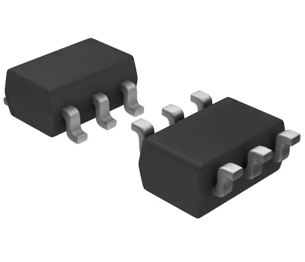

SOT23-6 Package
APPLICATIONS
ETA1611 is available in a space-saving SOT23-6
package.

PIN CONFIGURATION
SW
1
GND
2
ETA1611
FB 3
ABSOLUTE MAXIMUM RATINGS
(Note: Exceeding these limits may damage the device. Exposure to
absolute maximum rating conditions for long periods may affect device
reliability.)
6
NC
5
IN
4
EN
