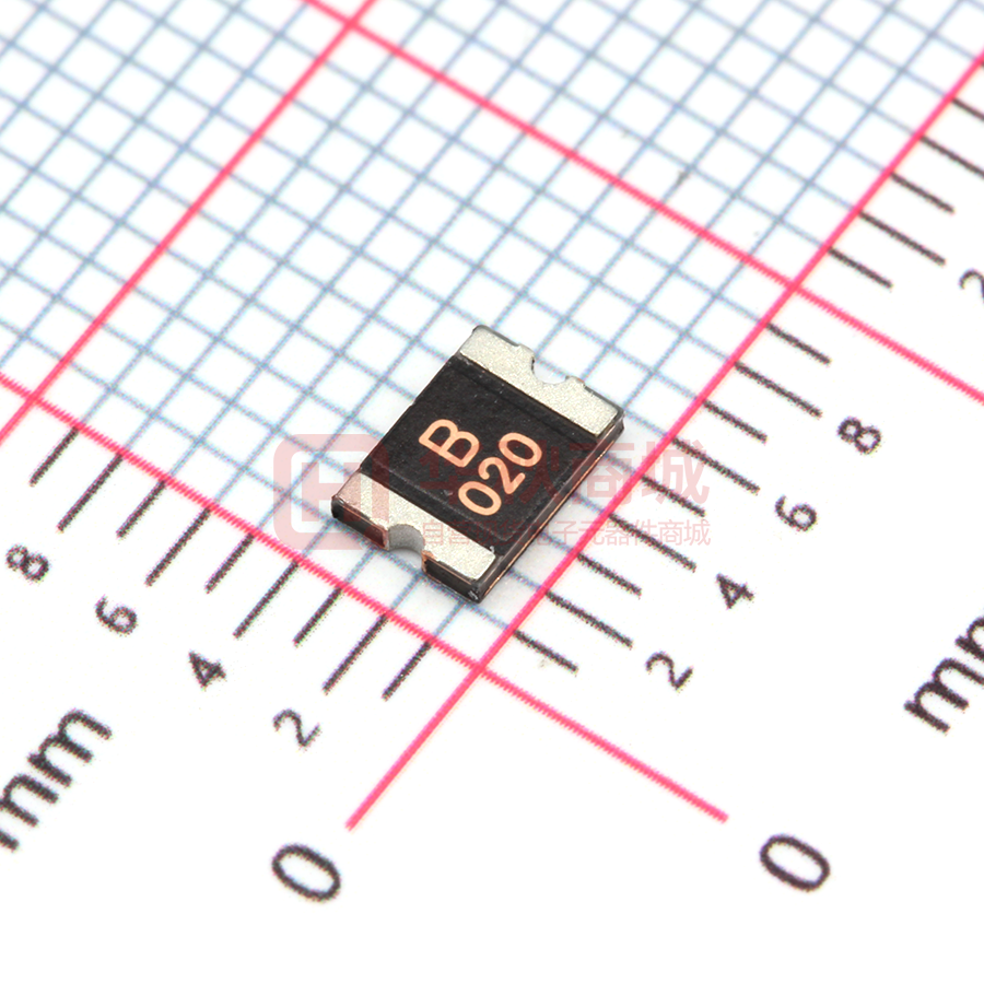

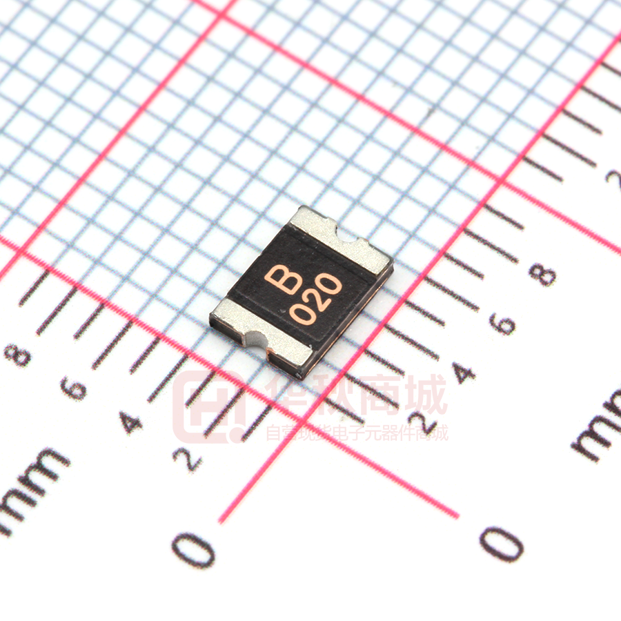

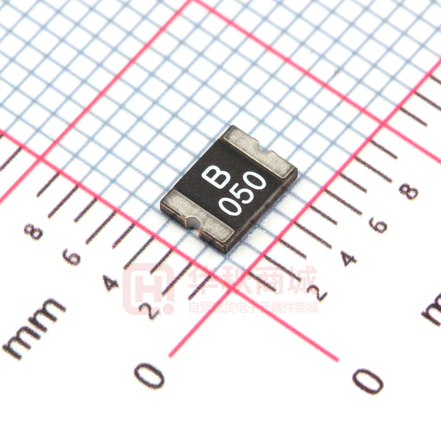

BHFUSE BSMD1812 Series Surface Mount PTC Device  Features       Size 0.18*0.12 inch /4.5*3.2 mm RoHS compliant, lead-free and halogen-free Fast response to fault current Low resistance Low profile Compatible with high temperature solders  Applications  Computer, Mobile phones, Multimedia  Automotive, Industrial controls, Telephony and broadband  Game machines, Portable electronics, Battery  Electrical Characteristics(25℃) Part Number Ihold (A) Itrip (A) Vmax (Vdc) Imax (A) Pd typ (W) Time to trip (A) (Sec) Rmin (Ω) R1max (Ω) BSMD1812-010-30V 0.10 0.30 30 40 0.8 0.50 1.50 0.750 15.00 BSMD1812-010-60V 0.10 0.30 60 40 0.8 0.50 1.50 0.750 15.00 BSMD1812-014-60V 0.14 0.34 60 40 0.8 1.50 0.15 0.650 6.000 BSMD1812-020-30V 0.20 0.40 30 40 0.8 8.00 0.04 0.350 5.000 BSMD1812-020-60V 0.20 0.40 60 40 0.8 8.00 0.04 0.350 5.000 BSMD1812-030-30V 0.30 0.60 30 40 0.8 8.00 0.10 0.250 3.000 BSMD1812-030-60V 0.30 0.60 60 40 0.8 8.00 0.10 0.250 3.000 BSMD1812-050-15V 0.50 1.00 15 40 0.8 8.00 0.15 0.150 1.400 BSMD1812-050-24V 0.50 1.00 24 40 0.8 8.00 0.15 0.150 1.400 BSMD1812-050-30V 0.50 1.00 30 40 0.8 8.00 0.15 0.150 1.400 BSMD1812-050-60V 0.50 1.00 60 40 0.8 8.00 0.15 0.150 1.400 BSMD1812-075-13.2V 0.75 1.50 13.2 40 0.8 8.00 0.20 0.090 0.450 BSMD1812-075-16V 0.75 1.50 16 40 0.8 8.00 0.20 0.090 0.450 BSMD1812-075-24V 0.75 1.50 24 40 0.8 8.00 0.20 0.090 0.450 BSMD1812-075-33V 0.75 1.50 33 40 0.8 8.00 0.20 0.090 0.450 BSMD1812-110-8V 1.10 2.20 8 100 0.8 8.00 0.30 0.045 0.250 BSMD1812-110-16V 1.10 2.20 16 100 0.8 8.00 0.30 0.045 0.250 BSMD1812-110-24V 1.10 2.20 24 40 0.8 8.00 0.30 0.045 0.250 BSMD1812-110-33V 1.10 2.20 33 40 0.8 8.00 0.30 0.045 0.250 BSMD1812-125-16V 1.25 2.50 16 100 0.8 8.00 0.40 0.050 0.160 BSMD1812-125-24V 1.25 2.50 24 40 0.8 8.00 0.40 0.050 0.160 BSMD1812-150-16V 1.50 3.00 16 100 0.8 8.00 0.50 0.040 0.160 Specifications are subject to change without notice Revision 2017 Polymer PTC Thermistor 1/7 BHFUSE BSMD1812 Series Surface Mount PTC Device Part Number Ihold (A) Itrip (A) Vmax (Vdc) Imax (A) Pd typ (W) Time to trip (A) (Sec) Ri (Ω) R1max (Ω) BSMD1812-150-24V 1.50 3.00 24 40 0.8 8.00 0.50 0.040 0.160 BSMD1812-150-33V 1.50 3.00 33 40 0.8 8.00 0.50 0.040 0.160 BSMD1812-160-8V 1.60 3.20 8 100 0.8 8.00 1.00 0.030 0.130 BSMD1812-160-16V 1.60 3.20 16 100 0.8 8.00 1.00 0.030 0.130 BSMD1812-160-24V 1.60 3.20 24 40 0.8 8.00 1.00 0.030 0.130 BSMD1812-200-8V 2.00 4.00 8 100 0.8 8.00 2.00 0.020 0.100 BSMD1812-200-12V 2.00 4.00 12 100 0.8 8.00 2.00 0.020 0.100 BSMD1812-200-16V 2.00 4.00 16 100 0.8 8.00 2.00 0.020 0.100 BSMD1812-200-24V 2.00 4.00 24 40 0.8 8.00 2.00 0.020 0.100 BSMD1812-200-30V 2.00 4.00 30 40 0.8 8.00 2.00 0.020 0.100 BSMD1812-250-8V 2.50 5.00 8 40 0.8 8.00 2.50 0.015 0.080 BSMD1812-260-8V 2.60 5.20 8 100 0.8 8.00 2.50 0.010 0.050 BSMD1812-260-13.2V 2.60 5.20 13.2 40 0.8 8.00 2.50 0.010 0.050 BSMD1812-260-16V 2.60 5.20 16 40 0.8 8.00 2.50 0.010 0.050 BSMD1812-300-8V 3.00 6.00 8 100 0.8 8.00 4.00 0.010 0.040 BSMD1812-300-12V 3.00 6.00 12 100 0.8 8.00 4.00 0.010 0.040 BSMD1812-300-16V 3.00 6.00 16 40 0.8 8.00 4.00 0.010 0.040 BSMD1812-350-6V 3.50 7.00 6 100 2.0 10.00 4.00 0.008 0.035 BSMD1812-350-16V 3.50 7.00 16 100 2.0 10.00 4.00 0.008 0.035 BSMD1812-400-6V 4.00 8.00 6 100 2.0 10.00 4.00 0.005 0.025 Ihold = Hold current: maximum current device will pass without tripping in 25℃ still air. Itrip = Trip current: minimum current at which the device will trip in 25℃ still air. Vmax = Maximum voltage device can withstand without damage at rated current (Imax). Imax = Maximum fault current device can withstand without damage at rated voltage (Vmax). Pd typ. = Typical power dissipated from device when in the tripped state at 25℃ still air. Rmin = Minimum resistance of device in initial (un-soldered) state. R1max = Maximum resistance of device at 25℃ measured one hour after tripping or reflow soldering of 260℃ for 20 sec. Caution:Operation beyond the specified ratings may result in damage and possible arcing and flame.  WARNING  Users shall independently assess the suitability of these devices for each of their applications.  Operation of these devices beyond the stated maximum ratings could result in damage to the devices and lead to electrical arcing and/or fire.  These devices are intended to protect against the effects of temporary over-current or over-temperature conditions and are not intended to perform as protective devices where such conditions are expected to be repetitive or prolonged in duration.  Exposure to silicon-based oils, solvents, electrolytes, acids, and similar materials can adversely affect the prolonged of these PPTC devices.  These devices undergo thermal expansion under fault conditions, and thus shall be provided with adequate space and be protected against mechanical stresses.  Circuits with inductance may generate a voltage (L di/dt) above the rated voltage of the PPTC device. Specifications are subject to change without notice Revision 2017 Polymer PTC Thermistor 2/7 BHFUSE BSMD1812 Series Surface Mount PTC Device  Thermal Derating Curve  Typical Time-to-Trip At 25℃  Thermal Derating Chart Part Number Ambient operating temperature hold current(Ihold) -40℃ -20℃ 0℃ 25℃ 40℃ 50℃ 60℃ 70℃ 85℃ BSMD1812-010 0.16 0.14 0.12 0.10 0.08 0.07 0.06 0.05 0.03 BSMD1812-014 0.23 0.19 0.17 0.14 0.12 0.10 0.09 0.08 0.06 BSMD1812-020 0.29 0.26 0.23 0.20 0.17 0.15 0.14 0.12 0.10 BSMD1812-030 0.44 0.39 0.35 0.30 0.26 0.23 0.21 0.18 0.15 BSMD1812-050 0.69 0.59 0.55 0.50 0.45 0.43 0.35 0.30 0.23 BSMD1812-075 1.10 0.99 0.87 0.75 0.63 0.57 0.49 0.45 0.35 BSMD1812-110 1.60 1.45 1.28 1.10 0.92 0.83 0.71 0.66 0.52 BSMD1812-125 2.00 1.75 1.52 1.25 1.00 0.95 0.90 0.75 0.53 BSMD1812-150 2.10 1.96 1.77 1.50 1.23 1.09 0.95 0.82 0.61 BSMD1812-160 2.30 2.05 1.88 1.60 1.26 1.12 0.98 0.84 0.63 BSMD1812-200 2.88 2.61 2.25 2.00 1.80 1.66 1.45 1.09 0.80 BSMD1812-260 3.90 3.42 2.96 2.60 2.22 2.07 1.94 1.35 1.00 BSMD1812-300 4.15 3.76 3.46 3.00 2.55 2.28 2.01 1.61 1.33 BSMD1812-350 4.84 4.39 4.04 3.50 2.98 2.66 2.35 1.88 1.55 BSMD1812-400 4.97 4.62 4.32 4.00 3.48 3.16 2.85 2.38 2.05 Specifications are subject to change without notice Revision 2017 Polymer PTC Thermistor 3/7 BHFUSE BSMD1812 Series Surface Mount PTC Device  Soldering Parameters Profile Feature Pb-Free Assembly Average Ramp-Up Rate(Tsmax to Tp) 3℃/second max Preheat -Temperature Min(Tsmin) -Temperature Max(Tsmax) -Time(Tsmin to Tsmax) 150℃ 200℃ 60~180 seconds Time maintained above: -Temperature(TL) -Time(tL) 217℃ 60~150 seconds Peak Temperature(Tp) 260℃ Ramp-Down Rate 6℃/second max Time 25℃ to Peak Temperature 8 minutes max Storage Condition 0℃~30℃,30%-60%RH  Recommended reflow methods: IR, vapor phase oven, hot air oven, N2 environment for lead-free.  Recommended maximum paste thickness is 0.25mm.  Devices can be cleaned using standard industry methods and solvents. Note 1: All temperature refer to topside of the package, measured on the package body surface. Note 2: If reflow temperatures exceed the recommended profile, devices may not meet the performance requirements.  Environmental Specifications Test Conditions Resistance change Passive aging +85°C, 1000 hrs. ±5% typical Humidity aging +85°C, 85% R.H. , 168 hours ±5% typical Thermal shock +85°C to -40°C, 20 times ±33% typical Resistance to solvent MIL-STD-202,Method 215 No change Vibration MIL-STD-202,Method 201 No change Ambient operating conditions : - 40 °C to +85 °C Maximum surface temperature of the device in the tripped state is 125 °C Specifications are subject to change without notice Revision 2017 Polymer PTC Thermistor 4/7 BHFUSE BSMD1812 Series Surface Mount PTC Device  Physical Dimensions & Recommended Pad Layout (mm) 1.78 A 1.78 D Part Number 3.15 B 010 014 B 3.45 E Marking Quantity BSMD1812-010-30V B010 BSMD1812-010-60V C A B C D E Min Max Min Max Min Max Min Min 1500 4.37 4.73 3.07 3.41 0.50 1.10 0.30 0.25 B010 1500 4.37 4.73 3.07 3.41 0.50 1.10 0.30 0.25 BSMD1812-014-60V B014 1500 4.37 4.73 3.07 3.41 0.50 1.10 0.30 0.25 BSMD1812-020-30V B020 1500 4.37 4.73 3.07 3.41 0.50 1.10 0.30 0.25 BSMD1812-020-60V B020 1500 4.37 4.73 3.07 3.41 0.50 1.10 0.30 0.25 BSMD1812-030-30V B030 1500 4.37 4.73 3.07 3.41 0.50 1.10 0.30 0.25 BSMD1812-030-60V B030 1500 4.37 4.73 3.07 3.41 0.50 1.10 0.30 0.25 BSMD1812-050-15V B050 1500 4.37 4.73 3.07 3.41 0.40 1.00 0.30 0.25 BSMD1812-050-24V B050 1500 4.37 4.73 3.07 3.41 0.40 1.00 0.30 0.25 BSMD1812-050-30V B050 1500 4.37 4.73 3.07 3.41 0.40 1.00 0.30 0.25 BSMD1812-050-60V B050 1500 4.37 4.73 3.07 3.41 0.50 1.10 0.30 0.25 BSMD1812-075-13.2V B075 1500 4.37 4.73 3.07 3.41 0.50 1.10 0.30 0.25 BSMD1812-075-16V B075 1500 4.37 4.73 3.07 3.41 0.50 1.10 0.30 0.25 BSMD1812-075-24V B075 1500 4.37 4.73 3.07 3.41 0.50 1.10 0.30 0.25 BSMD1812-075-33V B075 1500 4.37 4.73 3.07 3.41 0.50 1.10 0.30 0.25 BSMD1812-110-8V B110 1500 4.37 4.73 3.07 3.41 0.40 1.00 0.30 0.25 BSMD1812-110-16V B110 1500 4.37 4.73 3.07 3.41 0.40 1.00 0.30 0.25 BSMD1812-110-24V B110 1500 4.37 4.73 3.07 3.41 0.40 1.00 0.30 0.25 BSMD1812-110-33V B110 1500 4.37 4.73 3.07 3.41 0.60 1.30 0.30 0.25 BSMD1812-125-16V B125 1500 4.37 4.73 3.07 3.41 0.60 1.30 0.30 0.25 BSMD1812-125-24V B125 1500 4.37 4.73 3.07 3.41 0.60 1.30 0.30 0.25 BSMD1812-150-8V B150 1500 4.37 4.73 3.07 3.41 0.60 1.30 0.30 0.25 BSMD1812-150-16V B150 1500 4.37 4.73 3.07 3.41 0.60 1.30 0.30 0.25 BSMD1812-150-24V B150 1500 4.37 4.73 3.07 3.41 0.80 1.50 0.30 0.25 BSMD1812-150-33V B150 1500 4.37 4.73 3.07 3.41 0.80 1.50 0.30 0.25 Specifications are subject to change without notice Revision 2017 Polymer PTC Thermistor 5/7 BHFUSE BSMD1812 Series Surface Mount PTC Device Part Number Marking Quantity BSMD1812-160-8V B160 BSMD1812-160-16V A B C D E Min Max Min Max Min Max Min Min 1500 4.37 4.73 3.07 3.41 0.50 1.10 0.30 0.25 B160 1500 4.37 4.73 3.07 3.41 0.50 1.10 0.30 0.25 BSMD1812-160-24V B160 1500 4.37 4.73 3.07 3.41 0.50 1.10 0.30 0.25 BSMD1812-200-8V B200 1500 4.37 4.73 3.07 3.41 0.60 1.30 0.30 0.25 BSMD1812-200-12V B200 1500 4.37 4.73 3.07 3.41 0.60 1.30 0.30 0.25 BSMD1812-200-16V B200 1500 4.37 4.73 3.07 3.41 0.60 1.30 0.30 0.25 BSMD1812-200-24V B200 1500 4.37 4.73 3.07 3.41 0.60 1.50 0.30 0.25 BSMD1812-200-30V B200 1500 4.37 4.73 3.07 3.41 0.60 1.50 0.30 0.25 BSMD1812-250-8V B250 1500 4.37 4.73 3.07 3.41 0.60 1.50 0.30 0.25 BSMD1812-260-8V B260 1500 4.37 4.73 3.07 3.41 0.60 1.50 0.30 0.25 BSMD1812-260-13.2V B260 1500 4.37 4.73 3.07 3.41 0.60 1.50 0.30 0.25 BSMD1812-260-16V B260 1500 4.37 4.73 3.07 3.41 0.60 1.50 0.30 0.25 BSMD1812-300-8V B300 1500 4.37 4.73 3.07 3.41 0.60 1.50 0.30 0.25 BSMD1812-300-12V B300 1500 4.37 4.73 3.07 3.41 0.60 1.50 0.30 0.25 BSMD1812-300-16V B300 1500 4.37 4.73 3.07 3.41 0.60 1.50 0.30 0.25 BSMD1812-350-6V B350 1500 4.37 4.73 3.07 3.41 0.60 1.50 0.30 0.25 BSMD1812-350-16V B350 1500 4.37 4.73 3.07 3.41 0.60 1.50 0.30 0.25 BSMD1812-400-6V B400 1500 4.37 4.73 3.07 3.41 0.60 1.50 0.30 0.25 Specifications are subject to change without notice Revision 2017 Polymer PTC Thermistor 6/7 BHFUSE BSMD1812 Series Surface Mount PTC Device  Tape And Reel Specifications (mm) Governing Specifications BSMD1812-010-30V~ BSMD1812-075-33V BSMD1812-110-16V~ BSMD1812-200-16V BSMD1812-200-24V~ BSMD1812-400-6V W 12.0 ± 0.3 12.0 ± 0.3 12.0 ± 0.3 F 5.5 ± 0.05 5.5 ± 0.05 5.5 ± 0.05 E1 1.75 ± 0.1 1.75 ± 0.1 1.75 ± 0.1 D0 1.55 ± 0.05 1.55 ± 0.05 1.55 ± 0.05 D1 1.55min 1.55min 1.55min P0 4.0 ± 0.1 4.0 ± 0.1 4.0 ± 0.1 P1 8.0 ± 0.1 8.0 ± 0.1 8.0 ± 0.1 P2 2.0 ± 0.05 2.0 ± 0.05 2.0 ± 0.05 A0 3.58 ± 0.1 3.58 ± 0.1 3.58 ± 0.1 B0 4.93 ± 0.1 4.93 ± 0.1 4.93 ± 0.1 T 0.2 ± 0.1 0.2 ± 0.1 0.2 ± 0.1 K0 0.74 ± 0.1 1.04 ± 0.1 1.35 ± 0.1 Leader min 390 390 390 Trailer min 160 160 160 Reel Dimensions  C φ178 ± 1.0 D φ60.2 ± 0.5 H 16.0 ± 0.5 W 13.2 ± 1.5 Contact information SHENZHEN HCHC ELECTRONIC CO., LTD TEL: 0755-85259917 FAX: 0755-28704432 E-MAIL: sale@hchc-elec.com Specifications are subject to change without notice Revision 2017 Polymer PTC Thermistor 7/7
BSMD1812-050-30V
物料型号:BSMD1812系列 器件简介:这是一款表面贴装的PTC热敏电阻器,具有快速响应故障电流、低电阻、低轮廓和兼容高温焊接的特点。 引脚分配:文档中未明确提供引脚分配信息,但通常PTC设备为两个引脚。 参数特性:提供了在25℃下的工作电气特性,包括保持电流(Ihold)、触发电流(Itrip)、最大电压(Vmax)、最大电流(Imax)、典型耗散功率(Pd typ)、触发时间以及初始状态和触发后的最大/最小电阻值。 功能详解:这些PTC设备用于保护电路免受临时过电流或过热条件的影响,不适用于预期会重复或持续时间较长的条件。 应用信息:适用于计算机、手机、多媒体、汽车、工业控制、电话和宽带、游戏机、便携式电子设备和电池等。 封装信息:尺寸为0.180.12英寸/4.53.2毫米,符合RoHS标准,无铅和无卤素。
