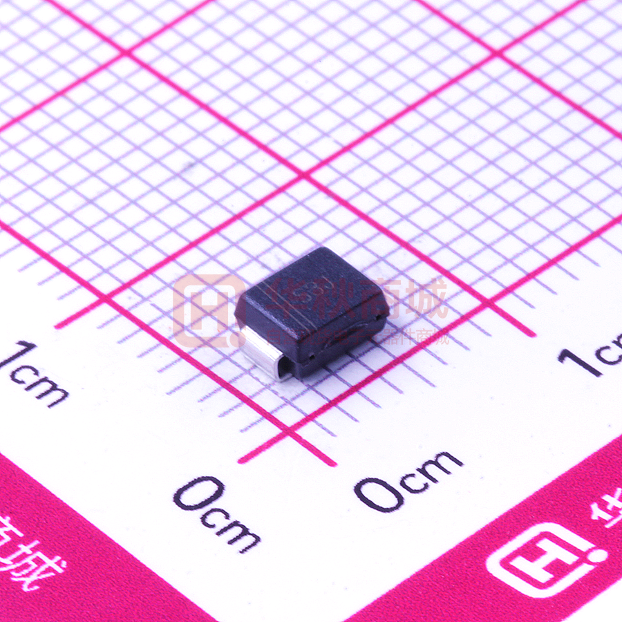

    SMB(DO-214AA)
    整流二极管 VRRM=600V If=3A VF=1.1V CJ=35pF SMB
S3JBG 数据手册
S3ABG THRU S3MBG Surface Mount General Purpose Silicon Rectifiers Reverse Voltage - 50 to 1000 V Forward Current - 3 A PINNING PIN FEATURES • For surface mounted applications • Low profile package • Glass Passivated Chip Junction • Easy to pick and place • Lead free in comply with EU RoHS 2011/65/EU directives DESCRIPTION 1 Cathode 2 Anode 2 MECHANICAL DATA • Case: SMB • Terminals: Solderable per MIL-STD-750, Method 2026 • A pprox. Weight: 0.055g / 0.002oz 1 Top View Marking Code: S3A~S3M Simplified outline SMB and symbol Maximum Ratings and Electrical characteristics Ratings at 25 °C ambient temperature unless otherwise specified. Single phase half-wave 60 Hz, resistive or inductive load, for capacitive load current derate by 20 %. Symbols Parameter S3AB G S3BB G S3DB G S3GB G S3JB G S3KB G S3MB G Units Maximum Repetitive Peak Reverse Voltage V RRM 50 100 200 400 600 800 1000 V Maximum RMS voltage V RMS 35 70 140 280 420 560 700 V Maximum DC Blocking Voltage V DC 50 100 200 400 600 800 1000 V Maximum Average Forward Rectified Current I F(AV) 3 A Peak Forward Surge Current 8.3 ms Single Half Sine Wave Superimposed on Rated Load I FSM 90 A Maximum Instantaneous Forward Voltage at 3 A VF 1.1 V IR 5 100 μA Cj 35 pF RθJA RθJC 48 16 °C/W T j , T stg -55 ~ +150 °C Maximum DC Reverse Current T a = 25 °C at Rated DC Blocking Voltage T a =125 °C Typical Junction Capacitance Typical Thermal Resistance (1) (2) Operating and Storage Temperature Range (1)Measured at 1 MHz and applied reverse voltage of 4 V D.C (2)P.C.B. mounted with 2.0" X 2.0" (5 X 5 cm) copper pad areas. REV.08 1 of 3 S3ABG THRU S3MBG Fig.2 Typical Instaneous Reverse Characteristics Instaneous Reverse Current ( μ A) Average Forward Current (A) Fig.1 Forward Current Derating Curve 5.0 4.0 3.0 2.0 1.0 Single phase half-wave 60 Hz resistive or inductive load 0.0 25 50 75 100 125 150 175 100 T J =150°C T J =125°C 10 T J =100°C 1.0 T J =75°C 0.1 T J =25°C 0.01 0 Junction Capacitance ( pF) Instaneous Forward Current (A) 10 1.0 800 100 T J =25°C 10 T J =25°C 0.1 0.4 1 0.6 0.8 1.0 1.2 1.4 1.6 1.8 0.1 Fig.5 Maximum Non-Repetitive Peak Forward Surage Current 100 80 60 40 20 8.3 ms Single Half Sine Wave (JEDEC Method) 00 1 10 1.0 10 Reverse Voltage (V) Instaneous Forward Voltage (V) Peak Forward Surage Current (A) 600 Fig.4 Typical Junction Capacitance Fig.3 Typical Forward Characteristic 100 Number of Cycles REV.08 400 200 Instaneous Reverse Voltage (V) Case Temperature (°C) 2 of 3 100 S3ABG THRU S3MBG PACKAGE OUTLINE SMB Plastic surface mounted package; 2 leads L A A1 C A b D E E1 VM A SMB mechanical data UNIT mm mil A1 L C b 5.59 0.20 1.5 0.305 2.2 3.3 5.08 0.05 0.8 0.152 1.9 155 220 7.9 59 12 87 200 2.0 32 6 75 A E D max 2.44 4.70 3.94 min 2.13 4.06 max 96 185 min 84 130 160 Marking The recommended mounting pad size 2.2 (86) 2.4 (94) 2.8 (110) 2.4 (94) mm Unit : (mil) REV.08 E1 3 of 3 Type number Marking code S3ABG S3A S3BBG S3B S3DBG S3D S3GBG S3G S3JBG S3J S3KBG S3K S3MBG S3M
