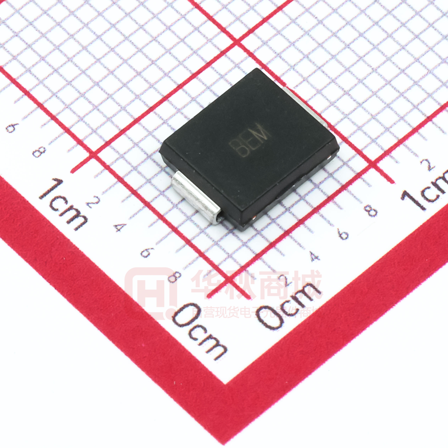

    SMC SMT 15V 24.4V
SMCJ15CA 数据手册
山东晶导微电子股份有限公司 Jingdao Microelectronics co.LTD SMCJ Series PINNING The SMCJ series is designed specifically to protect sensitive electronic equipment from voltage transients induced by lightning and other transient voltage events. FEATURES • 1500W peak pulse power capability at 10/1000μs waveform • For surface mounted applications to optimize board space • Glass passivated chip junction • Halogen free and RoHS compliant PIN DESCRIPTION 1 Cathode 2 Anode 2 Unipolar 1 MECHANICAL DATA • Case: SMC • Terminals: Solderable per MIL-STD-750, Method 2026 • A pprox. Weight: 0.22g (0.0077oz) Bipolar Simplified outline SMC and symbol Symbol Value Unit Peak Pulse Power Dissipation on 10/1000 us waveform P PPM 1500 W Peak Forward Surge Current,8.3ms Single Half Sine-Wave Superimposed on Rated Load (JEDEC Method) (UNI) 200 A Parameter I FSM Power dissipation on Infinite heat sink at T A =50°C PD 6.5 W Maximum instantaneous forward voltage at 100 A for unidirectional only VF 3.5 V Peak Pulse Current on 10/1000 us waveform I PPM See Next Table A Typical Thermal Resistance Junction to Ambient(Note 1) RθJA RθJL 75 15 °C/W Operating Junction Temperature and Storage Temperature Range T j , T stg -55 ~ +150 °C NOTES: 1. Mounted on 8 mm 2 (0.13mm thick) land areas. 2017.12 SMC-TVS-SMCJ Series -1500W Page 1 of 4 Characteristics at Ta = 25°C Marking Type UNI BI Reverse Stand-off Voltage Breakdown Voltage V RMW V BR @ I T Test Current Max Clamping Voltage Peak Pulse Current Maximum Reverse Leakage IR IT V C @ I PP I PP UNI BI V Min(V) Max(V) mA V A μA SMCJ5.0A SMCJ5.0CA GDE BDE 5 6.4 7 10 9.2 163 800 SMCJ6.0A SMCJ6.0CA GDG BDG 6 6.67 7.37 10 10.3 145.7 800 SMCJ6.5A SMCJ6.5CA GDK BDK 6.5 7.22 7.98 10 11.2 134 500 SMCJ7.0A SMCJ7.0CA GDM BDM 7 7.78 8.6 10 12 125 200 SMCJ7.5CA GDP BDP 7.5 8.33 9.21 1 12.9 116.3 100 SMCJ7.5A SMCJ8.0A SMCJ8.0CA GDR BDR 8 8.89 9.83 1 13.6 110.3 50 SMCJ8.5A SMCJ8.5CA GDT BDT 8.5 9.44 10.4 1 14.4 104.2 20 SMCJ9.0A SMCJ9.0CA GDV BDV 9 10 11.1 1 15.4 97.4 10 SMCJ10A SMCJ10CA GDX BDX 10 11.1 12.3 1 17 88.3 5 SMCJ11A SMCJ11CA GDZ BDZ 11 12.2 13.5 1 18.2 82.5 1 SMCJ12CA GEE BEE 12 13.3 14.7 1 19.9 75.4 1 SMCJ13A SMCJ13CA GEG BEG 13 14.4 15.9 1 21.5 69.8 1 SMCJ14A SMCJ14CA GEK BEK 14 15.6 17.2 1 23.2 64.7 1 SMCJ12A SMCJ15A SMCJ15CA GEM BEM 15 16.7 18.5 1 24.4 61.5 1 SMCJ16A SMCJ16CA GEP BEP 16 17.8 19.7 1 26 57.7 1 SMCJ17A SMCJ17CA GER BER 17 18.9 20.9 1 27.6 54.4 1 SMCJ18A SMCJ18CA GET BET 18 20 22.1 1 29.2 51.4 1 SMCJ20A SMCJ20CA GEV BEV 20 22.2 24.5 1 32.4 46.3 1 SMCJ22CA GEX BEX 22 24.4 26.9 1 35.5 42.3 1 SMCJ24A SMCJ24CA GEZ BEZ 24 26.7 29.5 1 38.9 38.6 1 SMCJ26A SMCJ26CA GFE BFE 26 28.9 31.9 1 42.1 35.7 1 SMCJ28CA GFG BFG 28 31.1 34.4 1 45.4 33.1 1 SMCJ22A SMCJ28A SMCJ30A SMCJ30CA GFK BFK 30 33.3 36.8 1 48.4 31 1 SMCJ33A SMCJ33CA GFM BFM 33 36.7 40.6 1 53.3 28.2 1 SMCJ36CA GFP BFP 36 40 44.2 1 58.1 25.9 1 SMCJ40A SMCJ40CA GFR BFR 40 44.4 49.1 1 64.5 23.3 1 SMCJ43A SMCJ43CA GFT BFT 43 47.8 52.8 1 69.4 21.7 1 SMCJ36A SMCJ45A SMCJ45CA GFV BFV 45 50 55.3 1 72.7 20.6 1 SMCJ48A SMCJ48CA GFX BFX 48 53.3 58.9 1 77.4 19.4 1 SMCJ51A SMCJ51CA GFZ BFZ 51 56.7 62.7 1 82.4 18.2 1 SMCJ54A SMCJ54CA GGE BGE 54 60 66.3 1 87.1 17.3 1 SMCJ58A SMCJ58CA GGG BGG 58 64.4 71.2 1 93.6 16.1 1 SMCJ60CA GGK BGK 60 66.7 73.7 1 96.8 15.5 1 SMCJ64A SMCJ64CA GGM BGM 64 71.1 78.6 1 103 14.6 1 SMCJ70A SMCJ70CA GGP BGP 70 77.8 86 1 113 13.3 1 SMCJ75CA GGR BGR 75 83.3 92.1 1 121 12.4 1 SMCJ60A SMCJ75A SMCJ78A SMCJ78CA GGT BGT 78 86.7 95.8 1 126 11.9 1 SMCJ85A SMCJ85CA GGV BGV 85 94.4 104 1 137 11 1 SMCJ90A SMCJ90CA GGX BGX 90 100 111 1 146 10.3 1 SMCJ100A SMCJ100CA GGZ BGZ 100 111 123 1 162 9.3 1 SMCJ110A SMCJ110CA GHE BHE 110 122 135 1 177 8.5 1 SMCJ120A SMCJ120CA GHG BHG 120 133 147 1 193 7.8 1 SMCJ130A SMCJ130CA GHK BHK 130 144 159 1 209 7.2 1 SMCJ150A SMCJ150CA GHM BHM 150 167 185 1 243 6.2 1 SMCJ160A SMCJ160CA GHP BHP 160 178 197 1 259 5.8 1 SMCJ170A SMCJ170CA GHR BHR 170 189 209 1 275 5.5 1 SMCJ180A SMCJ180CA GHT BHT 180 201 222 1 292 5.1 1 SMCJ200A SMCJ200CA GHV BHV 200 224 247 1 324 4.6 1 SMCJ220A SMCJ220CA GHX BHX 220 246 272 1 356 4.2 1 SMCJ250CA GHZ BHZ 250 279 309 1 405 3.7 1 SMCJ250A SMCJ300A SMCJ300CA GJE BJE 300 335 371 1 486 3.1 1 SMCJ350A SMCJ350CA GJG BJG 350 391 432 1 567 2.6 1 SMCJ400A SMCJ400CA GJK BJK 400 447 494 1 648 2.3 1 SMCJ440A SMCJ440CA GJM BJM 440 492 543 1 713 2.1 1 山东晶导微电子股份有限公司 Jingdao Microelectronics co.LTD SMCJ Series Fig.2 Pulse Waveform P PPM,PEAK PULSE FORWARD ,kW Fig.1 Peak Pulse Power Rating Curve 150 100 10 1 0.31x0.31" (80 x 80mm) Copper pad Area T A =25°C t f =10us I ppm ,Peak Pulse Current (%) Non-Repetive Pulse.Wavefom Shown in Figure.3 T A=25°C Pulse Width (td) is Defined as the Point where the Peak. Current Decayst to 50% of Ipp Peak Value 100 80 Half Value-I pp /2 60 10/1000usec Waveform as Defined bye R.E.A. 40 20 td 0 00 0.1 1 10 100 1000 0 10000 3.0 2.0 1.0 t d,PULSE WIDTH ,us 4.0 T,TIME,ms Fig.3 Forward Current Derating Curve Fig.4 Typical Junction Capacitance 100000 Bi-directional V= 0V 100 10000 Cj (pF) PEAK PULSE POWER(P PP)OR CURRENT(I PP) DERATINGIN PERCENTAGE% I ppm 80 60 Uni-directional V=0V 1000 Uni-directional @ V R 100 40 Bi-directional @ V R Tj=25℃ 10 20 f = 1MHz Vsig=mVp-p 1 0 25 50 75 100 125 150 175 T A,AMBIENT TEMPERATURE,°C 1 10 100 1000 V BR - Reverse Breakdown Voltage (V) I FSM,PEAK FORWARD SURGE CURRENT, AMPERES Fig.5 Maximum Non-Repetitive Peak Forward Surge Current 240 200 160 120 80 40 T J=T Jmax 8.3ms Single Half Sinepwave JEDEC Method 0 1 10 100 Number of Cycles at 60Hz 2017.12 www.sdjingdao.com Page 3 of 4 山东晶导微电子股份有限公司 Jingdao Microelectronics co.LTD SMCJ Series PACKAGE OUTLINE SMC Plastic surface mounted package; 2 leads E A A1 A C b D L E1 VM A SMC mechanical data A E D E1 A1 C L b max 2.62 7.0 6.2 8.0 0.21 0.31 1.6 3.25 min 2.00 6.5 5.6 7.6 0.05 0.15 0.9 2.75 max 103 276 244 315 8.3 12 63 128 min 79 256 220 299 2.0 5.9 35 108 UNIT mm mil The recommended mounting pad size 3.8 (150) 4.1 (160) 4.3 (170) 4.1 (160) mm Unit : (mil) 2017.12 JD 80404 1B60 Page 4 of 4
SMCJ15CA
物料型号:SMCJ系列
器件简介:该系列二极管专为保护敏感电子设备免受雷电和其他瞬态电压事件引起的电压瞬态而设计。
引脚分配:有两个引脚,1号引脚为阴极,2号引脚为阳极。
参数特性: - 峰值脉冲功率能力:1500W(10/1000μs波形) - 适用于表面贴装,以优化板空间 - 玻璃钝化芯片结 - 无卤素,符合RoHS标准
功能详解: - 提供了详细的电气特性表,包括但不限于峰值脉冲功率耗散、峰值正向浪涌电流、功率耗散、最大瞬态正向电压、峰值脉冲电流和典型热阻。 - 工作结温和存储结温范围:-55℃至+150℃
应用信息:文档提供了峰值脉冲功率等级曲线、脉冲波形、正向电流降额曲线、典型结电容和最大非重复峰值正向浪涌电流等图表。
封装信息:塑料表面贴装封装,2个引脚,提供了详细的机械数据和推荐的安装垫尺寸。
