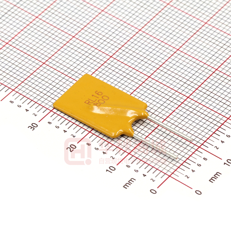

RL16-800
RL16-800
    RUILON(瑞隆源)
    PTC_13.5X3MM_TM
    最大电压:16V 最大电流:100A 保持电流:8A 跳闸电流:16A
RL16-800 数据手册
ELECTRONICS Positive Thermal Coefficent RL16 Series Circuit Protection System Specifications are subject to change without notice. Positive Thermal Coefficent - RL16 Series Features 1. 100A short circuit rating 2. 16V Operating voltages 3. Fast time–to–trip 4. Meets all USB protection requirements 5. RoHS compliant, Lead- Free and Halogen-Free* Applications 1. Overcurrent and overtemperature protection of automotive electronics 2. Hard disk drives 3. PC motherboards 4. PC peripherals 5. Point-of-sale (POS) equipment 6. PCMCIA cards 7. USB port protection - USB 2.0, 3.0 & OTG 8. HDMI 1.4 Source protection 9. Computers&peripherals 10. General Electronics Product Name R L 1 LOGO Circuit Protection System 6 Vmax:16V - 2 5 0 Ihold:2.50A Specifications are subject to change without notice. Page:1 D Positive Thermal Coefficent - RL16 Series Dimension E E Fig.1 Ihold Vmax Itrip Imax Rmax Rmin D Package Dimensions (mm) Pdtyp Type Number A V A HRL16-300 3 16 6 HRL16-400 4 16 8 HRL16-500 5 16 HRL16-600 6 16 HRL16-700 7 HRL16-800 8 A Ω Ω W Circuit A B C D E Figure 100 0.06 0.02 2.3 9 12 5.1 3 0.8 Fig.1 100 0.04 0.02 2.4 10 13 5.1 3 0.8 Fig.1 10 100 0.025 0.014 2.6 10.7 15 5.1 3 0.8 Fig.1 12 100 0.021 0.01 2.8 13.5 15 5.1 3 0.8 Fig.1 16 14 100 0.015 0.008 3 13.5 18 5.1 3 0.8 Fig.1 16 16 100 0.013 0.006 3.3 13.5 18 5.1 3 0.8 Fig.1 E HRL16-900 9 16 18 100 0.012 0.004 3.7 15 23 5.1 3 0.8 Fig.3 HRL16-1000 10 16 20 100 0.011 0.004 3.7 18 24 5.1 3 0.8 Fig.3 HRL16-1100 11 16 22 100 0.009 0.003 4.2 18 25 5.1 3 0.8 Fig.3 HRL16-1200 12 16 24 100 0.008 0.003 4.2 22.5 28 10.5 3 0.8 Fig.3 HRL16-1400 14 16 28 100 0.008 0.003 4.2 24 28 10.5 3 0.8 Fig.3 I hold = Hold current: maximum current device will pass without tripping in 20°C still air. V max = Maximum operating voltage device can withstand without damage at rated current (Imax). R min/max = Minimum/Maximum device resistance prior to tripping at 25°C. I max = Maximum fault current device can withstand without damage at rated voltage (V max). I trip = Trip current: minimum current at which the device will trip in 20°C still air. R typ = Typical resistance of device in initial (un-soldered) state. Circuit Protection System Specifications are subject to change without notice. Page:2 Percentage of Derating Current 1.6 1.4 1.2 1.0 0.8 0.6 Positive Thermal Coefficent - RL16 Series 0.4 0.2 0.0 Average Time Current Curves Temperature Rerating Curve -40 -20 0 20 40 60 80 Temperature (C°) Derating Curves for A16 Series Percentage of Derating Current 1.8 1.6 1.4 1.2 1.0 0.8 0.6 0.4 0.2 0.0 -40 -20 0 20 40 60 80 Temperature (C°) Soldering Parameters TP 20~40 S Profile Feature Pb-Free Assembly Average Ramp-Up Rate(Ts max to T p) 3°C/second mac. TP 260 Critical Zone Ramp-up TL 217 TL to TP tL 60~150 s Tsmax 200 Tsmin Ramp-down 150 ts Preheat 60~180 s Preheat -Temperature Min(Ts min) -Temperature Max(Ts max) -Time(Ts min to Ts max) 150°C 200°C 60~180 seconds Time maintained above: -Temperature(TL) -Time(tL) +217°C 60~150 seconds 25 t 25 C to peak Time Peak Temperature(Tp) Ramp-Down Rate Recommended reflow methods: IR, vapor phase oven, hot air oven, N2 environment for lead-free Recommended maximum paste thickness is 0.25mm Devices can be cleaned using standard industry methods and solvents. Note 1:All temperature refer to topside of the package, measured on the package body surface. Note 2: If reflow temperatures exceed the recommended profile, devices may not meet the performance requirements. Circuit Protection System Time 25°C to Peak Temperature Storage Condition 260°C 6°C/second max. 8 minutes max 0°C~35°C,70%RH Specifications are subject to change without notice. Page:3 Positive Thermal Coefficent - RL16 Series THERMAL DERATING CHART - IH(A) Type Number -40°C -20°C 0°C 23°C 40°C 50°C 60°C 70°C 85°C RL16-250 3.70 3.46 3.10 2.50 2.14 1.90 1.83 1.33 1.19 RL16-300 4.40 3.96 3.60 3.00 2.64 2.40 2.13 1.83 1.56 RL16-400 5.90 5.28 4.80 4.00 3.52 3.20 2.84 2.44 2.08 RL16-500 7.40 6.60 6.00 5.00 4.40 4.00 3.55 3.05 2.60 RL16-600 8.90 7.92 7.20 6.00 5.28 4.80 4.26 3.66 3.12 RL16-700 10.4 9.24 8.40 7.00 6.10 5.60 4.97 4.27 3.64 RL16-800 11.8 10.56 9.60 8.00 7.04 6.40 5.68 4.88 4.16 RL16-900 13.3 11.88 10.80 9.00 7.92 7.20 6.39 5.49 4.68 RL16-1000 14.8 13.20 12.00 10.00 8.80 8.00 7.10 6.10 5.20 RL16-1100 16.3 14.52 13.20 11.00 9.68 8.80 7.81 6.71 5.72 RL16-1200 17.7 15.84 14.40 12.00 10.56 9.60 8.52 7.32 6.24 RL16-1400 20.7 18.48 16.80 14.00 12.32 11.20 9.94 8.54 7.28 Warehouse Storage Conditions of Products · Storage Conditions: 1. Storage Temperature: -10°C~+40°C 2. Relative Humidity:≤75%RH 3. Keep away from corrosive atmosphere and sunlight. · Period of Storage: 1 year Circuit Protection System Specifications are subject to change without notice. Page:4 RuiLongYuan Electronics Co., Ltd. · Reproducing and modifying information of the document is prohibited without permission from Ruilongyuan International Inc. · Ruilongyuan International Inc. reserves the rights to make changes of the content herein the document anytime without notification. Please refer to our website for the latest document. · Ruilongyuan International Inc. disclaims any and all liability arising out of the application or use of any product including damages incidentally and consequentially occurred. · Ruilongyuan International Inc. does not assume any and all implied warranties, including warranties of fitness for particular purpose, non-infringement and merchantability. · Applications shown on the herein document are examples of standard use and operation. Customers are responsible in comprehending the suitable use in particular applications.Ruilongyuan International Inc. makes no representation or warranty that such applications will be suitable for the specifed use without further testing or modifcation. · The products shown herein are not designed and authorized for equipments requiring high level of reliability or relating to human life and for any applications concerning life-saving or life-sustaining, such as medical instruments, transportation equipment,aerospace machinery et cetera. Customers using or selling these products for use in such applications do so at their own risk and agree to fullyindemnify Ruilongyuan International Inc. for any damages resulting from such improper use or sale. Circuit Protection System Specifications are subject to change without notice. Page:5
