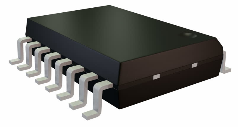

TF2110M /2113M High-Side and Low-Side Gate Drivers Features Description  Drives two N-channel MOSFETs or IGBTs in high-side / low side configuration  The floating high-side operates to 600V  2.5A sink / 2.5A source typical output currents  Outputs tolerant to negative transients  Wide gate driver supply voltage range: 10V to 20V  Wide logic input supply voltage range: 3.3V to 20V  Wide logic supply offset voltage range: -5V to 5V  15 ns(typ) rise / 13 ns (typ) fall times with 1000 pF load  105 ns (typ) turn-on / 94 ns (typ) turn-off delay times  Cycle-by-cycle edge-triggered shutdown circuitry  Extended temperature range: -40 °C to +125 °C The TF2110M and TF2113M are high voltage, high-speed MOSFET and IGBT drivers with independent high-side and lowside out- puts. The high-side driver features floating supply for operation at up to 500V / 600V. The 10 ns (max) / 20 ns (max) propagation delay matching between the high and the low side drivers allows high frequency operation. The TF2110M and TF2113M logic inputs are compatible with standard CMOS levels (as low as 3.3V) while driver outputs feature high pulse current buffers designed for minimum driver cross- conduction. The TF2110M and TF2113M are offered in 16-pin SOIC wide and 14-pin PDIP packages. They operate over an extended -40 °C to +125 °C temperature range. Applications  DC-DC Converters  AC-DC Inverters  Motor Controls  Class D Power Amplifiers Typical Application Ordering Information PART NUMBER TF2110M-3BS TF2110M-TEU TF2110M-TEH TF2113M-3BS TF2113M-TEU TF2113M-TEH www.tfsemi.com July 2019 PDIP-14 SOIC-16W PACKAGE PDIP-14 SOIC-16W SOIC-16W PDIP-14 SOIC-16W SOIC-16W Year Year Week Week PACK / Qty Tube / 25 Tube / 45 T & R / 1500 Tube / 25 Tube / 45 T & R / 1500 MARK YYWW TF2110 Lot ID YYWW TF2113 Lot ID Rev. 2.3 1 TF2110M /2113M High-Side and Low-Side Gate Drivers Pin Diagrams Top View: PDIP-14 TF2110M /TF2113M Top View : SOIC -16 Wide TF2110M /TF2113M Pin Descriptions PIN NAME PIN DESCRIPTION VDD Logic power supply pin HIN Logic input pin for the high-side gate driver output. HIN and HO are in phase SD Logic input shutdown pin LIN Logic input pin for the low side gate driver output. LIN and LO are in phase VSS Logic ground pin VB High-side gate driver floating power supply pin HO High-side gate driver output pin VS High-side gate driver floating power supply return pin Vcc Low-side gate driver power supply pin LO Low-side gate driver output pin COM Low-side gate driver power supply return pin NC “No connect” pin July 2019 2 TF2110M /2113M High-Side and Low-Side Gate Drivers Absolute Maximum Ratings (NOTE1) A VB - High side floating supply voltage (TF2110).....-0.3V to +524V VB - High side floating supply voltage (TF2113).....-0.3V to +624V VS - High side floating supply offset voltage....VB -24V to VB+0.3V VHO - High side floating output voltage...............VS-0.3V to VB+0.3V dVS / dt - Offset supply voltage transient...................................50 V/ns SOIC-16W Thermal Resistance (NOTE2) qJC..................................................................................................45 °C/W qJA ..................................................................................................90 °C/W VCC - Low side fixed supply voltage...................................-0.3V to +24V VLO - Low side output voltage..................................-0.3V to VCC +0.3V VDD - Logic supply voltage............................................-0.3V to VSS+24V VSS - Logic supply offset voltage........................VCC-24V to VCC+0.3V VIN - Logic input voltage (HIN, LIN and SD)...VSS-0.3V to VDD+0.3V PDIP-14 Thermal Resistance (NOTE2) qJC..................................................................................................35 °C/W qJA ..................................................................................................75 °C/W TJ - Junction temperature.............................................................+150 °C TL - Lead Temperature (soldering, 10 seconds)........................300 °C TSTG - Storage temerature ..............................................-55 oC to 150 °C NOTE2 When mounted on a standard JEDEC 2-layer FR-4 board. PD - Package power dissipation at TA ≤ 25 °C SOIC-16W..........................................................................................1.25W PDIP-14.................................................................................................1.6W NOTE1 Stresses beyond those listed under “Absolute Maximum Ratings” may cause permanent damage to the device. These are stress ratings only, and functional operation of the device at these or any other conditions beyond those indicated in the operational sections of the specifications is not implied. Exposure to absolute maximum rating conditions for extended periods may affect device reliability. Recommended Operating Conditions Symbol Parameter VB High side floating supply absolute voltage VS High side floating supply offset voltage VHO MIN TYP MAX Unit VS + 10 VS + 20 V TF2110 NOTE3 500 V TF2113 NOTE3 600 V High side floating output voltage VS VB V VCC Low side fixed supply voltage 10 20 V VLO Low side output voltage 0 VCC V VDD Logic supply voltage VSS + 3 VSS + 20 V VSS Logic supply offset voltage -5 (NOTE 4) 5 V VIN Logic input voltage (HIN, LIN and SD) VSS VDD V TA Ambient temperature -40 125 °C NOTE 3 Logic operational for VS =-4V to +500V. Logic state held for VS= -4V to -VBS NOTE 4 When VDD
