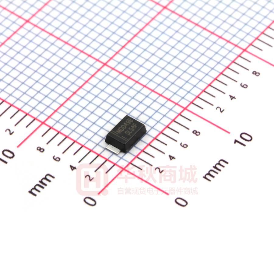

SL54F
SL54F
    MDD(辰达半导体)
    SMAF
    肖特基二极管 VR=40V IF=5A VF=0.45V IR=1000uA
SL54F 数据手册
SL54F Reverse Voltage - 40 Volts Forward Current - 5.0 Ampere LOW FORWARD VOLTAGE SCHOTTKY BARRIER DIODES Features SMAF  7KHSODVWLFSDFNDJHFDUULHV8QGHUZULWHUV/DERUDWRU\ )ODPPDELOLW\&ODVVLILFDWLRQ95R+6FRPSOLDQW 0.106(2.70) 0.094(2.40) 0.063 (1.60) 0.051 (1.30)  , GHDIRUSULQWHGFLUFXLWERDUG  2SHQ-XQFWLRQFKLS  /RZUHYHUVHOHDNDJH +LJKIRUZDUGVXUJHFXUUHQW 0.146(3.70) 0.130(3.30)  FDSDELOLW\ +LJKWHPSHUDWXUHVROGHULQJJXDUDQWHHG  ℃VHFRQGVDWWHUPLQDOV 0.047(1.20) 0.035(0.90) Mechanical Data 0.008(0.20) 0.005(0.12) 0.047(1.20) 0.031(0.80) Case: 60$) molded plastic body Terminals: Solderable per MIL-STD-750,Method 2026 Polarity: Polarity symbol marking on body Mounting Position: Any Weight : 0.00 ounce, 0.07 grams 0.193(4.90) 0.173(4.40) Dimensions in inches and (millimeters) Maximum Ratings And Electrical Characteristics Ratings at 25 C ambient temperature unless otherwise specified. Single phase half-wave 60Hz,resistive or inductive load,for capacitive load current derate by 20%. Parameter SL54F SYMBOLS Marking Code MDD SL54F UNITS 40 28 40 V V V I(AV) 5.0 A IFSM 150 A VF 0.45 V IR 1.0 50 mA CJ RJA 800 pF Typical thermal resistance (NOTE 2) 45.0 ℃/W Operating junction temperature range TJ -55 to +150 ℃ TSTG -55 to +150 ℃ Maximum repetitive peak reverse voltage Maximum RMS voltage Maximum DC blocking voltage Maximum average forward rectified current at TL(see fig.1) Peak forward surge current 8.3ms single half sine-wave superimposed onrated load (JEDEC Method) Maximum instantaneous forward voltage at 5.0A Maximum DC reverse current at rated DCblocking voltage TA=25℃ TA=125℃ Typical junction capacitance (NOTE 1) Storage temperature range VRRM VRMS VDC Note:1.Measured at 1.0MHz and applied reverse voltage of 4.0V D.C. 2.P.C.B. mounted with 2.0x2.0”(5.0x5.0cm) copper pad areas 3.The typical data above is for reference only. https://www.microdiode.com Rev:2024A2 Page :1 SL54F Reverse Voltage - 40 Volts Forward Current - 5.0 Ampere Typical Characterisitics Fig.2 Typical Reverse Characteristics Average Forward Current (A) 6 5 4 3 2 1 Single phase half-wave 60 Hz resistive or inductive load 0 25 75 50 100 125 150 Instaneous Reverse Current ( μA) Fig.1 Forward Current Derating Curve 10 4 10 1 T J =25°C 10 0 0 20 40 60 Fig.4 Typical Junction Capacitance 1000 T J =25°C Junction Capacitance (pF) 20 10 1 0.1 0.2 0.4 0.6 0.8 1.0 1.2 1.4 1.6 200 100 50 20 10 1 0.1 100 10 Instaneous Forward Voltage (V) Reverse Voltage (V) Fig.5 Maximum Non-Repetitive Peak Forward Surage Current Fig.6- Typical Transient Thermal Impedance 175 150 125 100 75 50 25 500 1.8 8.3 ms Single Half Sine Wave (JEDEC Method) 00 1 10 Number of Cycles at 60Hz 100 Transient Thermal Impedance( °C / W) 0 100 80 Percent of Rated Peak Reverse Voltage(%) Fig.3 Typical Forward Characteristic Instaneous Forward Current (A) T J =75°C 10 2 Case Temperature (°C) Peak Forward Surage Current (A) T J =100°C 10 3 200 100 10 1 0.01 0.1 1 10 100 t, Pulse Duration(sec) The curve above is for reference only. https://www.microdiode.com Rev:2024A2 Page :2 SL54F Reverse Voltage - 40 Volts Forward Current - 5.0 Ampere Packing information unit:mm P0 P1 d Item Symbol Tolerance A B C d D D1 D2 E F P P0 P1 T W W1 0.1 0.1 0.1 0.05 2.0 min 0.5 0.1 0.1 0.1 0.1 0.1 0.1 0.3 1.0 SMAF E Carrier width Carrier length Carrier depth Sprocket hole 7" Reel outside diameter 7" Reel inner diameter Feed hole diameter Sprocket hole position Punch hole position Punch hole pitch Sprocket hole pitch Embossment center Overall tape thickness Tape width Reel width F B A W P D2 D1 T C W1 D 2.80 4.75 1.42 1.50 178.00 54.40 13.00 1.75 5.05 4.00 4.00 2.00 0.30 8.00 12.30 Note:Devices are packed in accor dance with EIA standar RS-481-A and specifications listed above. Reel packing PACKAGE SMAF REEL SIZE 7" REEL (pcs) COMPONENT SPACING (m/m) BOX (pcs) INNER BOX (m/m) REEL DIA, (m/m) CARTON SIZE (m/m) CARTON (pcs) APPROX. GROSS WEIGHT (kg) 3,000 4.0 6,000 210*208*203 178 400*265*400 120,000 10.0 Suggested Pad Layout https://www.microdiode.com Symbol Unit (mm) A 1.8 0.071 B 0.063 C 1.6 3.8 0.150 D 2.2 0.087 E 5.4 0.213 Unit (inch) Rev:2024A2 Page :3
