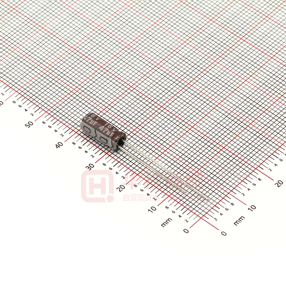

    直插铝电解电容 插件,D5xL11mm 47µF ±20% Ф5.00 x 11.00mm 16V 2.5Ω 95mA 10000Hrs@105℃
01EC1882SHG47uF16V 数据手册
SHG Series Aluminum Electrolytic Capacitors Item Name SHG1C470M-0511 Rating SHG16V47μF Case size Φ5*11mm KNSCHA Lifetime 10000 hours 1. Operating Temp. Range -40℃ ~ + 105℃ 2. Electrical Characteristics See Table 1. 【Table 1】 Rated Voltage VDC Surge Voltage VDC Nominal Static Capacitance (μF) 16 20 47 Permissible Tolerance Dissipation Leakage on Factor Current Ripple Current Impedance(Ω) Capacitance(%) (tanδ)max 2min. 20℃ (mArms)max 100KHZ 20℃ 20℃ 120Hz 20℃ 120Hz (μA)max 105℃100KHz -20~+20 7.52 0.16 95 2.5 3. Dimensions Rubber Bung Sleeve Фd=0.05 Tinned copper-ply wire φd Safety Vent φ5 or over F±0.5 ФD+αmax 15min. L+βmax. Unit(mm) φD+0.5Max 5 φD+0.5 4min. L+1Max 11 F±0.5 2.0 d±0.05 0.5 4. Marking Following items are printed with white color on coffee color sleeve Example of Marking 16V 47μF ① Rated voltage & Nominal Capacitance ② Polarity (negative) ③ Trade Mark ④ series ⑤ Symbol of Capacitance Tolerance (M) ⑥ Max Operating Temp. ① ② KNSCHA SHG ③ ④ (M )105℃ ⑤⑥ 5.MULTIPLIER FOR RIPPLE CURRENT ①. Frequency Coefficient Freq.(Hz) 120 60(50) Cap(μF) 0.75 0.80 0.1-47 0.80 0.85 68-680 1000-22000 0.85 0.87 ②. Temperature Coefficient Ambient 40 60 Temperature(℃) Coefficient 2.40 2.10 1K 10K 100K 0.85 0.90 0.89 0.90 0.95 0.92 1.00 1.00 1.00 70 85 105 1.78 1.65 1.00 No,KNS-20200319001 (1/5) 6. No. Characteristics Item 1 Leakage Current Performance I= 7.52 μA Test Method (I=0.01CV) I= Max Leakage Current C=Ctatic Capacitor: V=Rated Voltage Protection Resistor : 1000±10Ω Applied Volt : Rated Voltage Mesauring time : 2minutes Measured Frequency : 120Hz±20% 2 Static Capacitance 3 Dissiption Factor (tanδ) 37.6 ~ 56.4 μF Measured Voltage ≤ 0.5Vrms, 1.5 ~ 2.0VDC 0.16 and Under Same as condition of Capacitors 4 High Temp. Load Characteristics Leakage Current Cap. Change Dissipation Factor Appearance ≦the value specified in Table 1 Test Temp. : 105±2℃ Applied voltage: Rated voltage ≦±20% of initial value ≦200% of value specified in Table 1 Test Time :10,000 hours No remarkable abnormality +72, -0 hours 5 High Temp. no load Characteristics Leakage Current Cap. Change Dissipation Factor Appearance ≦the value specified in Table 1 Test Temp. : 105±2℃ No voltage applied ≦±20% of initial value ≦200% of value specified in Table 1 Test Time :1000 hours No remarkable abnormality +24, -0 hurs 6 Terminal Strength Tensile Strength Bending Strength 7 Impedance Ratio 45N {4.5kg} 25N {2.5kg} WV Z-25℃/Z+20℃ Z-40℃/Z+20℃ Keeping time Tensile 1~5sec Bending 30±5sec 16 3 4 8 Temperature Stage Item Charac 2,3 Impedance Ratio teristics 5 Cap, Change Performance Stage Test Temp(℃) 20±2 less than the value mentioned in 5-7, 1 -25±3; ≤±25% against value in stage 4 2 -25±3; 3 20±2 4 105±2 After the capacitor is held at tempereture of each stage 5 20±2 and reaches temperature stability, measure performance. 6 9 Surge Voltage Item Leakage Current Cap, Change Dissipation Factor Appearance Perforemance ≤ the initial specified value ≤ ±15% against value before test ≤ the initial specified value No remakable abnormality Test Temp. 15~35℃ Test volt. Surge Volt.Specified in 2 Voltage apply. 1,000times of chage for 30±5sec, under frequency of 6±0.5sec, and discharge for 5min30sec. No,KNS-20200319001 (2/5) 6-2. Characteristics No. Item Performance 10 Vibration Resistance Test Method Stability required Capacitance ≤±5% of the initial specified value Cap. Change Appearance No remarkable abnormality Frequency : 10~55Hz/1min. Width of vibration, 1.5mm Direction and duration X, Y and Z directions, each for 2 hours (Total 9 hours) 11 Solderbility 3/4 area of surrounding directions of surface should be covered with new solder. Solder: Sn-Ag, Sn-Cu Type Soldering Temp : 240±5℃ Dipping degree : 2~2.5mm Flux : Ethanol solution (JIS K8101) or Isopropylalchol (JIS K8839) solution of Rosin (JIS K5902) 12 Resistance to Soldering Leakage Current Cap. Change Dissipation Factor Appearance ≦ Initial specified value ≦±10% of initial value ≦ Initial specified in value No remarkable abnormality Soldering Temp. 280±5℃ Soldering Time . 10±1sec. 13 Resistance to Humidity Leakage Current Cap. Change Dissipation Factor Appearance ≦ Initial specified value ≦±15% of initial value ≦ Initial spesified value No remarkable abnormality Test Temp. : 40±2℃ Humidity 90~95% Test Time : 500 ± 8 hours After the above condition,restored to normal temp, and then measured. 14 Perssure valve There must not be thing ignition, scattering moment the resolution that that case works safely characterstics Dcmethod: impress the reverse voltage and of 1A, I cancel an electric current. 7 Packing method 5-1 Packaging shape, size, quantity Component size 5*11 Quanity per 40000pcs. H L W 8 Related Standards JIS C 5141 9 Marking on packing box ① ② ③ ④ ⑤ ⑥ ⑦ Item name Series name Rated Voltage Nominal Static Capacitance Case size Lot No. Quantity No,KNS-20200319001 (3/5) 10 Leakage current Connecting the capacitor with a protective resistor (1kΩ±10Ω) in series for 2 minutes, and then, measure leakage current.
