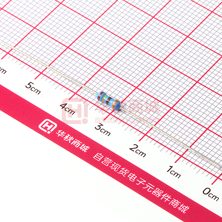

    插件,D2.4xL6.3mm
    金属膜电阻 AXIAL_D2.4X6.3MM_TM 240Ω ±5% 1/4W
