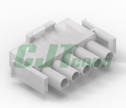

    间距P=6.35mm 胶壳 1pins 600V 19A
C6351HF-1P 数据手册
C6351 SERIES 6.35mm pitch wire to wire and wire to board connector Specifications Current rating:13.5A AC,DC(Max) Voltage rating:600V AC,DC Temperature range:-40°C~+105°C Contact resistance:3.5mΩ Max. Insulation resistance:1000MΩ Min. Withstanding voltage:5000V AC/minute *Compliant with RoHS and REACH* *Meet the HF/Halogen Free,GWT/Glow wire Test (IEC60335-1) request,need to customize* *Contact CJT for details* Standards E326732 wire to board wire to wire PART NO. 4.45 C6351HM-2P C6351HM-3P C6351HM-4P C6351HM-5P C6351HM-6P C6351HM-7P C6351HM-8P C6351HM-9P C6351HM-10P C6351HM-3x2P C6351HM-3x3P C6351HM-3x4P C6351HM-3x5P A E 2.79 Optional Polarizing key D B 2.54 C 14.73 1.60 32.85 REF. 1.60 1.97 1.60 30.48 REF. 30.31 REF. 1.97 28.50 43.73 48.83 REF. 43.56 48.66 REF. 15.87 27.85 14.73 2.41 27.85 14.73 E326732 Circuit 1 location when using polarizing key option with 2,3,4,5,6,7,8,9,10 circuit housing option with 3x2,3x3,3x4,3x5 circuit housing A 14.35 20.70 27.05 33.40 39.75 46.10 52.45 58.80 65.15 14.35 20.70 27.05 33.40 Dimensions B C D 13.46 8.64 2.41 13.46 8.64 2.41 13.46 8.64 2.41 13.46 8.64 2.41 13.46 8.64 2.41 13.46 8.64 2.41 13.46 8.64 2.41 13.46 8.64 2.41 13.46 8.64 2.41 26.16 12.19 6.99 26.16 12.19 6.99 26.16 12.19 6.99 26.16 12.19 6.99 E 6.35 6.35 6.35 6.35 6.35 6.35 6.35 6.35 6.35 6.35 6.35 8.89 8.89 Unit:mm CHANGJIANG CONNECTORS TEL:+86-755-29959119 29959129 FAX:+86-755-29959139 Http://www.CJT.cn C-211 C6351 SERIES C6351F-T 6.35mm pitch wire to wire and wire to board connector 6.35mm pitch Crimp Terminal Reference Informations: *Used in CJT C6351HF or C6351HM series Housing 0.30 A 4.63±0.25 A 4.25±0.25 SEC:A-A B 20.10±0.25 2.90±0.25 SEC:B-B ∅2.70±0.20 3.57±0.25 B 4.20±0.25 Unit:mm Ordering information & Specifications: Wire Range Part NO. C6351F-TB C6351F-TP C6351F-GB C6351F-GP Insulation O.D. 3.30mm(max) 3.30mm(max) 3.30mm(max) AWG#14-#20 AWG#14-#20 AWG#14-#20 AWG#14-#20 3.30mm(max) Material Brass Phosphor Bronze Brass Phosphor Bronze Qty/reel 4,000 PCS 4,000 PCS 4,000 PCS 4,000 PCS Finish Tin over Nickel Tin over Nickel Gold over Nickel Gold over Nickel Optional Gold plating available but MOQ requested C6351M-T 6.35mm pitch Crimp Terminal Reference Informations: *Used in CJT C6351HF or C6351HM series Housing 0.30 4.20±0.25 A SEC:A-A B 20.20±0.25 B 4.60±0.25 A SEC:B-B 4.20±0.25 Unit:mm Ordering information & Specifications: Part NO. C6351M-TB C6351M-TP C6351M-GB C6351M-GP Wire Range AWG#14-#20 AWG#14-#20 AWG#14-#20 AWG#14-#20 3.60±0.25 ∅2.10±0.20 2.85±0.20 Insulation O.D. 3.30mm(max) 3.30mm(max) 3.30mm(max) 3.30mm(max) Material Brass Phosphor Bronze Brass Phosphor Bronze Finish Tin over Nickel Tin over Nickel Gold over Nickel Gold over Nickel Qty/reel 4,000 PCS 4,000 PCS 4,000 PCS 4,000 PCS Optional Gold plating available but MOQ requested CHANGJIANG CONNECTORS TEL:+86-755-29959119 29959129 FAX:+86-755-29959139 Http://www.CJT.cn C-212 C6351 SERIES C6351MA-T 6.35mm pitch wire to wire and wire to board connector 6.35mm pitch Crimp Terminal A SEC:A-A B 20.20±0.25 B 4.60±0.25 A 4.10±0.25 0.30 2.90±0.25 SEC:B-B ∅2.10±0.20 3.70±0.25 Reference Informations: *Used in CJT C6351HF or C6351HM series Housing 4.20±0.25 Unit:mm Ordering information & Specifications: Wire Range Part NO. C6351MA-TB C6351MA-TP C6351MA-GB C6351MA-GP AWG#16-#20 AWG#16-#20 AWG#16-#20 AWG#16-#20 Material Brass Phosphor Bronze Insulation O.D. 3.30mm(max) 3.30mm(max) 3.30mm(max) 3.30mm(max) Brass Phosphor Bronze Qty/reel 4,000 PCS 4,000 PCS 4,000 PCS 4,000 PCS Finish Tin over Nickel Tin over Nickel Gold over Nickel Gold over Nickel Optional Gold plating available but MOQ requested C6351F-T-H 6.35mm pitch Crimp Terminal Reference Informations: *Used in CJT C6351HF or C6351HM series Housing 0.30 A 6.00±0.25 5.40±0.25 A B 20.10±0.25 B SEC:A-A ∅2.70±0.20 SEC:B-B 4.27±0.25 Unit:mm Ordering information & Specifications: Part NO. C6351F-TB-H C6351F-TP-H C6351F-GB-H C6351F-GP-H Wire Range AWG#12-#14 AWG#12-#14 AWG#12-#14 AWG#12-#14 3.25±0.25 3.55±0.25 Insulation O.D. 4.30mm(max) 4.30mm(max) 4.30mm(max) 4.30mm(max) Material Brass Phosphor Bronze Brass Phosphor Bronze Finish Tin over Nickel Tin over Nickel Gold over Nickel Gold over Nickel Qty/reel 2,500 PCS 2,500 PCS 2,500 PCS 2,500 PCS Optional Gold plating available but MOQ requested CHANGJIANG CONNECTORS TEL:+86-755-29959119 29959129 FAX:+86-755-29959139 Http://www.CJT.cn C-213 C6351 SERIES C6351M-T-H 6.35mm pitch wire to wire and wire to board connector 6.35mm pitch Crimp Terminal Reference Informations: *Used in CJT C6351HF or C6351HM series Housing 0.30 A B SEC:A-A 21.00±0.25 B ∅2.10±0.20 3.55±0.25 SEC:B-B 3.25±0.25 A 6.00±0.25 5.40±0.25 4.20±0.25 Unit:mm Ordering information & Specifications: Wire Range Part NO. C6351M-TB-H C6351M-TP-H C6351M-GB-H C6351M-GP-H AWG#12-#14 AWG#12-#14 AWG#12-#14 AWG#12-#14 Insulation O.D. 4.30mm(max) 4.30mm(max) 4.30mm(max) 4.30mm(max) Material Brass Phosphor Bronze Brass Phosphor Bronze Finish Tin over Nickel Tin over Nickel Gold over Nickel Gold over Nickel Qty/reel 2,500 PCS 2,500 PCS 2,500 PCS 2,500 PCS Optional Gold plating available but MOQ requested C6351MA-T-H 6.35mm pitch Crimp Terminal Reference Informations: *Used in CJT C6351HF or C6351HM series Housing 0.30 6.00±0.25 A SEC:A-A B 21.00±0.25 B 3.55±0.25 SEC:B-B ∅2.10±0.20 3.25±0.25 A 5.40±0.25 4.20±0.25 Unit:mm Ordering information & Specifications: Part NO. C6351MA-TB-H C6351MA-TP-H C6351MA-GB-H C6351MA-GP-H Wire Range AWG#12-#14 AWG#12-#14 AWG#12-#14 AWG#12-#14 Insulation O.D. 4.30mm(max) 4.30mm(max) 4.30mm(max) 4.30mm(max) Material Brass Phosphor Bronze Brass Phosphor Bronze Finish Tin over Nickel Tin over Nickel Gold over Nickel Gold over Nickel Qty/reel 2,500 PCS 2,500 PCS 2,500 PCS 2,500 PCS Optional Gold plating available but MOQ requested CHANGJIANG CONNECTORS TEL:+86-755-29959119 29959129 FAX:+86-755-29959139 Http://www.CJT.cn C-214 C6351 SERIES C6351F-T-L 6.35mm pitch wire to wire and wire to board connector 6.35mm pitch Crimp Terminal Reference Informations: *Used in CJT C6351HF or C6351HM series Housing 0.30 A SEC:A-A B 19.25±0.25 3.10±0.25 3.00±0.25 B 3.50±0.25 A 3.35±0.25 SEC:B-B ∅2.70±0.20 4.20±0.25 Unit:mm Ordering information & Specifications: Wire Range Part NO. C6351F-TB-L C6351F-TP-L C6351F-GB-L C6351F-GP-L Insulation O.D. 2.54mm(max) 2.54mm(max) 2.54mm(max) 2.54mm(max) AWG#18-#24 AWG#18-#24 AWG#18-#24 AWG#18-#24 Material Brass Phosphor Bronze Brass Phosphor Bronze Qty/reel 5,000 PCS 5,000 PCS 5,000 PCS 5,000 PCS Finish Tin over Nickel Tin over Nickel Gold over Nickel Gold over Nickel Optional Gold plating available but MOQ requested C6351M-T-L 6.35mm pitch Crimp Terminal Reference Informations: *Used in CJT C6351HF or C6351HM series Housing 0.30 3.20±0.25 3.30±0.25 A SEC:A-A B 20.50±0.25 B ∅2.10±0.20 2.35±0.25 SEC:B-B 2.35±0.25 A 4.20±0.25 Unit:mm Ordering information & Specifications: Part NO. C6351M-TB-L C6351M-TP-L C6351M-GB-L C6351M-GP-L Wire Range AWG#18-#24 AWG#18-#24 AWG#18-#24 AWG#18-#24 Insulation O.D. 2.54mm(max) 2.54mm(max) 2.54mm(max) 2.54mm(max) Material Brass Phosphor Bronze Brass Phosphor Bronze Finish Tin over Nickel Tin over Nickel Gold over Nickel Gold over Nickel Qty/reel 5,000 PCS 5,000 PCS 5,000 PCS 5,000 PCS Optional Gold plating available but MOQ requested CHANGJIANG CONNECTORS TEL:+86-755-29959119 29959129 FAX:+86-755-29959139 Http://www.CJT.cn C-215 C6351 SERIES C6351MA-T-L 6.35mm pitch wire to wire and wire to board connector 6.35mm pitch Crimp Terminal Reference Informations: *Used in CJT C6351HF or C6351HM series Housing 0.30 SEC:A-A B 20.20±0.25 B 3.30±0.25 A 2.35±0.25 SEC:B-B ∅2.10±0.20 2.35±0.25 A 3.20±0.25 4.20±0.25 Unit:mm Ordering information & Specifications: Part NO. C6351MA-TB-L C6351MA-TP-L C6351MA-GB-L C6351MA-GP-L Wire Range AWG#18-#24 AWG#18-#24 AWG#18-#24 AWG#18-#24 Insulation O.D. 2.54mm(max) 2.54mm(max) 2.54mm(max) 2.54mm(max) Material Brass Phosphor Bronze Brass Phosphor Bronze Finish Tin over Nickel Tin over Nickel Gold over Nickel Gold over Nickel Qty/reel 5,000 PCS 5,000 PCS 5,000 PCS 5,000 PCS Optional Gold plating available but MOQ requested CHANGJIANG CONNECTORS TEL:+86-755-29959119 29959129 FAX:+86-755-29959139 Http://www.CJT.cn C-216 C6351 SERIES C6351H 6.35mm pitch wire to wire and wire to board connector 6.35mm pitch Single Row Housing Ordering Information: C6351HF-XP - *** 1 2 1.Part No. 2.Material: (blank):Nylon 66,UL94V-2/Natural V0:Nylon 66,UL94V-0/White GWT:Nylon 66,UL94V-0,GWT 750°C Reference Informations: *Material:Nylon 66,UL94V-2 or UL94V-0 *C6351HF/HM Suitable CJT C6351F-T(-H/-L) or C6351M-T(-H/-L) or C6351MA-T(-H/-L) series Terminal *Mates with CJT C6351 series Single row Housing or C6351 series Single row Wafer *Color:Natural C6351HF C6351HM C6351HM-1P 11.68±0.20 9.65±0.20 7.37±0.20 C6351HF-1P 7.37±0.20 9.65±0.20 27.60±0.25 C6351HM-2P 13.97±0.25 6.35±0.10 Circuit 1 27.60±0.25 7.62±0.20 6.35±0.10 C6351HFA-2P-A(With Post) 13.97±0.25 C6351HFA-2P 27.60±0.25 6.35±0.10 C6351HF-2P-A(With Post) 13.97±0.25 C6351HF-2P Ordering Information: C6351HM-XP - *** 1 2 1.Part No. 2.Material: (blank):Nylon 66,UL94V-2/Natural V0:Nylon 66,UL94V-0/White GWT:Nylon 66,UL94V-0,GWT 750°C Circuit 1 7.62±0.20 27.60±0.25 Circuit 1 27.60±0.25 7.62±0.20 6.35±0.10 7.62±0.20 Circuit 1 20.32±0.25 12.70±0.20 C6351HFA-3P 20.32±0.25 Circuit 1 27.60±0.25 12.70±0.20 6.35±0.10 20.32±0.25 6.35±0.10 C6351HM-3P 12.70±0.20 C6351HF-3P 7.62±0.20 27.60±0.25 Circuit 1 27.60±0.25 7.62±0.20 CHANGJIANG CONNECTORS TEL:+86-755-29959119 29959129 FAX:+86-755-29959139 Http://www.CJT.cn C-217 C6351 SERIES 6.35mm pitch wire to wire and wire to board connector C6351HF C6351HM-4P Circuit 1 Circuit 1 7.62±0.20 19.05±0.20 26.67±0.25 6.35±0.10 C6351HFA-4P 19.05±0.20 7.62±0.20 27.60±0.25 26.67±0.25 6.35±0.10 19.05±0.20 26.67±0.25 6.35±0.10 C6351HF-4P C6351HM 27.60±0.25 Circuit 1 7.62±0.20 27.60±0.25 33.20±0.25 6.35±0.10 C6351HM-5P 25.40±0.20 C6351HF-5P Circuit 1 27.60±0.25 6.35±0.10 33.20±0.25 25.40±0.20 Circuit 1 7.62±0.20 33.20±0.25 C6351HFA-5P 25.40±0.20 7.62±0.20 6.35±0.10 27.60±0.25 Circuit 1 27.60±0.25 7.62±0.20 CHANGJIANG CONNECTORS TEL:+86-755-29959119 29959129 FAX:+86-755-29959139 Http://www.CJT.cn C-218 C6351 SERIES 6.35mm pitch wire to wire and wire to board connector C6351HF C6351HM Circuit 1 27.60±0.25 39.40±0.25 Circuit 1 7.62±0.20 7.62±0.20 27.60±0.25 Circuit 1 27.60±0.25 Circuit 1 7.62±0.20 7.62±0.20 39.40±0.25 31.75±0.20 6.35±0.10 39.40±0.25 6.35±0.10 C6351HMA-6P 31.75±0.20 C6351HFA-6P 31.75±0.20 6.35±0.10 6.35±0.10 31.75±0.20 C6351HM-6P 39.40±0.25 C6351HF-6P 27.60±0.25 CHANGJIANG CONNECTORS TEL:+86-755-29959119 29959129 FAX:+86-755-29959139 Http://www.CJT.cn C-219 C6351 SERIES 6.35mm pitch wire to wire and wire to board connector C6351HF C6351HM Circuit 1 7.62±0.20 7.62±0.20 27.60±0.25 Circuit 1 7.62±0.20 7.62±0.20 45.75±0.25 6.35±0.10 6.35±0.10 38.10±0.20 Circuit 1 27.60±0.25 38.10±0.20 C6351HMA-7P 45.74±0.25 C6351HFA-7P 45.75±0.25 6.35±0.10 6.35±0.10 38.10±0.20 Circuit 1 27.60±0.25 38.10±0.20 C6351HM-7P 45.74±0.25 C6351HF-7P 27.60±0.25 CHANGJIANG CONNECTORS TEL:+86-755-29959119 29959129 FAX:+86-755-29959139 Http://www.CJT.cn C-220 C6351 SERIES 6.35mm pitch wire to wire and wire to board connector C6351HF Circuit 1 Circuit 1 7.62±0.20 7.62±0.20 27.60±0.25 Circuit 1 Circuit 1 7.62±0.20 7.62±0.20 52.10±0.25 44.45±0.20 6.35±0.10 52.10±0.25 27.60±0.25 6.35±0.10 C6351HMA-8P 44.45±0.20 C6351HFA-8P 52.10±0.25 6.35±0.10 44.45±0.20 52.10±0.25 27.60±0.25 6.35±0.10 C6351HM-8P 44.45±0.20 C6351HF-8P C6351HM 27.60±0.25 CHANGJIANG CONNECTORS TEL:+86-755-29959119 29959129 FAX:+86-755-29959139 Http://www.CJT.cn C-221 C6351 SERIES 6.35mm pitch wire to wire and wire to board connector C6351HF C6351HM-9P 27.60±0.25 Circuit 1 Circuit 1 7.62±0.20 7.62±0.20 27.60±0.25 C6351HMA-9P 27.60±0.25 Circuit 1 Circuit 1 7.62±0.20 7.62±0.20 58.45±0.25 50.80±0.20 6.35±0.10 50.80±0.20 58.44±0.25 6.35±0.10 C6351HFA-9P 58.45±0.25 50.80±0.20 6.35±0.10 50.80±0.20 58.44±0.25 6.35±0.10 C6351HF-9P C6351HM 27.60±0.25 CHANGJIANG CONNECTORS TEL:+86-755-29959119 29959129 FAX:+86-755-29959139 Http://www.CJT.cn C-222 C6351 SERIES 6.35mm pitch wire to wire and wire to board connector C6351HF C6351HM-10P 27.60±0.25 Circuit 1 Circuit 1 7.62±0.20 7.62±0.20 27.60±0.25 C6351HMA-10P 27.60±0.25 Circuit 1 Circuit 1 7.62±0.20 7.62±0.20 64.80±0.25 57.15±0.20 64.80±0.25 57.15±0.20 6.35±0.10 6.35±0.10 C6351HFA-10P 64.80±0.25 6.35±0.10 57.15±0.20 57.15±0.20 64.80±0.25 6.35±0.10 C6351HF-10P C6351HM 27.60±0.25 CHANGJIANG CONNECTORS TEL:+86-755-29959119 29959129 FAX:+86-755-29959139 Http://www.CJT.cn C-223 C6351 SERIES C6351H-3 6.35mm pitch wire to wire and wire to board connector 6.35mm pitch Triple Row Housing Ordering Information: C6351HF-3xXP - *** 1 2 1.Part No. 2.Material: (blank):Nylon 66,UL94V-2/Natural V0:Nylon 66,UL94V-0/White GWT:Nylon 66,UL94V-0,GWT 750°C Reference Informations: *Material:Nylon 66,UL94V-2 or UL94V-0 *C6351HF/HM-3xXP Suitable CJT C6351F-T(-H/-L) or C6351M-T(-H/-L) or C6351MA-T(-H/-L) series Terminal *Mates with CJT C6351 series triple row Housing or C6351 series triple row Wafer *Color:Natural C6351HF-3xXP Ordering Information: C6351HM-3xXP - *** 1 2 1.Part No. 2.Material: (blank):Nylon 66,UL94V-2/Natural V0:Nylon 66,UL94V-0/White GWT:Nylon 66,UL94V-0,GWT 750°C C6351HM-3xXP C6351HM-3x2P 20.40±0.25 14.04±0.25 Circuit 6 6.35±0.10 C6351HF-3x2P 20.40±0.25 Circuit 3 Circuit 1 Circuit 3 Circuit 1 27.60±0.25 14.05±0.25 6.35±0.10 6.35±0.10 12.70±0.20 C6351HFA-3x2P 14.04±0.25 Circuit 6 Circuit 3 6.35±0.10 27.60±0.25 Circuit 6 6.35±0.10 12.70±0.20 6.35±0.10 20.40±0.25 27.60±0.25 Circuit 1 12.70±0.20 20.40±0.25 Circuit 9 6.35±0.10 C6351HM-3x3P 20.40±0.25 12.70±0.20 C6351HF-3x3P 20.40±0.25 Circuit 3 Circuit 3 Circuit 1 Circuit 1 27.60±0.25 20.40±0.25 6.35±0.10 12.70±0.20 6.35±0.10 20.40±0.25 12.70±0.20 Circuit 3 6.35±0.10 Circuit 9 12.70±0.20 Circuit 9 6.35±0.10 20.40±0.25 12.70±0.20 C6351HFA-3x3P 27.60±0.25 Circuit 1 6.35±0.10 27.60±0.25 12.70±0.20 CHANGJIANG CONNECTORS TEL:+86-755-29959119 29959129 FAX:+86-755-29959139 Http://www.CJT.cn C-224 C6351 SERIES C6351H-3 6.35mm pitch wire to wire and wire to board connector 6.35mm pitch Triple Row Housing Reference Informations: *Material:Nylon 66,UL94V-2 or UL94V-0 *C6351HF/HM-3xXP Suitable CJT C6351F-T(-H/-L) or C6351M-T(-H/-L) or C6351MA-T(-H/-L) series Terminal *Mates with CJT C6351 series triple row Housing or C6351 series triple row Wafer *Color:Natural C6351HF-3xXP C6351HM-3xXP C6351HF-3x4P C6351HM-3x4P 20.40±0.25 19.05±0.20 6.35±0.10 26.74±0.25 Circuit 12 20.40±0.25 Circuit 3 Circuit 1 Circuit 3 Circuit 1 12.70±0.20 C6351HFA-3x4P 26.75±0.25 6.35±0.10 27.60±0.25 19.05±0.20 6.35±0.10 20.40±0.25 Circuit 12 Circuit 12 6.35±0.10 19.05±0.20 27.60±0.25 6.35±0.10 26.74±0.25 12.70±0.20 Circuit 3 Circuit 1 6.35±0.10 27.60±0.25 12.70±0.20 CHANGJIANG CONNECTORS TEL:+86-755-29959119 29959129 FAX:+86-755-29959139 Http://www.CJT.cn C-225 C6351 SERIES C6351H-3 6.35mm pitch wire to wire and wire to board connector 6.35mm pitch Triple Row Housing Reference Informations: *Material:Nylon 66,UL94V-2 or UL94V-0 *C6351HF/HM-3xXP Suitable CJT C6351F-T(-H/-L) or C6351M-T(-H/-L) or C6351MA-T(-H/-L) series Terminal *Mates with CJT C6351 series triple row Housing or C6351 series triple row Wafer *Color:Natural C6351HF-3xXP C6351HM-3xXP C6351HF-3x5P C6351HM-3x5P 20.40±0.25 25.40±0.20 33.10±0.25 6.35±0.10 Circuit 15 20.40±0.25 Circuit 3 Circuit 3 Circuit 1 Circuit 1 6.35±0.10 27.60±0.25 33.10±0.25 6.35±0.10 C6351HFA-3x5P 25.40±0.20 12.70±0.20 20.40±0.25 Circuit 15 Circuit 15 6.35±0.10 25.40±0.20 33.10±0.25 27.60±0.25 6.35±0.10 12.70±0.20 Circuit 3 Circuit 1 6.35±0.10 27.60±0.25 12.70±0.20 CHANGJIANG CONNECTORS TEL:+86-755-29959119 29959129 FAX:+86-755-29959139 Http://www.CJT.cn C-226 C6351 SERIES C6351HFI-XP 6.35mm pitch wire to wire and wire to board connector 6.35mm Pitch Interface Seal Reference Informations: *Material:Silicone rubber *Used in CJT C6351HF/HFA series single row Housing *Color:Blue 7.60 A±0.20 CJT B±0.25 1.20 0.55 Technical Requirements: *2.79mm-3.30mm insulation diameter passed European IP sealing level #5/7(swirling dust/immersion to 1 meter for 30 minutes) *1.52mm-2.79mm insulation diameter passed European IP sealing level #5/6(swirling dust/heavy seas) *Wire AWG range is #20-14 with insulation diameter range 1.52mm-3.3mm A±0.20 A±0.20 6.35±0.10 7.60 7.60 6.35±0.10 CJT CJT Ordering Information & Dimensions: B±0.25 B±0.25 0.55 1.20 1.20 0.55 PART NO. 2P 3P 4P 5P Dimensions A B 6.35 14.00 12.70 20.35 19.05 26.70 25.40 33.05 Unit: mm C6351S-XP 6.35mm PItch Wire Seal Reference Informations: *Material:Silicone rubber *Used in CJT C6351HF/HFA or C6351HM/HMA series single row Housing *Color:Blue A±0.20 6.35±0.20 CJT 7.60±0.20 Ø1.60 Technical Requirements: *2.79mm-3.30mm insulation diameter passed European IP sealing level #5/7(swirling dust/immersion to 1 meter for 30 minutes) *1.52mm-2.79mm insulation diameter passed European IP sealing level #5/6(swirling dust/heavy seas) *Wire AWG range is #20-14 with insulation diameter range 1.52mm-3.3mm 2.55 10.16±0.20 B±0.25 Ordering Information & Dimensions: PART NO. 6.00±0.10 4.65±0.10 2P 3P 4P 5P Dimensions A B 6.35 14.00 12.70 20.35 19.05 26.70 25.40 33.05 Unit: mm CHANGJIANG CONNECTORS TEL:+86-755-29959119 29959129 FAX:+86-755-29959139 Http://www.CJT.cn C-227 C6351 SERIES C6351HFI-3xXP 6.35mm pitch wire to wire and wire to board connector 6.35mm Pitch Interface Seal Reference Informations: *Material:Silicone rubber *Used in CJT C6351HF/HFA series triple row Housing *Color:Blue A±0.20 6.35±0.10 A±0.20 0.55 20.35±0.25 CJT 20.35±0.20 1 0.55 Technical Requirements: *2.79mm-3.30mm insulation diameter passed European IP sealing level #5/7(swirling dust/immersion to 1 meter for 30 minutes) *1.52mm-2.79mm insulation diameter passed European IP sealing level #5/6(swirling dust/heavy seas) *Wire AWG range is #20-14 with insulation diameter range 1.52mm-3.3mm CJT 1.20 1.20 B±0.25 B±0.25 C6351HFI-3x5P C6351HFI-3x2P A±0.20 A±0.20 B±0.25 C6351HFI-3x4P C6351HFI-3x3P C6351S-3xXP Ordering Information & Dimensions: PART NO. 1.20 B±0.25 0.55 CJT 20.35±0.20 0.55 CJT 20.35±0.20 6.35±0.10 1.20 3x2P 3x3P 3x4P 3x5P Dimensions A B 6.35 14.00 12.70 20.35 19.05 26.70 25.40 33.05 Unit: mm 6.35mm Pitch Wire Seal 20.35±0.20 Reference Informations: *Material:Silicone rubber *Used in CJT C6351HF/HFA or C6351HM series triple row Housing *Color:Blue Technical Requirements: *2.79mm-3.30mm insulation diameter passed European IP sealing level #5/7(swirling dust/immersion to 1 meter for 30 minutes) *1.52mm-2.79mm insulation diameter passed European IP sealing level #5/6(swirling dust/heavy seas) *Wire AWG range is #20-14 with insulation diameter range 1.52mm-3.3mm CJT Ø1.60 6.35±0.20 B±0.25 2.55 A±0.20 Ordering Information & Dimensions: 6.00±0.10 10.16±0.20 4.65±0.10 PART NO. 3x2P 3x3P 3x4P 3x5P Dimensions A B 6.35 14.00 12.70 20.35 19.05 26.70 25.40 33.05 Unit: mm CHANGJIANG CONNECTORS TEL:+86-755-29959119 29959129 FAX:+86-755-29959139 Http://www.CJT.cn C-228 C6351 SERIES C6351HFIA-XP 6.35mm pitch wire to wire and wire to board connector 6.35mm Pitch Interface Seal Reference Informations: *Material:Closed cell silicon foam *Used in CJT C6351HF/HFA series single row Housing *Color:Black 8.00+0.40 -0.70 A±0.30 1.57 B+0.40 -0.70 Technical Requirements: *2.79mm-3.30mm insulation diameter passed European IP sealing level #5/7(swirling dust/immersion to 1 meter for 30 minutes) *1.52mm-2.79mm insulation diameter passed European IP sealing level #5/6(swirling dust/heavy seas) *Wire AWG range is #20-14 with insulation diameter range 1.52mm-3.3mm A±0.30 A±0.30 6.35±0.25 8.00+0.40 -0.70 8.00+0.40 -0.70 6.35±0.25 Ordering Information & Dimensions: B+0.40 -0.70 1.57 PART NO. 1.57 B+0.40 -0.70 2P 3P 4P 5P Dimensions A B 6.35 14.35 12.70 20.70 19.05 27.05 25.40 33.40 Unit: mm C6351HFIA-3xXP 6.35mm Pitch Interface Seal Reference Informations: *Material:Closed cell silicon foam *Used in CJT C6351HF/HFA series triple row Housing *Color:Black 12.70±0.30 6.35±0.25 Technical Requirements: 12.70±0.30 6.35±0.25 20.70+0.40 -0.70 A±0.25 B+0.40 -0.70 B+0.40 -0.70 A±0.30 6.35±0.25 20.70+0.40 -0.70 *2.79mm-3.30mm insulation diameter passed European IP sealing level #5/7(swirling dust/immersion to 1 meter for 30 minutes) *1.52mm-2.79mm insulation diameter passed European IP sealing level #5/6(swirling dust/heavy seas) *Wire AWG range is #20-14 with insulation diameter range 1.52mm-3.3mm 1.57 1.57 Ordering Information & Dimensions: PART NO. 3x2P 3x3P 3x4P 3x5P Dimensions A B 6.35 14.35 12.70 20.70 19.05 27.05 25.40 33.40 Unit: mm CHANGJIANG CONNECTORS TEL:+86-755-29959119 29959129 FAX:+86-755-29959139 Http://www.CJT.cn C-229 C6351 SERIES C6351WV-XP-M 6.35mm pitch wire to wire and wire to board connector 6.35mm pitch 180° Single Row Wafer-MALE TYPE Ordering Information: C6351WV-XP-M - *** - *** 1 2 3 1.Part No. 2.Material: (blank):Nylon 66,UL94V-2/Natural V0:Nylon 66,UL94V-0/White GWT:Nylon 66,UL94V-0,GWT 750°C 3.Finish (blank):Tin over Nickel G:Gold-flash G15:15μin (0.38μm) MIN.Select Gold(Mating Area) 100μin (2.54μm) MIN.Select Tin G30:30μin (0.76μm) MIN.Select Gold(Mating Area) 100μin (2.54μm) MIN.Select Tin Reference Informations: *Material:Pin:Brass/Tin over Nickel Insulator:Nylon 66,UL94V-2 or UL94V-0 *Mates with CJT C6351HF/HFA series single row Housing *Color:Natural Circuit 1 ∅1.78±0.08 6.35±0.10 6.35±0.05 A±0.20 2.25/2.08 B±0.25 7.62±0.20 A A 2.01/1.85 SEC: A-A Ordering Information & Dimensions: 3.57±0.20 14.73±0.25 2.54±0.15 Mating Area P.C.B LAYOUT PART NO. 2P 3P 4P 5P 6P 7P 8P 9P 10P 8.90±0.25 Dimensions A B 6.35 13.97 12.70 20.32 19.05 26.67 25.40 33.02 31.75 39.37 38.10 45.72 44.45 52.07 50.80 58.42 57.15 64.77 Unit: mm C6351WV-XP-F 6.35mm pitch 180° Single Row Wafer-Female Type Ordering Information: C6351WV-XP-F - *** - *** 1 2 3 1.Part No. 2.Material: (blank):Nylon 66,UL94V-2/Natural V0:Nylon 66,UL94V-0/White GWT:Nylon 66,UL94V-0,GWT 750°C 3.Finish (blank):Tin over Nickel G:Gold-flash G15:15μin (0.38μm) MIN.Select Gold(Mating Area) 100μin (2.54μm) MIN.Select Tin G30:30μin (0.76μm) MIN.Select Gold(Mating Area) 100μin (2.54μm) MIN.Select Tin Reference Informations: *Material:Pin:Brass/Tin over Nickel Insulator:Nylon 66,UL94V-2 or UL94V-0 *Mates with CJT C6351HF/HFA series single row Housing *Color:Natural Circuit 1 ∅1.78±0.08 6.35±0.10 6.35±0.05 A±0.20 7.62±0.20 Ordering Information & Dimensions: 3.57±0.20 14.73±0.25 2.54±0.15 Mating Area P.C.B LAYOUT B±0.25 8.90±0.25 PART NO. 2P 3P 4P 5P 6P 7P 8P 9P 10P Dimensions A B 6.35 13.97 12.70 20.32 19.05 26.67 25.40 33.02 31.75 39.37 38.10 45.72 44.45 52.07 50.80 58.42 57.15 64.77 Unit: mm CHANGJIANG CONNECTORS TEL:+86-755-29959119 29959129 FAX:+86-755-29959139 Http://www.CJT.cn C-230 C6351 SERIES C6351WV-XP-RA 6.35mm pitch wire to wire and wire to board connector 6.35mm pitch 180° Single Row Wafer,Round Pin-MALE TYPE Ordering Information: C6351WV(-F)-XP-RA - ** - *** - *** 1 2 3 4 1.Part No. 2.Size(H): (blank):3.68mm H1:7.62mm H2:4.30mm H3:7.00mm H4:5.20mm 3.Material: (blank):Nylon 66,UL94V-0/White GWT:Nylon 66,UL94V-0,GWT 750°C 4.Finish (blank):Silver over Nickel G:Gold-flash G15:15μin (0.38μm) MIN.Select Gold(Mating Area) 100μin (2.54μm) MIN.Select Tin G30:30μin (0.76μm) MIN.Select Gold(Mating Area) 100μin (2.54μm) MIN.Select Tin Reference Informations: *Material:Pin:Brass/Silver over Nickel Insulator:Nylon 66,UL94V-0 *Mates with CJT C6351HF/HFA series single row Housing *Color:White Circuit 1 Ø1.78±0.08 6.35±0.10 A±0.20 6.35±0.05 4.45 P.C.B LAYOUT B±0.25 7.40±0.25 2.54±0.15 Ø2.10 PART NO. Mating Area H(3.68±0.20) 17.27±0.25 14.00±0.25 Ordering Information & Dimensions: Ø1.50 C6351WV-F-XP-RA 2P 3P 4P 5P 6P 7P 8P 9P 10P Dimensions A B 6.35 13.97 12.70 20.32 19.05 26.67 25.40 33.02 31.75 39.37 38.10 45.72 44.45 52.07 50.80 58.42 57.15 64.77 Unit: mm C6351WV-F-XP-M 6.35mm pitch 180° Single Row Wafer Polarizing Peg-MALE TYPE Ordering Information: C6351WV-F-XP-M - *** - *** 1 2 3 1.Part No. 2.Material: (blank):Nylon 66,UL94V-2/Natural V0:Nylon 66,UL94V-0/White GWT:Nylon 66,UL94V-0,GWT 750°C 3.Finish (blank):Tin over Nickel G:Gold-flash G15:15μin (0.38μm) MIN.Select Gold(Mating Area) 100μin (2.54μm) MIN.Select Tin G30:30μin (0.76μm) MIN.Select Gold(Mating Area) 100μin (2.54μm) MIN.Select Tin 2.25/2.08 Reference Informations: *Material:Pin:Brass/Tin over Nickel Insulator:Nylon 66,UL94V-2 or UL94V-0 *Mates with CJT C6351HF/HFA series single row Housing *Color:Natural Circuit 1 Ø1.78±0.08 6.35±0.05 6.35±0.10 4.45±0.05 A±0.20 7.62±0.20 14.73±0.25 A A 2.01/1.85 SEC: A-A Ordering Information & Dimensions: 3.57±0.20 17.27±0.25 2.54±0.15 Mating Area P.C.B LAYOUT B±0.25 8.90±0.25 PART NO. 2P 3P 4P 5P 6P 7P 8P 9P 10P Dimensions A B 6.35 13.97 12.70 20.32 19.05 26.67 25.40 33.02 31.75 39.37 38.10 45.72 44.45 52.07 50.80 58.42 57.15 64.77 Unit: mm CHANGJIANG CONNECTORS TEL:+86-755-29959119 29959129 FAX:+86-755-29959139 Http://www.CJT.cn C-231 C6351 SERIES C6351WV-F-XP-F 6.35mm pitch wire to wire and wire to board connector 6.35mm pitch 180° Single Row Wafer with Polarizing Peg-Female Type Reference Informations: *Material:Pin:Brass/Tin over Nickel Insulator:Nylon 66,UL94V-2 or UL94V-0 *Mates with CJT C6351HF/HFA series single row Housing *Color:Natural Ordering Information: C6351WV-F-XP-F - *** - *** 1 2 3 1.Part No. 2.Material: (blank):Nylon 66,UL94V-2/Natural V0:Nylon 66,UL94V-0/White GWT:Nylon 66,UL94V-0,GWT 750°C 3.Finish (blank):Tin over Nickel G:Gold-flash G15:15μin (0.38μm) MIN.Select Gold(Mating Area) 100μin (2.54μm) MIN.Select Tin G30:30μin (0.76μm) MIN.Select Gold(Mating Area) 100μin (2.54μm) MIN.Select Tin Circuit 1 Ø1.78±0.08 6.35±0.05 6.35±0.10 4.45±0.05 A±0.20 P.C.B LAYOUT B±0.25 7.62±0.20 Ordering Information & Dimensions: 3.57±0.20 PART NO. Mating Area 17.27±0.25 14.73±0.25 2.54±0.15 8.90±0.25 2P 3P 4P 5P 6P 7P 8P 9P 10P Dimensions A B 6.35 13.97 12.70 20.32 19.05 26.67 25.40 33.02 31.75 39.37 38.10 45.72 44.45 52.07 50.80 58.42 57.15 64.77 Unit: mm C6351WV-3xXP-M 6.35mm pitch 180° Triple Row Wafer-MALE TYPE Reference Informations: *Material:Pin:Brass/Tin over Nickel Insulator:Nylon 66,UL94V-2 or UL94V-0 *Mates with CJT C6351HF/HFA series triple row Housing *Color:Natural 6.35±0.10 Ø1.78±0.08 12.70±0.20 6.35±0.05 Circuit 1 6.35±0.05 6.35±0.10 Ordering Information: C6351WV-3xXP-M - *** - *** 1 2 3 1.Part No. 2.Material: (blank):Nylon 66,UL94V-2/Natural V0:Nylon 66,UL94V-0/White GWT:Nylon 66,UL94V-0,GWT 750°C 3.Finish (blank):Tin over Nickel G:Gold-flash G15:15μin (0.38μm) MIN.Select Gold(Mating Area) 100μin (2.54μm) MIN.Select Tin G30:30μin (0.76μm) MIN.Select Gold(Mating Area) 100μin (2.54μm) MIN.Select Tin P.C.B LAYOUT 2.25/2.08 A±0.20 22.88±0.25 Mating Area B±0.25 A A SEC: A-A Ordering Information & Dimensions: 3.57±0.20 14.73±0.25 2.54±0.15 2.01/1.85 20.32±0.20 PART NO. 3x2P 3x3P 3x4P 3x5P Dimensions A B 6.35 13.97 12.70 20.32 19.05 26.67 25.40 33.02 Unit: mm CHANGJIANG CONNECTORS TEL:+86-755-29959119 29959129 FAX:+86-755-29959139 Http://www.CJT.cn C-232 C6351 SERIES C6351WV-3xXP-F 6.35mm pitch wire to wire and wire to board connector 6.35mm pitch 180° Triple Row Wafer-Female Type 6.35±0.10 Reference Informations: *Material:Pin:Brass/Tin over Nickel Insulator:Nylon 66,UL94V-2 or UL94V-0 *Mates with CJT C6351HF/HFA series triple row Housing *Color:Natural 6.35±0.05 Ø1.78±0.08 12.70±0.20 Circuit 1 Ordering Information: C6351WV-3xXP-F - *** - *** 1 2 3 1.Part No. 2.Material: (blank):Nylon 66,UL94V-2/Natural V0:Nylon 66,UL94V-0/White GWT:Nylon 66,UL94V-0,GWT 750°C 3.Finish (blank):Tin over Nickel G:Gold-flash G15:15μin (0.38μm) MIN.Select Gold(Mating Area) 100μin (2.54μm) MIN.Select Tin G30:30μin (0.76μm) MIN.Select Gold(Mating Area) 100μin (2.54μm) MIN.Select Tin 6.35±0.05 6.35±0.10 P.C.B LAYOUT A±0.20 22.88±0.25 Mating Area B±0.25 20.32±0.20 Ordering Information & Dimensions: 3.57±0.20 14.73±0.25 2.54±0.15 Dimensions A B 6.35 13.97 12.70 20.32 19.05 26.67 25.40 33.02 PART NO. 3x2P 3x3P 3x4P 3x5P Unit: mm C6351WV-3xXP-RA 6.35±0.10 Reference Informations: *Material:Pin:Brass/Silver over Nickel Insulator:Nylon 66,UL94V-0 *Mates with CJT C6351HF/HFA series triple row Housing *Color:White 12.70±0.20 Circuit 1 6.35±0.10 Ordering Information: C6351WV(-F)-3xXP-RA - ** - *** - *** 1 2 3 4 1.Part No. 2.Size(H): (blank):3.68mm H1:7.62mm H2:4.30mm H3:7.00mm H4:5.20mm 3.Material: (blank):Nylon 66,UL94V-0/White GWT:Nylon 66,UL94V-0,GWT 750°C 4.Finish (blank):Silver over Nickel G:Gold-flash G15:15μin (0.38μm) MIN.Select Gold(Mating Area) 100μin (2.54μm) MIN.Select Tin G30:30μin (0.76μm) MIN.Select Gold(Mating Area) 100μin (2.54μm) MIN.Select Tin Ø1.78±0.08 6.35±0.05 6.35mm pitch 180° Triple Row Wafer,Round Pin-Male Type A±0.20 20.32±0.20 Mating Area B±0.25 Ø2.10 H(3.68±0.20) 17.27±0.25 4.45 6.35±0.05 P.C.B LAYOUT 14.87±0.25 2.54±0.15 Ø1.55 C6351WV-F-3xXP-RA Ordering Information & Dimensions: PART NO. 3x2P 3x3P 3x4P 3x5P Dimensions A B 6.35 13.97 12.70 20.32 19.05 26.67 25.40 33.02 Unit: mm CHANGJIANG CONNECTORS TEL:+86-755-29959119 29959129 FAX:+86-755-29959139 Http://www.CJT.cn C-233 C6351 SERIES C6351WV-F-3xXP-M 6.35mm pitch wire to wire and wire to board connector 6.35mm pitch 180° Triple Row Wafer Polarizing Peg-Male Type Reference Informations: *Material:Pin:Brass/Tin over Nickel Insulator:Nylon 66,UL94V-2 or UL94V-0 *Mates with CJT C6351HF/HFA series triple row Housing *Color:Natural 12.70±0.20 6.35±0.05 6.35±0.10 Ø1.78±0.08 Circuit 1 Ordering Information: C6351WV-F-3xXP-M - *** - *** 1 2 3 1.Part No. 2.Material: (blank):Nylon 66,UL94V-2/Natural V0:Nylon 66,UL94V-0/White GWT:Nylon 66,UL94V-0,GWT 750°C 3.Finish: (blank):Tin over Nickel G:Gold-flash G15:15μin (0.38μm) MIN.Select Gold(Mating Area) 100μin (2.54μm) MIN.Select Tin G30:30μin (0.76μm) MIN.Select Gold(Mating Area) 100μin (2.54μm) MIN.Select Tin 6.35±0.05 2.25/2.08 4.45±0.05 P.C.B LAYOUT 2.01/1.85 6.35±0.10 A±0.20 SEC: A-A 22.88±0.25 Mating Area B±0.25 2.54±0.15 20.32±0.20 A A 3.57±0.20 17.27±0.25 14.73±0.25 Ordering Information & Dimensions: PART NO. 3x2P 3x3P 3x4P 3x5P Dimensions A B 6.35 13.97 12.70 20.32 19.05 26.67 25.40 33.02 Unit: mm C6351WV-F-3xXP-F 6.35mm pitch 180° Triple Row Wafer with Polarizing Peg-Female Type 6.35±0.10 Reference Informations: *Material:Pin:Brass/Tin over Nickel Insulator:Nylon 66,UL94V-2 or UL94V-0 *Mates with CJT C6351HF/HFA series triple row Housing *Color:Natural 6.35±0.05 Ø1.78±0.08 12.70±0.20 Circuit 1 Ordering Information: C6351WV-F-3xXP-F - *** - *** 1 2 3 1.Part No. 2.Material: (blank):Nylon 66,UL94V-2/Natural V0:Nylon 66,UL94V-0/White GWT:Nylon 66,UL94V-0,GWT 750°C 3.Finish: (blank):Tin over Nickel G:Gold-flash G15:15μin (0.38μm) MIN.Select Gold(Mating Area) 100μin (2.54μm) MIN.Select Tin G30:30μin (0.76μm) MIN.Select Gold(Mating Area) 100μin (2.54μm) MIN.Select Tin 6.35±0.05 4.45±0.05 6.35±0.10 P.C.B LAYOUT A±0.20 22.88±0.25 Mating Area B±0.25 20.32±0.20 Ordering Information & Dimensions: 3.57±0.20 14.73±0.25 17.27±0.25 2.54±0.15 PART NO. 3x2P 3x3P 3x4P 3x5P Dimensions A B 6.35 13.97 12.70 20.32 19.05 26.67 25.40 33.02 Unit: mm CHANGJIANG CONNECTORS TEL:+86-755-29959119 29959129 FAX:+86-755-29959139 Http://www.CJT.cn C-234 C6351 SERIES C6351WR-XP-M 6.35mm pitch wire to wire and wire to board connector 6.35mm Pitch 90° Single Row Wafer-Male Type Ordering Information: C6351WR-XP-M - *** - *** 1 2 3 1.Part No. 2.Material: (blank):Nylon 66,UL94V-2/Natural V0:Nylon 66,UL94V-0/White GWT:Nylon 66,UL94V-0,GWT 750°C 3.Finish: (blank):Tin over Nickel G:Gold-flash G15:15μin (0.38μm) MIN.Select Gold(Mating Area) 100μin (2.54μm) MIN.Select Tin G30:30μin (0.76μm) MIN.Select Gold(Mating Area) 100μin (2.54μm) MIN.Select Tin 2.25/2.11 1.98/1.85 9.14 4.06 Reference Informations: *Material:Pin:Brass/Tin over Nickel Insulator:Nylon 66,UL94V-2 *Mates with CJT C6351HF/HFA series single row Housing *Color:Natural SEC: A-A Ø3.81 Circuit 1 7.37±0.10 6.35±0.10 6.35±0.10 A±0.20 Ø1.52±0.08 P.C.B LAYOUT C±0.25 5.27 7.90±0.20 A PART NO. 2P 3P 4P 5P 6P 7P 8P 9P 10P 14.80±0.25 A Mating Area Ordering Information & Dimensions: B±0.25 Dimensions B 13.97 20.32 26.67 33.02 39.37 45.72 52.07 58.42 64.77 A 6.35 12.70 19.05 25.40 31.75 38.10 44.45 50.80 57.15 C 21.08 27.43 33.78 40.13 46.48 52.83 59.18 65.53 71.88 Unit: mm C6351WR-XP-F 6.35mm Pitch 90° Single Row Wafer-Female Type Ordering Information: C6351WR-XP-F - *** - *** 1 2 3 1.Part No. 2.Material: (blank):Nylon 66,UL94V-2/Natural V0:Nylon 66,UL94V-0/White GWT:Nylon 66,UL94V-0,GWT 750°C 3.Finish: (blank):Tin over Nickel G:Gold-flash G15:15μin (0.38μm) MIN.Select Gold(Mating Area) 100μin (2.54μm) MIN.Select Tin G30:30μin (0.76μm) MIN.Select Gold(Mating Area) 100μin (2.54μm) MIN.Select Tin 9.14 4.06 Reference Informations: *Material:Pin:Brass/Tin over Nickel Insulator:Nylon 66, UL94V-2 *Mates with CJT C6351HF/HFA series single row Housing *Color:Natural 7.37±0.10 Ø3.81 Circuit 1 6.35±0.10 6.35±0.10 A±0.20 Ø1.52±0.08 P.C.B LAYOUT C±0.25 7.90±0.20 Mating Area Ordering Information & Dimensions: B±0.25 14.80±0.25 5.27 PART NO. 2P 3P 4P 5P 6P 7P 8P 9P 10P A 6.35 12.70 19.05 25.40 31.75 38.10 44.45 50.80 57.15 Dimensions B 13.97 20.32 26.67 33.02 39.37 45.72 52.07 58.42 64.77 C 21.08 27.43 33.78 40.13 46.48 52.83 59.18 65.53 71.88 Unit: mm CHANGJIANG CONNECTORS TEL:+86-755-29959119 29959129 FAX:+86-755-29959139 Http://www.CJT.cn C-235 C6351 SERIES C6351WR-XP-R 6.35mm Pitch 90° Single Row Wafer,Round Pin-Male Type Ordering Information: C6351WR-XP-R - *** - *** 1 2 3 1.Part No. 2.Material: (blank):Nylon 66,UL94V-2/Natural V0:Nylon 66,UL94V-0/White GWT:Nylon 66,UL94V-0,GWT 750°C 3.Finish: (blank):Tin over Nickel G:Gold-flash G15:15μin (0.38μm) MIN.Select Gold(Mating Area) 100μin (2.54μm) MIN.Select Tin G30:30μin (0.76μm) MIN.Select Gold(Mating Area) 100μin (2.54μm) MIN.Select Tin A±0.20 6.35±0.10 C±0.10 Ø3.81±0.10 ∅2.10 9.14 Ø1.90±0.10 3.23±0.05 Reference Informations: *Material:Pin:Brass/Tin over Nickel Insulator:Nylon 66,UL94V-2 *Mates with CJT C6351HF/HFA series single row Housing *Color:Natural Ø1.35 6.35mm pitch wire to wire and wire to board connector 6.35±0.05 A±0.10 Circuit 1 P.C.B LAYOUT C±0.25 Ordering Information & Dimensions: B±0.25 7.90±0.20 17.27±0.25 14.80±0.25 PART NO. 4.06±0.25 Dimensions B 13.97 20.32 26.67 33.02 39.37 45.72 52.07 58.42 64.77 A 6.35 12.70 19.05 25.40 31.75 38.10 44.45 50.80 57.15 2P 3P 4P 5P 6P 7P 8P 9P 10P C 21.08 27.43 33.78 40.13 46.48 52.83 59.18 65.53 71.88 Unit: mm C6351WVB-XP 6.35mm pitch 180° Single Row Wafer Reference Informations: *Material:Pin:Brass/Tin over Nickel Insulator:PBT,UL94V-0 *Mates with CJT C6351HF/HFA-2P,3P series Housing *Color:Black B±0.25 Circuit 1 6.35±0.10 5.08 5.08 2.54 A A A±0.20 2.54 2.54 2.54 Ordering Information: C6351WVB-XP - *** - *** 1 2 3 1.Part No. 2.Material: (blank):PBT,UL94V-0 GWT:PBT,UL94V-0,GWT 750°C 3.Finish: (blank):Tin over Nickel G:Gold-flash G15:15μin (0.38μm) MIN.Select Gold(Mating Area) 100μin (2.54μm) MIN.Select Tin G30:30μin (0.76μm) MIN.Select Gold(Mating Area) 100μin (2.54μm) MIN.Select Tin t=0.025~0.05 P.C.B LAYOUT 7.62±0.20 15.90±0.20 1.60~3.20 Ø0.825±0.025 Ø0.90±0.025 SEC:A-A 5.00 Ordering Information & Dimensions: 2.54 5.08 PART NO. 2.54±0.20 2P 3P Dimensions A B 6.35 18.95 12.70 25.30 Unit: mm CHANGJIANG CONNECTORS TEL:+86-755-29959119 29959129 FAX:+86-755-29959139 Http://www.CJT.cn C-236
