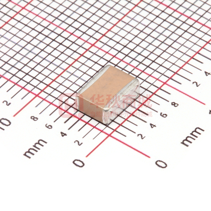

    贴片电容(MLCC) 1825 10µF ±10% 100V X7R
FS46X106K101EGG 数据手册
信昌電子陶瓷股份有限公司 Prosperity Dielectrics Co., Ltd. No.566-1, Kaoshi Rd., Yangmei, Taoyuan 32668, Taiwan (R.O.C.) Tel : 886-3-4753355 Fax : 886-3-4854959 Messrs. : Date : 一般共用 2020/11/02 APPROVAL SHEET Product Name : High Capacitance Multilayer Ceramic Chip Capacitors Part No. : FS Series Description : Size≤2225, X7R/X7S/X6S/X5R/Y5V, Cap.≥1μF, UR1μF products or 0603/Cap.≥10μFSIZE S/B thickness ±0.2mm products. “#3” For 1206 size P thickness products. “#4” 1206/100V/Cap.≥1.2μF products 6. GENERAL ELECTRICAL DATA Dielectric X7R X7S X6S X5R Y5V 0402, 0603, 0805, 0201, 0402, 0603, 0201, 0402, 0603, 0402, 0603, 0805, 1206, 1210 0805, 1206, 1210 0805, 1206, 1210 1206, 1210, 1812 6.3V, 10V, 16V, 25V, 6.3V, 10V, 16V, 25V, 4V, 6.3V, 10V, 16V, 6.3V, 10V, 16V, 25V, 50V, 100V 35V, 50V 25V, 35V, 50V 35V, 50V, 100V 1μF to 100μF 1μF to 100μF 1μF to 220μF 1μF to 100μF K(±10%), M(±20%) K(±10%), M(±20%) K(±10%), M(±20%) Z(-20/+80%) -55 to +125°C -55 to +125°C -55 to +105°C -55 to +85°C -25 to +85°C ±15% ±22% ±22% ±15% +30/-80% 0402, 0603, 0805, Size 1206, 1210, 1812, 1825, 2220, 2225 6.3V, 10V, 16V, 25V, Rated voltage (WVDC) 50V, 100V, 250V, 500V, 630V Capacitance range* Capacitance tolerance** 1μF to 47μF J(±5%)K(±10%), M(±20%) Tan δ* Note 1 Operating temperature Capacitance characteristic Termination Cu or Ag/Ni/Sn or Au (lead-free termination) * Measured at the condition of 30~70% related humidity. X7R/X7S/X6S/X5R : Apply 1.0±0.2Vrms, 1.0KHz±10% for Cap.≤10μF; 0.5±0.2Vrms, 120Hz±20% for Cap.>10µF, at 25°C ambient temperature. Y5V : Apply 1.0±0.2Vrms, 1.0KHz±10% for Cap.≤10μF; 0.5±0.2Vrms, 120Hz±20% for Cap.>10µF, at 20°C ambient temperature. ** Preconditioning for Class II MLCC : Perform a heat treatment at 150±10°C for 1 hour, then leave in ambient condition for 24±2 hours before measurement. Note 1 : X7R/X7S/X6S/X5R Rated D.F.≤ ≥100V ≤2.5% 50V ≤2.5% 35V ≤3.5% 25V ≤3.5% 16V ≤3.5% 10V ≤5% 6.3V ≤10% 4V ≤15% Exception of D.F.≤ ≤3.5% 1206≥0.47μF, 1812≥4.7μF, 1825≥4.7μF, 2220≥4.7μF, 2225≥4.7μF ≤5% 0603≥0.068μF, 0805>0.1µF, 1206>1μF, 1210≥2.2μF ≤10% 0805>0.22µF, 1210≥3.3μF 0201(50V), 0603≥0.047μF, 0805≥0.18μF, 1206≥0.47μF, ≤3.5% 1210≥2.2μF, 1812≥4.7μF, 1825≥4.7μF, 2220≥4.7μF, 2225≥4.7μF ≤5% 0201≥0.01uF, 1210≥4.7μF ≤10% 0402≥0.012μF, 0603>0.1μF, 0805≥1μF, 1206≥2.2μF, 1210≥10μF ≤10% 0603≥1μF, 0805≥2.2µF, 1206≥2.2μF, 1210≥10μF ≤5% 0201≥0.01μF, 0805≥1μF, 1210≥10μF ≤7% 0603≥0.33μF, 0201≥0.1μF, 0402≥0.056μF, 0603≥0.47μF, 0805≥2.2μF, ≤10% 1206≥2.2μF, 1210≥22μF ≤12.5% 0402≥0.47μF 0201≥0.01μF, 0402≥0.033μF, 0603≥0.15μF, 0805≥0.68μF, ≤5% 1206≥2.2μF, 1210≥4.7μF 0201≥0.1uF(0201/X7R≥0.022μF), 0402≥0.22uF, 0603≥0.15μF, ≤10% 0805≥2.2μF, 1206≥4.7μF, 1210≥22μF 0201≥0.012μF, 0402≥0.33μF(0402/X7R≥0.22μF), 0603≥0.33μF, ≤10% 0805≥2.2μF, 1206≥2.2μF, 1210≥22μF ≤15% 0201≥0.1μF, 0402≥1μF, 0603≥10μF 0201≥0.1μF, 0402≥1μF, 0603≥10μF, 0805≥4.7μF, 1206≥47μF, ≤15% 1210≥100μF ≤20% 0402≥2.2μF ----- Y5V Rated D.F.≤ ≥50V ≤5% 35V ≤7% Exception of D.F.≤ ≤7% --≤7% 25V ≤5% ≤9% 16V ≤7% (C10µF, 0.5±0.2Vrms, 120Hz±20%. ** Test condition : 0.5±0.2Vrms, 1KHz±10%. X7R: 0805=106(6.3V), 0603/475(6.3V) X5R: 0201≧224 (6.3V,10V,16V)#1, 0402≧475 (6.3V,16V), 0402≧225(10V), 0603=106 (6.3V) TT18X≧475(10V) , TT15X series X6S: 0201/474(4V),0201≧104 (6.3V,10V#1), Q/D.F. 3. (Tangent Of loss angle) 0402≧225 (6.3V), 0402/475 (10V), 0603/106 (6.3V), X7S: 0402/225(6.3V) #1 Excluding Exception of D.F.≤ 1206≥0.47μF, 1812≥4.7μF, 1825≥4.7μF, 2220≥4.7μF, ≤3.5% 2225≥4.7μF ≤5% 0603≥0.068μF, 0805>0.1µF, 1206>1μF, 1210≥2.2μF ≤10% 0805>0.22µF, 1210≥3.3μF 0201(50V), 0603≥0.047μF, 0805≥0.18μF, ≤3.5% 1206≥0.47μF, 1210≥2.2μF, 1812≥4.7μF, 1825≥4.7μF, 2220≥4.7μF, 2225≥4.7μF ≤5% 0201≥0.01uF, 1210≥4.7μF 0402≥0.1μF, 0603>0.1μF, 0805≥1μF, 1206≥2.2μF, ≤10% 1210≥10μF ≤10% 0603≥1μF, 0805≥2.2µF, 1206≥2.2μF, 1210≥10μF ≤5% 0201≥0.01μF, 0805≥1μF, 1210≥10μF ≤7% 0603≥0.33μF 0201≥0.1μF, 0402≥0.10μF, 0603≥0.47μF, ≤10% 0805≥2.2μF, 1206≥2.2μF, 1210≥22μF ≤12.5% 0402≥0.47μF 0201≥0.01μF, 0402≥0.033μF, 0603≥0.15μF, ≤5% 0805≥0.68μF, 1206≥2.2μF, 1210≥4.7μF 0201≥0.1uF(0201/X7R≥0.022μF), 0402≥0.22uF, ≤10% 0603≥0.68μF, 0805≥2.2μF, 1206≥4.7μF, 1210≥22μF 0201≥0.012μF, 0402≥0.33μF(0402/X7R≥0.22μF), ≤10% 0603≥0.33μF, 0805≥2.2μF, 1206≥2.2μF, 1210≥22μF ≤15% 0201≥0.1μF, 0402≥1μF 0201≥0.1μF, 0402≥1μF, 0603≥10μF, 0805≥4.7μF, ≤15% 1206≥47μF, 1210≥100μF ≤20% 0402≥2.2μF ----- * Y5V X5R/0201/105(6.3V);225(10V), Rated Vol. D.F.≤ X6S/0201/104(10V) (1.0±0.2Vrms,1KHz±10%) ≥50V Exception of D.F.≤ ≤7% 0603≥0.1μF, 0805≥0.47μF, 1206≥4.7μF ≤12.5% 1210≥6.8μF 35V ≤7% ----0402≥0.047μF, 0603≥0.1μF, 0805≥0.33μF, ≤7% 1206≥1μF, 1210≥4.7μF ≤5% *Before initial measurement (Class II only) : To 25V 0402≥0.068μF, 0603≥0.47μF, 1206≥4.7μF, ≤9% 1210≥22μF apply de-aging at 150°C for 1hr then set for 24±2 ≤9% 0402≥0.068μF, 0603≥0.68μF 16V hrs at room temp. ≤7% (C100V ≤50V X7R 100V Capacitance C≥0.1µF C≥0.022µF C≥0.1µF C≥0.22µF C≥0.47µF C≥0.082µF C≥1.0µF C≥2.2µF C≥4.7µF C≥0.47µF C≥0.12µF C≥4.7µF C≥1.0µF C≥1.0µF C≥0.22µF C≥4.7µF C≥1.0µF X7R C≥1.0µF ≥100V (6) 120% of rated voltage for below range : Size 2220 Dielectric X7R Rated Voltage ≥100V Capacitance C≥15µF * Test time : 1000 +24/-0 hrs. * Before initial measurement (Class II only) : To apply de-aging at 150°C for 1hr then set for 24±2 hrs at room temp. * Measurement to be made after keeping at room temp. for 48±4 hrs (Class II). ** De-rating conditions : Specification No. : FS-000-001-22 ~ 10 ~ DCM-003-8.3 Rev 2 信昌電子陶瓷股份有限公司 Prosperity Dielectrics Co., Ltd. 8. RELIABILITY TEST CONDITIONS AND REQUIREMENTS No. Item Test Condition Requirements * Capacitors mounted on a substrate. A force of 5N(≤0603) or 10N(>0603) applied perpendicular to the place of substrate and parallel the line joining Adhesive the center of terminations for 10±1 second. Strength of 13. Termination * No remarkable damage or removal of the terminations. (Robustness of termination) * The middle part of substrate shall be pressurized by means of the pressurizing rod at a rate of about 1mm per second until the deflection becomes 1mm. * No remarkable damage. Resistance to Flexure of 14. Substrate (Substrate Dielectric Cap. Change X7R/X7S/X6S/X5R Within ±12.5% Y5V Within ±30% (This capacitance change means the change of capacitance under bending test) specified flexure of substrate from the capacitance measured before the test) Unit : mm * Vibration frequency : 10~55 Hz/min. * Total amplitude : 1.5mm. * Test time : 6 hrs. (Two hrs each in three mutually 15. Vibration Resistance perpendicular directions) * Before initial measurement (Class II only) : To apply de-aging at 150°C for 1hr then set for 24±2 hrs at * No remarkable damage. * Cap. change and D.F. : To meet initial spec. room temp. * Measurement to be made after keeping at room temp. for 48±4 hrs (Class II). Specification No. : FS-000-001-22 ~ 11 ~ DCM-003-8.3 Rev 2 信昌電子陶瓷股份有限公司 Prosperity Dielectrics Co., Ltd. 9. PACKAGE DIMENSION AND QUANTITY Size 0201(0603) 0402(1005) 0603(1608) 0805(2012) 1206(3216) 1210(3225) 1808(4520) 1812(4532) 1825(4563) 2220(5750) 2225(5763) Thickness (mm) 0.30±0.03 0.30±0.05 0.30±0.09 0.50±0.05 0.50 +0.02/-0.05 0.50±0.20 0.50±0.10 0.80±0.07 0.80 +0.15/-0.10 0.50±0.10 0.60±0.10 0.80±0.10 0.85±0.10 1.25±0.10 1.25±0.20 0.80±0.10 0.85±0.10 0.95±0.10 1.15±0.15 1.25±0.10 1.60±0.20 1.60 +0.30/-0.10 0.85±0.10 0.95±0.10 1.25±0.10 1.60±0.20 2.00±0.20 2.50±0.30 1.25±0.10 1.60±0.20 2.00±0.20 1.25±0.10 1.60±0.20 2.00±0.20 2.50±0.30 2.80±0.30 1.60±0.20 2.00±0.20 2.50±0.30 2.80±0.30 1.60±0.20 2.00±0.20 2.50±0.30 2.80±0.30 1.60±0.20 2.00±0.20 2.50±0.30 2.80±0.30 Paper tape 7” reel 15k 15k 15k 10k 10k 10k 4k 4k 4k 4k 4k 4k 4k 4k 4k - Plastic tape 13” reel 70k 50k 50k 15k 15k 15k 15k 15k 15k 15k 15k - 7” reel 3k 3k 3k 3k 3k 2k 2k 3k 3k 3k 2k 1k 1k 2k 2k 1k 1k 1k 1k 0.5k 0.5k 1k 1k 0.5k 0.5k 1k 1k 0.5k 0.5k 1k 1k 0.5k 0.5k 13” reel 10k 10k 10k 10k 10k 10k 9k 10k 10k 10k 6k 6k 10k 8k 6k 5k 3k Unit : pcs Specification No. : FS-000-001-22 ~ 12 ~ DCM-003-8.3 Rev 2 信昌電子陶瓷股份有限公司 Prosperity Dielectrics Co., Ltd. 9. PACKAGE DIMENSION AND QUANTITY 9.1. EMBOSSED TAPE DIMENSIONS Fig. 9.1 The dimension of paper tape Size Chip Thickness A0 B0 T K0 W P0 10xP0 P1 P2 D0 D1 E F Unit : 0201 0402 0.50±0.05 0.50±0.10 0.70±0.20 1.20±0.20 ≤0.80 8.00±0.10 4.00±0.10 40.00±0.10 2.00±0.05 2.00±0.05 1.55±0.05 1.75±0.05 3.50±0.05 mm 0.30±0.03 0.39±0.07 0.69±0.07 ≤0.50 8.00±0.10 4.00±0.10 40.00±0.10 2.00±0.05 2.00±0.05 1.55±0.05 1.75±0.05 3.50±0.05 mm Size Fig. 9.2 The dimension of plastic tape 0603 0.80±0.07 0.80 +0.15/-0.1 0.80±0.10 1.00 +0.05/-0.1 1.80±0.10 0.95±0.05 8.00±0.10 4.00±0.10 40.00±0.20 4.00±0.10 2.00±0.05 1.55±0.05 1.75±0.05 3.50±0.05 mm 1.02 +0.05/-0.1 1.80±0.10 0.97±0.05 8.00±0.10 4.00±0.10 40.00±0.20 4.00±0.10 2.00±0.05 1.55±0.05 1.75±0.05 3.50±0.05 mm 1.50±0.10 2.30±0.10 0.95±0.05 8.00±0.10 4.00±0.10 40.00±0.20 4.00±0.10 2.00±0.05 1.55±0.05 1.75±0.05 3.50±0.05 mm 1206 Chip Thickness 0.80±0.10 A0 B0 T K0 W P0 10xP0 P1 P2 D0 D1 E F Unit : 2.00±0.10 3.50±0.10 0.95±0.05 8.00±0.10 4.00±0.10 40.00±0.20 4.00±0.10 2.00±0.05 1.55±0.05 1.75±0.10 3.50±0.05 mm 0805 1210 0.95±0.10 1.25±0.10 1.60±0.20 1.60+0.3/-0/1
FS46X106K101EGG
1. 物料型号:文档中提到的物料型号为FS系列,这是一款高电容多层陶瓷片式电容器。
2. 器件简介:PDC FS系列电容器采用环保材料制造,不含铅和镉。这些电容器通过在MLCC中串联多层电容器单元来实现高电压性能。这种特殊设计可以在整个电容器中分布电压梯度,以防止短路故障,是LCD背光逆变器应用的安全设计。
3. 引脚分配:文档中没有明确提到具体的引脚分配图,但提到了电容器适用于表面贴装,适用于波峰焊和回流焊。
4. 参数特性: - 尺寸:不超过2225。 - 介质:X7R/X7S/X6S/X5R/Y5V。 - 电容:大于或等于1μF。 - 额定电压:小于1KV。
5. 功能详解: - 实现小尺寸中的高电容。 - 无铅端子(纯锡)。 - 符合无卤素和RoHS标准。 - 高可靠性,无极性。
6. 应用信息: - 数字电路耦合或去耦应用。 - 用于旁路。 - 非常适合平滑电路。 - 直流至直流转换器。
7. 封装信息:文档提供了不同尺寸和封装类型的详细信息,包括尺寸代码、描述、额定电压、包装类型、厚度描述等。
