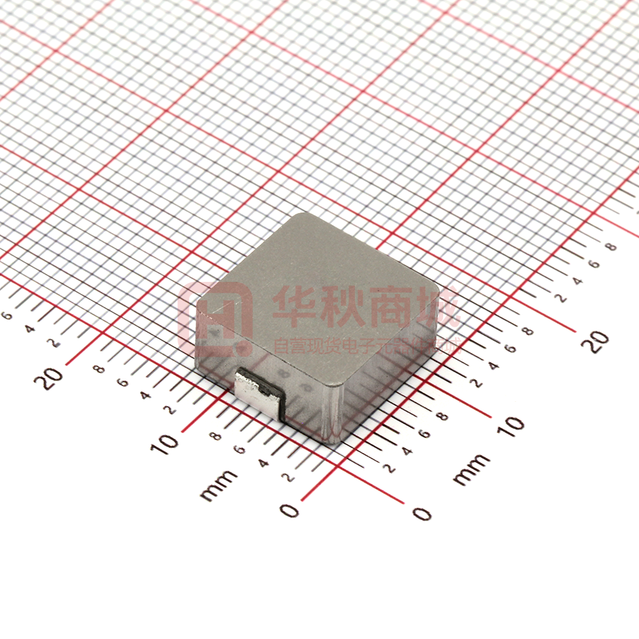

    功率电感 68µH ±20% IND_14.4X12.8MM_SM 6.50mm 14.40 x 12.80mm 115mΩ 2.5A
SLO1365H680MTT 数据手册
SLO1365H680MTT 1. Features 1. Magnetic metal powder inductor. 2. Compact design. 3. High current,low DCR,high efficiency. 4. Very low acoustic noise and very low leakage flux noise. 5. High reliability. 6. 100% Lead(Pb)-Free and RoHS compliant. 2. Dimensions 680 编号 A B C D E 尺寸(mm) 14.40Max. 12.80 0.30 ± 4.00 0.50 ± 6.50Max. 0 0.15 ~ F ± 2.50 0.50 3. Recommend Land Pattern Dimensions A B C 4.50 3.40 14.10 Unit : mm Rev.01 Page 1 of 7 www.Sunltech.com SLO1365H680MTT 4.Specifications DCR ( mΩ) L0 Inductance Part Number ( µH ) @ (0A) SLO1365H680MTT 68 Typ. 1. Idc : DC current (A) that will cause an approximate Saturation Current DC Amps. Idc ( A ) DC Amps. Isat ( A ) Max 95 NOTES: Heat Rating Current 115 2.5 5 △T of 40℃, 2. 2. Isat : DC current (A) that will cause Lo to drop approximately 35% ℃ ambient 4. Operating Temperature Range -55℃ to +125℃ 3. All test data is referenced to 25 5. The part temperature (ambient + temp rise) should not exceed 125 ℃under the worst operating conditions. Circuit design, component placement, PWB trace size and thickness, airflow and other cooling provisions all affect the part temperature. Part temperature should be verified in the end application. 6. TEST FREQUENCY:100KHz,1.0V 7. TESTING INSTRUMENT L :Agilent4284A,WK4235,CH3302/G LCR METER CH1320,CH1320S BIAS CURRENT SOURCE Rdc :CH502BC MICRO OHMMETER Rev.01 Page 2 of 7 www.Sunltech.com SLO1365H680MTT 5. TEST REPORT TEST REPORT L0A 68uH ±20% 66.79 65.38 64.91 67.71 68.04 66.34 65.51 65.27 64.83 65.09 Specification Tolerance 1 2 3 4 5 6 7 8 9 10 X Specification Tolerance 1 2 3 4 5 6 7 8 9 10 X Rev.01 Electrical Characteristic Item DCR 115mΩ Max 65.987 A B 14.4 12.8 Max (mm) 95.6 96.4 95.9 95.6 96.3 96.5 95.7 95.8 95.6 96.1 95.95 External Dimensions Item C 2.5Amps △T≦40℃ I sat 5Amps L≧65% 39.1℃ 74.42% I rms D F 4.0 6.5 2.5 ± 0.3(mm) ± 0.5(mm) Max (mm) ± 0.5(mm) 14.11 12.75 4.05 6.38 2.53 14.07 12.75 4.03 6.34 2.55 14.09 12.74 4.05 6.39 2.61 14.09 12.74 4.05 6.41 2.63 14.05 12.75 4.03 6.40 2.61 14.09 12.75 4.05 6.36 2.49 14.07 12.74 4.02 6.39 2.54 14.05 12.74 4.05 6.36 2.51 14.06 12.75 4.04 2.55 14.09 12.74 4.05 6.41 6.36 14.077 12.745 4.042 6.380 2.555 Page 3 of 7 2.53 www.Sunltech.com SLO1365H680MTT 6. INDUCTANCE VS DC CURRENT 7.TEMPERATURE RISE VS DC CURRENT Rev.01 Page 4 of 7 www.Sunltech.com SLO1365H680MTT 8. Reliability and Test Condition Item Performance Test Condition ℃ -10~+40℃,50~60%RH (Product without taping) Operating temperature -40~+125 Storage temperature Electrical Performance Test HP4284A,CH11025,CH3302,CH1320,CH1320S Inductance Refer to standard electrical characteristics list. DCR CH16502,Agilent33420A Micro-Ohm Meter. Saturation Current (Isat) △L30% typical. Saturation DC Current (Isat) will cause L0 to drop L(%)(keep quickly). △ Heat Rated Current (Irms) Heat Rated Current (Irms) Heat Rated Current (Irms) will cause the coil Approximately △T≦40℃ △T(℃) without core loss. temperature rise Reliability Test ℃ Temperature:125±2 . Duration:1000±12hrs . High Temperature Exposure Test ℃ Low Temperature Life Test Temperature:-40±2 Low Temperature Life Test . Humidity:85±3%RH. Temperature:85±2 . Duration:1000±12hr s. ℃ Biased Humidity Test Condition for 1 cycle Step1:-40+0 / -2 Thermal shock test Electric specifications should be satisfied ℃ 15±1 min. Step2:Room temperature within ℃ ≦0.2 min. Step3:+125+2 / -0 Frequency: 10-2000-10Hz for15±1min. 20 min. Amplitude: Parts mounted within 2" from any secure Vibration test point. Directions and times: X, Y, Z directions for 20 min. Reflow test Reflow test Solder test Terminals should be covered by over 95% solder on visual inspection Solder test Terminals should be covered by over 95% solder on visual inspection Rev.01 Page 5 of 7 : ±℃ : : ± ℃, , ± ℃, ± Pre-heat 150 5 Duration 5 minutes 20~40 Temperature 260 5 seconds (IPC/JEDEC J-STD-020C) After dip into flux dip into solder 235 5 4 1seconds Flux solder for lead free (ANSI /J-STD-002C Method B) 、 www.Sunltech.com SLO1365H680MTT 9. SOLDERING CONDITION RECOMMENDED 9.1 器件焊接方式: 9.1.1 回流焊焊接方式及推荐炉温曲线 9.1.2 高温耐热性描述(在 265℃的熔融铅料中,停留时间不少于 10 秒,3 次最少,无 质量问题。) O 9.1.3 返修温度和时间 (温度:400 C;时间:不少于 5 秒。) 9.1.4 焊接次数 (元器件能承受的焊接次数不少于 3 次。) Rev.01 Page 6 of 7 www.Sunltech.com SLO1365H680MTT 10. Packaging Information F TYPE A B A B C D E F C D 24mm 330 100 21.0 ±0.8 + 0 .5 13 − 0.2 16±0.3 26.4 E Q’TY (PCS) A0 B0 KO W P T 500 14.5±0.1 12.9±0.1 ±0.1 6.6±0.1 24.0±0.3 16.0±0.1 .0±0.1 0.40±0.05 101 一卷包装:500Pcs; ①一卷包装 ② 小箱装两卷:一共 1000Pcs; 00Pcs; ③ 大箱装三小箱: 大箱装三小箱 一共 3000Pcs. 00Pcs. Rev.01 Page 7 of 7 www.Sunltech.com
